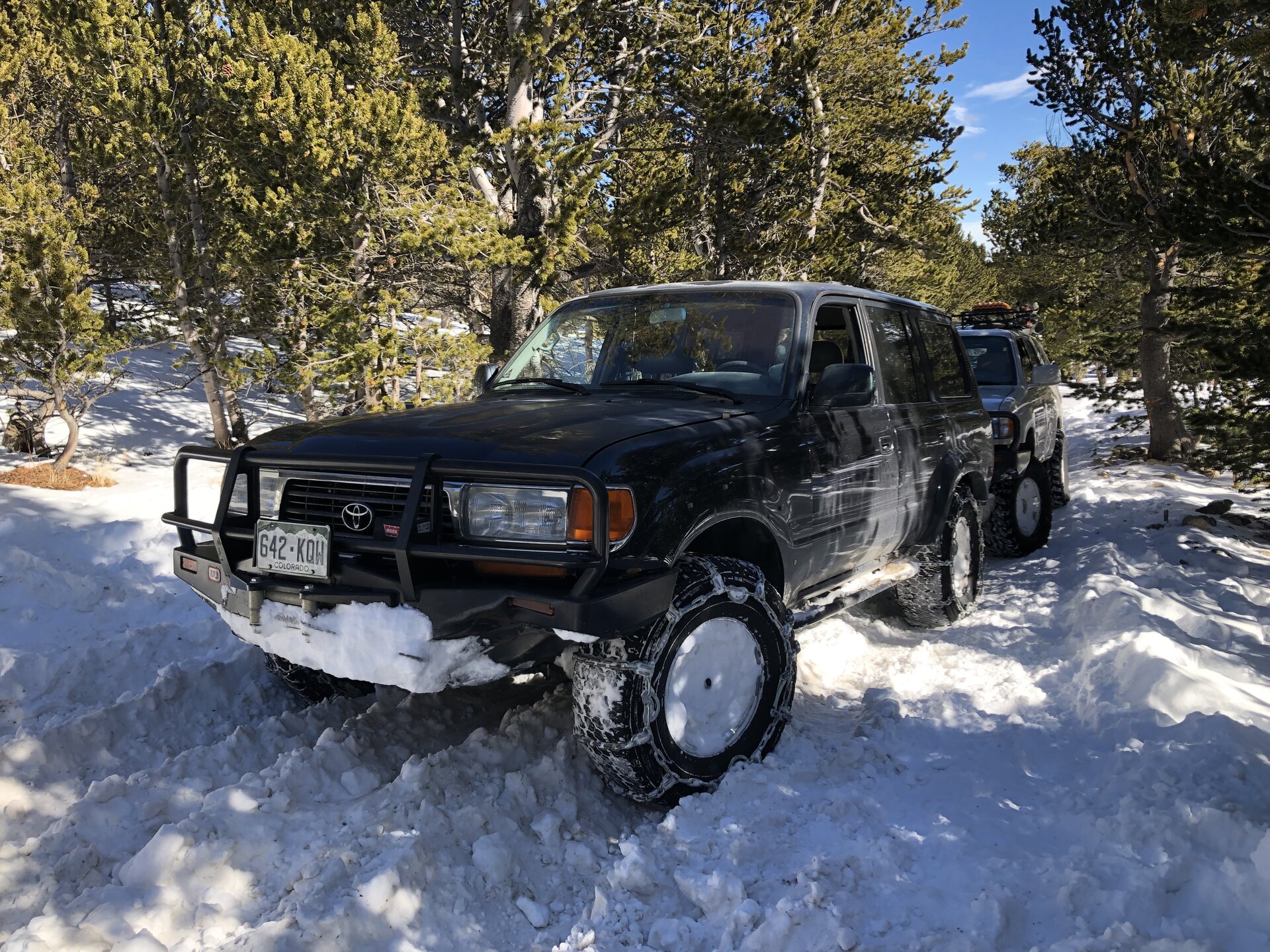

Half a century ago my dad's "rule" was chain the front going up hill and chain the rear going down hill. Or, chain all 4 corners.
Chains are going to make noise at either end. When it comes to the front axle clearance becomes even more important.

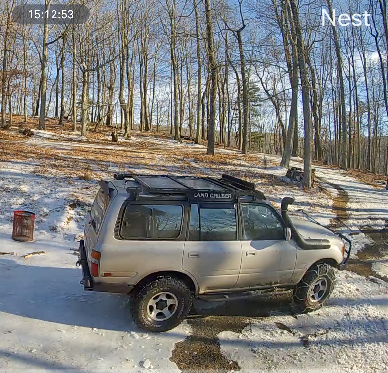

I recently purchased chains, installed for the first time today. I only bought two so I installed on the front for increased steering control. They worked well on solid ice.
