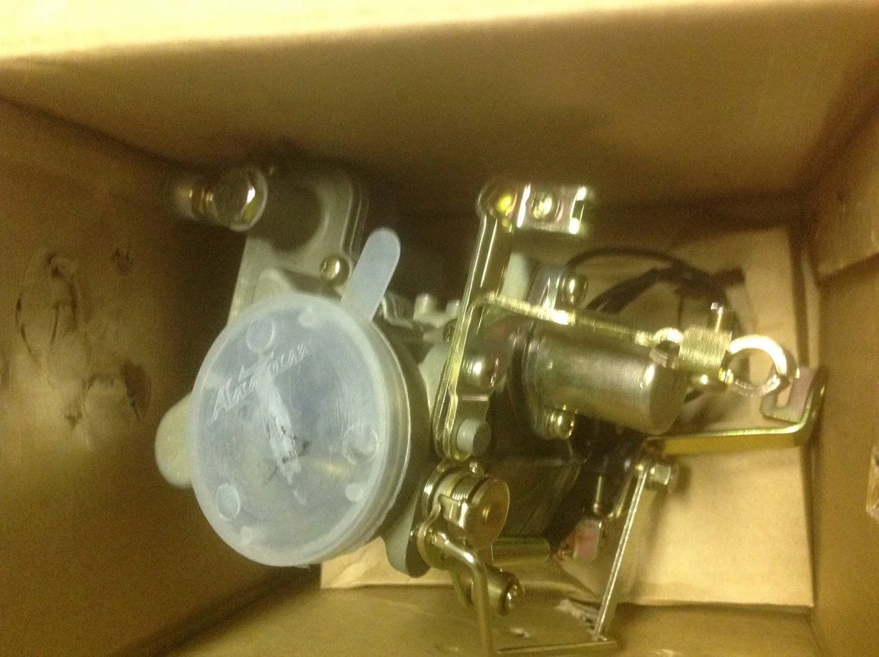

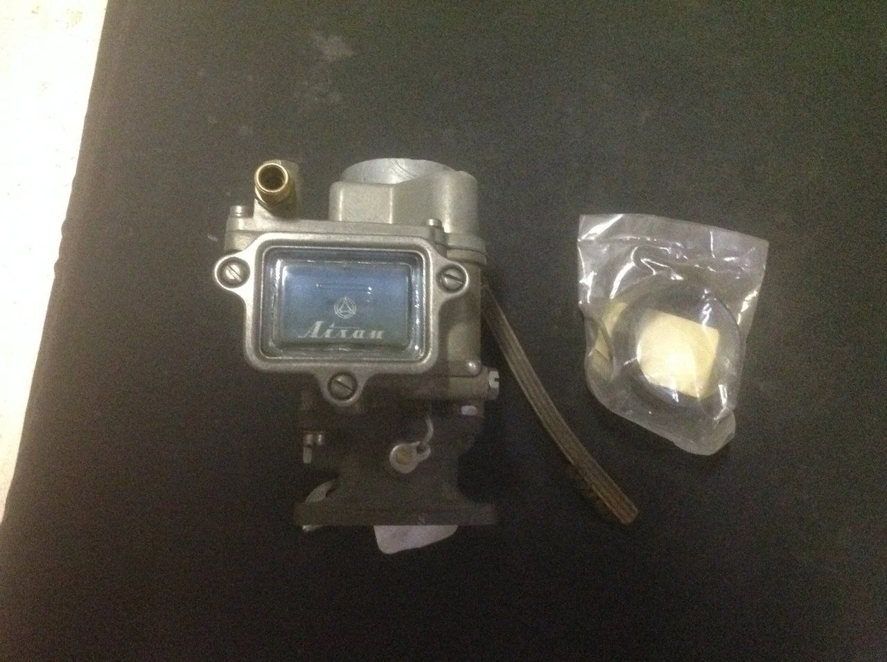

That rig deserves a period-correct blue tag large window carb. Rebuilt, fully detailed, with NOS air cleaner gasket. $800.00
Pretty sure my carb is fine- the fuel pump the current suspect.
What is the date code on that blue tag? Tell me the story on that one? Did you go with a more modeling one?

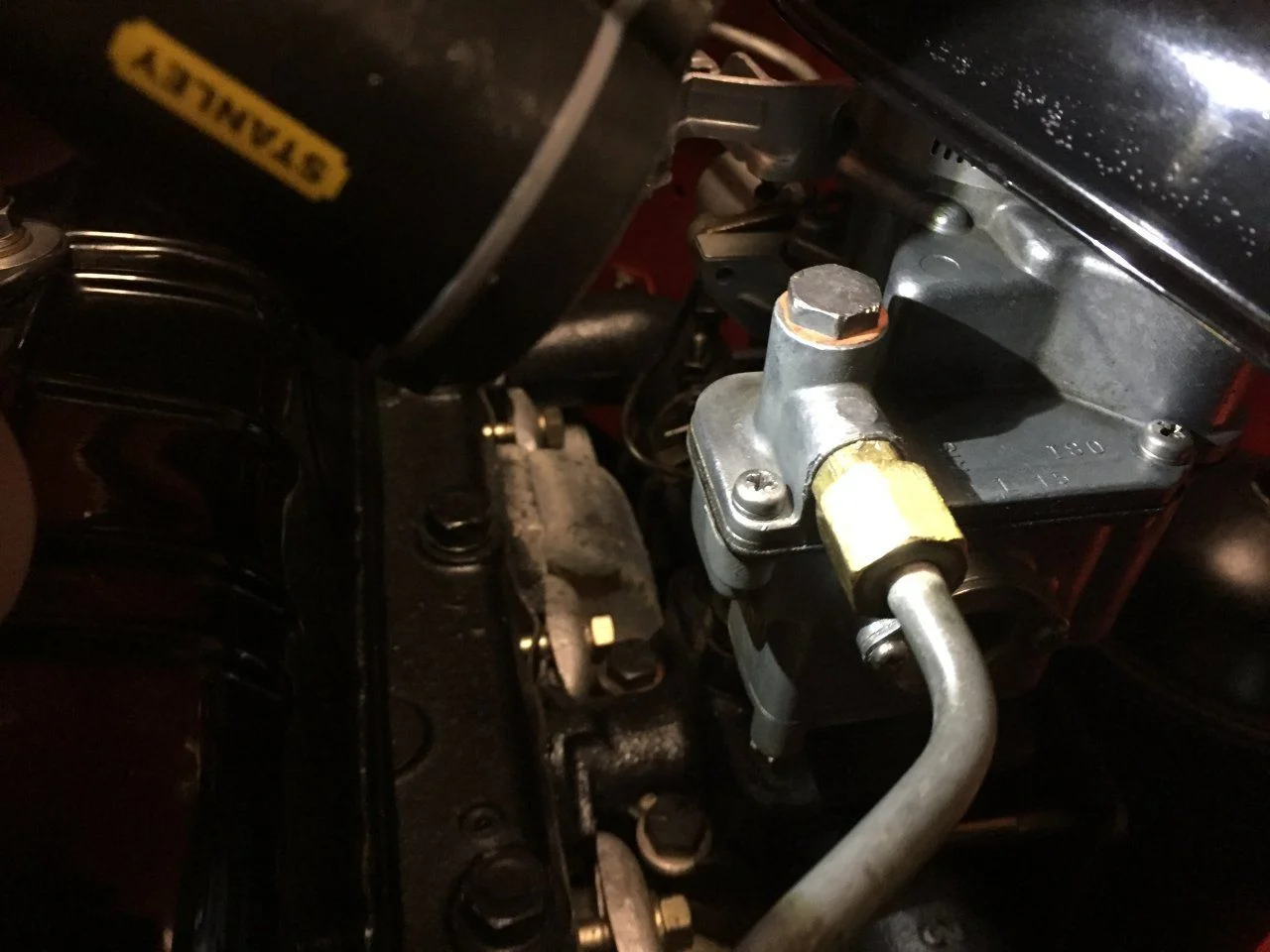

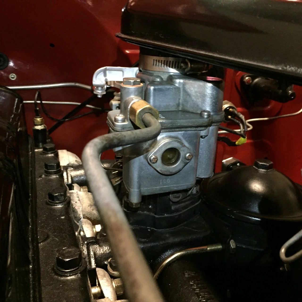

Could not resist such a beauty. Thanks Mark. It's going on now. Although we found the issue with the fuel (homemade fuel line inlet jet that restricted flow- missed in restoration since it was hidden)- I still wanted the original period correct style carb.

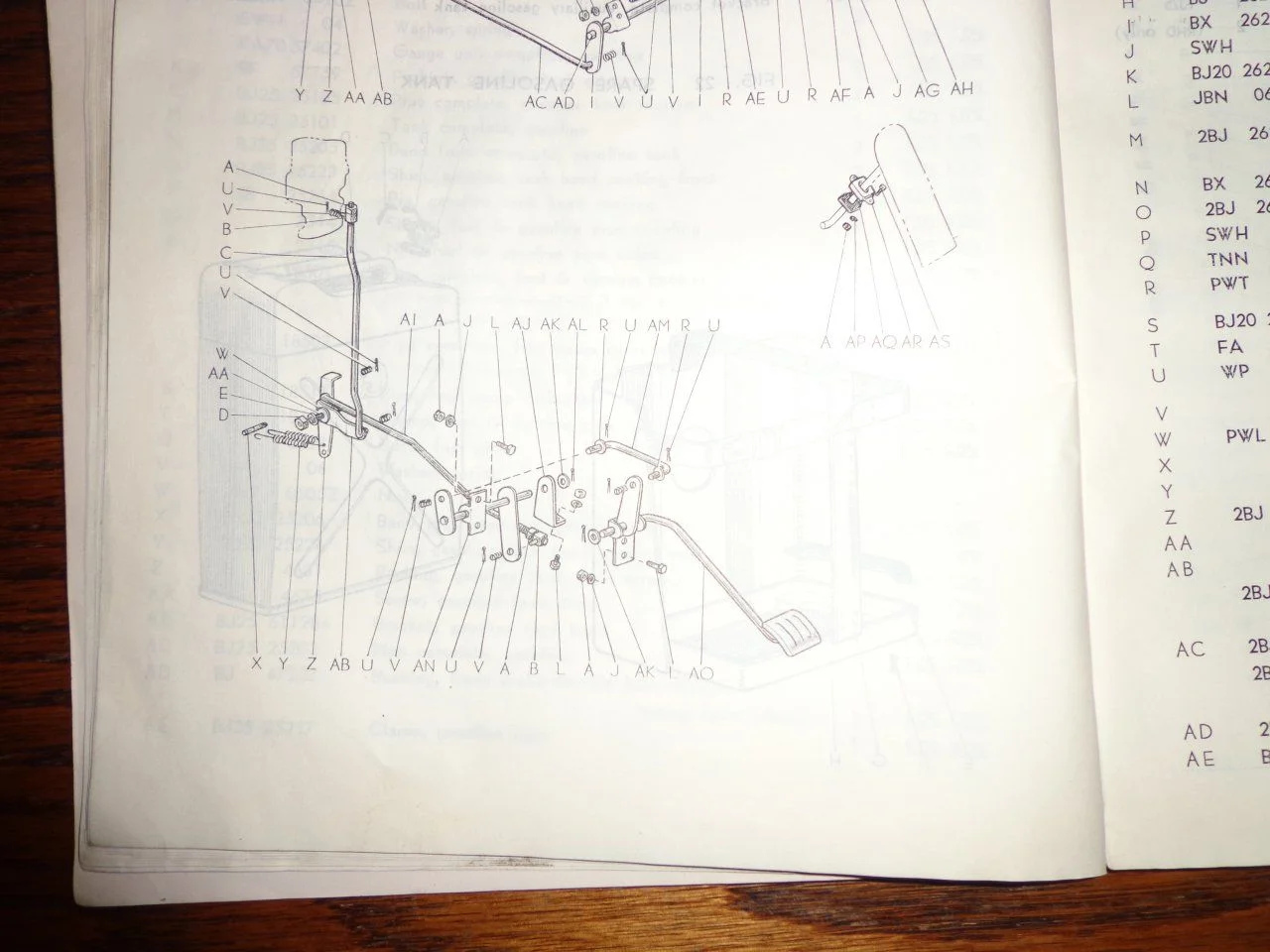

Question for all who are familiar- there is no "Spring" on the carb body linkages throttle for it to return to idle. On the 25's was that spring in the main linkages? Scratching my head....
Thanks. What a great resource! That Blue Face looks so bad arse on this thing....tweaking a few more things like hose clamps, etc to get her closer...wire covers, etc.
