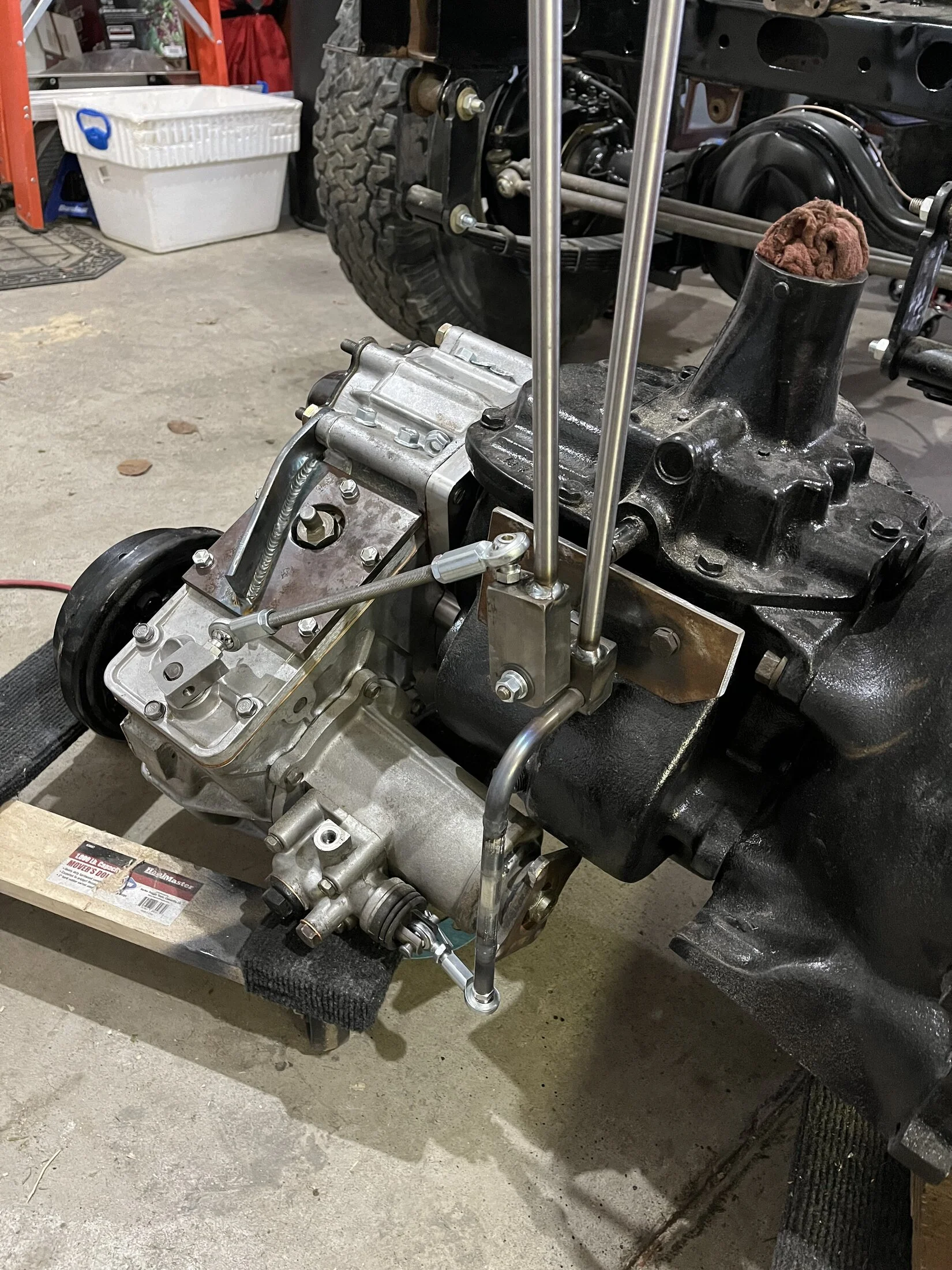

Here is my setup. I don't have a picture of it in the vehicle, but I did put a 1" body lift on mine for clearance issues.
My bracket is a homebrew version where I welded the pivot pin from the twin stick kit onto a bracket and bolted it to the SM420 case. I also swapped the two sticks left to right and welded an extension on the 2WD to 4WD selector.
If it has a body lift your twin stick is probably funky because he had the bodylift installed first and he then had to raise the twin stick up to get the pivot point closer to the floor to reduce the throw of the sticks. I run a body lift also. And my t-case lever is was stock and the throw is long at the top of the stick so the hole in my floor was huge. I raised my pivot point up to get the linkage up closer to the floor then I was able to patch up the floors and install the OEM shift lever boot back The body lift probably wasn’t installed to clear the linkage. The linkage was raised to pass through the floor of the body lifted crusier. I run a SM465 to 3spd t-case. So custom linkage too.
Thanks for the pictures, that helps a bunch. He used the threaded hole that is the rearward most bolt hole in your bracket which I think is taller than the forward threaded bolt hole and definitely higher than your pivot. If I can get the linkage more forward on the trans like yours is then I think I will be fine.
