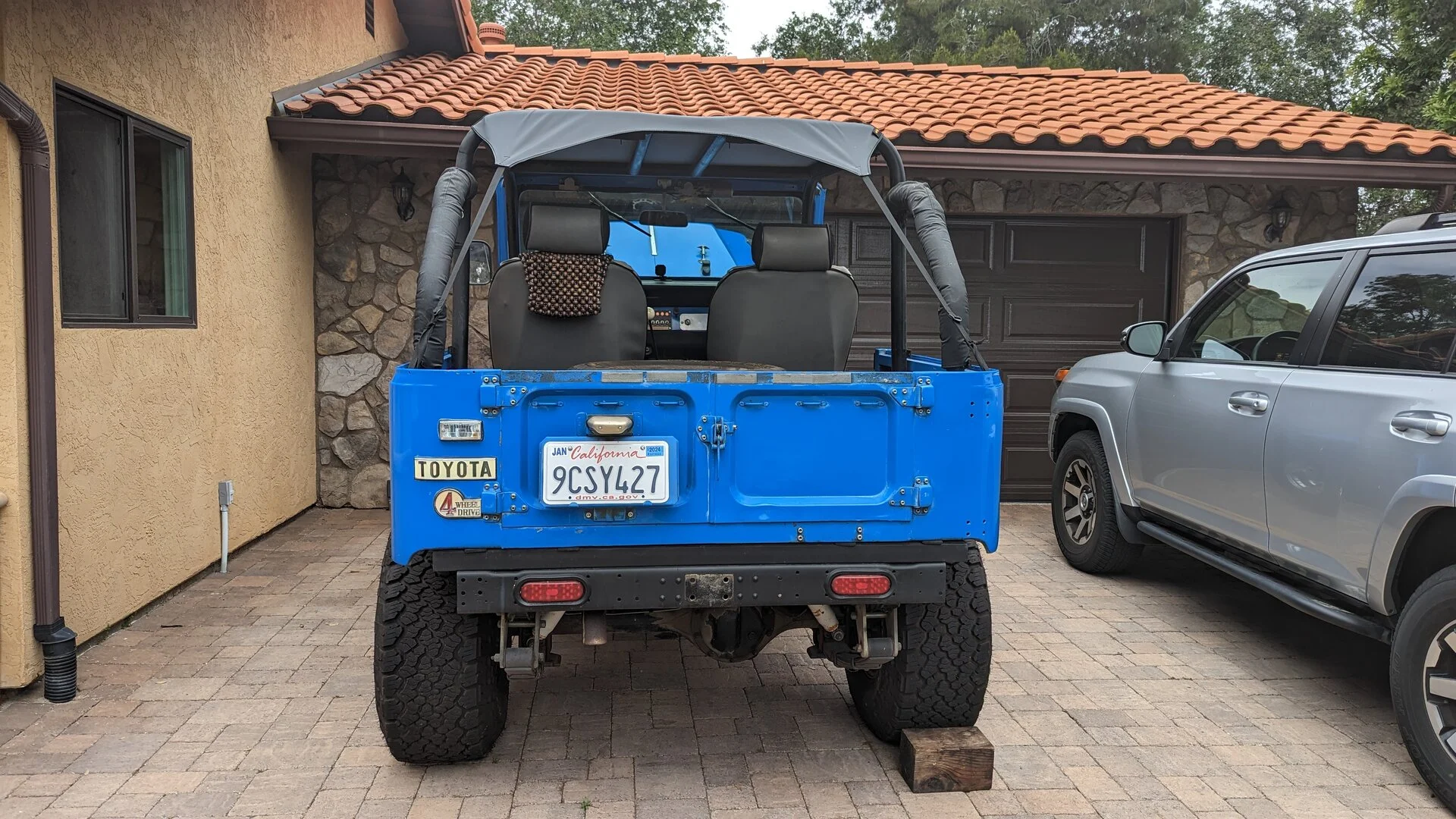

Pic as I got it home today.

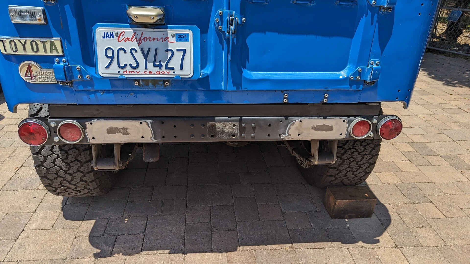

  • Removed aftermarket LED taillights and installed 1968 correct taillights
  • Had a fabricator fill in the holes in the rear crossmember where the aftermarket lights were so the new bumper could be mounted.

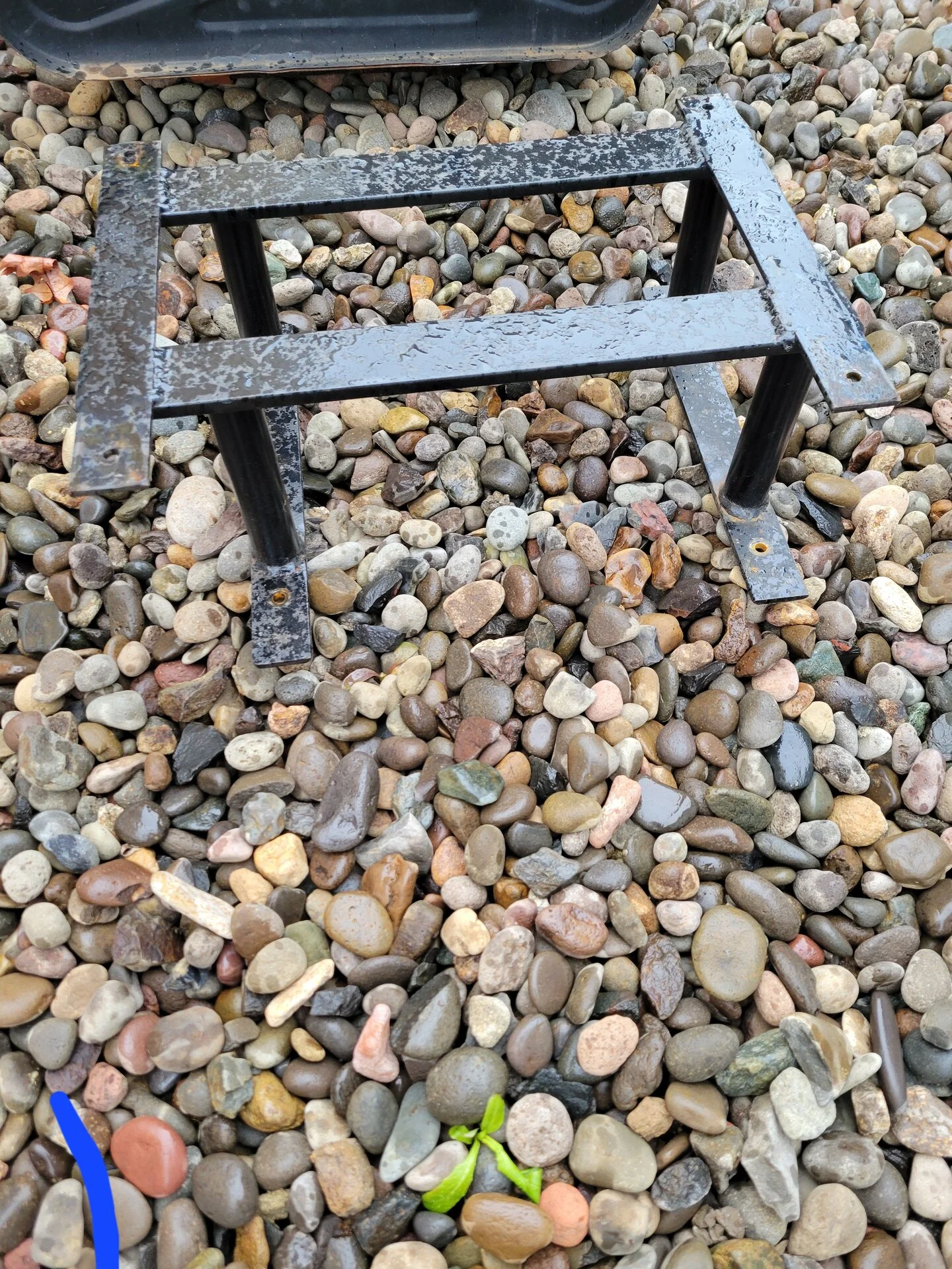

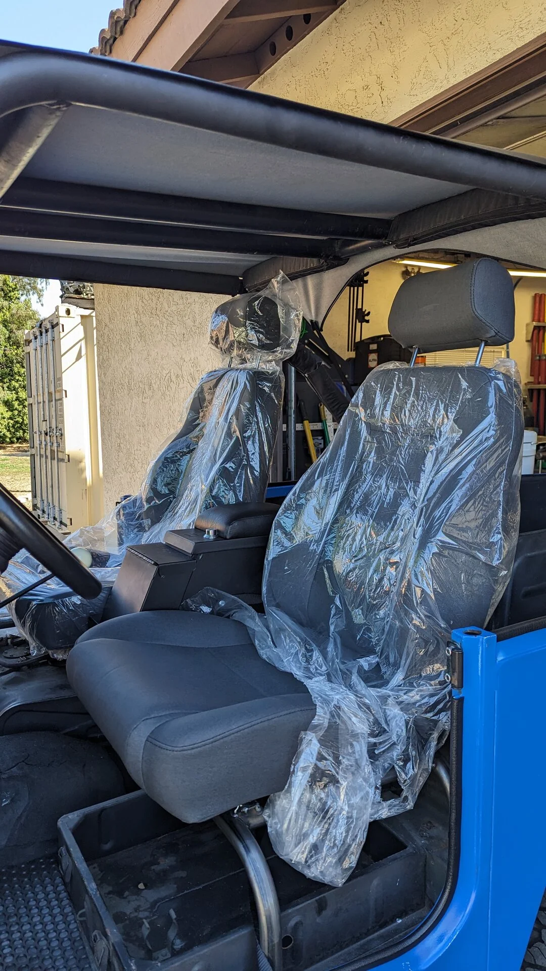

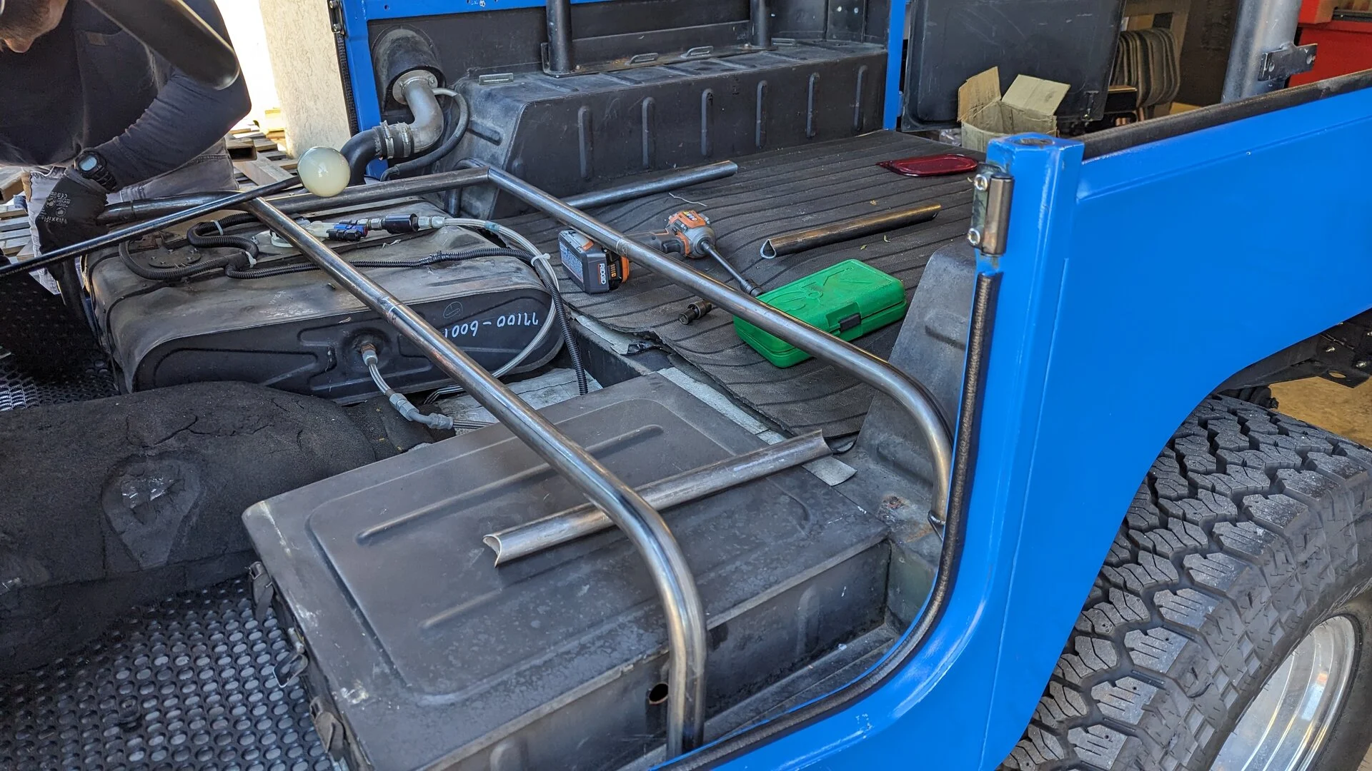

Finally got over to the fabricator guys house and had him weld up the cumminscruiser seat frame kit. I order best top trail max pro ii seats and a Tuffy console as well. For seat belts I picked some basic lap belts, once I get the roll cage figured out I'll go to a retractable belt system. Huge improvement over what I had which was crap and non adjustable.

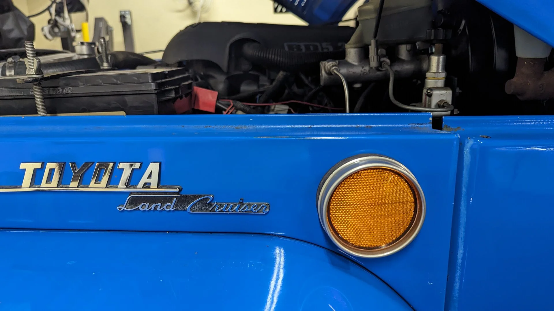

Last up is some nice reflectors I scored from a mud member. Been looking for a good set for months.

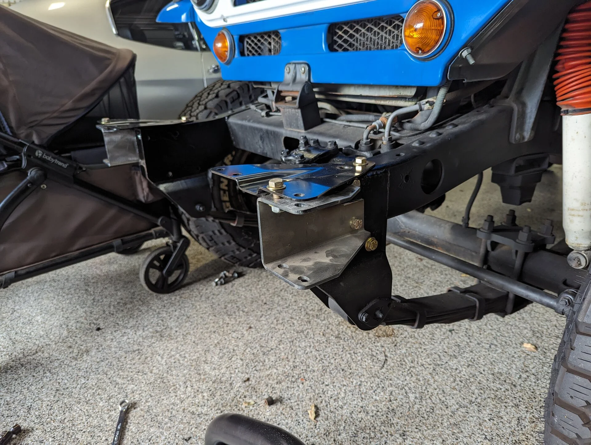

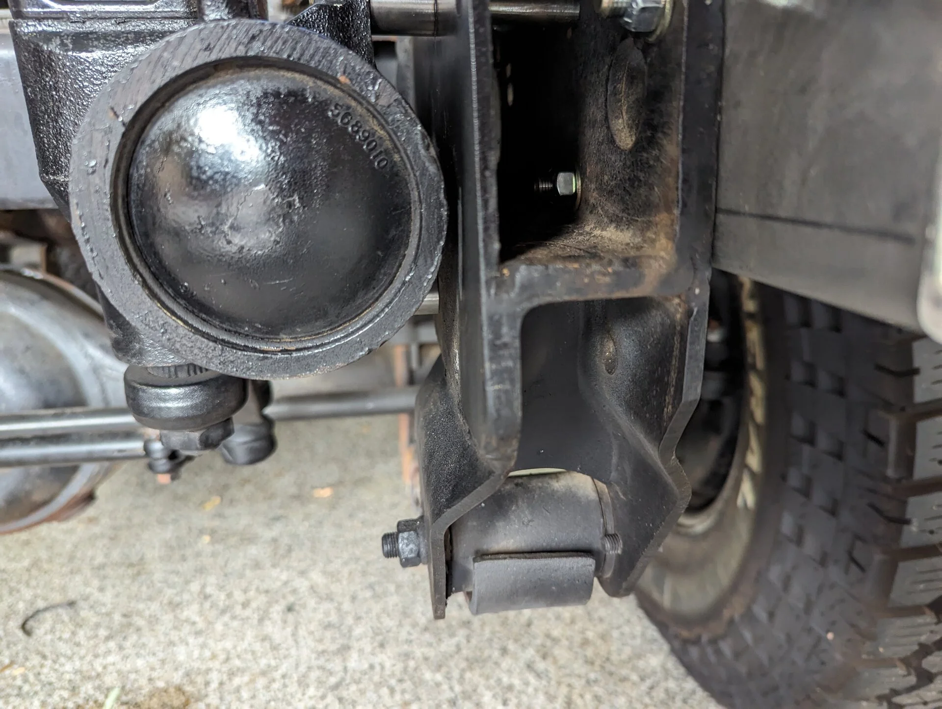

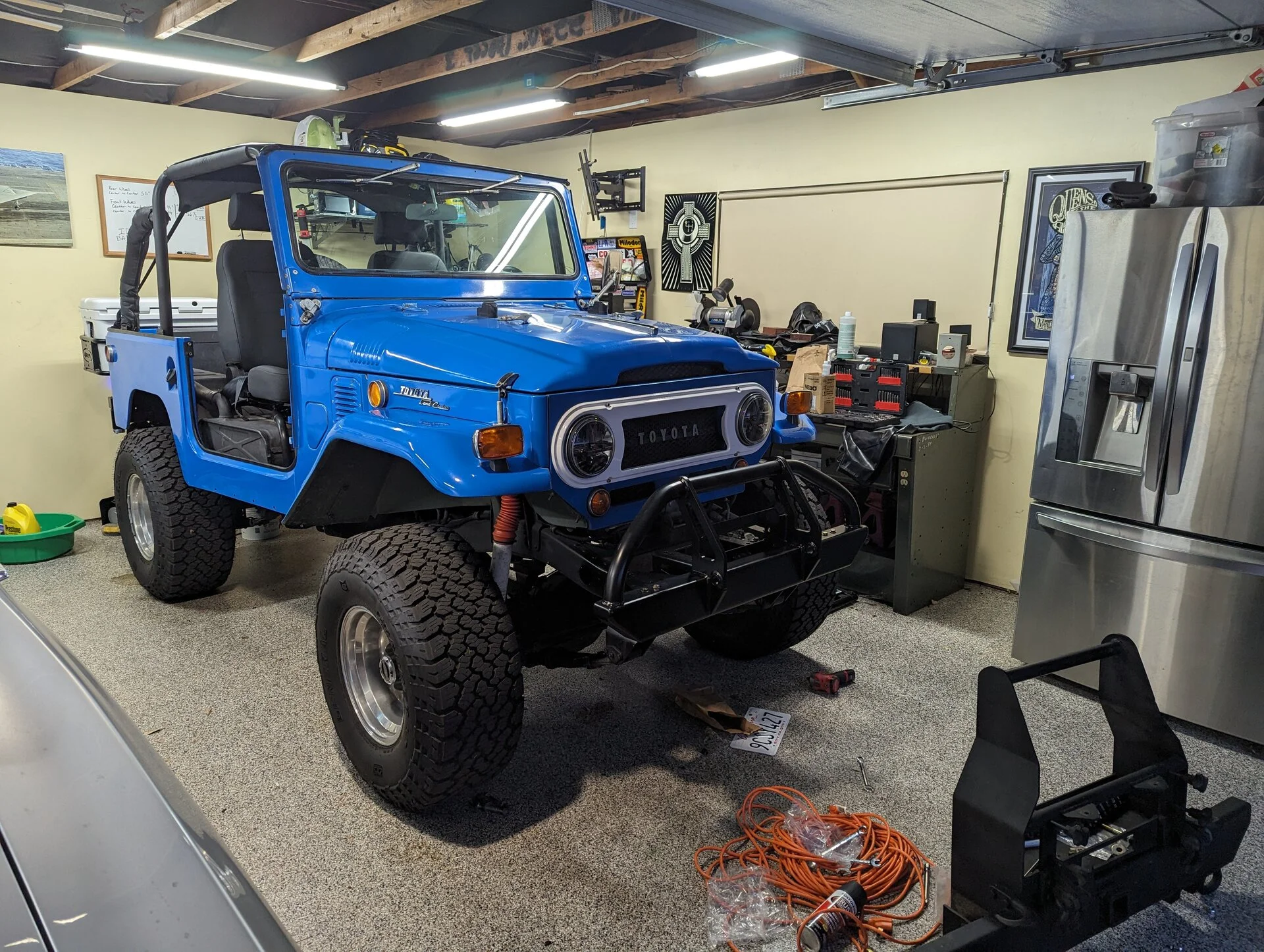

Got my front bumper from 4plus just before the holidays. Big thanks to 4plus and trailtailor (awesome frame mount brackets) for the quick shipping. Had to adjust my Saginaw Box a little to clear the winch tray but everything is bolted up. Starting to gather parts for H55F swap

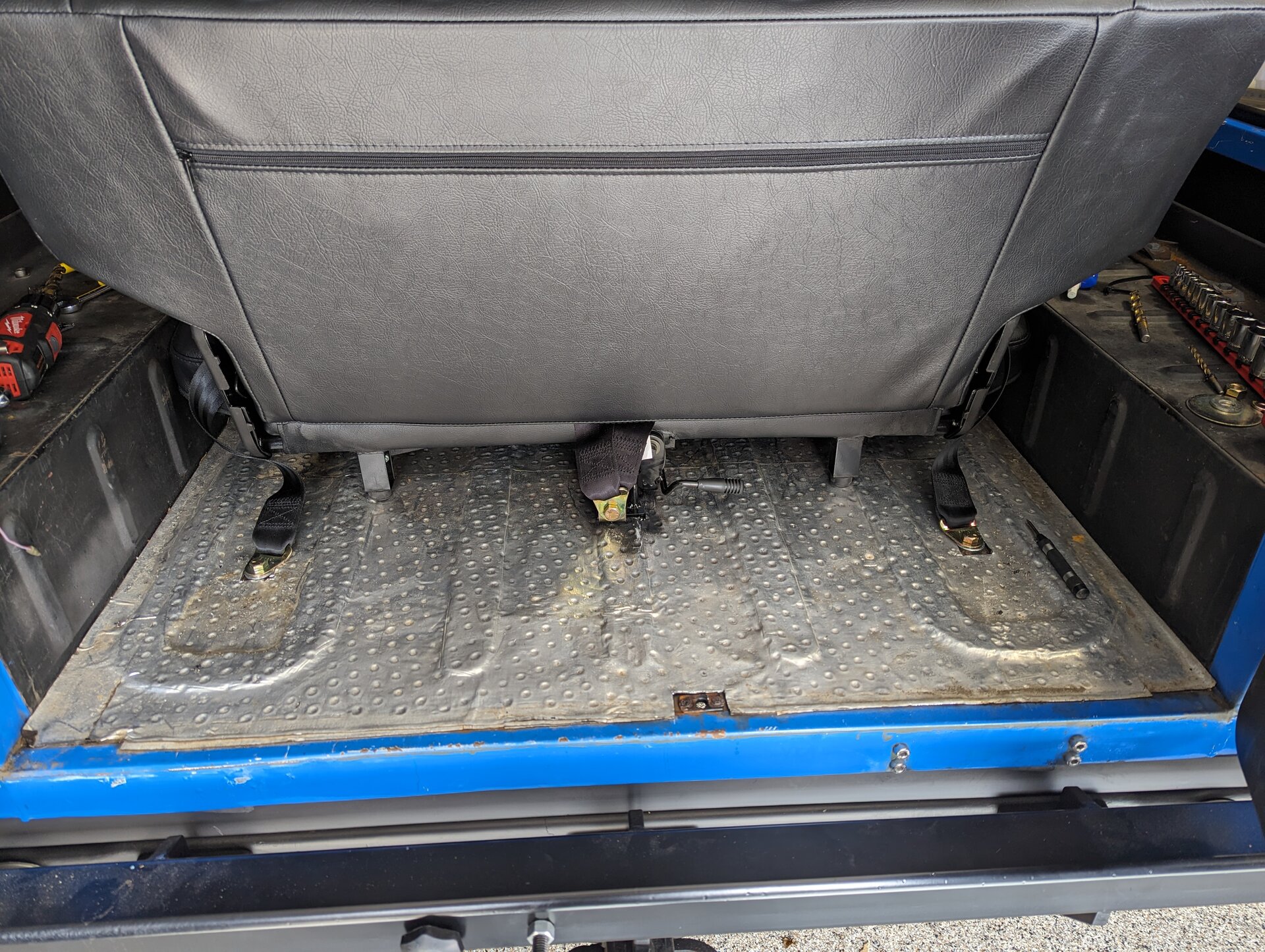

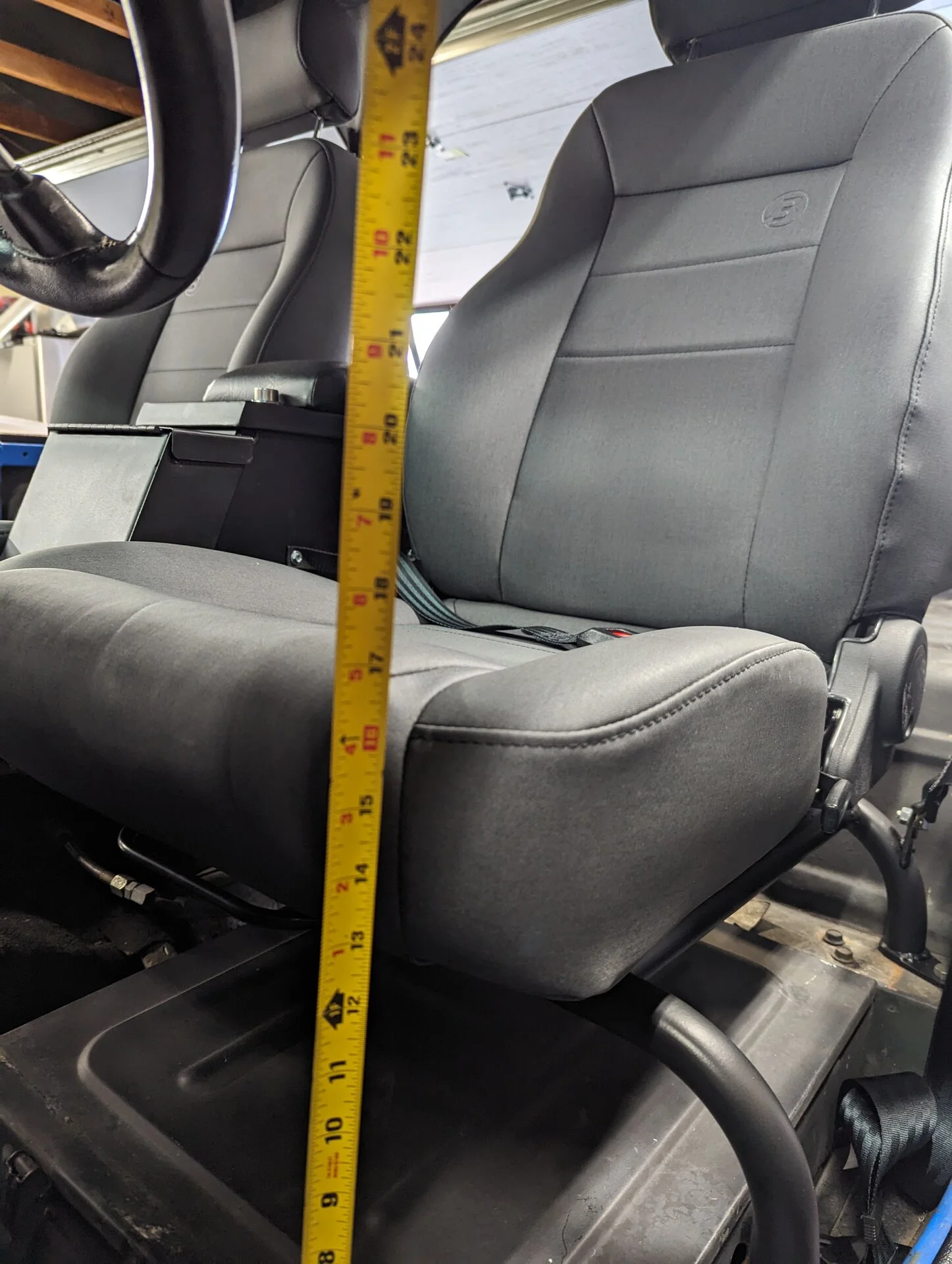

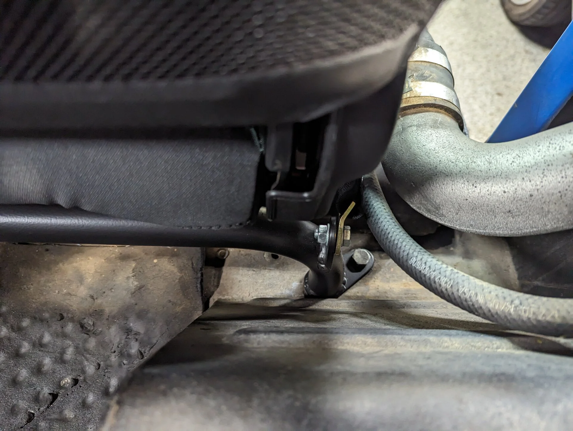

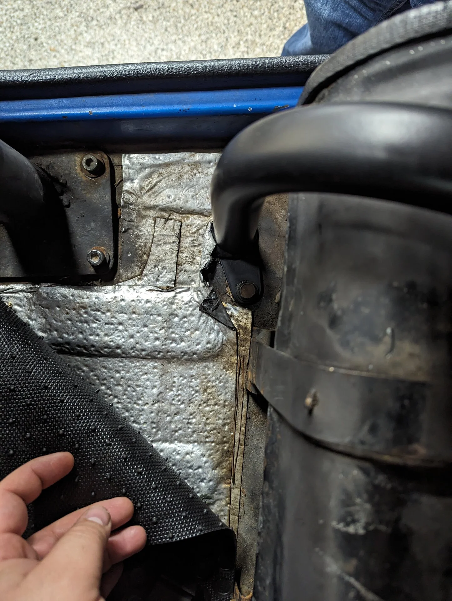

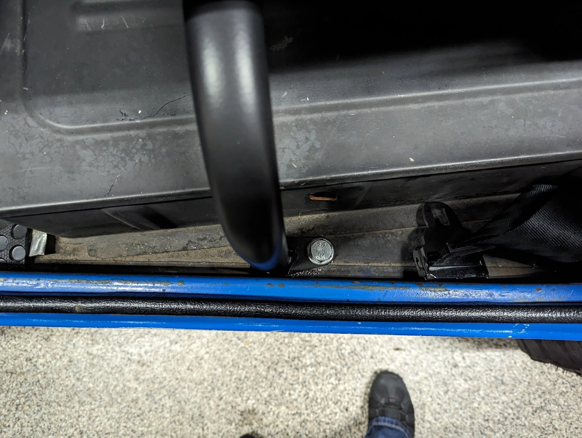

Do you have any more pictures of the seat mounts in the rear? I've been trying to mock mine up and don't want to lose the seat belt mounting nuts if possible.
Also how thick are the seats? My old seat mount (homemade) with generic universal seats was 2 ½ inches shorter and with that I was having trouble seeing through the top of my window.
My frames are as low as possible without hitting the tank. If I ever go to a rear tank I'd go back and cut the legs down about an inch or so for a slightly better view. I'm 5'9" and every once in awhile I feel like I'm looking at the top of the window frame.
Rear seats use the factory body mount bolt that's behind each front seat. I added the center latch/seatbelt mount and then added the two outer lap belt mounts farther back to clear the body brace under the rear pan. I only needed to use the brackets that were provided with the seat, I didn't make any new ones. For kids it's fine, if I thought I'd be hauling adults I would make new brackets and left it up a little ways. The rear seat is made for a jeep yj and I think they have a foot well that is deeper than what we have. Hope this helps
Sorry I wasn't very clear on seat. I am also using the cumminscruiser seat mount and am trying figure out the best way to mount the rear bar. It looks like you are over to one side. The front bar is limited because of the toolbox.
Post #7 is the only other picture I have of the build process. I had to have a local guy weld them up for me. It's using the factory frames bolt holes, so it's shifted to the drivers side

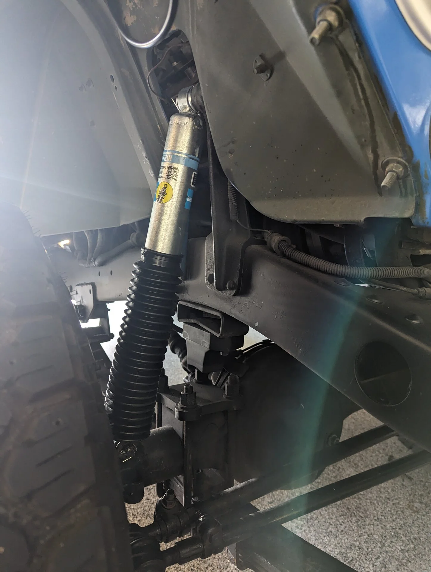

1 year of re-ownership down and I celebrated with some new bilstein's for the 40. It had some old ranchos from the 90's in there that had long since failed. I could compress all 4 with almost no effort. New shocks feel great, rig rides a lot better and a lot of the squeaking has died down.
