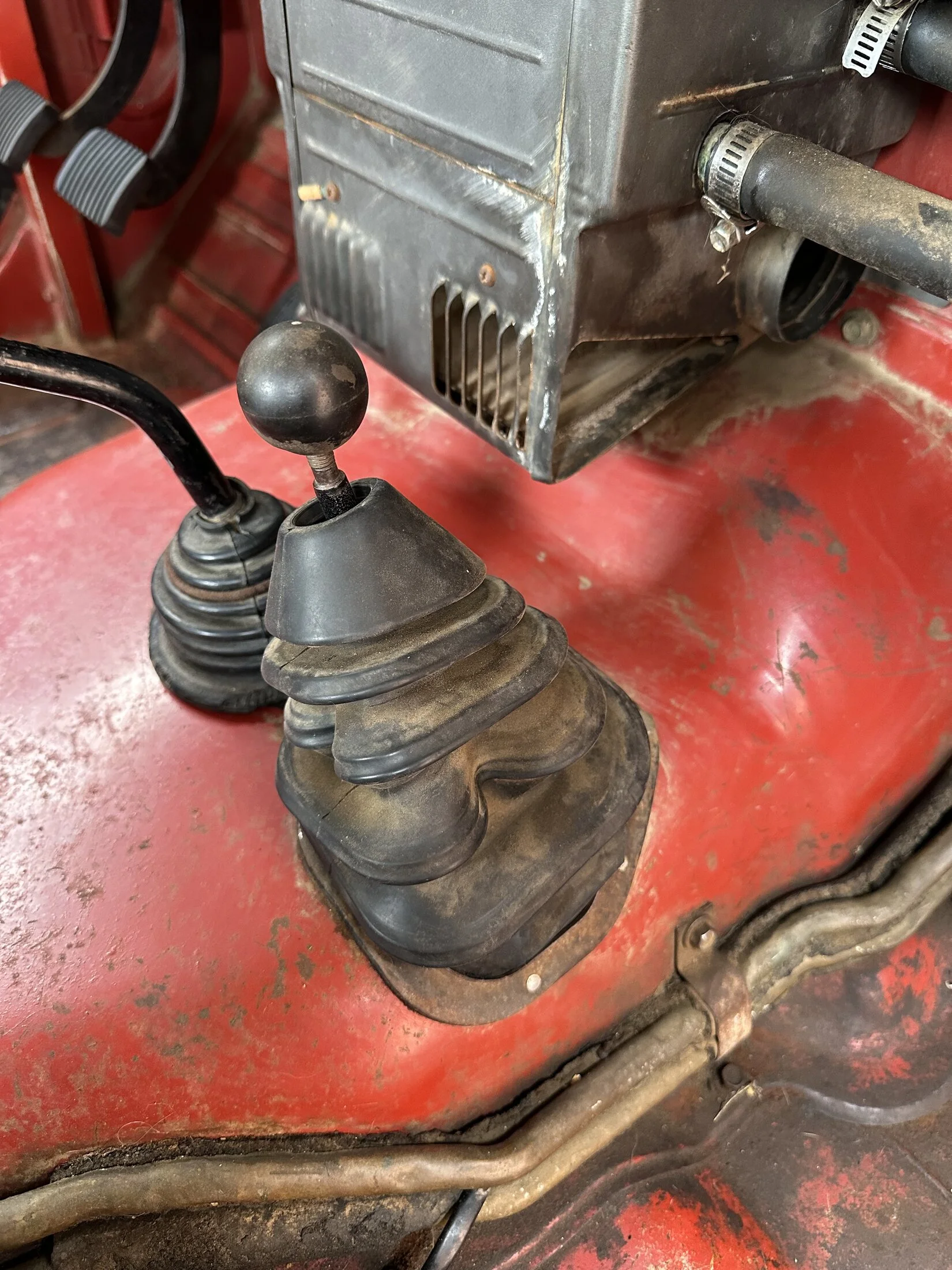

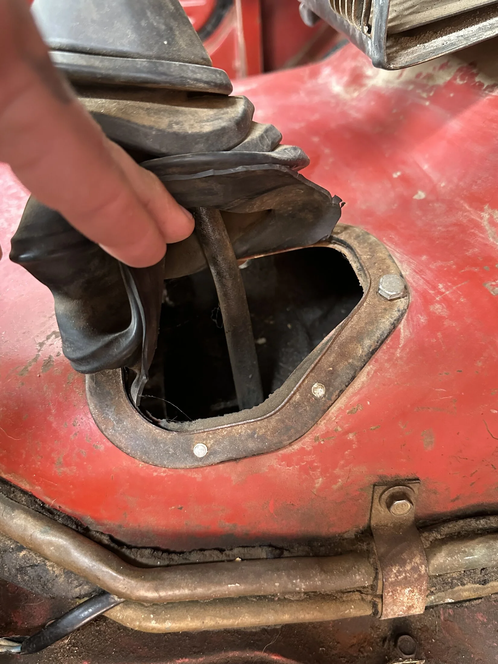

So I’ve learned that maybe the 3spd for the 73’ fj40 may not have had an inner boot for the transfer case. Curious if anyone has discovered an alternative lately. I see there’s some autozone type pieces that would need to be switched out yearly. Maybe there’s a more permanent piece someone has come across for the transfer case?
Around the 90's I took a piece of water proof tent floor canvas (used) and sewed it into a cone shape after folding over the top and putting in some paracord to tie it shut. Drilled out the pop rivets in that metal formed bands, removed the rotten failing rubber (like yours) placed my fabric cone in between the bands - adjusted the fit - poke holes for the new pop rivets and then for the mounting screws. Still works.

Very cool. I’ll go the diy route
the boot you have currently is not correct for a 73, looks like an early 60 series boot
I think it's either a mini truck boot or off a 70 series.

Could use an original transfer case boots and heavy piece rubber sandwiched between the boot and tunnel cover with an L pattern cut to match the shift pattern.
