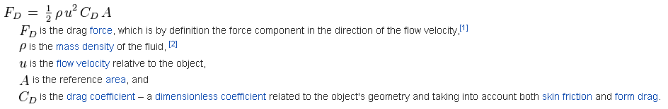

coax nailed it above. From Wikipedia "Drag Equation":
Mass density, Reference Area, and Drag Coefficient do not change for the case of driving down the highway.
Force of drag increases with the square of your velocity.
If you get really technical about it, you find that at low speeds, the velocity isn't really enough to cause appreciable drag. At higher speed, everything becomes limited by drag.
Now, if you multiply the Force of Drag from above by the speed of the vehicle, this will tell you how much horsepower is necessary at the wheels to maintain that speed. Throw in factors for driveline efficiency, transmission efficiency, and rolling resistance or the tires, and you can get a good idea of the vehicle's required power output from the engine.
To get REALLY detailed you can do some fancy calculus to include the accelerations of the vehicle speeding up and slowing down. Then you can use all this information to calculate the rate of gasoline mass flow from the injectors.
Then when you're done with that they give you a diploma and you never do calculations like that again.
