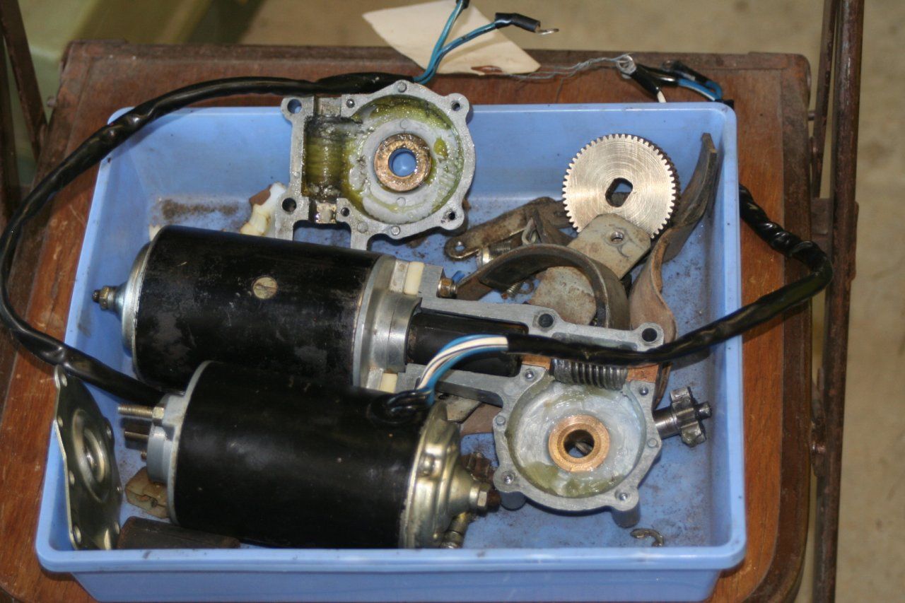

After spending way too much time on this, I've got a tailgate window working without a lot of gear noise. I played with three different motors, but only had the one brass gear ready, I'll need to machine the new one down later. One of the motors ran noticeably slower on the down stroke and this was without the window installed. The last thing I tried was different grease and that worked. I was using Super Lube originally and switched to a German silicone based grease made for bearings, etc. It is a heavier grease than the Super Lube. It seems like the white Lithium base grease, that was in all the gears, tends to harden over time. Hopefully this new grease holds up and doesn't get hard.
I also hooked up the little lever that stops the tailgate handle from working with the window up. It's really the only lock on the tailgate. I don't have the safety switch in, but wanted some way of stopping someone from just opening the gate. Not sure if it's the exact way it came from the factory, but it works!
I am having a hard time trying to get the motor out. Does it all come out? I need to get the window down so I can get the rear door open. Any hints? Any help out there would be great!
Mookkidzz,
If you haven't read this thread already try it, might help...Rear window article available from Gary S
Does the window motor run or just a click? If clicking, could be a bad ground. To answer one if your problems, yes everything has to come out in order to get to the motor. The two little clips hold the arms to the window track, they slide off, then you can wiggle the arms and motor out of the cavity, after disconnecting all wires and rods.
Good luck with it and don't forget the bandaids! :)

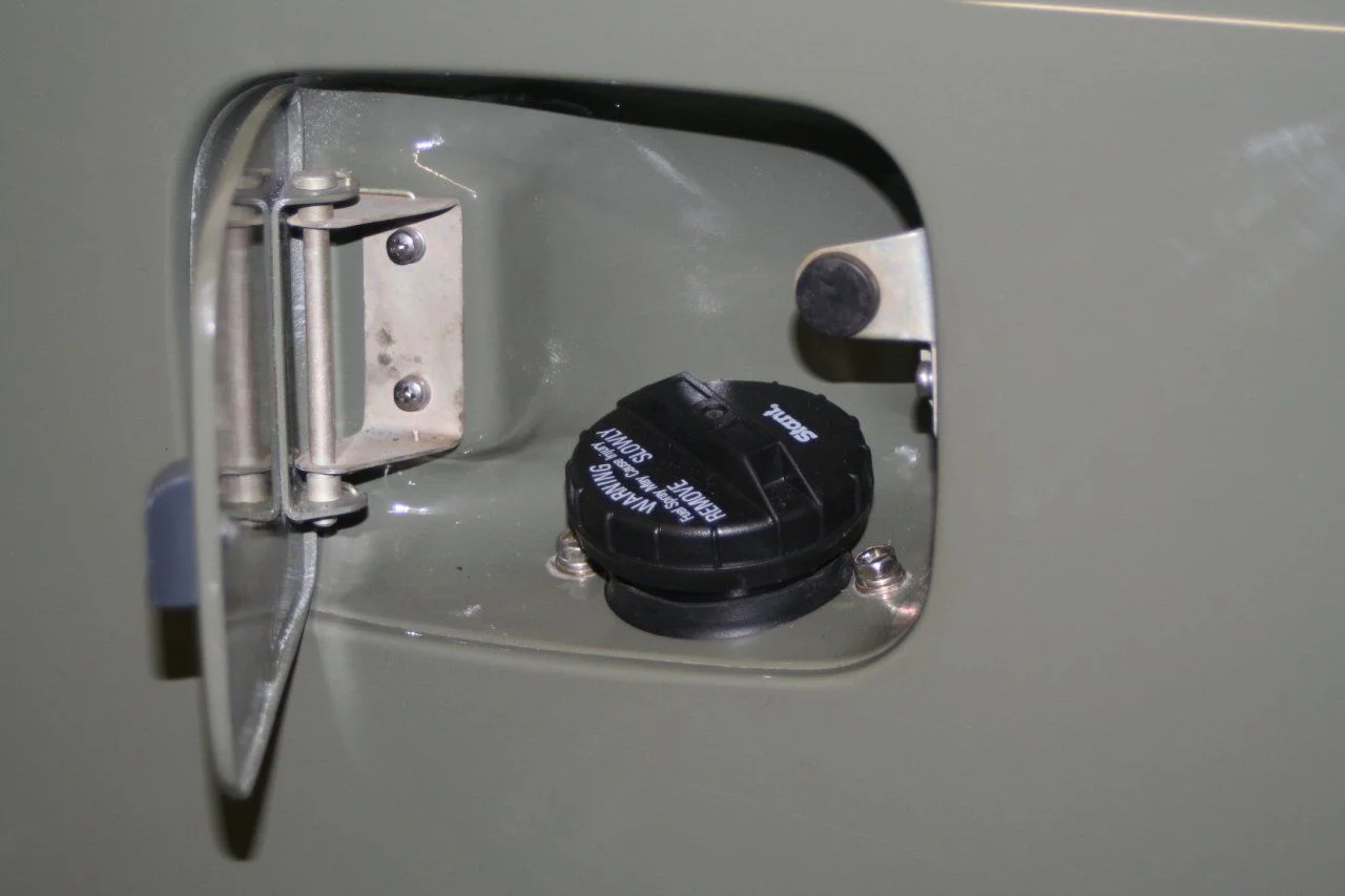

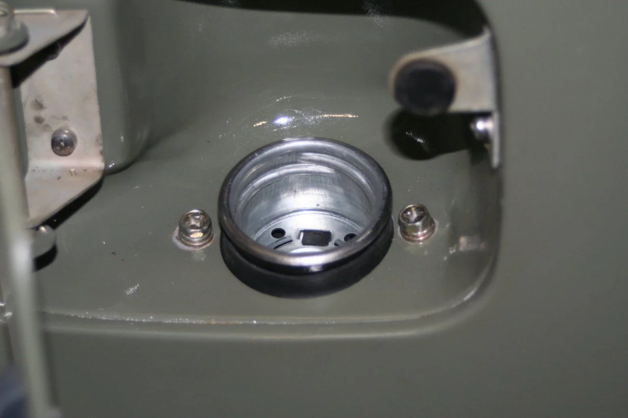

I've been wanting to change my filler neck to a modern screw in type cap in order to stop fuel leaking out the old cap. I bought a 2" cab chassis filler neck and modified it to work on the 55. I had to cut and reweld the mounting ring at the right angle with welded 6mm nuts, a little bit of work, but in the end everything worked good.
Here's the final product..
My tank has only one overfill inlet, so the new neck works out good. Hopefully that stops fuel leaking out the cap when full.
