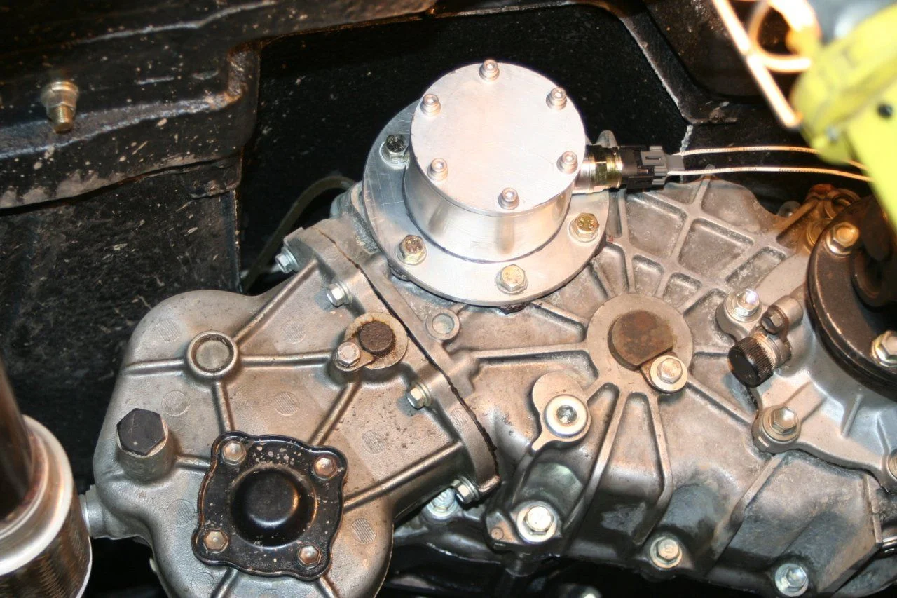

Had to part ways with Ruff Stuff today, hired them to build an FF axle for me, but after two months and no progress I called Diamond Axles. They are picking up the ball and getting me the axle. I want a direct replacement for the FJ60 axle width wise and be a Full Float with disc brakes and a E brake included. It will be all Toyota parts with RVC shafts. Moving forward I got a VSS from Jags That Run and got it mounted, need to wire it up. I'm not sure which pin it is , but I'll leave that up to the computer tuner guy.

VSS=vehicle speed sensor. It tells the computer how fast it's going. better fuel economy and when the a/c is running, keeps the motor from dying at idle. That was a simplified explanation, but the best I got. :)

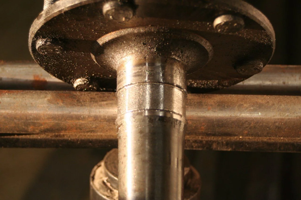

While waiting for my FF Diamond axle to be built, I took the SF axle apart. Ever since I got a case of stretchy nuts, the rear axle has been making noise. I found one of the problems today. These are Poly Performance axles and I don't know the chain of events that led to this failure, but here it is. I'm going to take the pumpkin to a pro to check everything and replace what's bad.
