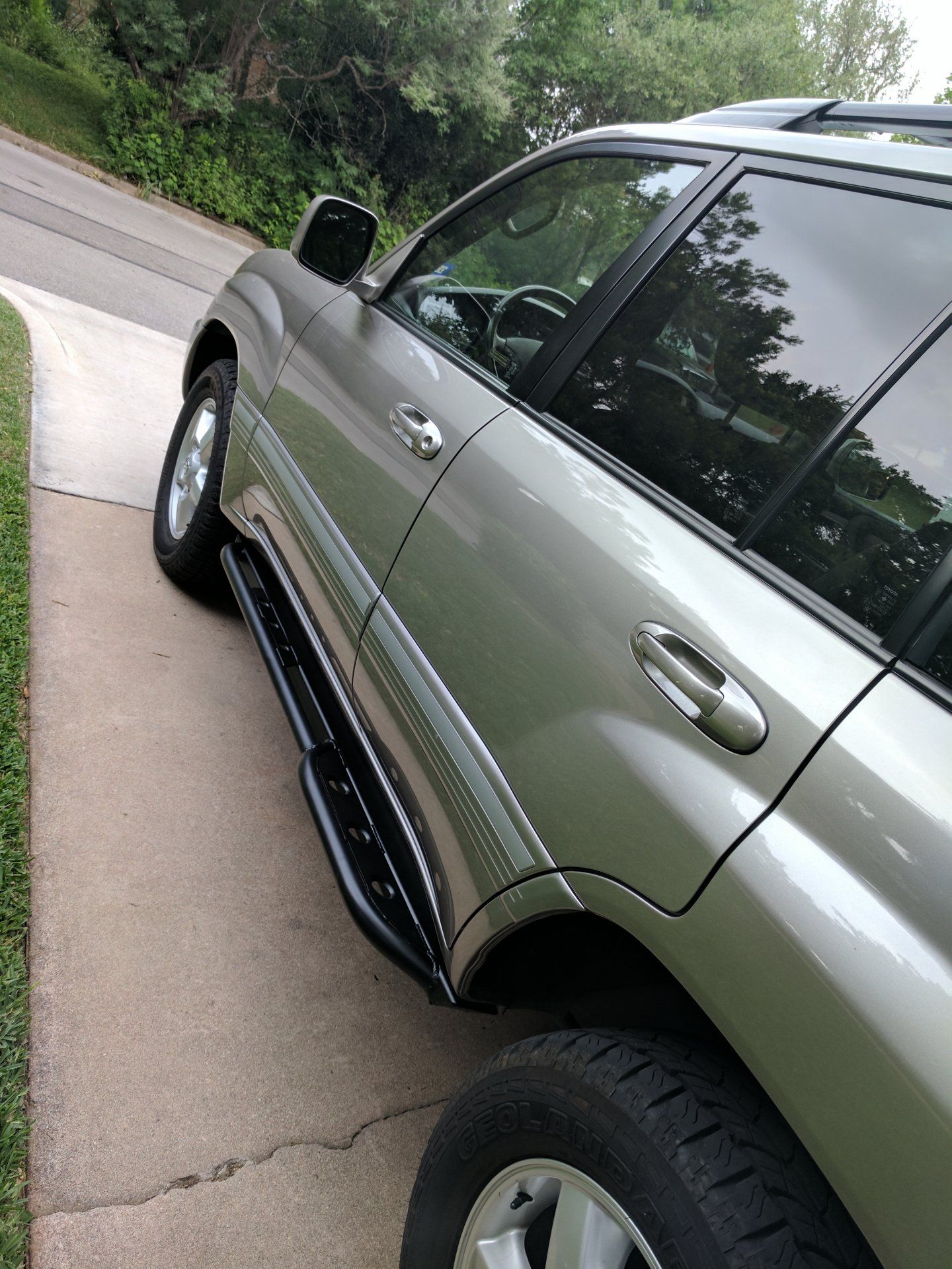

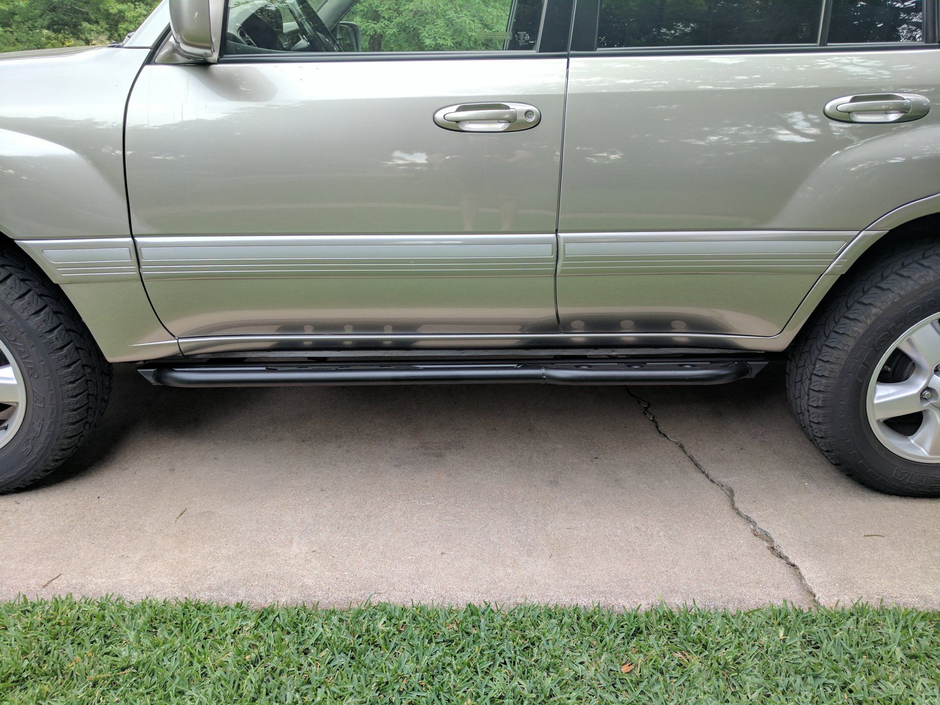

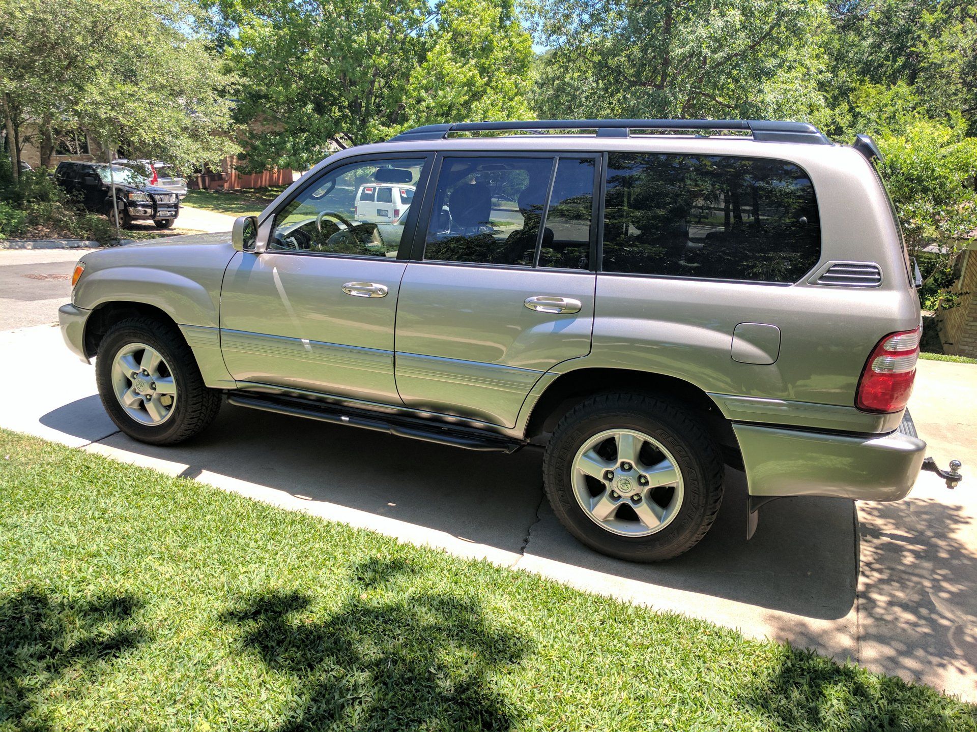

Nice! Pretty happy with the OPORs? I'm in Austin as well and looking at the Slee and White Knuckle.
Thanks, if you want to see them in person, pm me. Also, if you need help installing what ever you get, let me know.

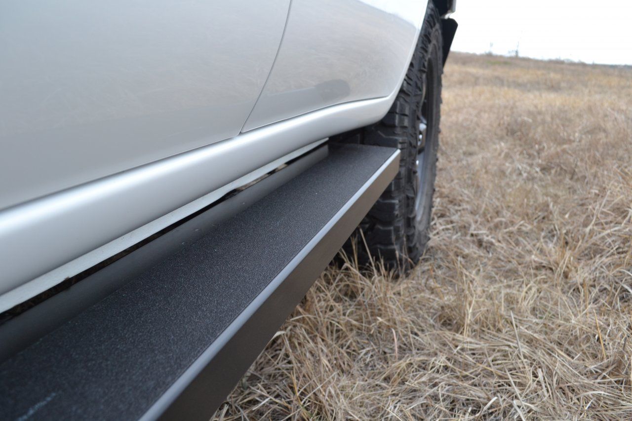

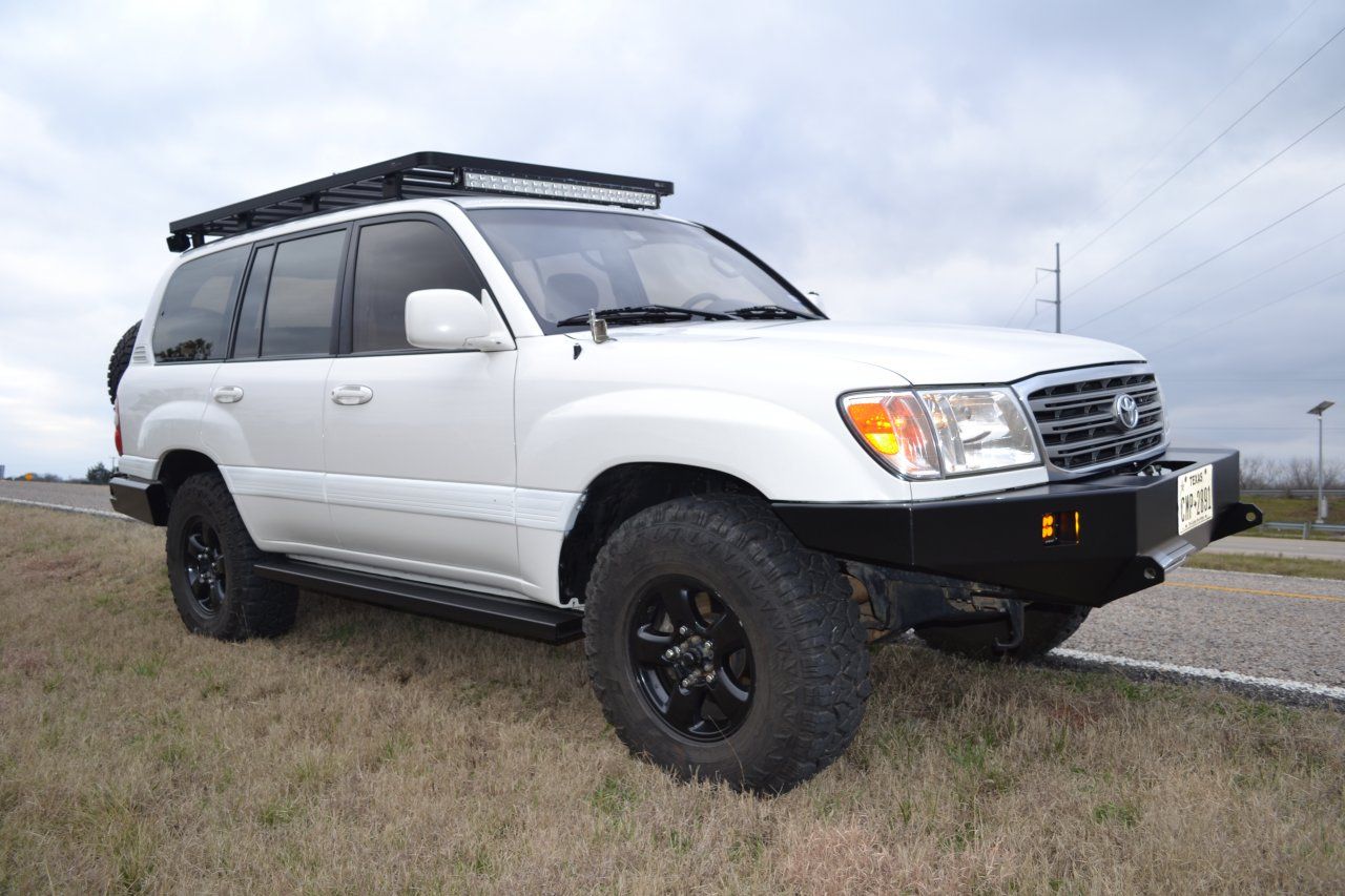

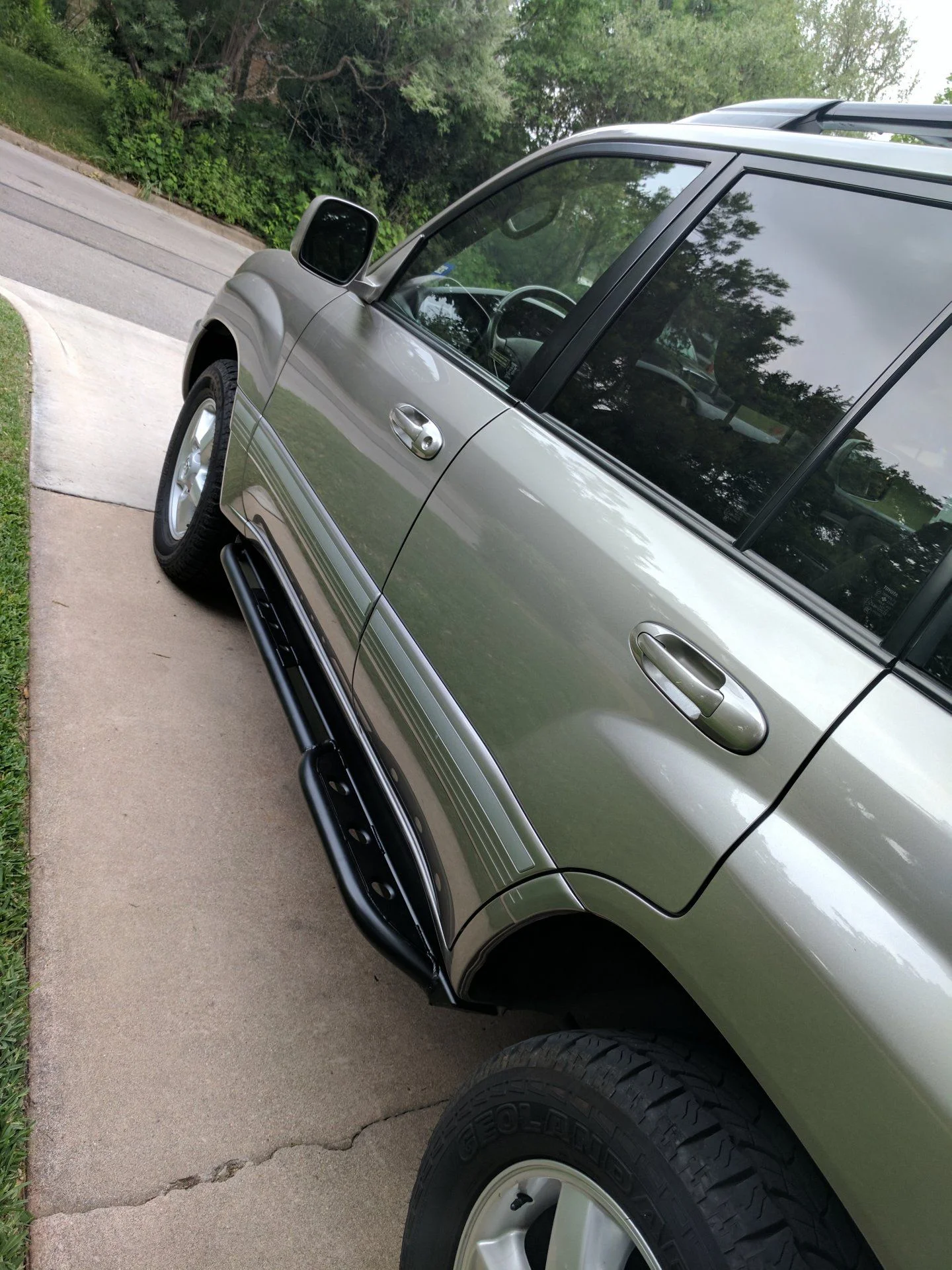

Here's a couple photos of some I had made locally. Pretty happy with them, I sort of wish they were tighter to the body but that would = less protection. They're sprayed with self etching primer then a aerosol bed liner so I can easily touch them up as they get mangled.

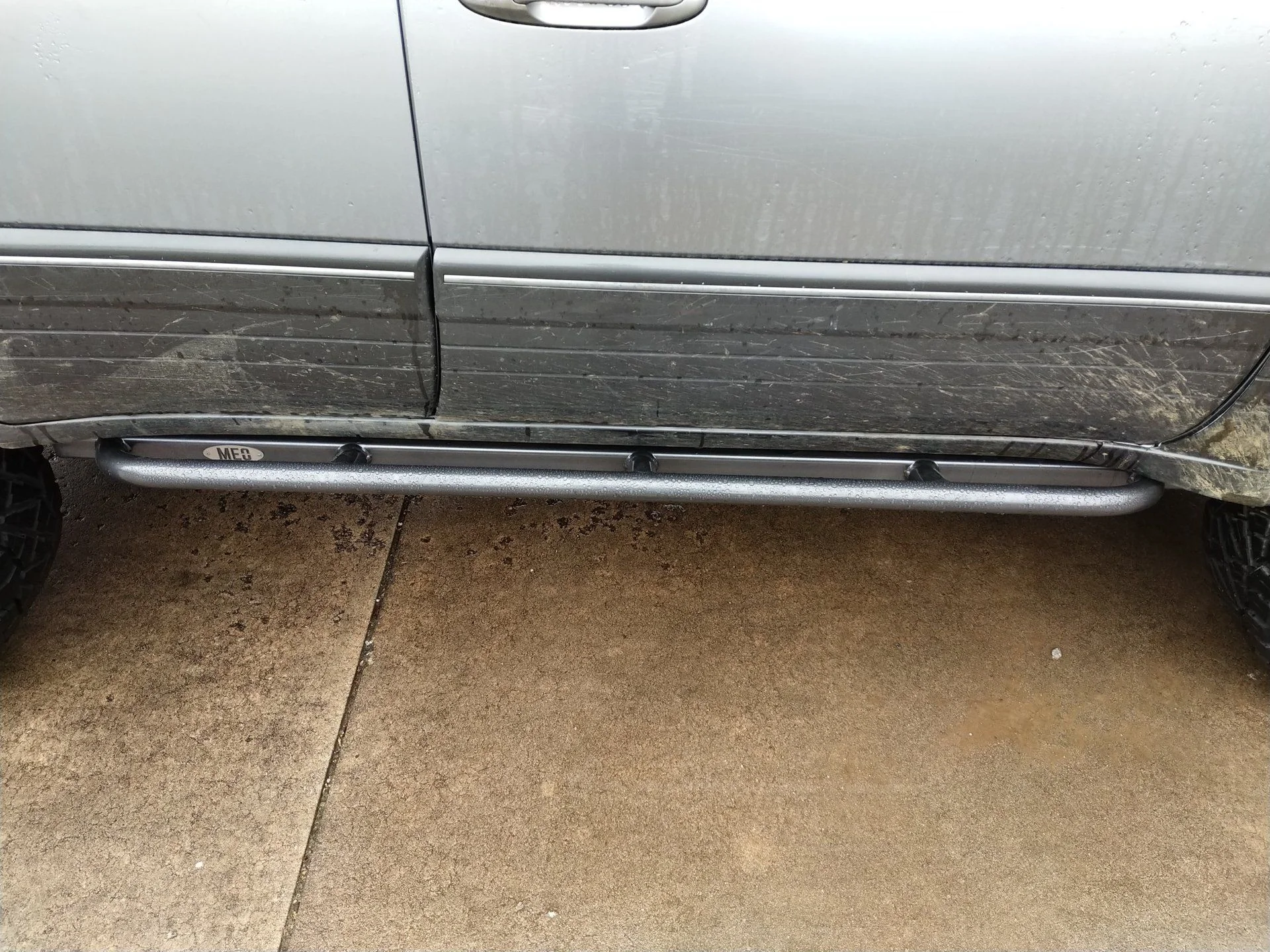

@Oklahomeboy did you ever decide? I went with MEO sliders and have been happy with them so far. Yes they are welded on, and I feel MEO is part of the community as they are mostly Toyota centered. They are welded on but I can't seem to find a reason they'd need to come off.

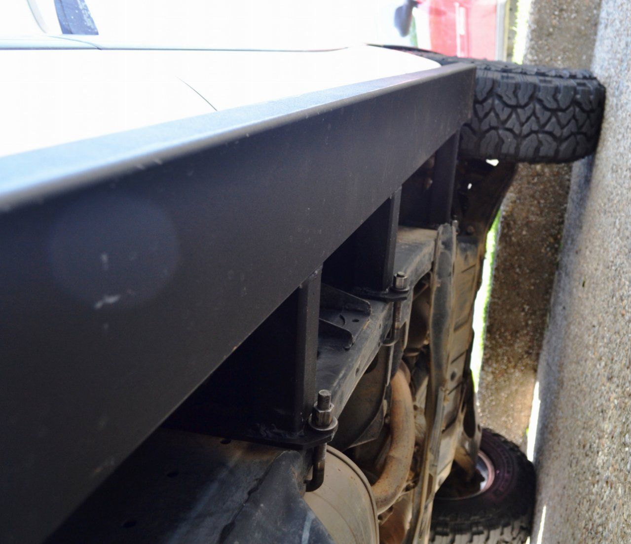

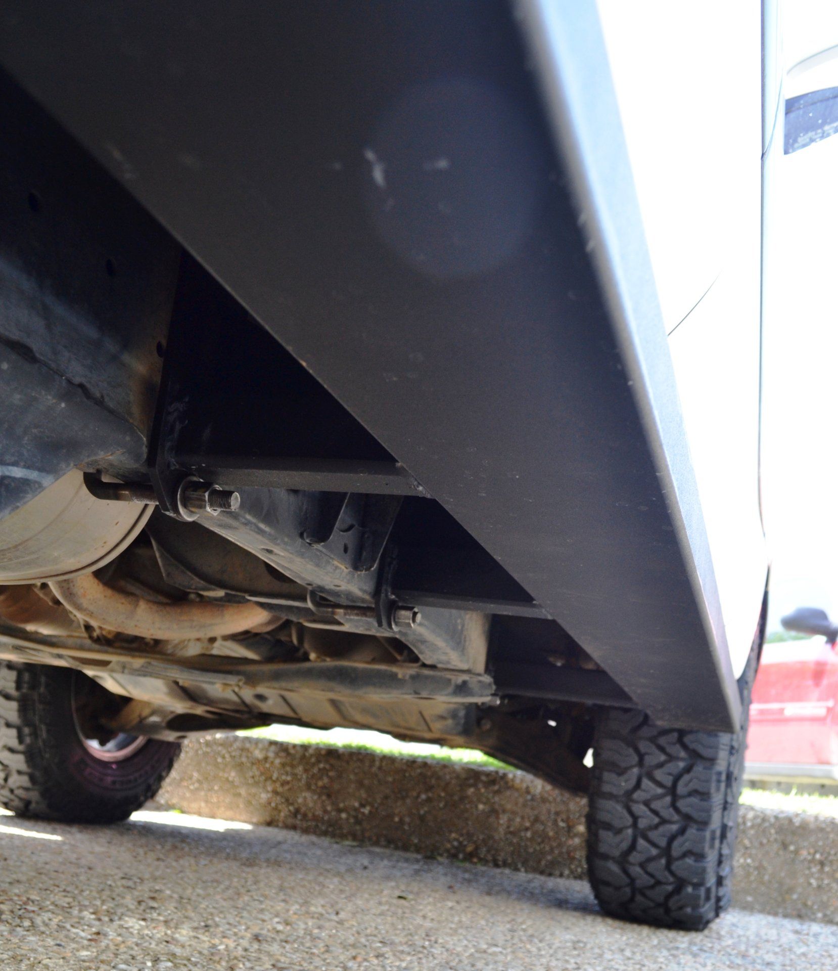

I am seriously thinking to go that route but want to find U bolts or U bracket to attach to the frame and not weld.
Hi, where did you purchase those U bolts from? Do you know the dimensions by any chance?
Not sure what the demensions are off the top of my head. I can get some measurements. Just like a U-bolt on an axle or trailer. I had these bent to my specifications by some place in the DFW area. I can t recall who at the moment. They came with fine threads and extra long nuts and washers. The main thing I had to consider was that the frame rail is different thickness in the front than the rear. So I took the thickest measurement and had them made the same.
This is already helping as did not even think frame rail thickness would be different. Thank you.
I had a minute to search the web for U-bolt suppliers in California. There are plenty of options. So many I was a little surprised. There could even be one in your area... The adage applies measure twice cut once but measure a few more times and mark the frame rail with some soap stone where the legs of the slider will sit as not to interfere with other things under the vehicle (back side of frame).
