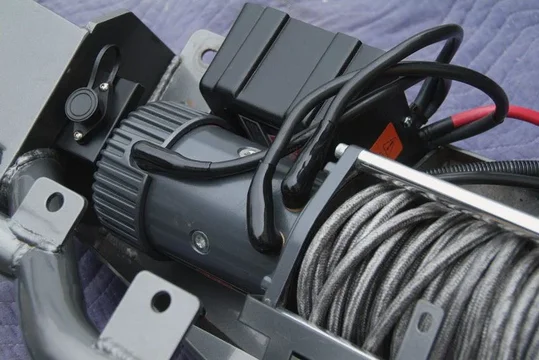

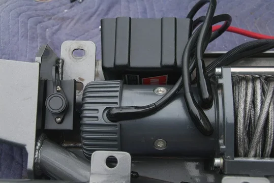

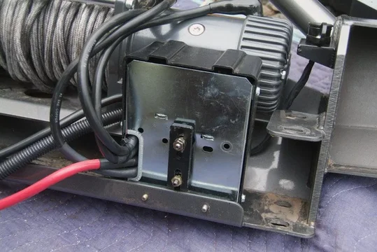

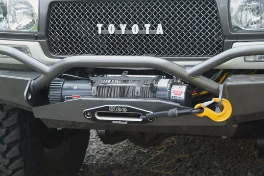

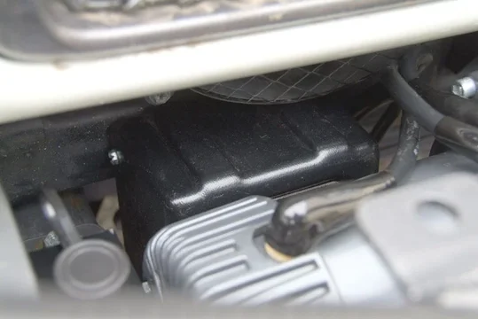

Decided to move the winch solenoid to a new spot on the Slee Short Bus bumper to make room for another Rigid Industries LED light. The spot behind the winch is exactly the right size for the solenoids with zero room to spare. The JDM aux fan is just above it but does not touch, the bumper braces are welded in just the right spots to make it work, and the frame is just far enough back for it all to fit. The bumper was drilled and tapped for bolts.
Ignore the wire...haven't cleaned that up yet.

14" Rigid in the flood pattern :grinpimp:
