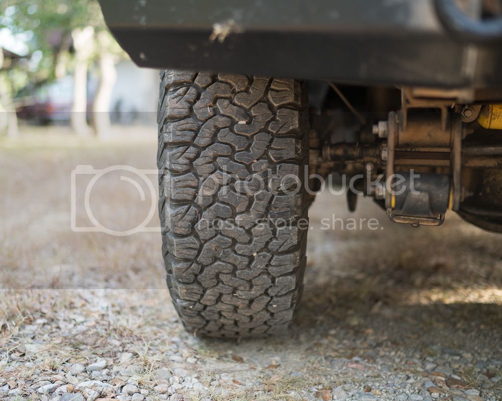

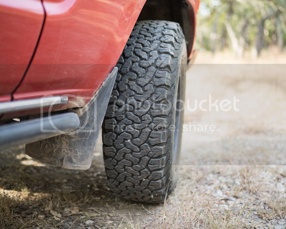

@theron do those 34" KO2's measure pretty true to size? I know most BFG's run a lot smaller than advertised.
They have a nice chart that lists tire size and real world measurements. The 34x10.5 measure out as 33.5x10.6 on 17x8.5 rims:
All-Terrain T/A KO2 | BFGoodrich Tires
For comparison the closest Duratrac is 285/70 r17 and it comes in at 33x11.5...so the BFG is a special tire these days if you want something "narrow", D+ load range, but still ~33"
https://www.goodyear.com/en-US/tires/wrangler-duratrac/sizes-specs
