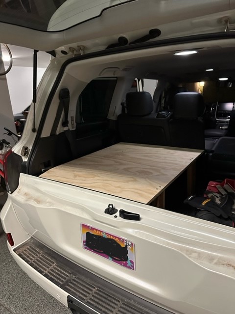

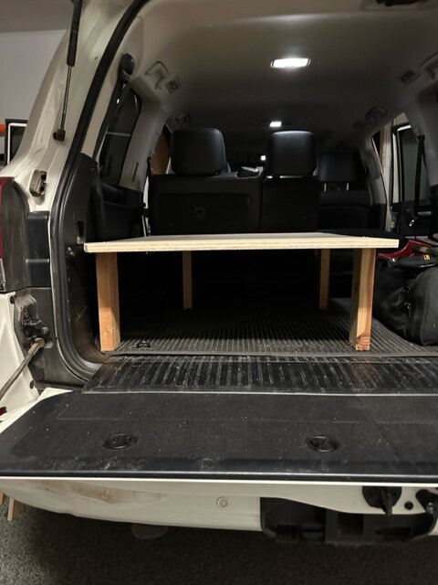

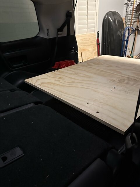

I started by creating two different platforms. One would be on legs and fit behind an upright second row (with 2x4's supporting it) and the other one would lay on top of the second row. I wanted to make sure that the second row could recline a little bit so it would be comfortable in the second row for a long drive. The rear platform is 2'8" wide and 3'6" long. I wanted it to be over the 60 portion of the 60/40 split seat and pushed as far up against the side of the cargo area as possible. This creates a couple issues. First is that the rear of the cargo areas notches inward, so you have to make a notch in the rear portion. Second is that the wheel well cuts into the cargo area as well--I built the platform over the wheel well, but the 2x4 supporting it had to moved inward to avoid the wheel well. This allows for storage underneath which was one of the goals.

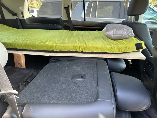

It took a little bit of trial and error to get the second platform to work. I went with the same 2'8" width and a 2'6" long platform. I'm 6'2" so wanted as much length to the platform as I could get while still fitting in the front seat. This dimension did require me to move the front seat forward a little bit, but there was still enough room to get into the cab.

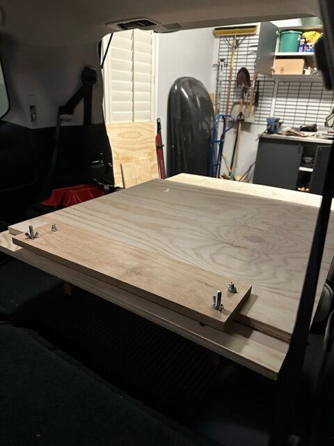

To make the overall platform level, I needed to adjust the eight of the 2x4's supporting the platform in the cargo area so that they would be level with the top of the folded down second row. The rear cargo area also dips down when you get close to the back of the second row. I opted to move the 2x4 supports back a little so that they were on the level part of the cargo floor just to the rear of where the floor dips down. Below is a photo over the rear portion with the second row seats folded down.

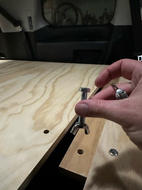

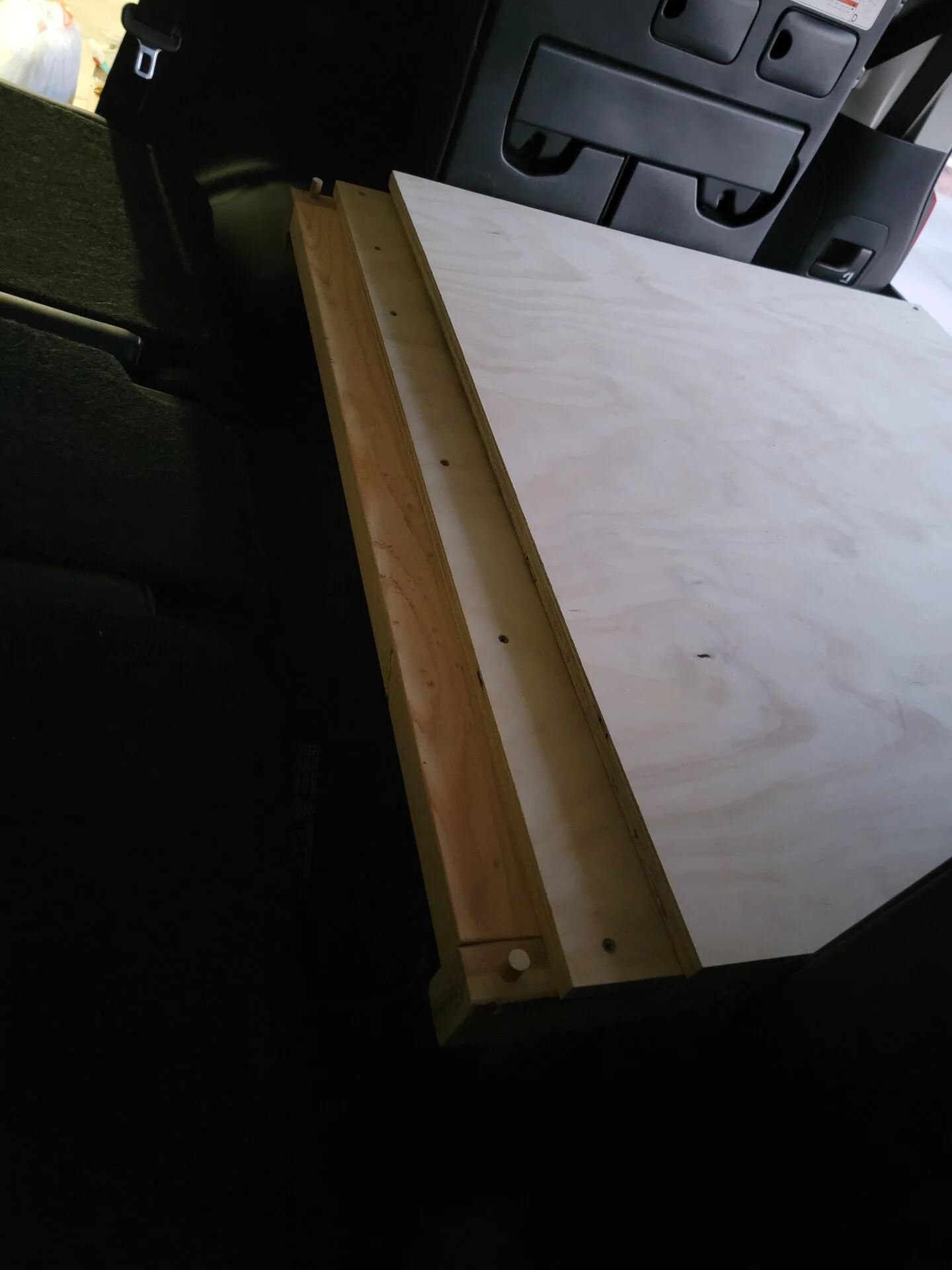

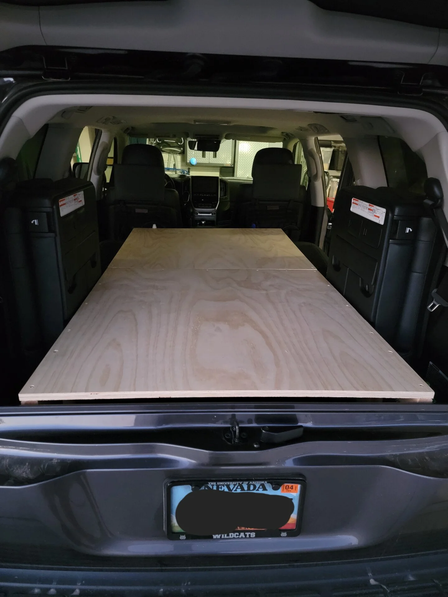

I wanted something that would keep the two portions of the platform attached to each other, so I decided to attach them with a 1x4 strip that would be bolted into each portion of the platform. I also didn't want to have to get tools out assemble it while on the road. First I bolted the 1x4 onto the portion that lays on the second row seats. Then I drilled holes in the 1x4 and the rear platform where I could insert bolts and put wing nuts on it to make is secure.

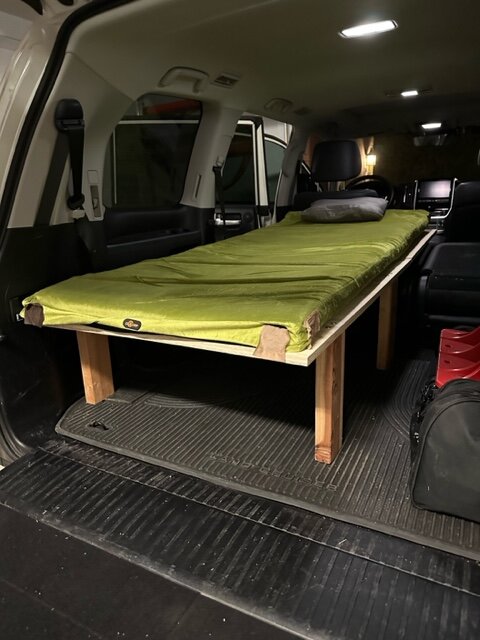

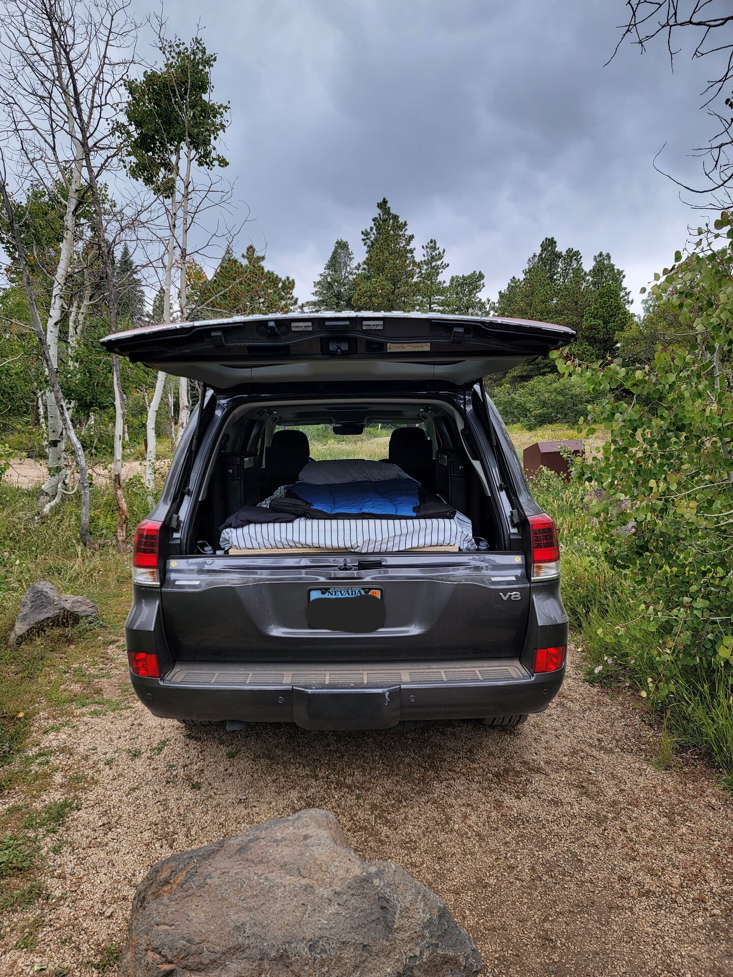

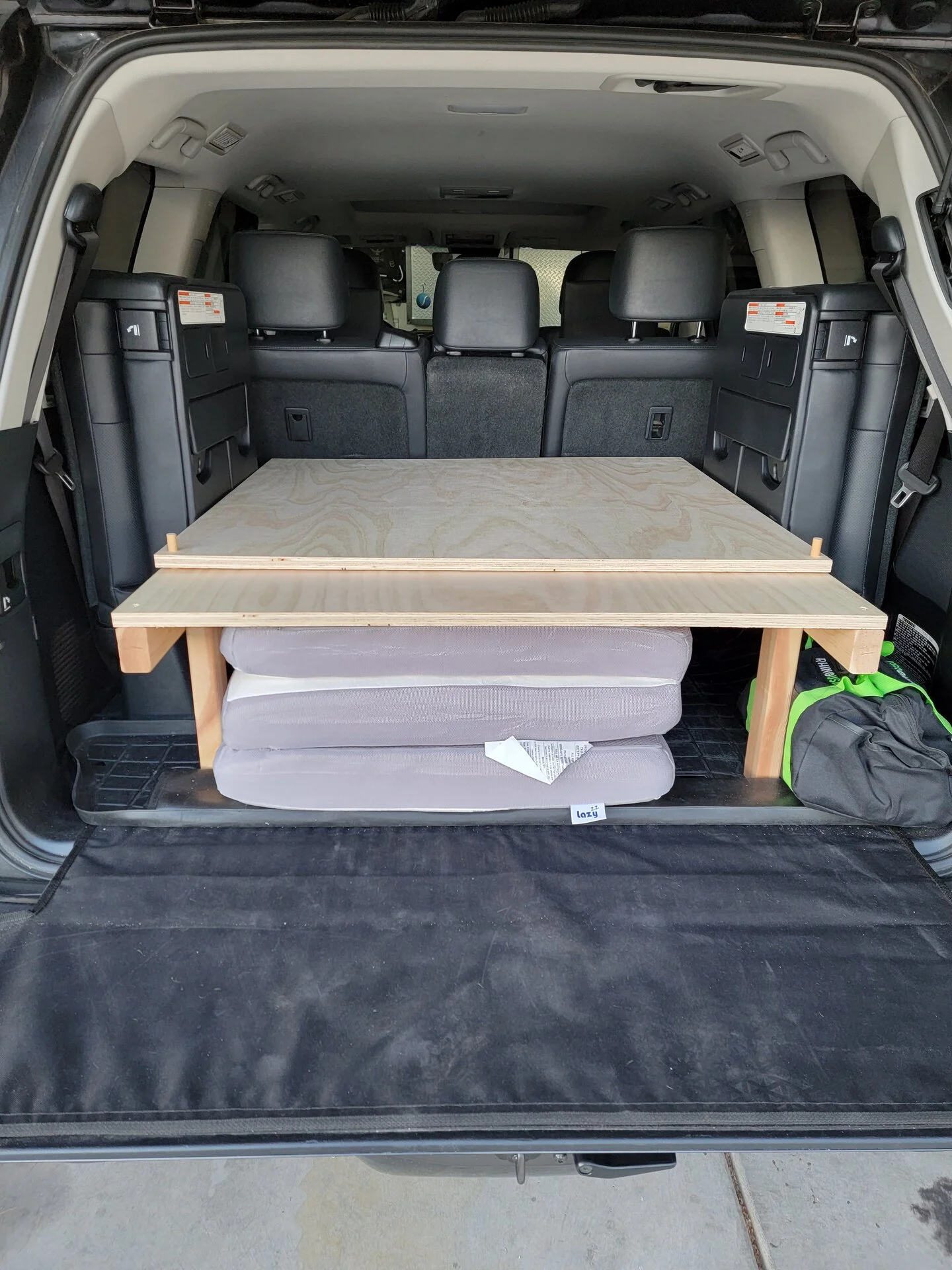

Once assembled, I put a memory foam mattress on top of it. I picked this up on Amazon--it was $117 when I bought it, looks like the price has gone up since then. It came with the pillow shown in the photo. Beware that the mattress is pretty big, even when rolled up. It did fit underneath the rear platform.
Amazon product ASIN B0BQ2QVW1C
I was worried about whether I would feel the top of the bolts when laying on it, but it wasn't an issue at all.
With the second row up, I had to find a place to put the front portion for the drive out and back. Ended up just flipping it upside down and putting it on top of the rear platform. It would move around a bit with nothing on it, but once things are packed on top of the it there's no movement.

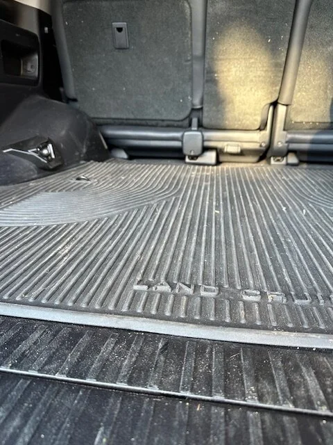

How tall are those legs in the cargo area?
They are 11 3/4", but I do have them sitting on top of a rubber cargo mat. When I removed the 3rd row seats I bought a Heritage Edition cargo mat which is what it sits on top of. If you aren't using a rear mat, you'd want to make them a little longer. Here is a photo of the mat for reference.
