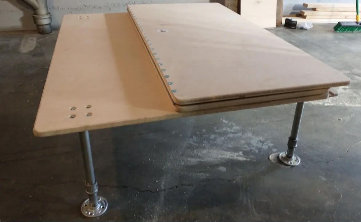

I have a very simply DIY platform in the back of LC that I built after removing the 3rd row seats. For day to day driving, it doesn't really move around or shift at all, but I'd like a more secure way of tying it down.
I normally keep my golf clubs / push cart under the platform, and the top is just used to hold whatever (groceries, packages, etc), but I will swap out tools / camping gear in the instances where we're camping.
For those of you who have done something similar, how did you secure your platform?
Photos of what you did would be great if you've got them!

I need to construct a similar sleeping platform before next spring. Appreciate the pic for inspiration.
I mounted a piece of plywood to the floor using the leftover mount holes from the seats. It basically created a new subfloor and I trimmed it to the follow the shape of floor and trim. Then I cut holes above the mounting holes which allowed me to bolt the plywood to the floor. One bolt and washer at each corner, basically. Use cardboard to mock up your plywood.
Then I attached my platform to that board permanently (my legs are wood). I can remove the whole setup by removing the 4 bolts, which takes about 5 minutes.
Not sure if it will help but see my thread on a simple platform.
