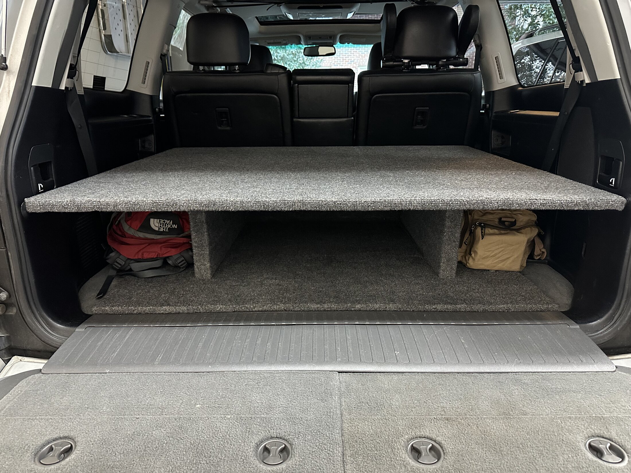

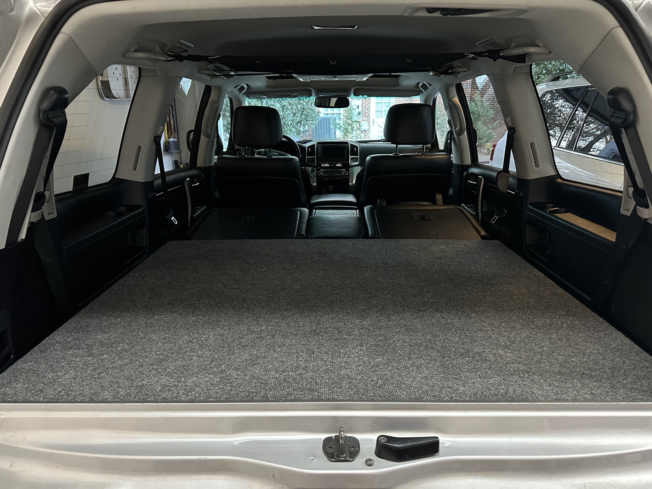

Here is my simple platform. I used a 1/2” sheet of oak to make a subfloor, bolted into the 4 existing holes in the floor. I cut the edges to shape along the trim.
Then I used 2x12” to make the legs and rear support, so it’s a 3-sided box approx 25x25”.
Then I cut another sheet on top, approx 50x41” and mounted that on top.
It’s covered in basic carpet.
It removes as one piece by the 4 bolts.
I throw bags, bins and valuables underneath. I stack more on top, including the heavy stuff. It aligns well with the 2nd row seats folded down, so I can throw a pad/mattress on top for sleeping.
It’s simple but has served me well for 10 years.
