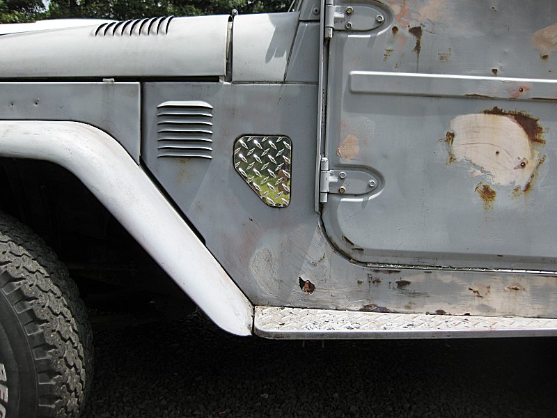

i've always gone pick'n'pull hunting for hood vents to help with these issues. I always use hood vents from late 80s/early 90s trans ams. The are super easy to put in and very functional. you can also always find them for about 2 bucks a pair. you could always use a pair of 40 series kickout vents ( or whatever they are called) that are used to bring outside air into the cabin from the side and just flip them and open them when you need to exhaust additional heat. they're diamond plated in this picture, but you get the picture.
you could probably even build a cabling system to open them from inside the cab.
