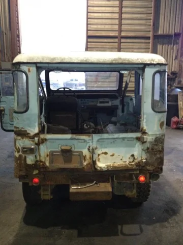

What mine looked like when I bought the rig.....
What it looks like now........
