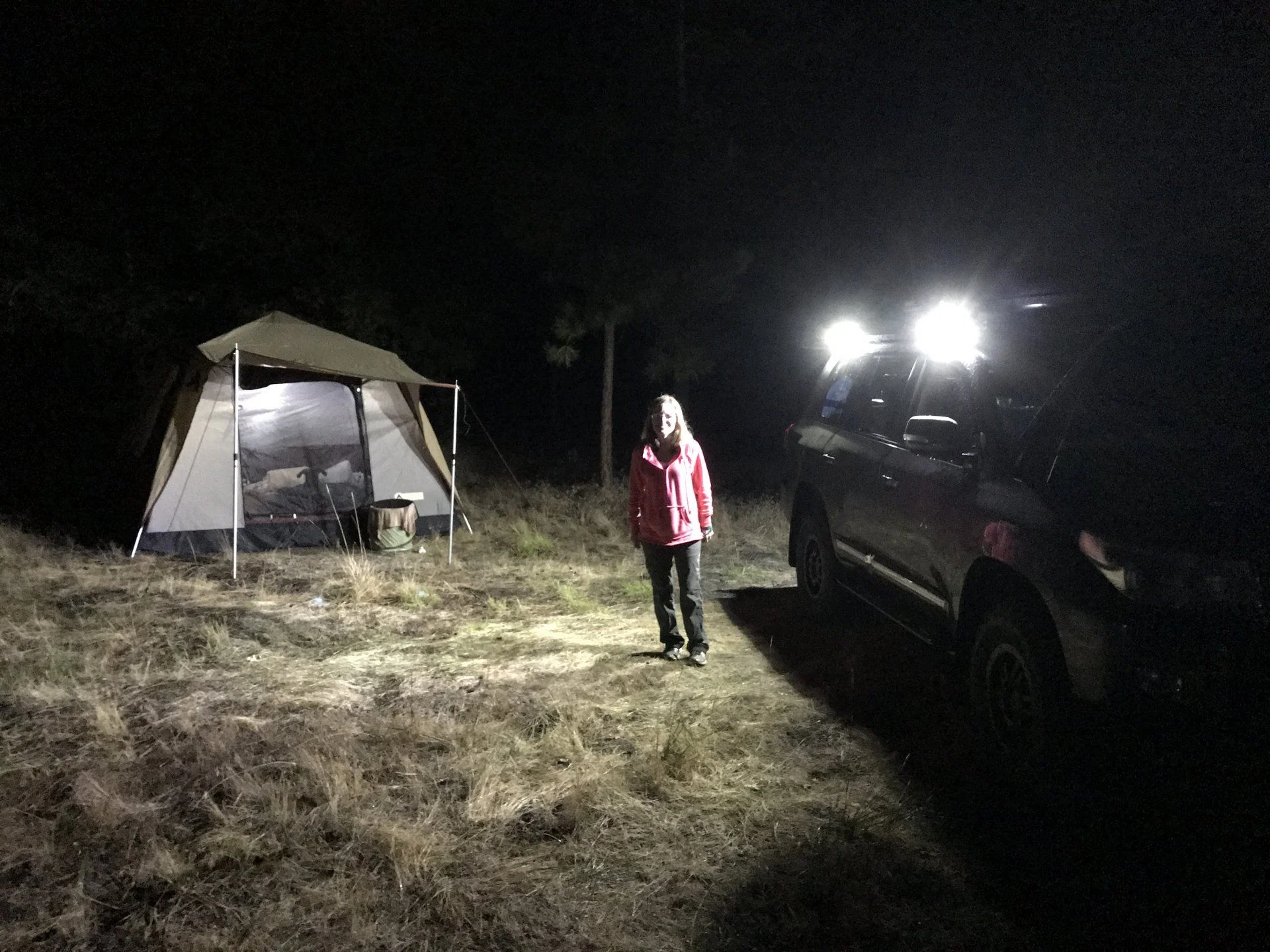

We have some Maxxima scene lights but no rock lights yet. The Maxximas may not be the brightest, but they have about the best diffused pattern I’ve seen. The Rigid scene lights that angle down are brighter by comparison, but have a way more pronounced “hot spot”.

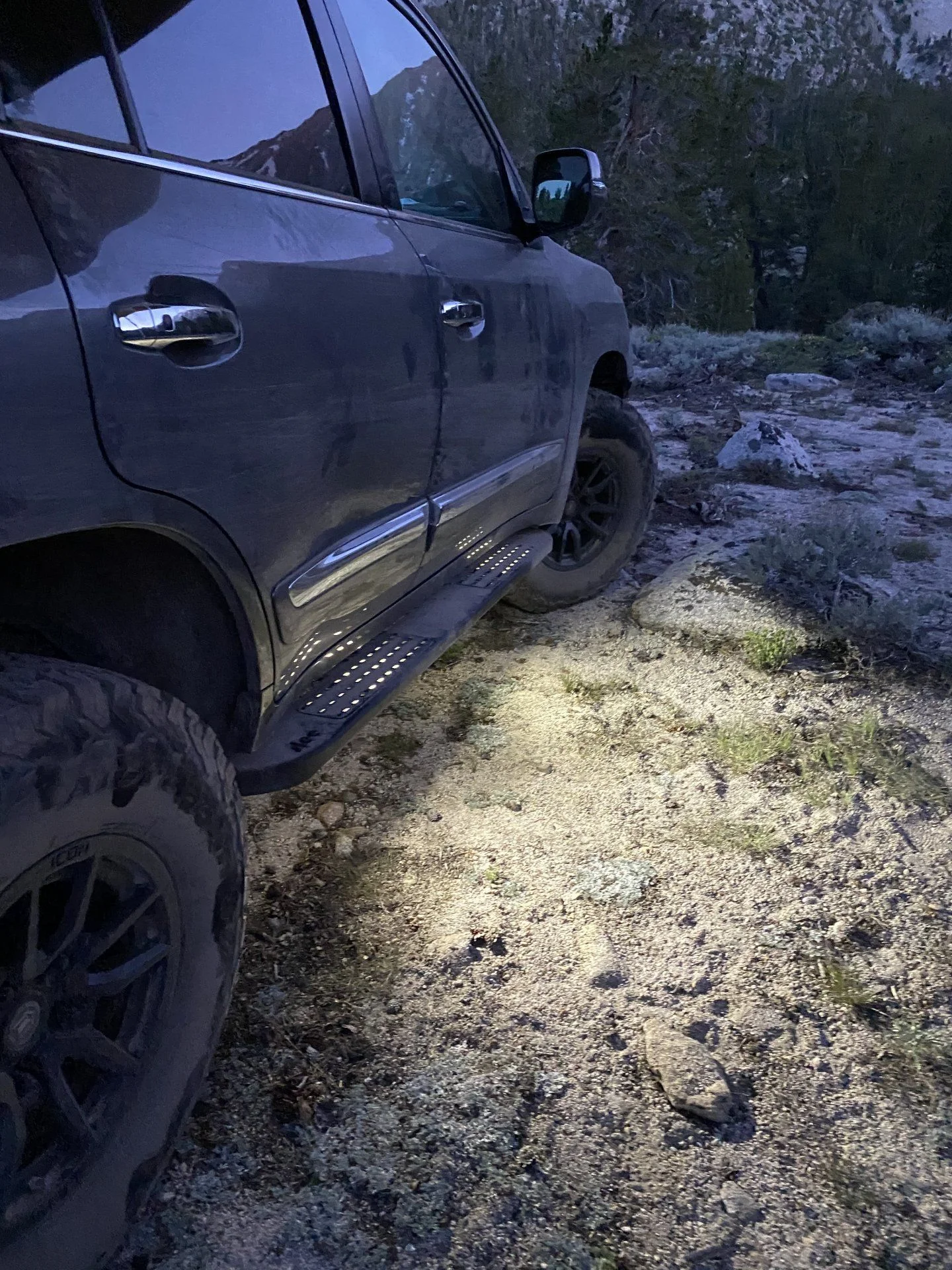

This is on my "Cruiser Projects" list for this season. I have 4 of these sitting on the shelf, and I think I've picked out where they are gonna go:
These are very nice lights, I have no concerns about their durability under the vehicle in a very wet environment. I'm kinda bummed that the pigtails are not available now, I guess I'll have to just cut off the connectors and come up with something different.

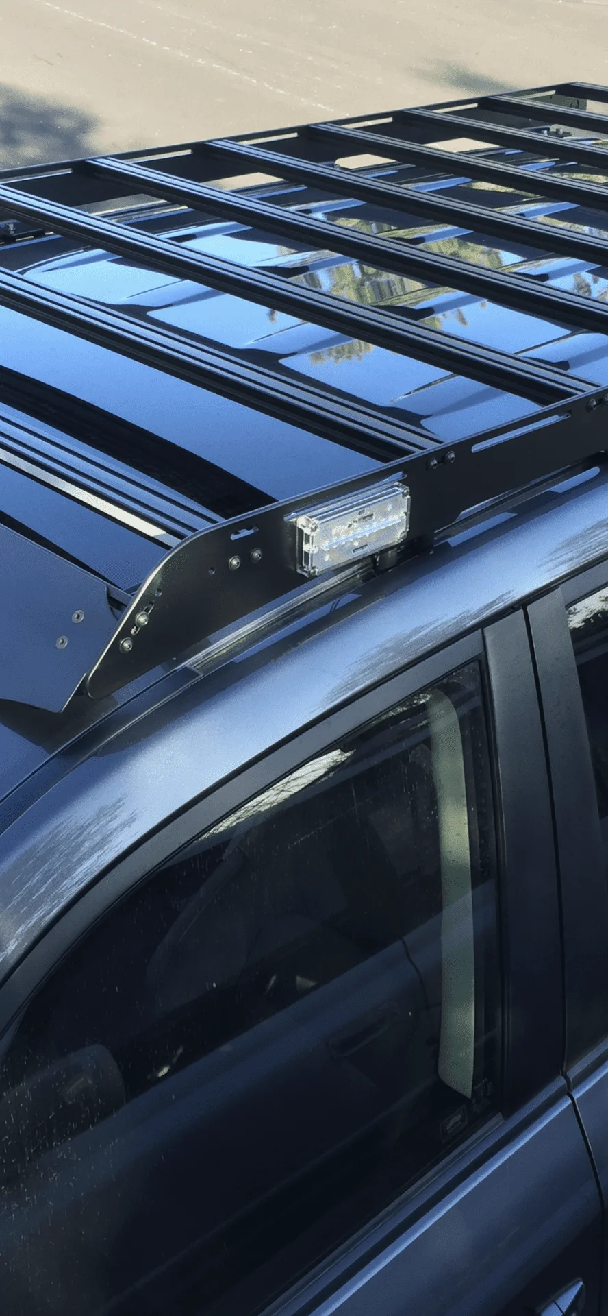

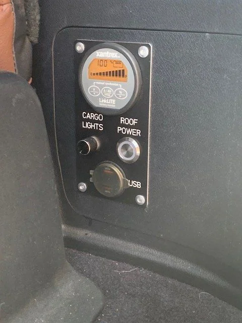

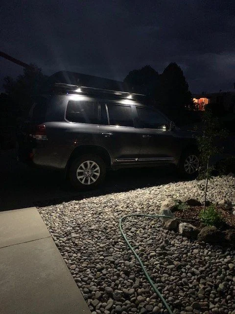

Camping lights on my 2018 LC. Power from 2nd battery run to monitor/distribution panel in the rear cargo area. Roof power (camping lights and RTT power) run through rear panels, ceiling headliner and up to rack. Camping lights are controlled by waterproof switches I installed in the Frontrunner rack.
LED lIghts are: Amazon product ASIN B013QLMFA2
LED mounts and monitor/distribution are panels I designed with Front Panel Express CAD (Frontpanelexpress.com)

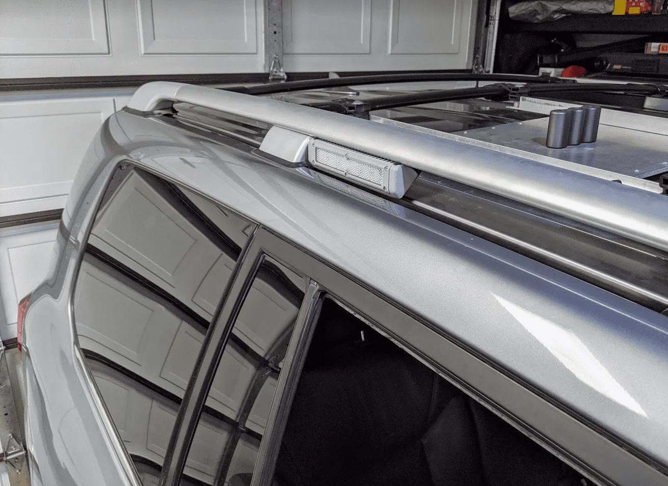

Scene lights on stock rack. Tried to keep this as low profile and stock looking as possible.
Made a stainless steel bracket (no chance for rust) that hangs onto the inside slot of the stock rail. Used some hardware left from an extra cross bar I had from my 100-series. I can slide it back and forth as necessary to adjust against the crossbars.
Controlled by SwitchPros which has a dimming function and Bluetooth control via phone. Looking forward to the next campout.
Made a stainless sheet bracket that hangs onto the inside slot of the stock rail. Used some hardware left from an extra cross bar I had from my 100-series. I can slide it back and forth as necessary to adjust the stock crossbars.

What lights are those? That looks really clean. Nice job.
Thanks. They're generic lights for a non-critical job. Form factor mattered more and these fit the bill. Seem reasonably well made with good cast construction.
Amazon product ASIN B075K5FJ53
