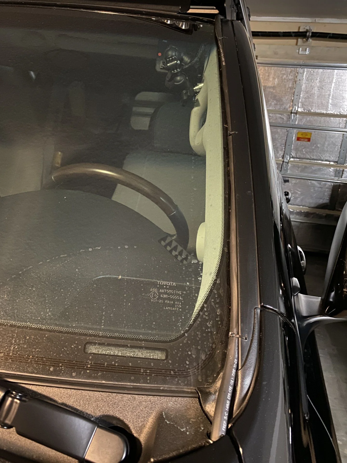

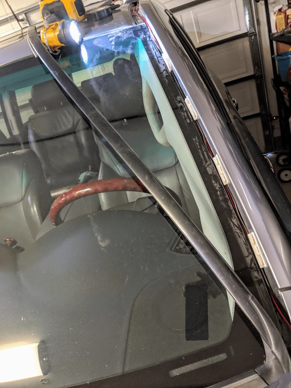

I ran 14/5 EPR Tray Cable up each A-Pillar. Drilled some small holes in the windshield trim (it’s actually metal with a plastic coating) and secured with cable ties.
I don't have much electronics on the roof other than the pair of scene lights. Ran 14 gauge bare wire underneath the trim on both sides. There may be space enough for the next gauge up or 2 pairs of wires on each side.
Had the windshield replaced last month and the installer had no problems with the wires there.
