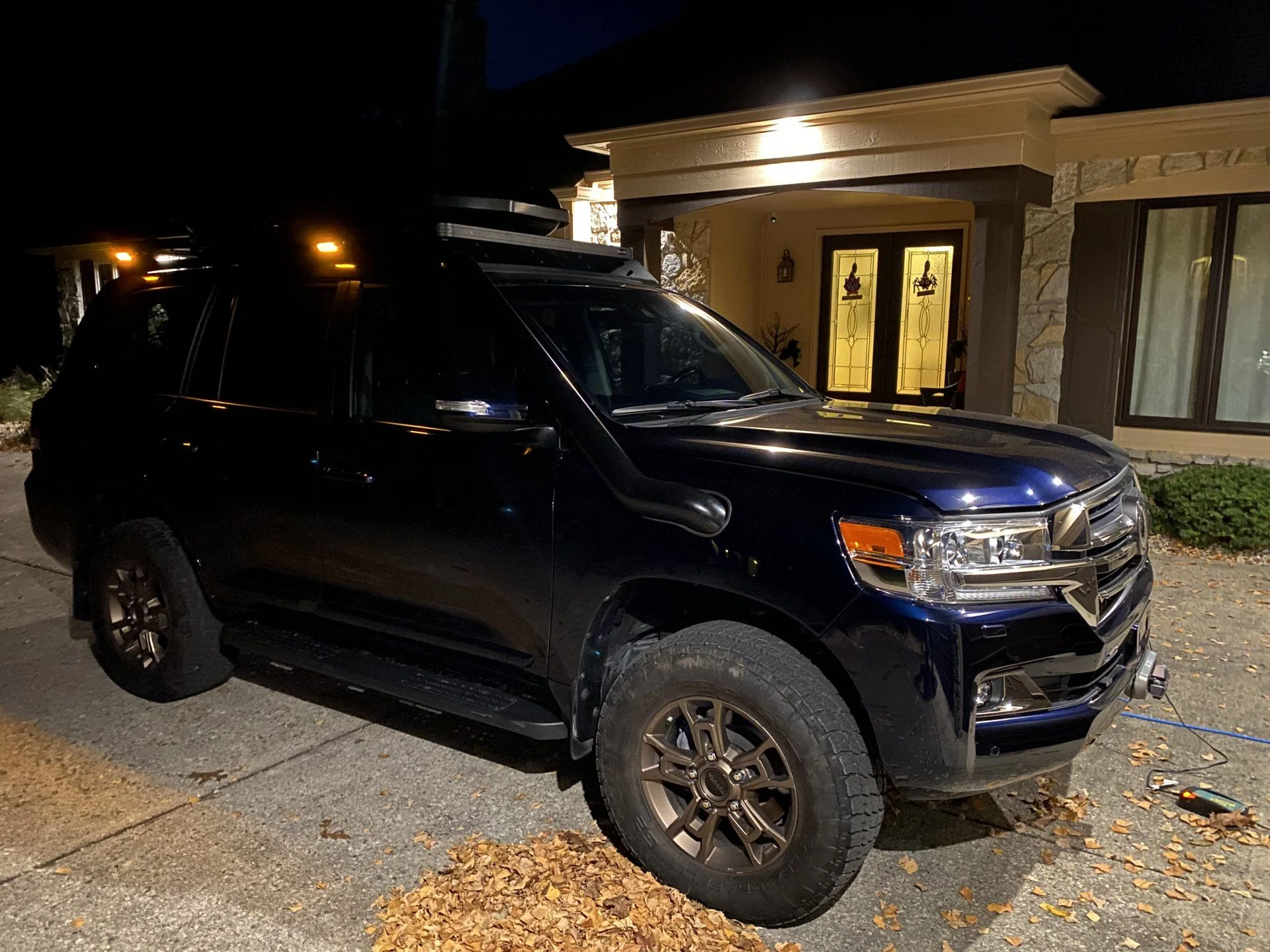

Was considering scene lights to the rear. Decided to double duty the as delivered passive rear stock fog light elements for rear fogs and rear scene.
Rear fogs as I often traverse the tule fog through the central CA valley where the fog gets thick.
Yes it's red, but that's not a bad thing for nighttime. Separately, was thinking to also double duty the large rear backup lights on the LX for added scene lighting, but I'm getting enough light with just these fog elements.
Adding a socket and bulb to the fully fleshed out except for cut receptacle stock light fixture. 7/8" hole saw. Then dremel for the detail detents.

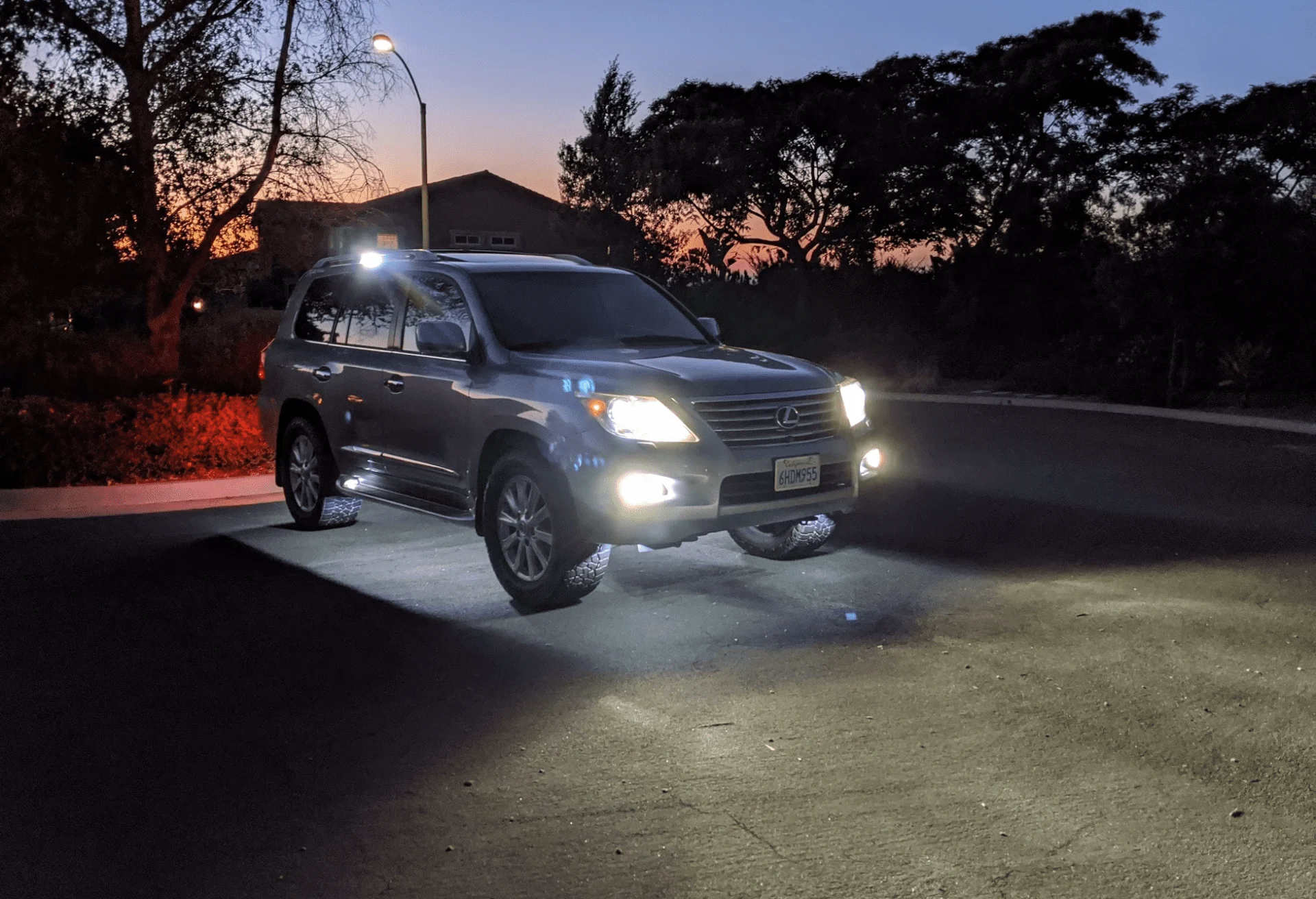

Thanks for the inspiration all. Finished the install of all too many lights.
New lighting elements include
1) Rock
2) Scene
3) Forward Spot
4) Rear Fogs

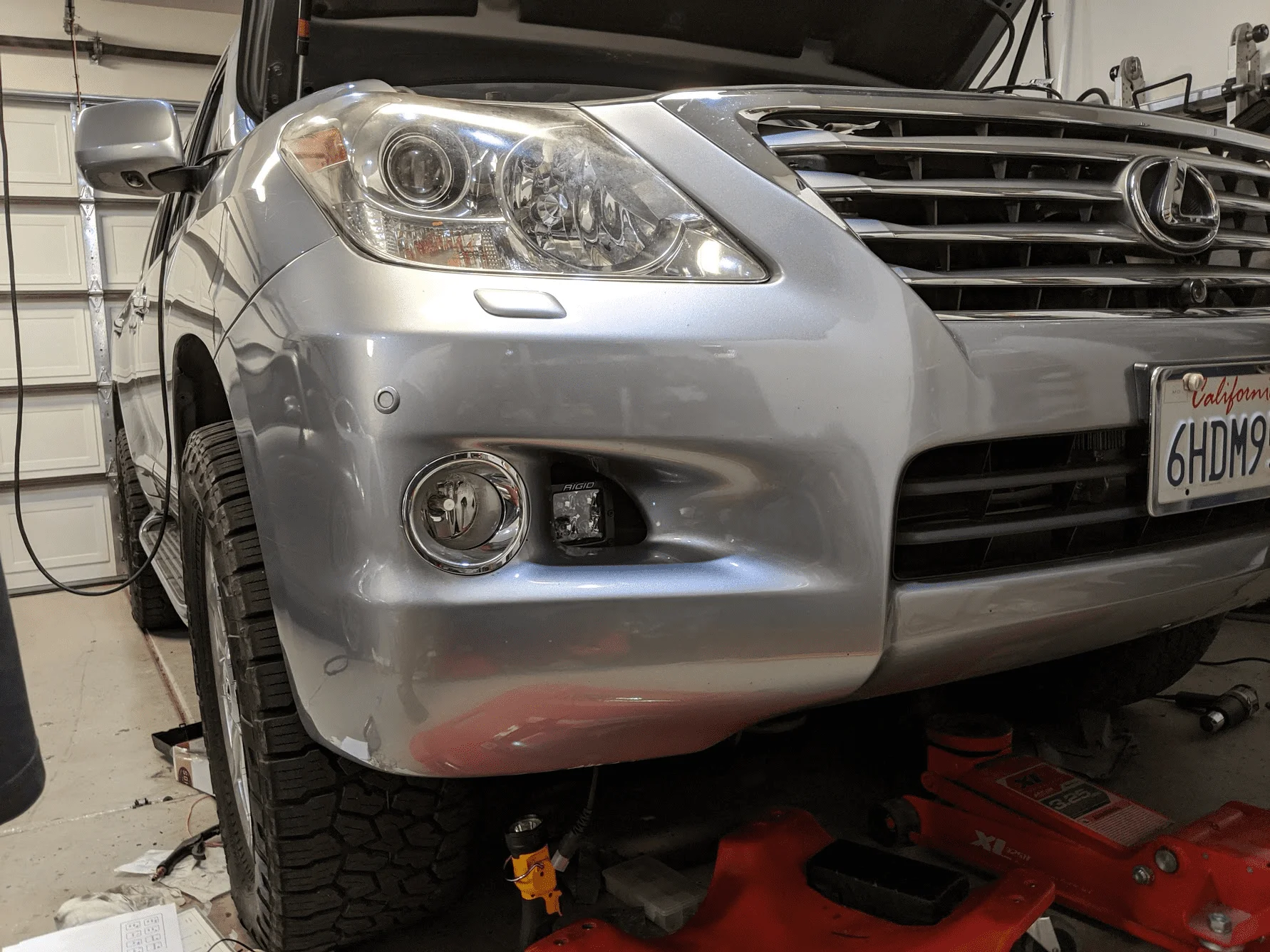

Also modified stock front lighting that I can have the full 3 sets of lights (4 including aftermarket spots) on simultaneously - headlight, fogs, highbeams. Stock would only allow any two at a time. All are fitted with high output H11 leds.
Complementing the 3 forward lights is a new pair of Rigid D-Pro Spots. Spots throwing ultra long which is a focus not existing in the stock elements. 4 total pairs of forward lighting is definitely getting the job done. All without looking much different than stock which is the way I prefer it.

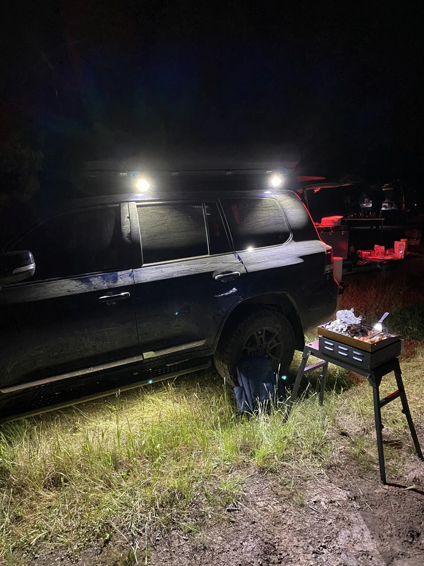

National Luna makes excellent white/red or white/amber lights for locations like hatch (I run them in mine). Much more diffuse...no harsh shadows while you work compared to single-point-source rock lights. Highly recommend.
Was planning on 8, with a light forward and rear of each tire. Worked out that I installed 10 due to the spacing of the lights in the harness. On each side, 3 under the stock steps, 1 rear of the rear tire, and 1 forward of the front tire. Recessed as possible as I dislike being able to see the elements directly. Used two of the following kits which were easy to install with 3M tape backed elements.

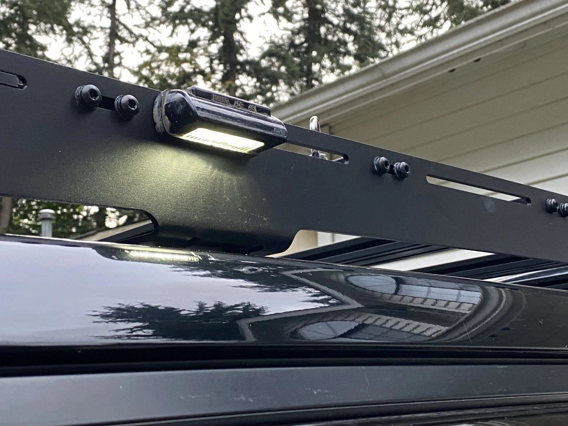

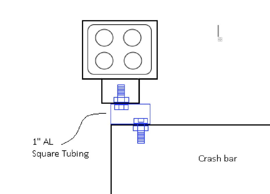

Scene lights on stock rack. Tried to keep this as low profile and stock looking as possible.
Made a stainless steel bracket (no chance for rust) that hangs onto the inside slot of the stock rail. Used some hardware left from an extra cross bar I had from my 100-series. I can slide it back and forth as necessary to adjust against the crossbars.
Controlled by SwitchPros which has a dimming function and Bluetooth control via phone. Looking forward to the next campout.

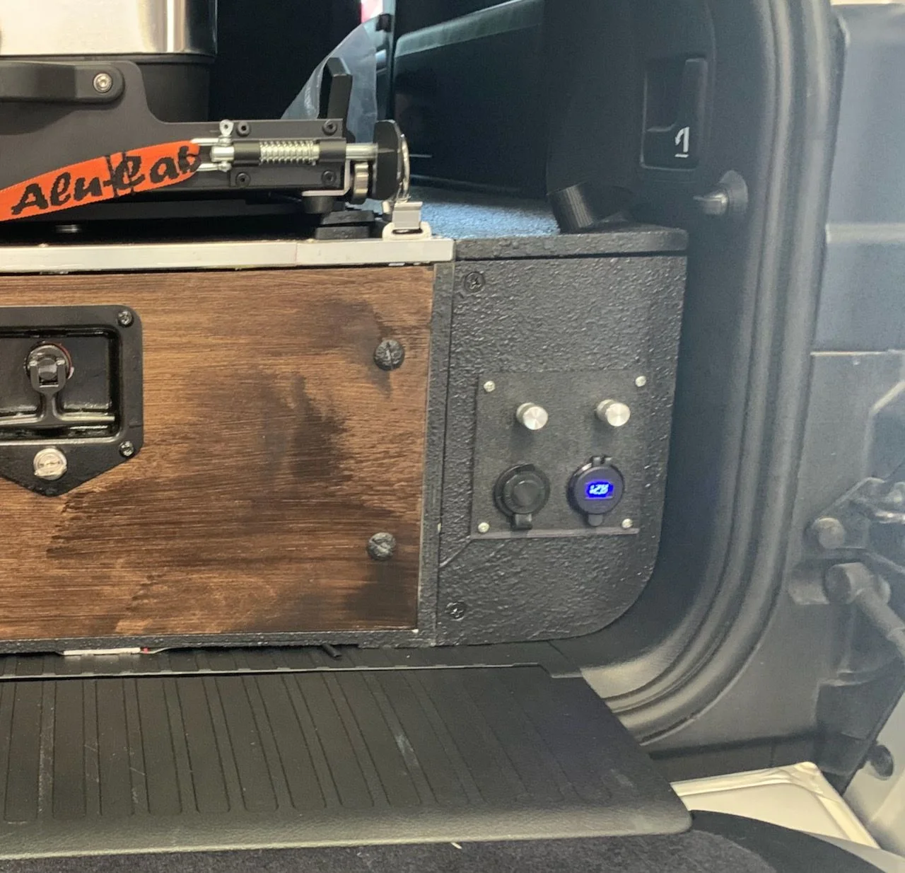

You inspired me to do the same. I didn't want to run another wire from my Switch Pro to the rear so installed two dimmer switches which also turn lights off. Blue Sea fuse block (hidden in jack compartment) in rear is controlled via Switch Pro. Waiting for another grommet to arrive so I can run power through the rear door to roof. Have spare aluminum sheet and will use to cut out brackets.

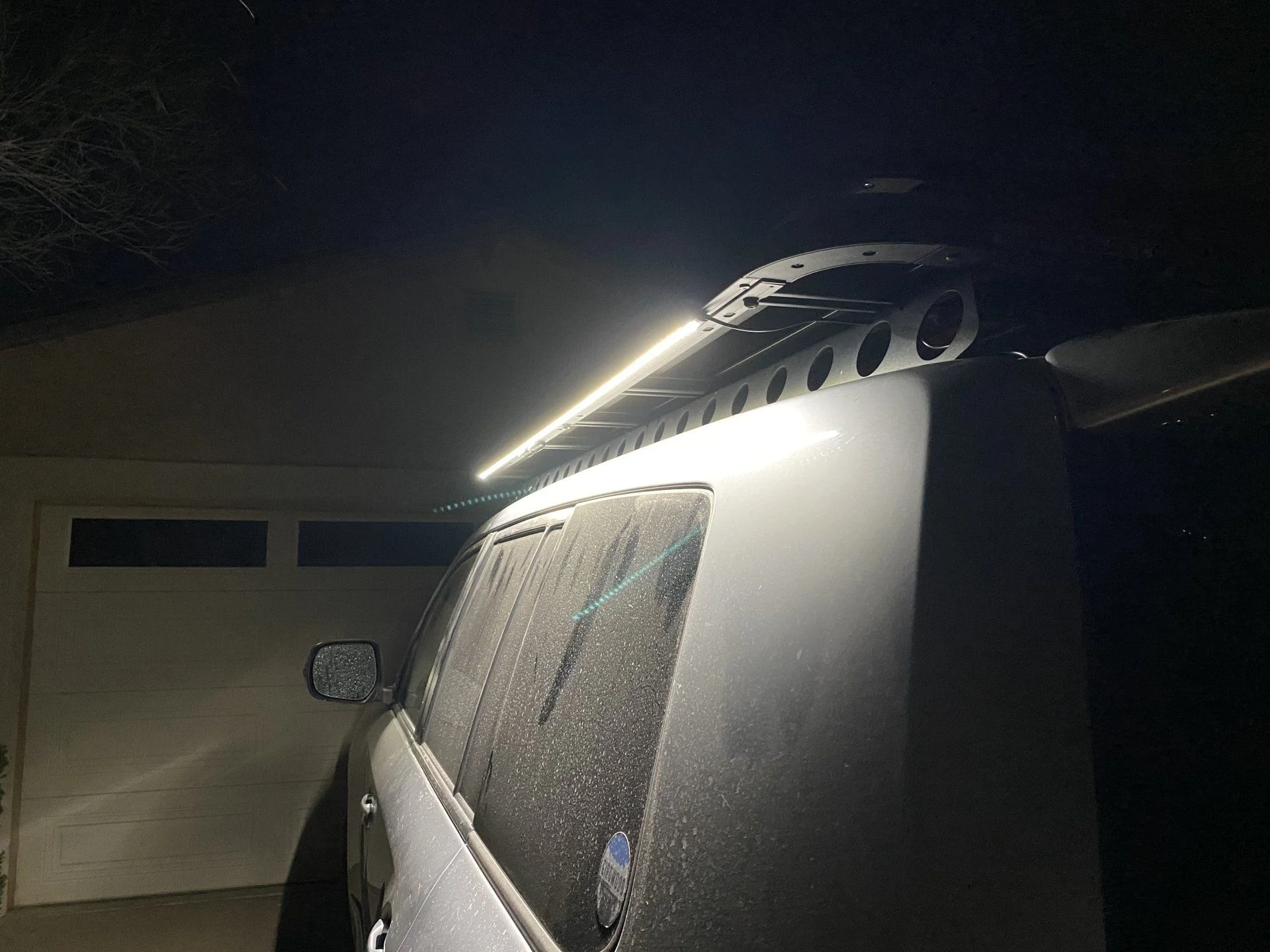

I've met the US vendor for Hard Korr multiple times. I bought one of the 19" light bars and installed that on my rear hatch. I like it since it has a diffuser, dimmer, and two colors (white and orange). I notched the little cover for the wire to come out and used VHB to just stick to the hatch itself. I'll try to get a pic and update this post at some point.

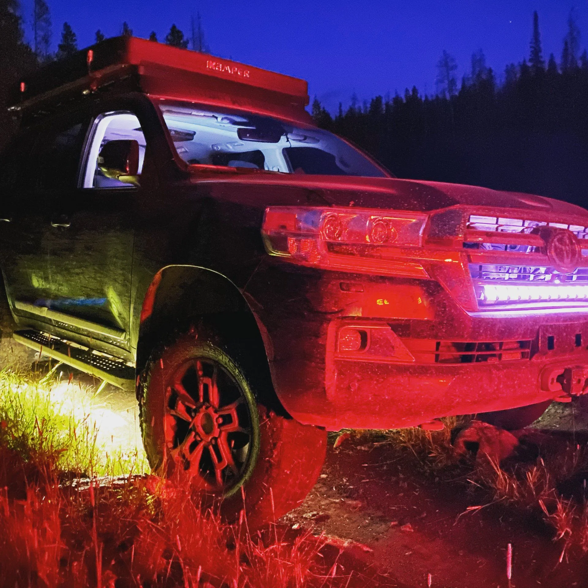

Here’s a few on my rig.
- 8 rock lights tied to done circuit, two rear, three on each side under the @sleeoffroad sluders (override on Switchpro up front)

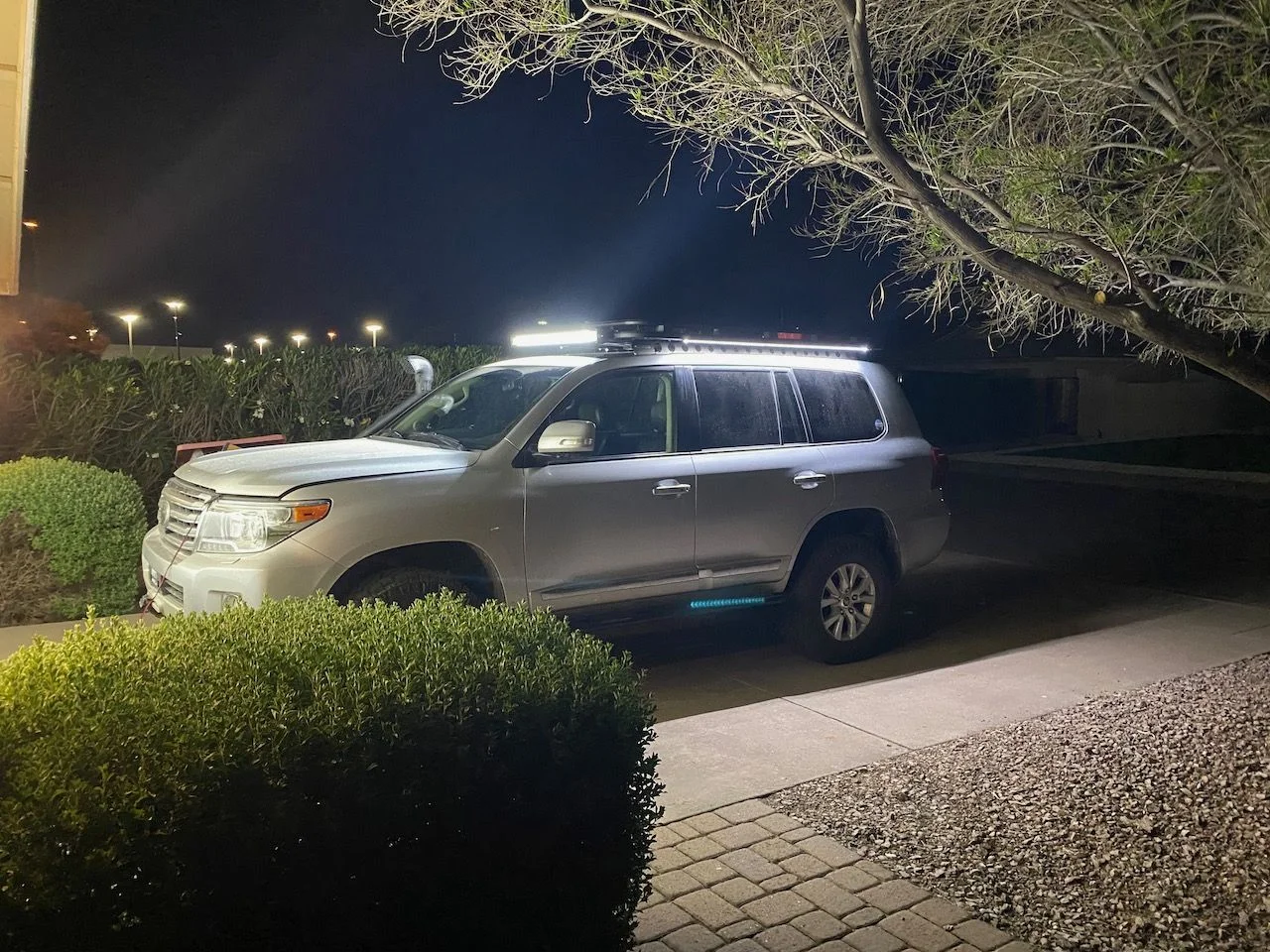

- 4 rigid SLR spreaders (2 on each side) amber glow/full white (controlled from RedVision in rear/Bluetooth app), angled with @Dissent scene angle brackets

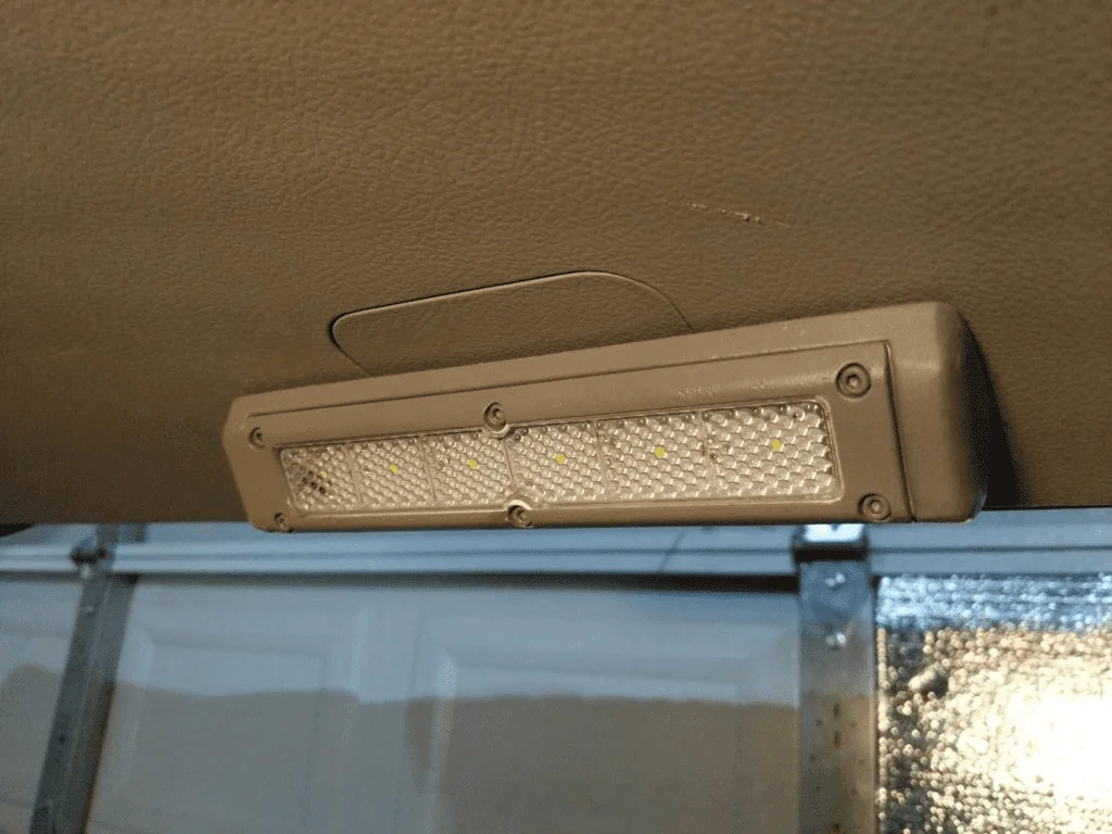

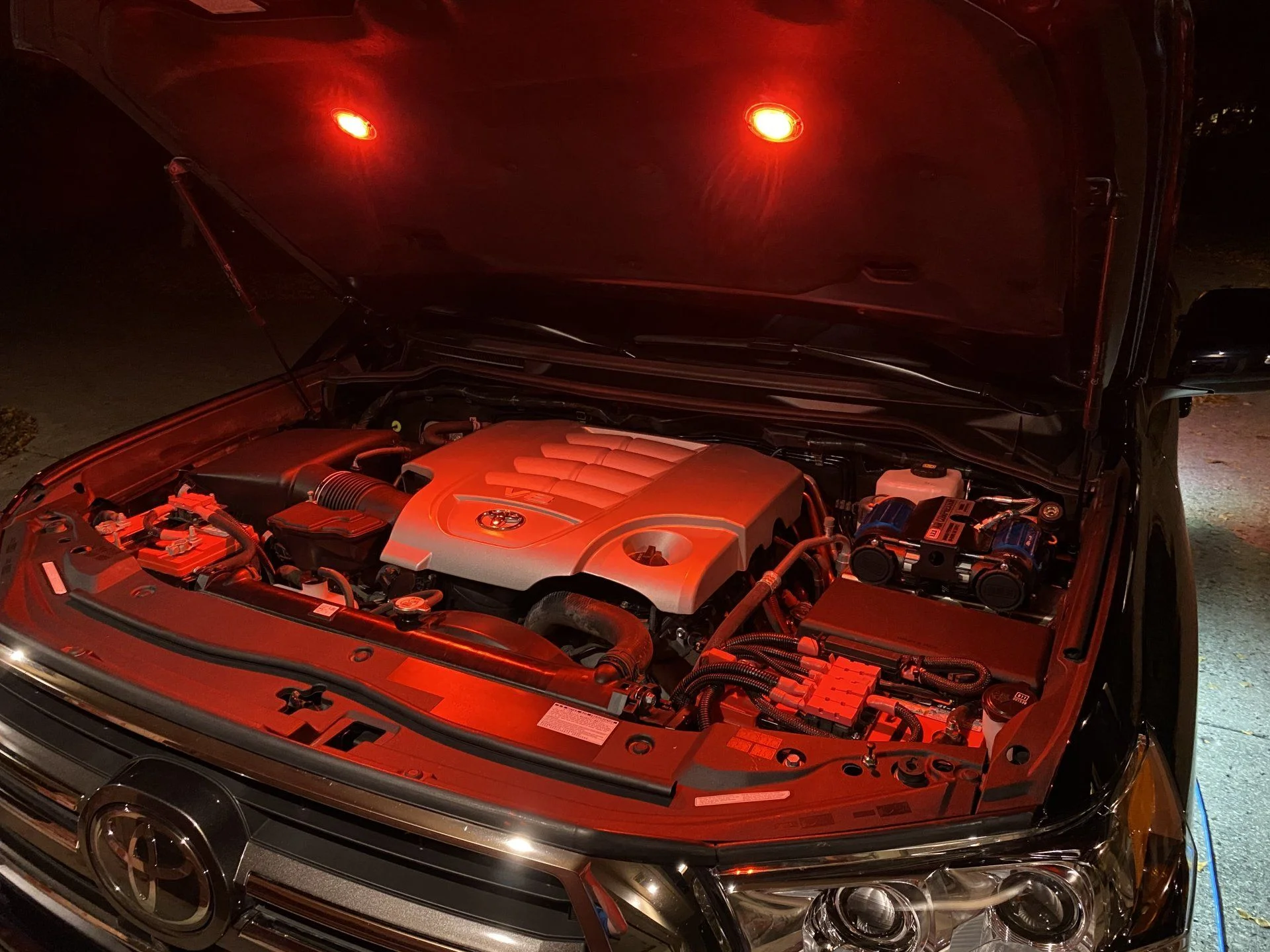

- 2 Whalen waterproof amber/white combo in hood liner, controlled with toggle switch in plastic cover over radiator
- 2 Whalen waterproof amber/white combos in hatch for drawers controlled with toggle switch for easy access to turn on w/o any light at night.
Looking through photos, found a few more worth sharing.

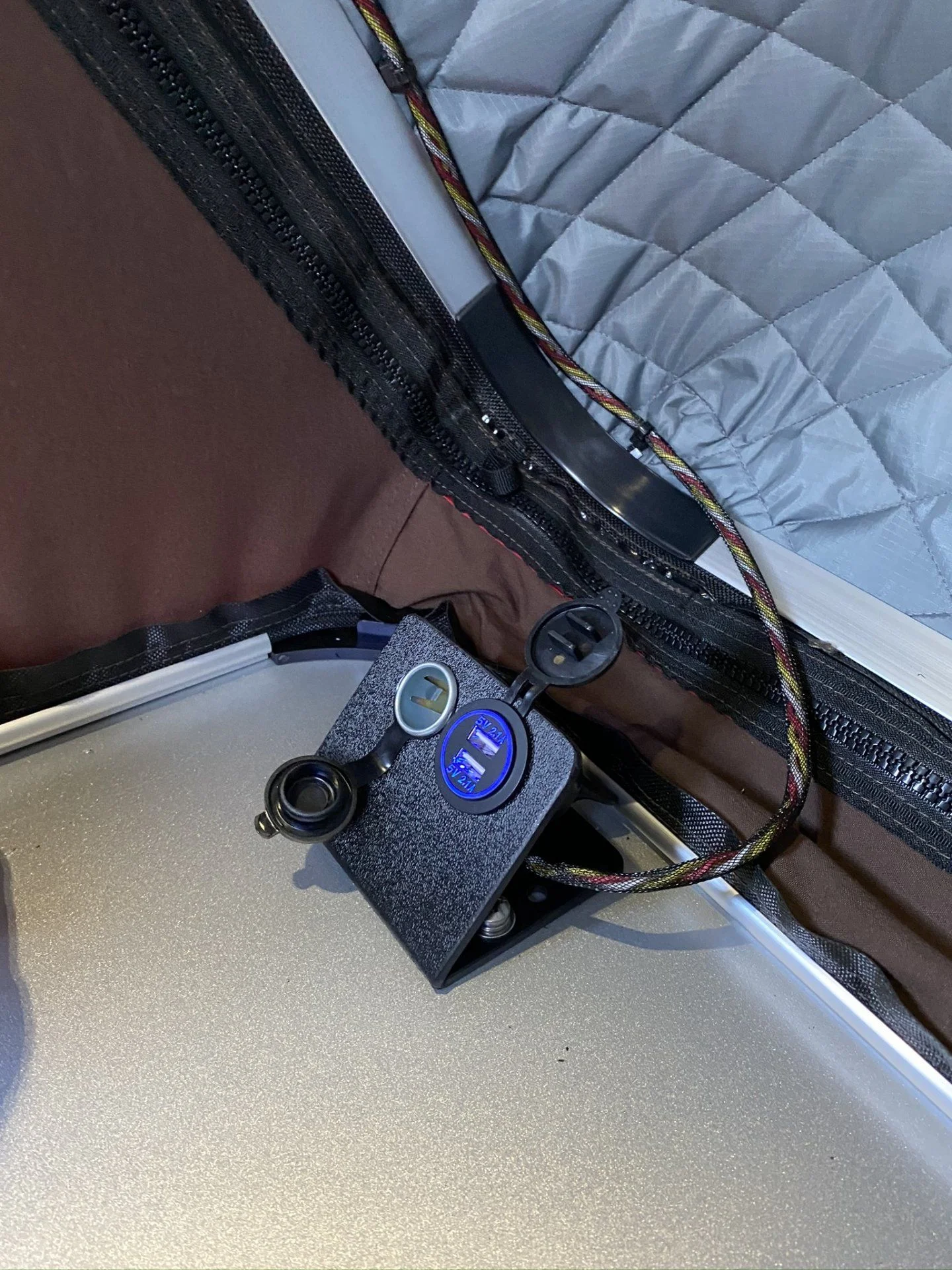

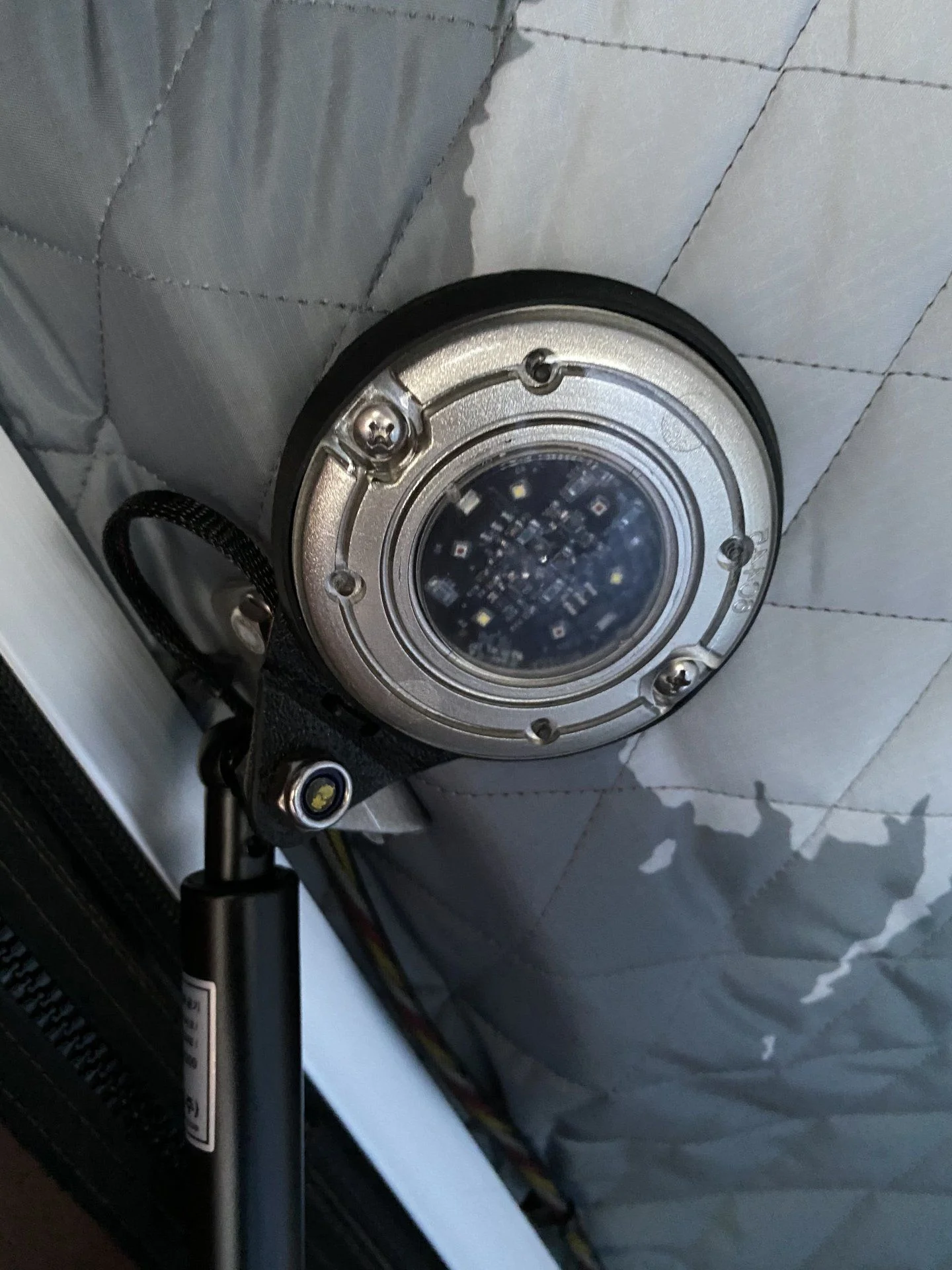

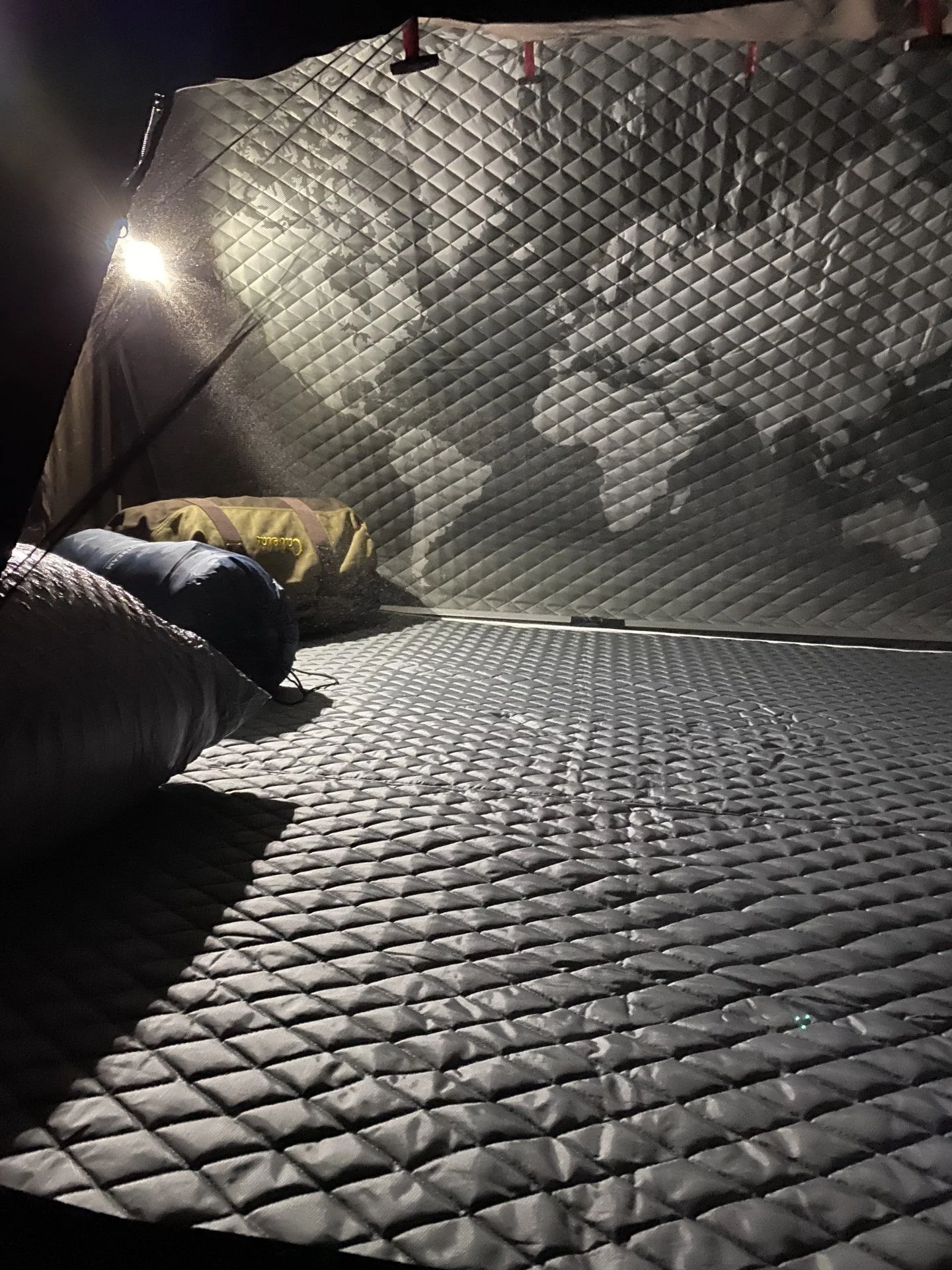

- 1 Whalen amber/white combo in the iKamper controlled with RedVision(RedVision app)
- two 2.4v USBs and one 12-volt outlet in the iKamper (controlled with RedVision) connected to roof with Deutsch connector for easy unplug when RTT is stored
- 30” Rigid ADAPT in (Heritage) grille

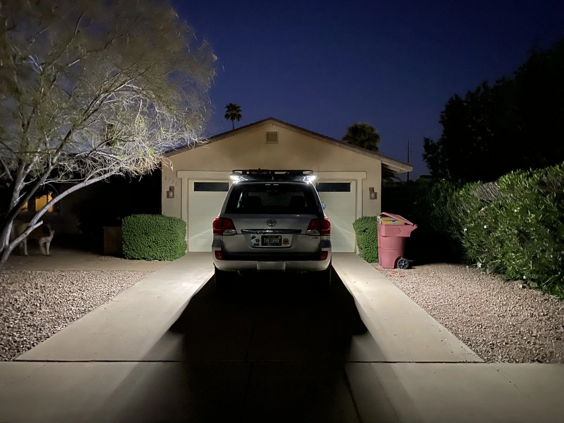

- SLR spreaders on full bright (white) mode
