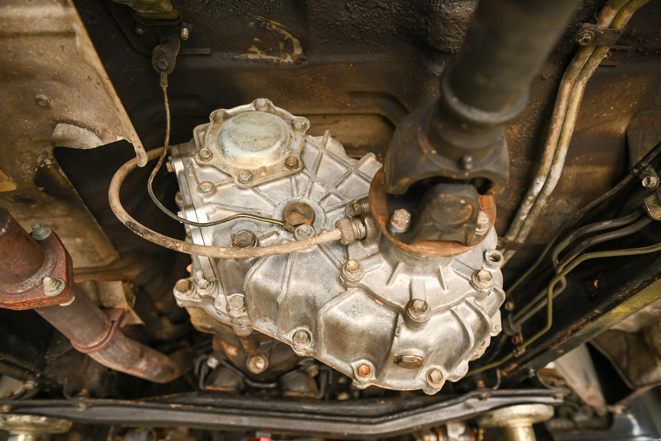

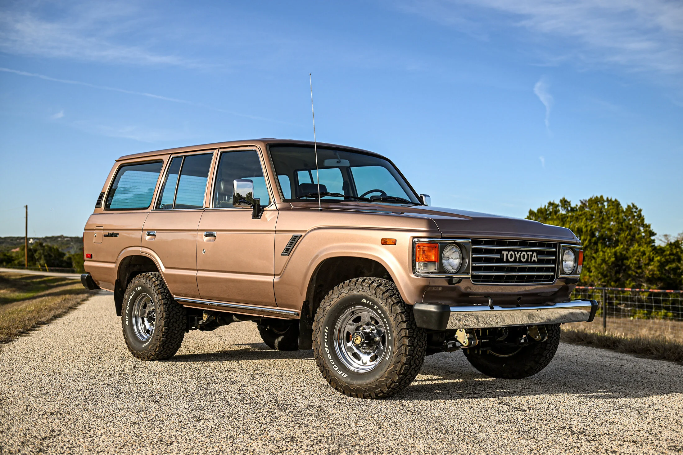

It looks shiny. Can you go see it in person? To me, most of those pics suck because of the lighting and focus, can’t really tell what’s going on. There’s 2 in particular of the rear drivers quarter panel where one pic looks like a scratch under the emblem but you can’t see it in the next.

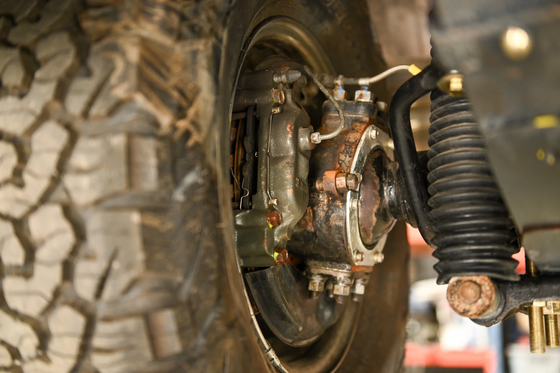

All that being said, it looks clean. Has a couple leaks or old leaks that weren’t cleaned. The rust issues would be my biggest concern, especially with a relatively fresh paint job. That still wouldn’t be a deal breaker, depending what you’re looking for.
That rig has a lot of leaks, knuckles are leaking, rear main seal and everything else behind it. looks good. But that rust needs to be investigated more. also need to do a water test on that windshield could be possible leaks into the interior due to that rust. The air cleaner has a few extra holes on the passenger side. what's up with that.? Like Skreddy said if you can see it in person I say do so. It's a great color though.
