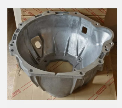

Those FJco bellhousings look ROUGH. They look like an afterthought more than a product if you've ever dealt with patterns and sand casting.

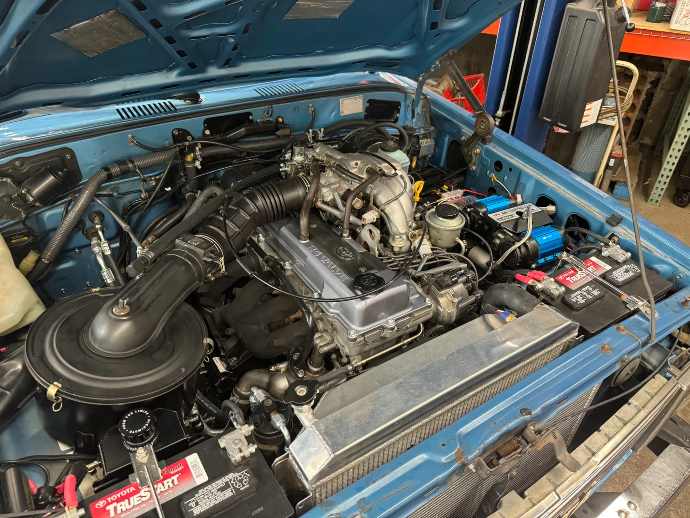

We've done two of these using the FJ Co bellhousing, and would absolutely do them again if the parts were available. In the 60, it did allow for keeping the transmission sitting in its mount and not having to redo anything in the drivetrain. We used the Haltech system made for the 80. It does not make LS power but does make more than the 2F and is 400% smoother at every rpm. The rest of the drivetrain still makes enough noise that you still get the full experience. 10/10 would recommend.
@FJ60Cam G damn, that is a good looking engine bay. Do you have any experience with 3111160230? Keeping the transmission mounts and drive shaft the same sounds wise, and my shop and I can easily tap some extra holes in the factory housing if that's the only difference between the two. Any idea what MPG those 60's got after your swap? MPG is probably the only thing that would push me towards a diesel. Just did a trip in the South West where I got a whopping 7mpg in my Sniper'd 2F...that's pretty f'n hard to swallow. Even if I had no f's to give towards economy, the difference in range between 7mpg and 20+??? in a diesel makes a huge difference in capability. 10% (1mpg) is mentioned based upon factory literature, but is that realistic given the variables? Somehow I'm hoping for better MPG, but that might be something akin to s***ting in one hand and hoping in the other?

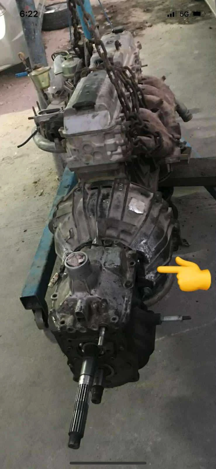

In my FJ collection is my daily white FJ62, which has low mileage. Then I had a long story with a modern 1FZ-fe that ended up in my possession. I am aware that this swap is a common practice in Qatar, and I can complete it within a week. However, I wanted to approach it in my own way to gain a deeper understanding of this concept. I do not hate the 3F, but I already have another stock 62 in black that I won't sell, and I do have a solid patena 1986 that has no engine, so that 3F will be used.
I plan to try it with H55 first, as my Qatari friend did for his swap, then go with H151 if needed.

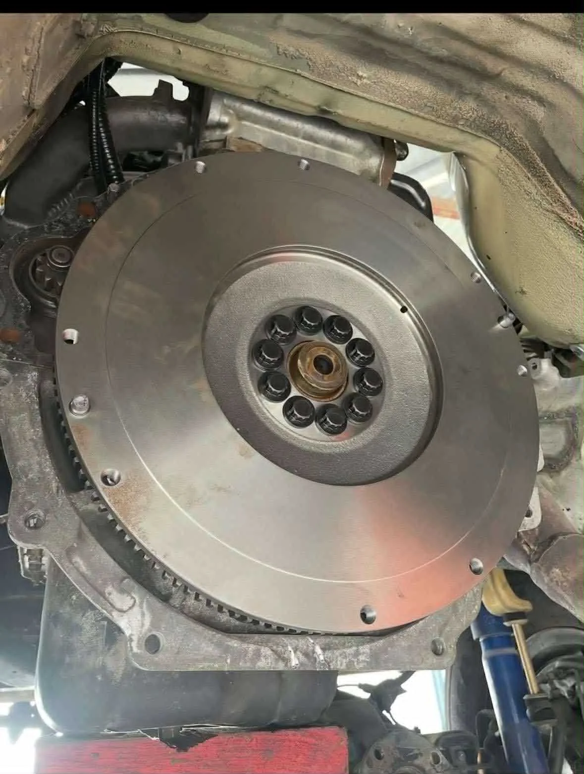

When I reached my Qatari friend, he shared this photo, which is an FZJ80 bell housing that had been modified to fit the H55 pattern.

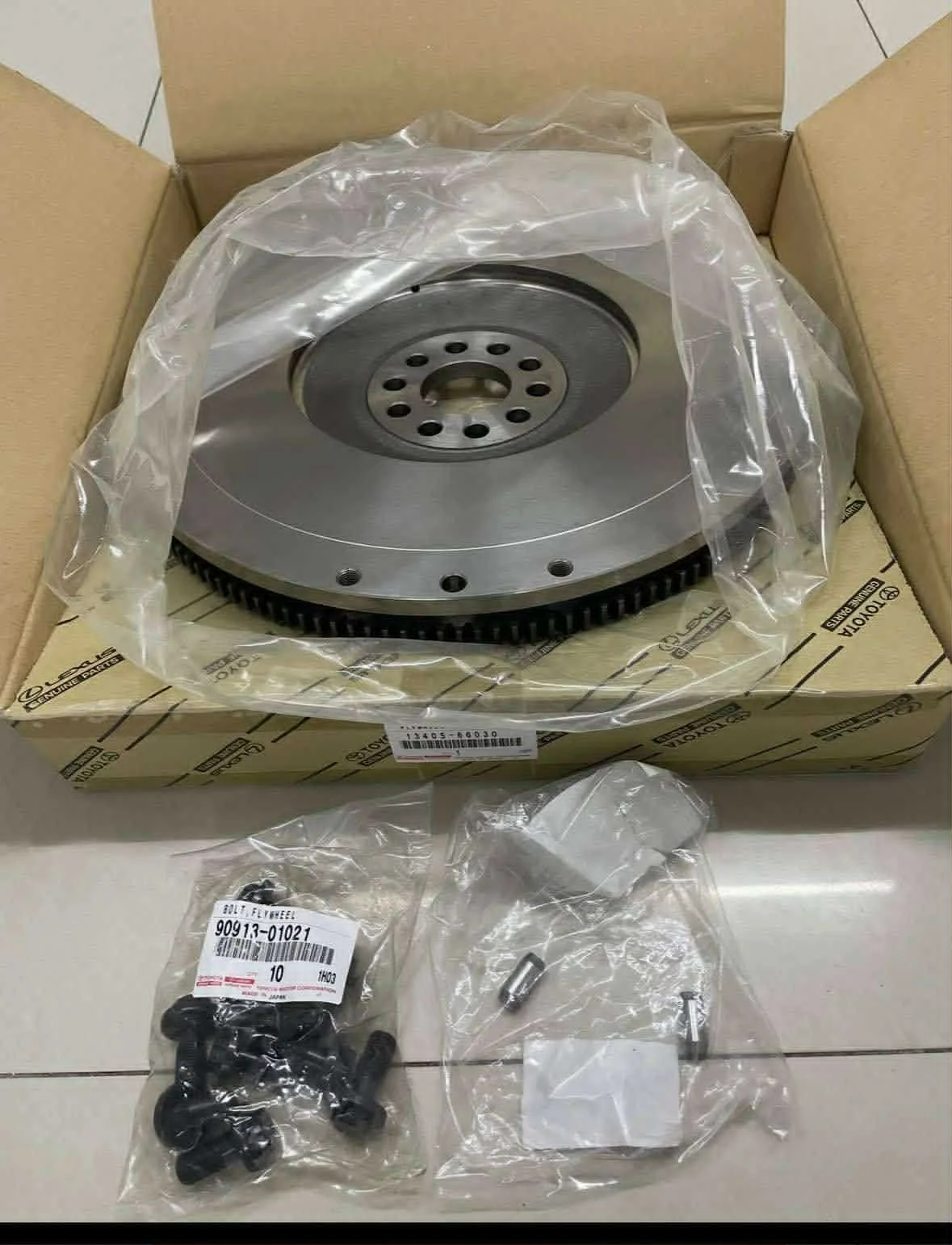

He took the following from FZJ80 the disk from FJ62 h55
- Flywheel is a 1fz's
- Fork and bearing
- Plate and clutch from zj80
In my case with latest 1FZ-fe. I have to go with fzj79 ECU because it came without key security.

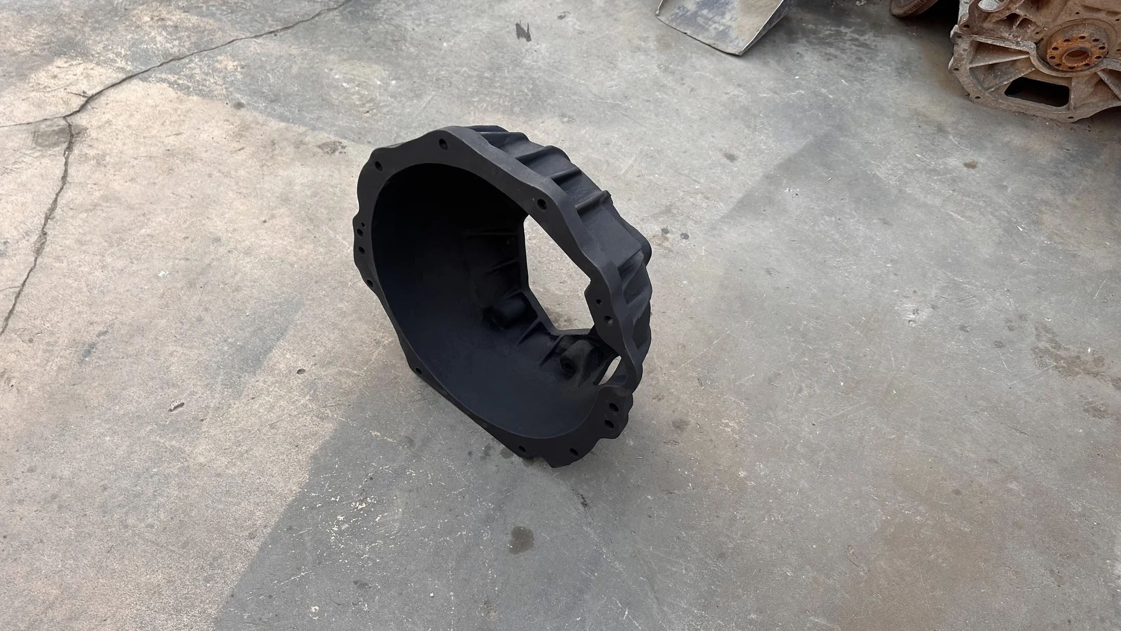

Here is a sample of shop work for making housings for swaps
this one i believe is a uz engine to nissan transmission, however he did one for gm to h55.
