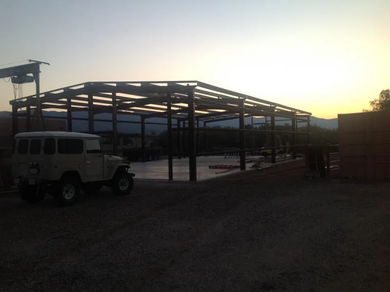

Here's a picture of 97% of red iron up. It taken six days so far and should have all structural up tomorrow by noon. BTW, my forty broke down on my way to work. I need a new fuel solenoid, So I might need to hold off on the building until I get my baby back on the road :steer:

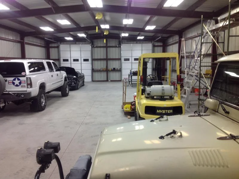

I went with six bulb T-5 hi-bay fixtures from relightdepot.com. I ended up installing a total of 18 fixtures for a 40'x80' (3200 SF). I can't believe the amount of light comes off these bad boys. The layout was a PITA but worth the time. The color on the lights is a 5K mimicking natural light. Very happy with the results for the money spent.
