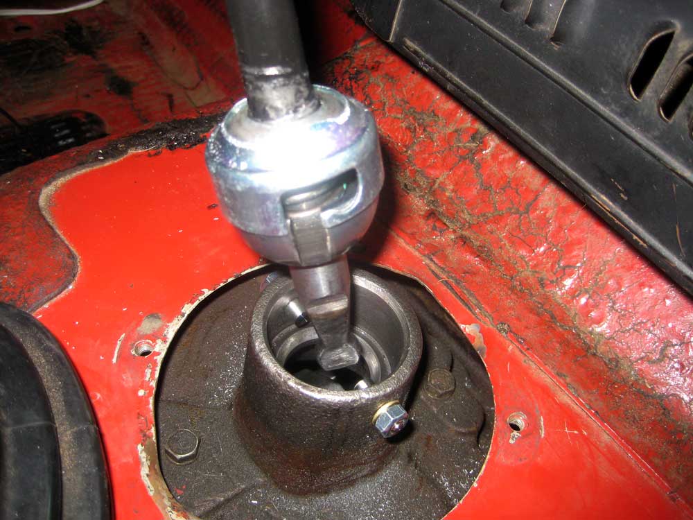

I decided that while I was removing the shifter, I might as well replace any parts I could, and to my surprise I found the retaining cap all hacked up, and the dowel pins where worn.
Being new to the FJ40, and not having a FSM handy - I had no clue how the retaining cap came off. After searching and asking a few questions here I figured it out. Because I could not find any pictures on ih8mud regarding this, I decided to post this tread.

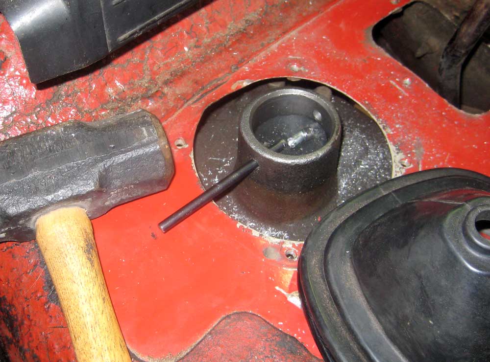

It's a .5:banana: job, I just drilled out the dowels, and tapped them out with a hammer.

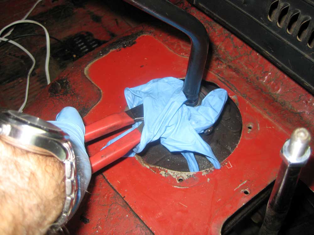

I have two tips:
1. Cut a small piece of rubber in a circle so you don't drop any parts into the tranny
2. Use the old rubber glove on a wrench trick when you push down, and turn on the retainer ring.

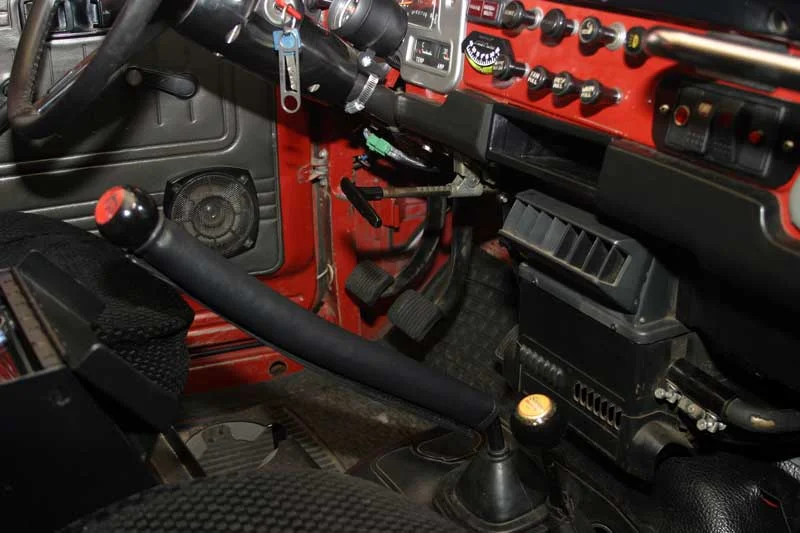

interesting dash

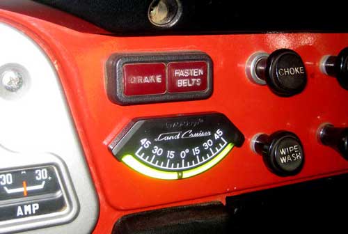

That dash is interesting--What's the funny shaped gauge on the right of the wheel --clinometer?
I like that!! I will be ordering one of those today if I have that same spot available on my dash that you have. Like Hillary Clinton..." I can't recall right now".
