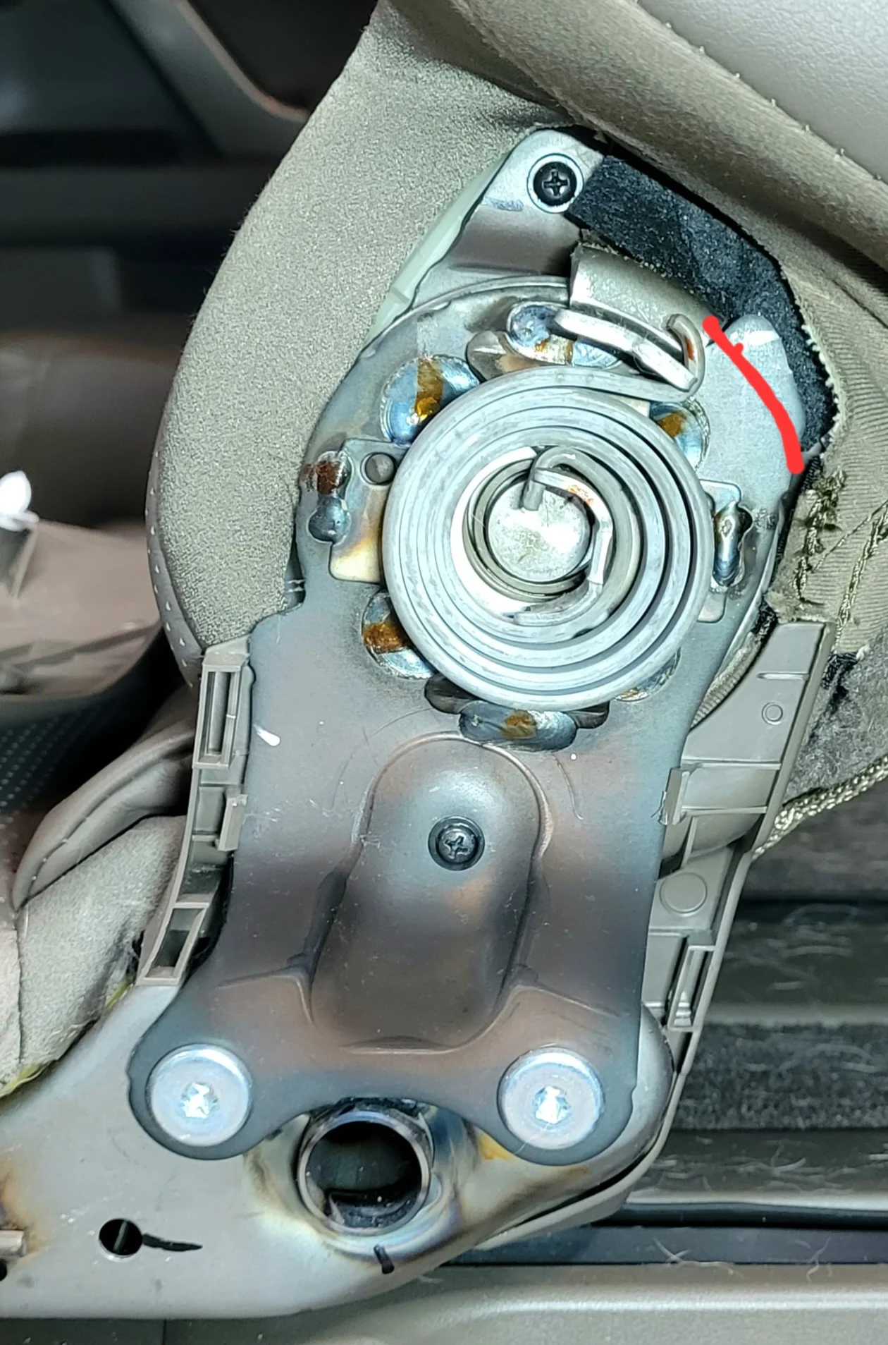

I took the left cover off the drivers side seat, and see there is a pretty solid chunk of metal limiting travel. How dumb of an idea is it to get after that sob with a grinder?!?! My only thought is to leave some material there for a stop, as the concern would be in an accident that there is nothing there to stop the seat from going too far back.

maybe you could cut/bend that section you're thinking of cutting, just as a trial? So you could bend it back if it didn't work for some reason.
It looks to be at least 1/4" steel, so bending it is not in the cards! haha
If cutting it, just be aware of the heat next to fabric and padding a cutoff wheel generates.
Yeah I would pull the whole seat out of the GX and probably cut and form some light gauge sheet metal around the area to protect the seat. Also cover it in a welding blanket or something NOT flammable!

Will this mod result in the spring shown being wound more? Probably won't make a difference if the additional degrees of rotation are small.
Yeah it will be wound more, but not sure that will have any effect on function.
