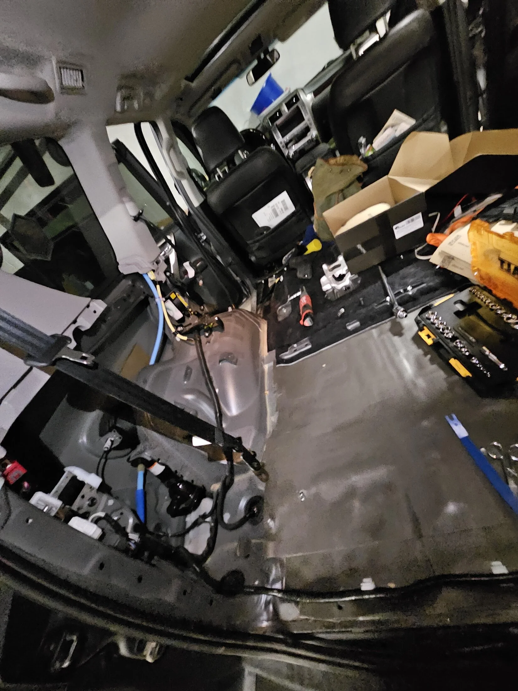

i used 80mil(2mm) sound deadening from amazon. i honestly don’t know if it helped. i would go thicker if i had to do it again. i did the entire metal area after the 3rd row is removed.

I used about 12 sheets. I pulled all the plastics to remove everything and stuck it everywhere I could. Made a big difference. Highly recommend.

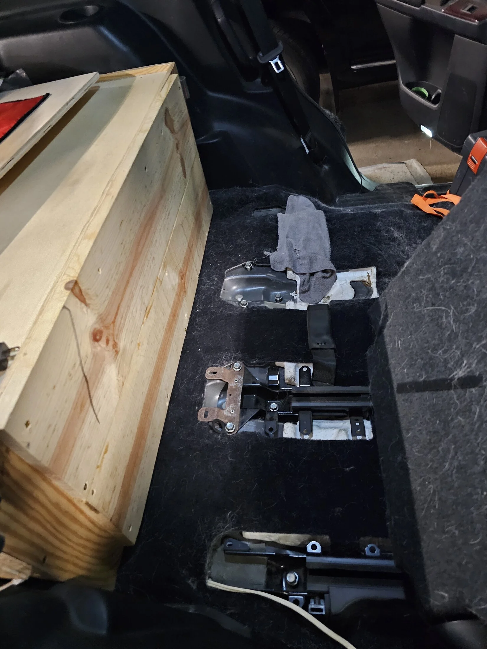

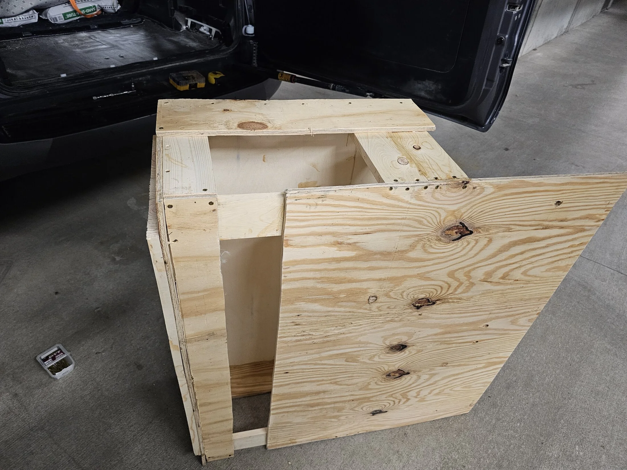

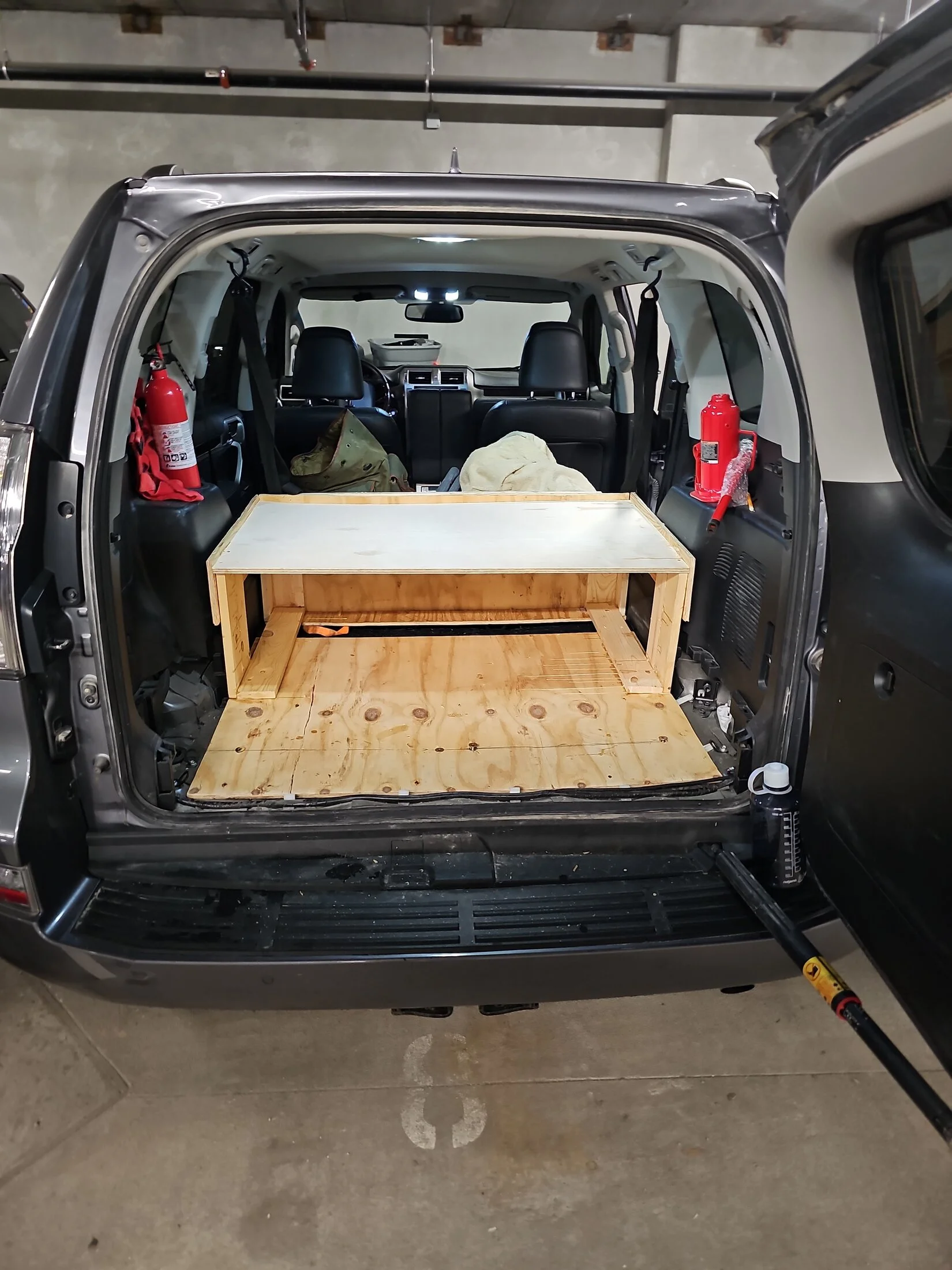

So far everything has worked great. I slid my cubby back 4 inches so the middle row can slide all the way back and it leaves room for a gallone of washer fluid and my steel toes for work. The cubby then also touches the back of the seats adding another support member.
I am considering passing on a rear swing out and keeping the cubby permanently, as I can remove in 5 minutes if needed. Just takes 4 rated bolts to be removed.

You may consider adding a length of rubber tubing/foam tubing/carpet trim or something along the length of the box that rubs against the middle seat back so you don't get a wear line from rubbing on the seat back carpet.
I have a split pool noodle for that.
