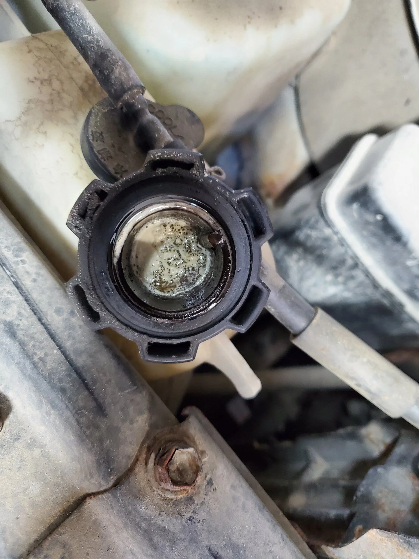

Cons: looks like some (1) rust on the under carriage, and.... there's some (2) white slime in the engine oil cap.

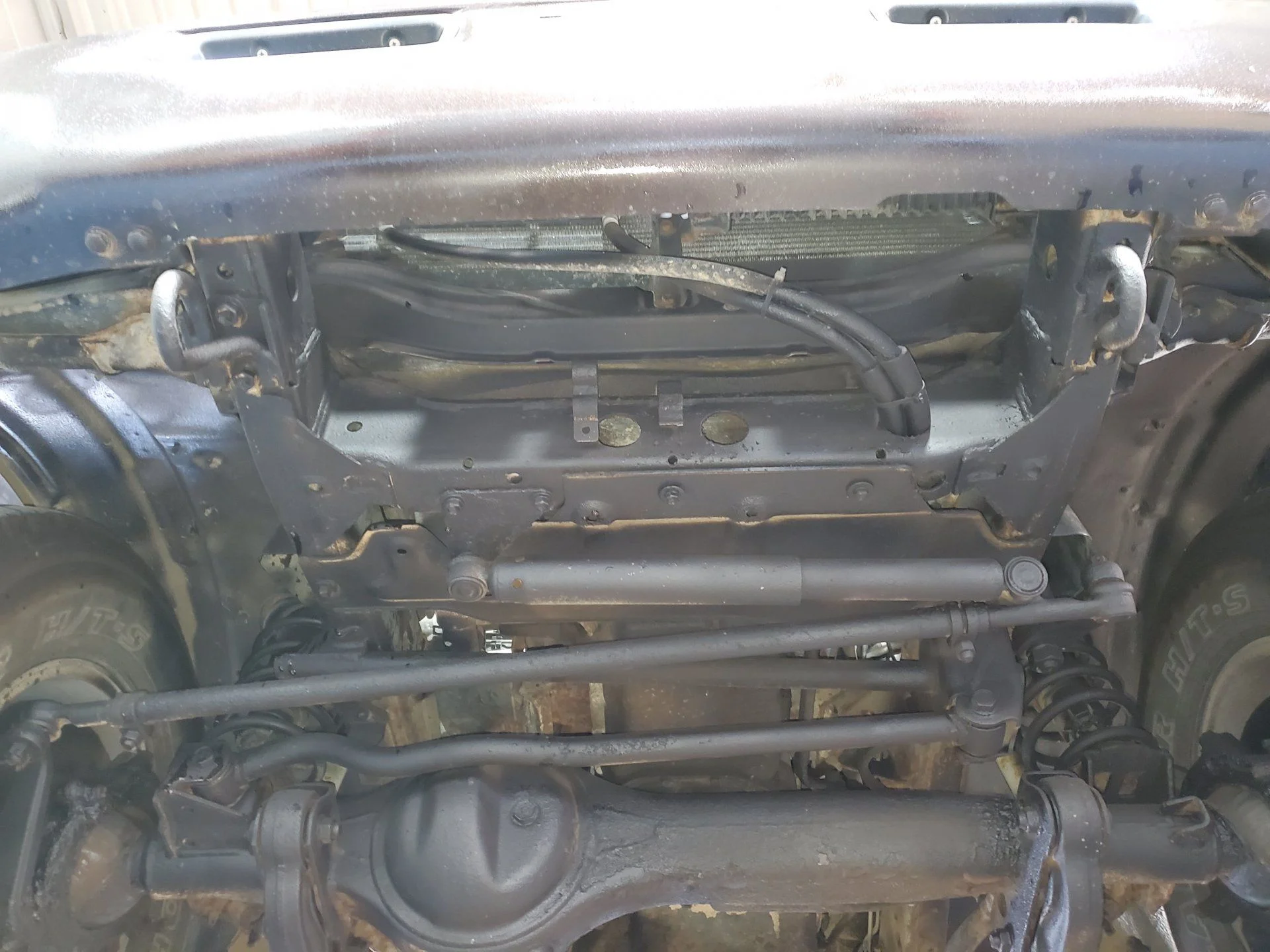

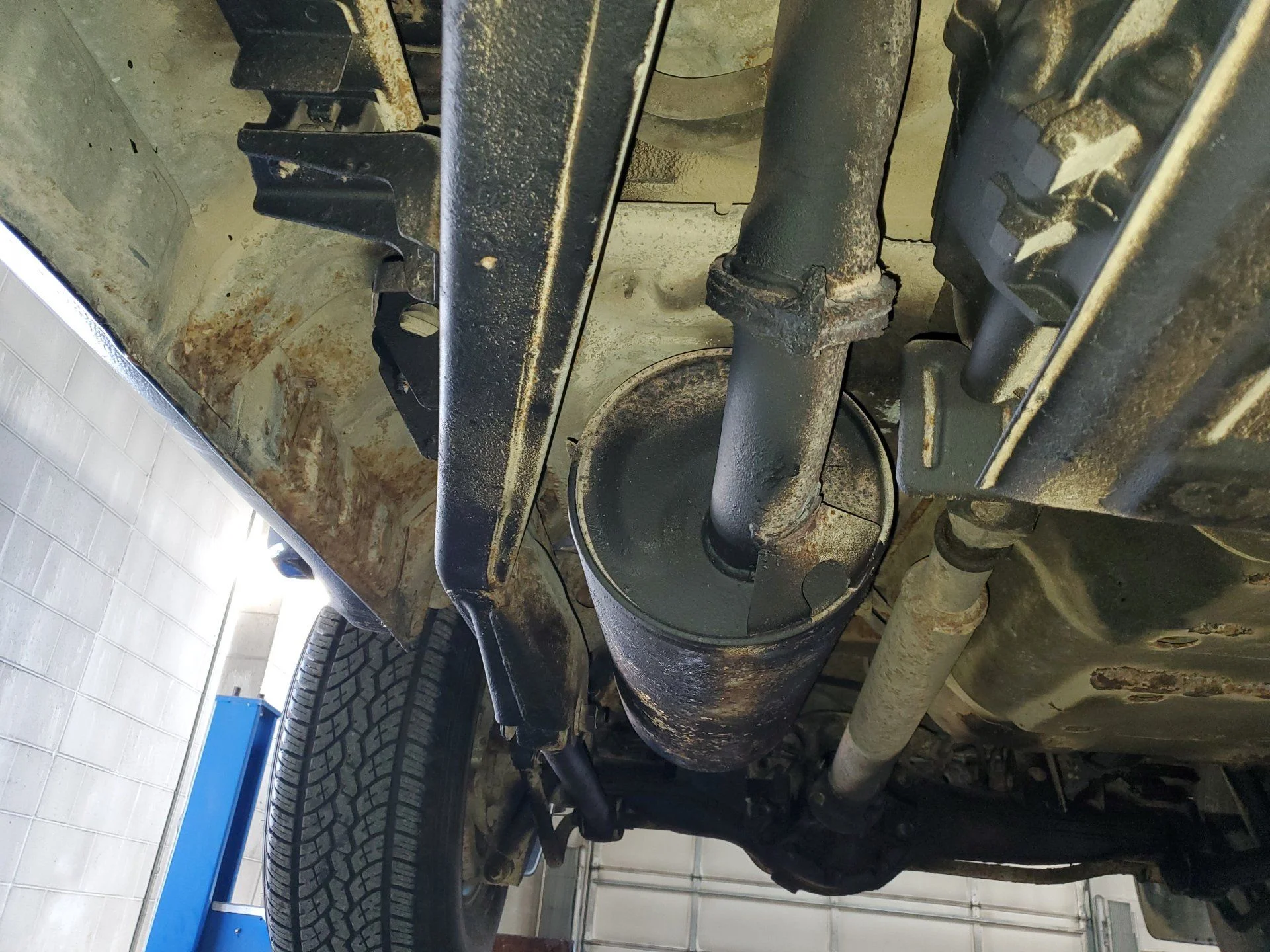

Rust is the game stopper. I wouldn’t give more than $2500. What’s all over the engine? There is absolutely no reason to deal with rust when you can get rust free for that money.

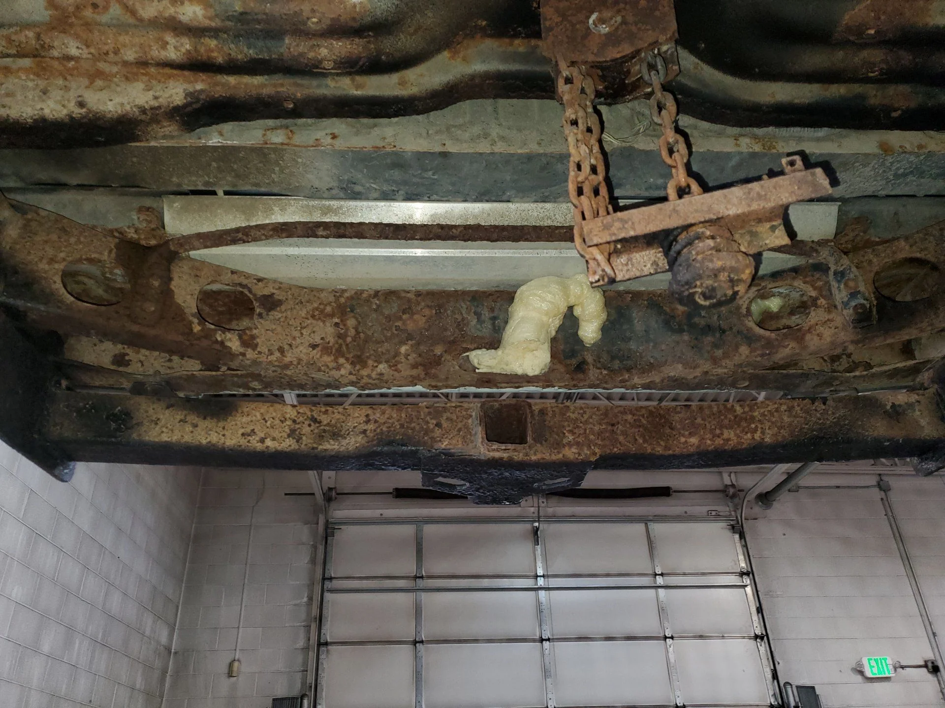

Hell no. It's had undercoating sprayed over rust and some sort of

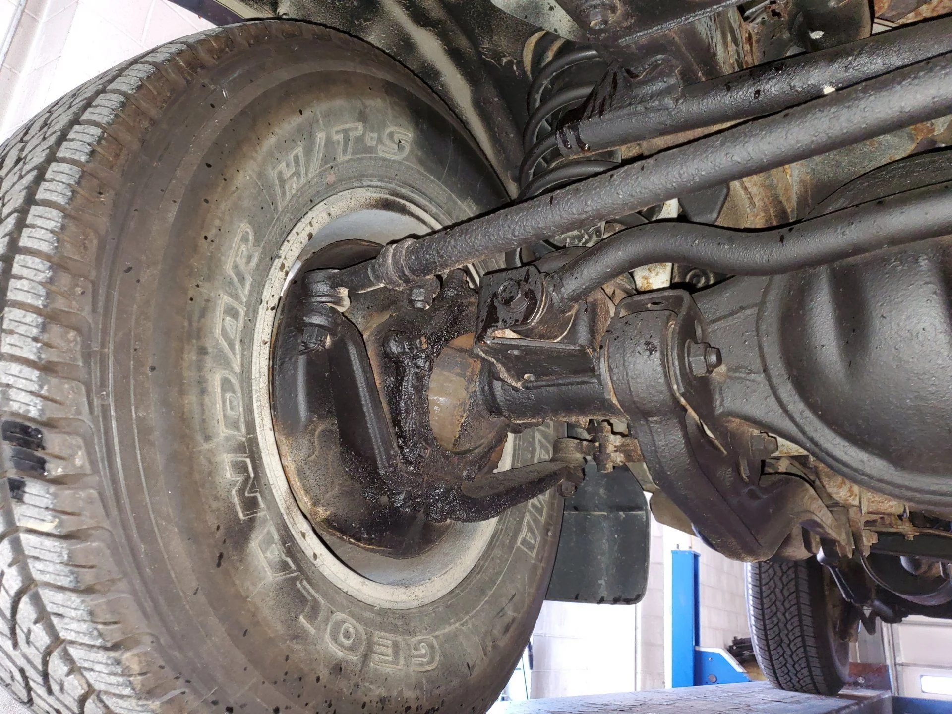

home foam insulation sprayed into the rear crossmember?? Front axle/knuckle/CV joint service is way past due (leaks). Engine bay and undercarriage are roached. Shocks are rusting off. 10k is a joke, more like $1500-2500 (for the locked axles) as a parts truck, maybe, if the panels aren't rusty, but they probably are.

Expanding foam in the rear crossmember? That might be a first

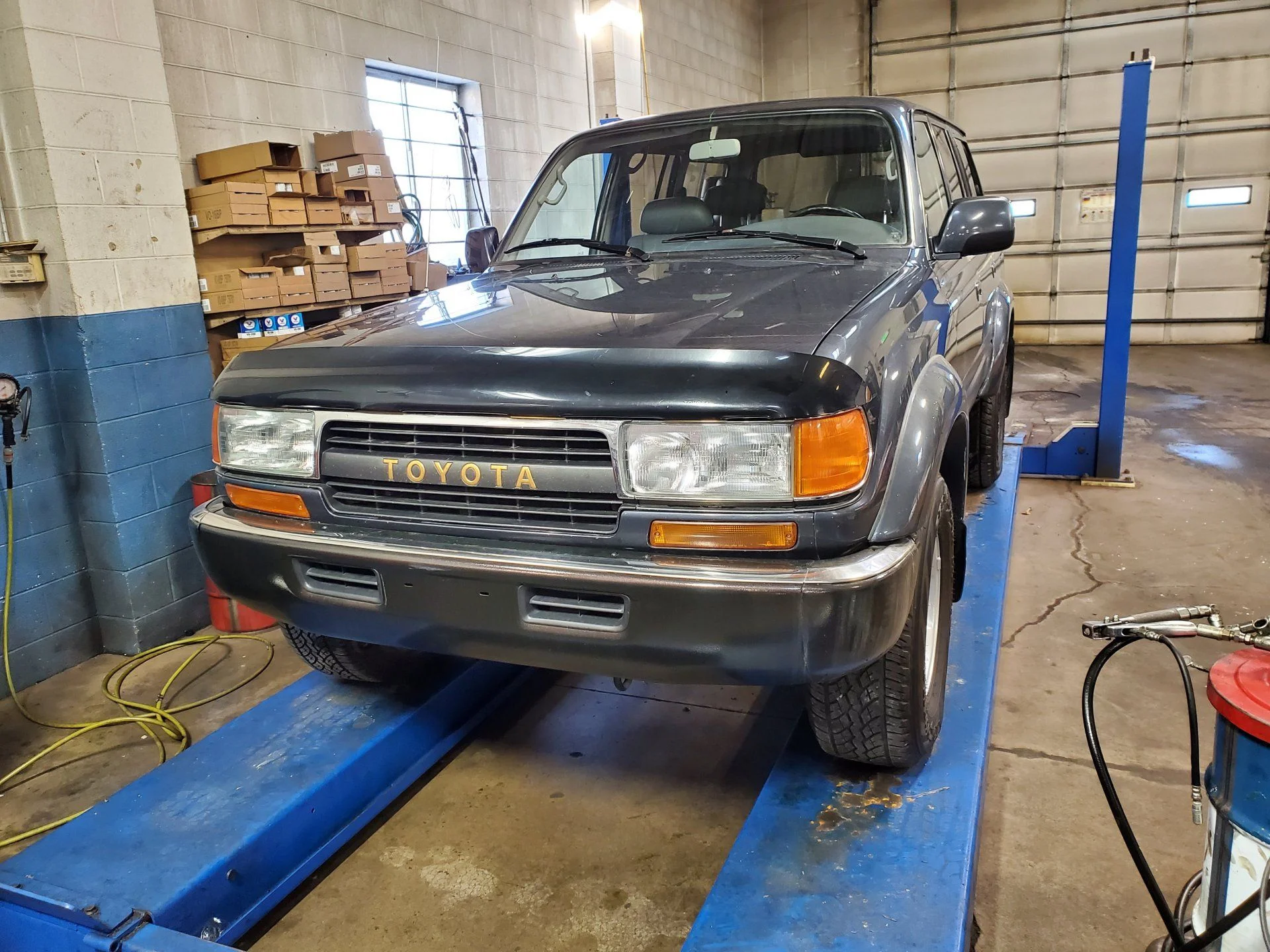

seats look clean but that's about it
Not worth that money. Rusty, and the oil cap says headgasket is gone.
10K with that rust, um, No.....looks like they tried to spray paint the front end area with rattle can black to cover up some rust....a couple K is all its worth
Nope, seen it before. That was on a Suzuki Samurai trail rig, still with sheet metal, but very few panels that were still straight/undented. Looked like it did a great job of holding that little truck together.
That expanding yellow foam is great for eliminating annoying rattles, or sounds. In fact, there's some in the roof of my K5 Blazer, between the two layers of metal. Cut down the noise quite a bit...:hillbilly:
That is a $1500 truck. There is rust in the rear rockers, maybe the front of rear wheel wells too. It is where these trucks seems to rust first. Can be fixed, but not for $10k.

You're going to need a new head gasket and the engine work associated with it, rebuild the front knuckles, and replace the dampers at a minimum. That's before you deal with the rust. The truck has low miles and lockers, and the exterior/interior looks great. I would look for rust in all the usual nooks and crannies before placing an offer. If there is evidence of rust in the rocker panels, door jams/lower door areas, right/left side of the firewall by the skirt mounts, tailgate, etc. I'd pass or offer less if you're comfortable with dealing with it.
