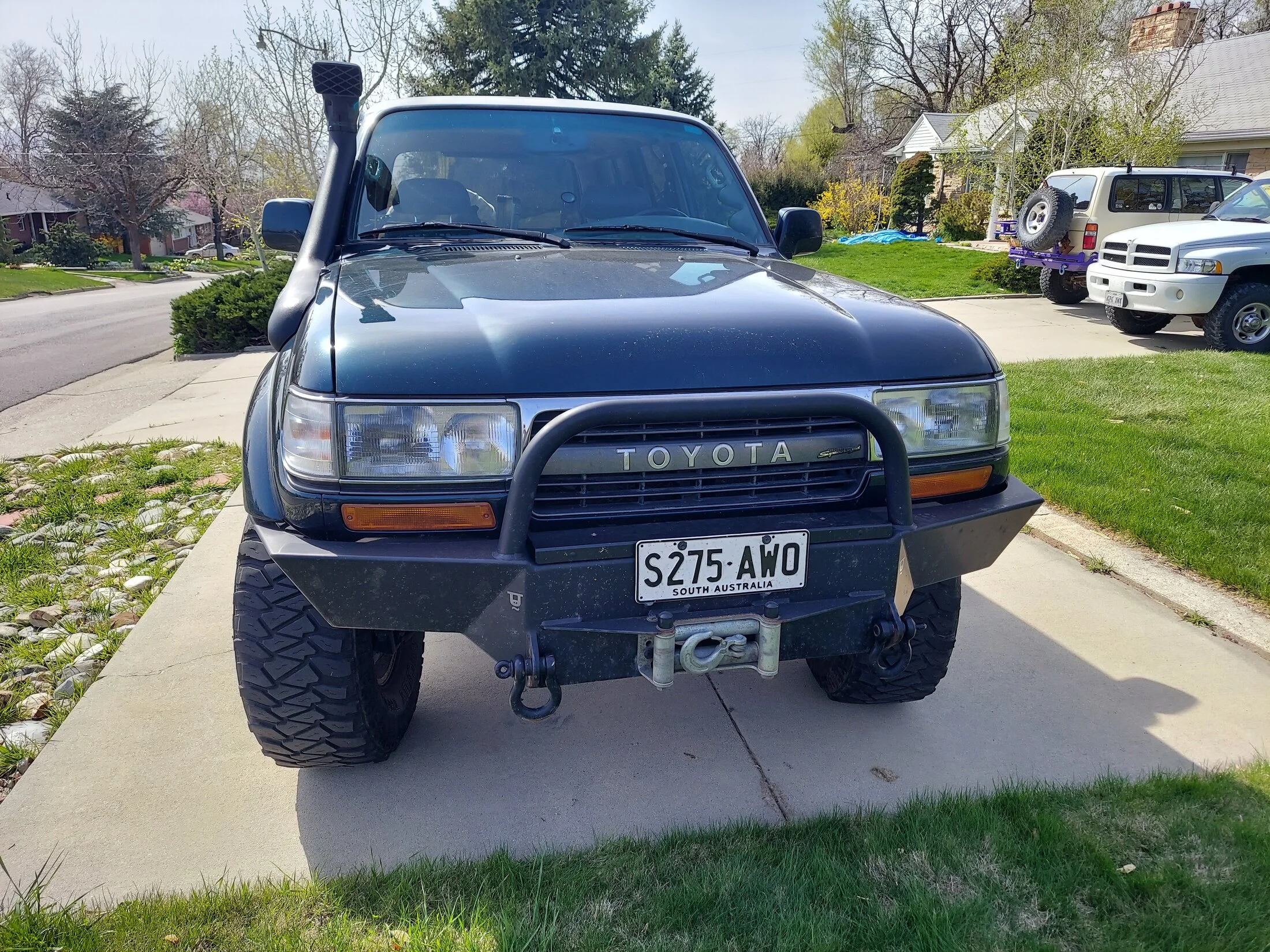

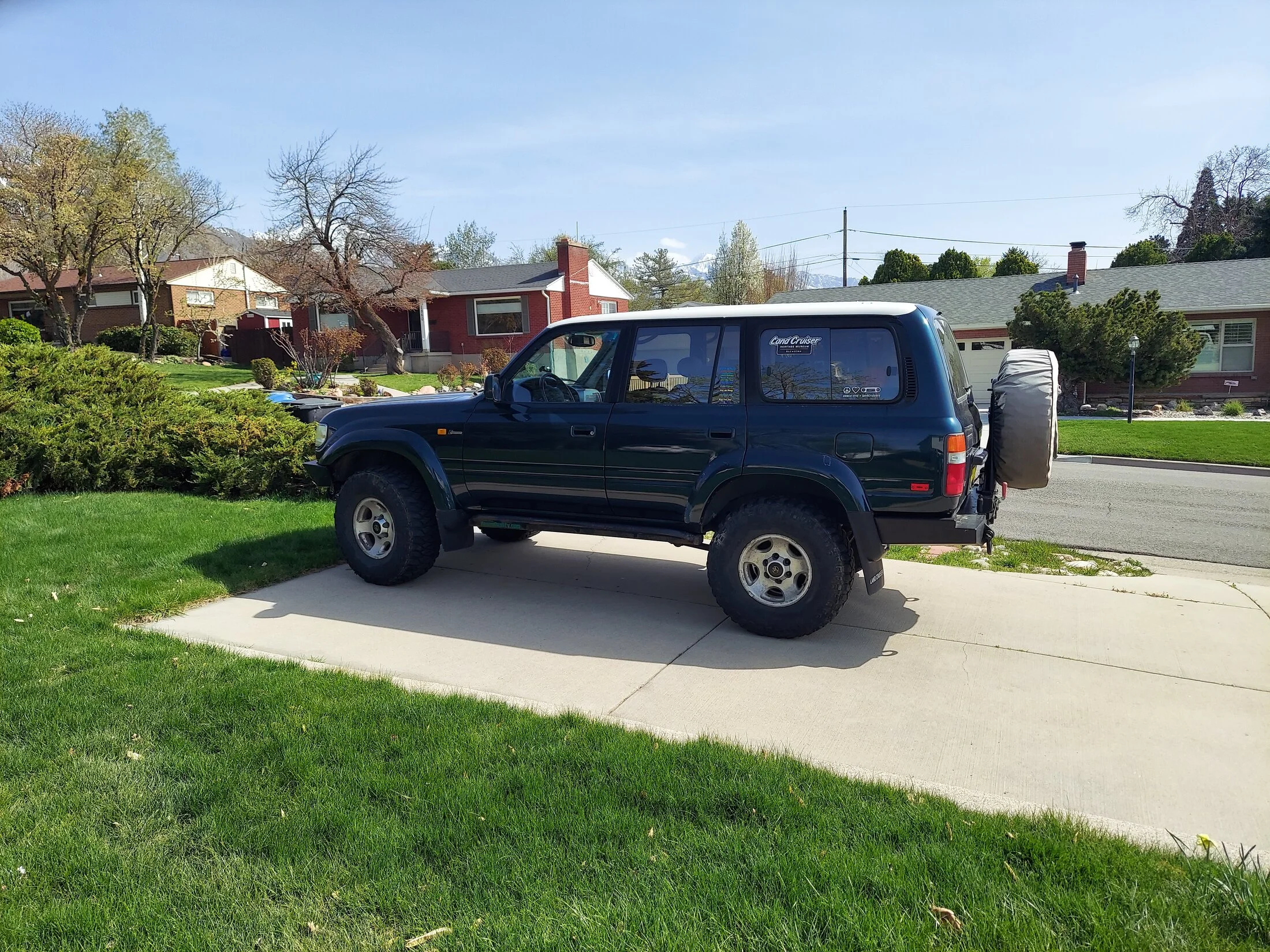

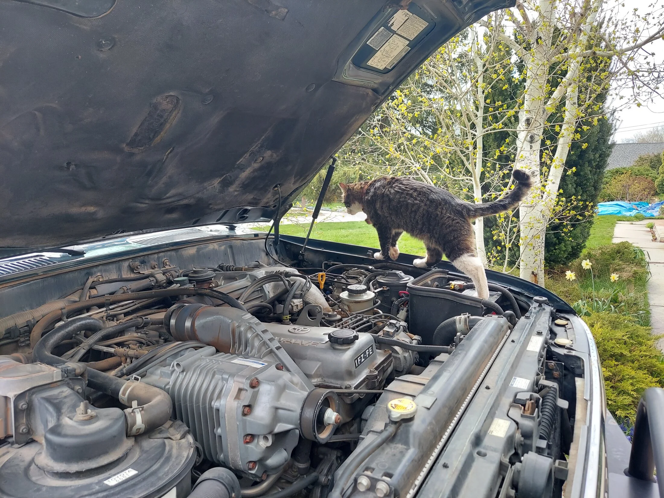

Prepping for Canyonlands

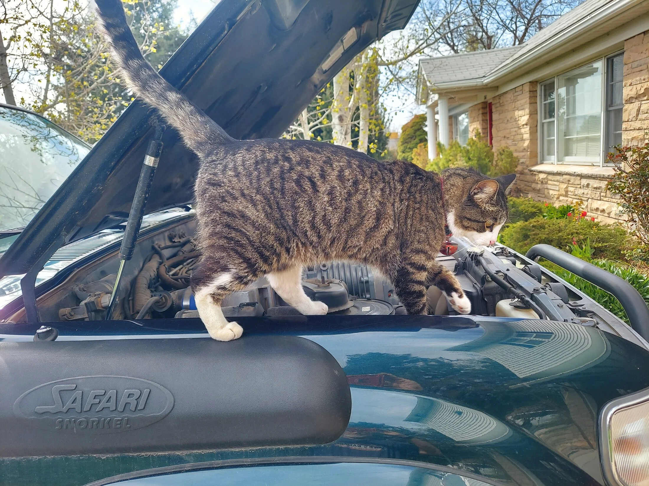

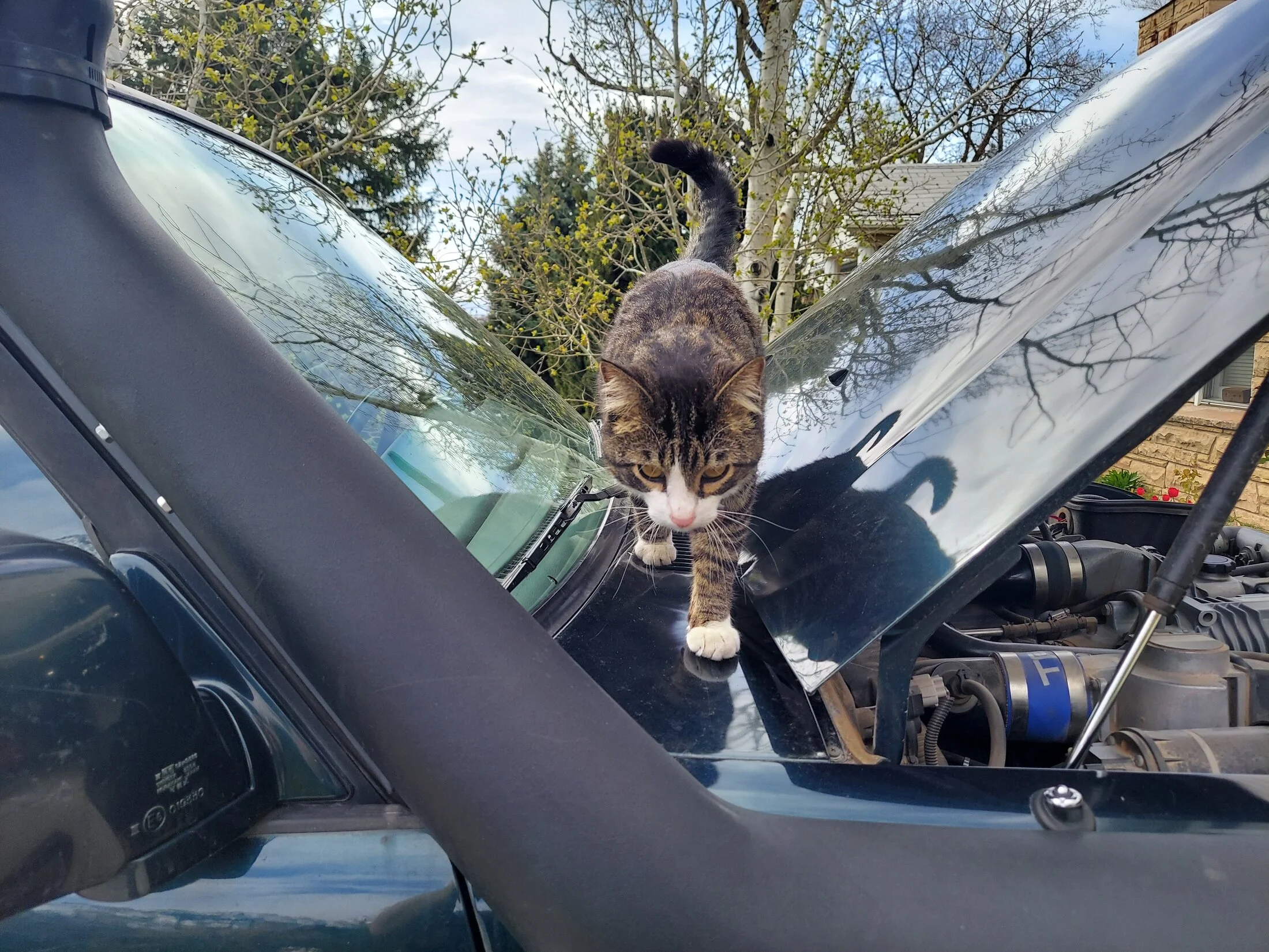

I'm prepping for a trip into Dollhouse, leaving Wednesday. My neighbor came over and provided a free Cat-Scan...
How much boost pressure does the SC provide?
The stock pulley was 3.2 inches. I'm running a 3 inch pulley. That produces ~7psi. That blower has been on the truck for 4 months shy of 25 years.
Vehicle (paint) looks to be in great condition, has it been repainted?
And you are running the stock ecu, injectors, MAF, etc. I assume so if dealerships installed the SC on request. I ask bc I’m building a 96 and going to turbo charge it to 7psi.

I installed it myself. It was the first field-installed unit on a 93-94. TRD did not intend them to fit on those years. I made it work. I also fitted methanol injection. It uses the stock efi computer and injectors. Base ignition timing is also stock.

Ok, so you've been running OBD1 with 6+ psi of boost for years with only a meth injection setup? Do I see intercooler piping too?
I've been speculating that OBD1 would be fine with a little spray of meth under 3/4 throttle/WOT. I ran a similar basic Snow meth system with a small intercooler on my old Callaway Rabbit that I was running 15psi and CIS injection and it was a beast. I did to a little to increase the fuel pressure on that one plus some other old school CIS tricks, but basically stock injection and bottom end that ran hard for years.

For a few months shy of 25 years and 156,523 miles (as of this morning). No intercooler. I do not run it "hard".
