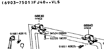

What screws are these exactly? I need to order replacements. I borrowed this pic. Thanks in advance. Tom.

The flat head cross point screws that hold the hinge to the header are "Screw - Toyota (93230-18020)" list price $1.24 at your local dealer.
They require a external tooth lock washer, 8mm, but are NLA from Toyota.
You might want to consider generic screws and washers.
For instance, Boltdepot.com has the flat head screws for (M8 -1.25 pitch, 20mm length) for $0.16 each in zinc plated steel, or $0.62 each for 316 stainless steel.
They have the external tooth lock washers in flat 8mm, for $0.07 each in A2 stainless steel.
The screws that hold the hatch to the hinge are "Bolt W Washer - Toyota (91651-40825)" list price $2.50 at the dealer.
These are JIS standard screws 12mm hex head, with integral flat and lock washers. M8-1.25 25mm long.
You may want to consider overlandmetric.com to get all this hardware as well.
