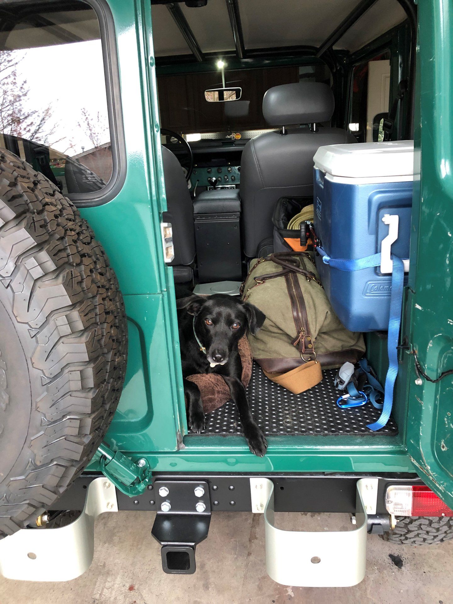

We packed up the Land Cruiser and our dog Olive won't get out. HA!

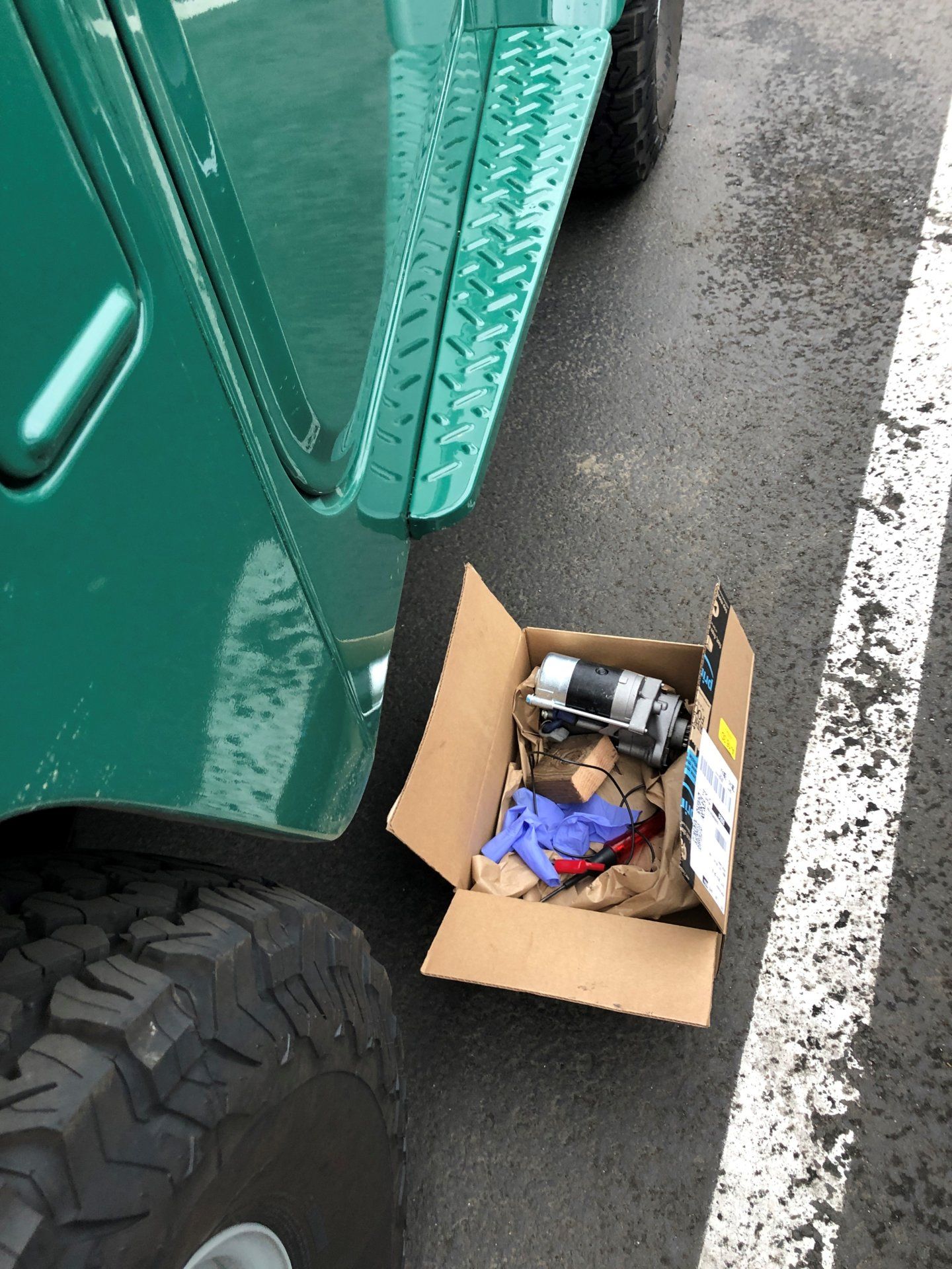

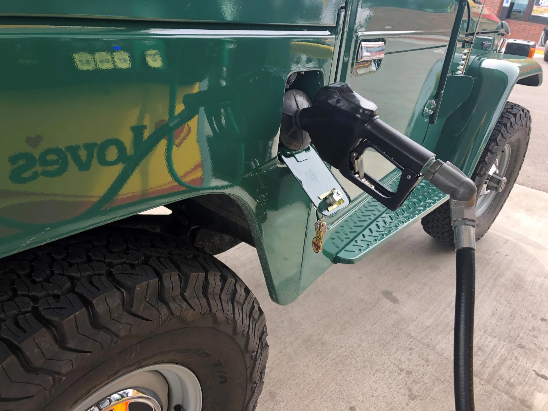

We cruised over to get some fuel (the first of many fuel stops) and when I went to restart the engine, the gear reduction starter failed again. Lots of tries later, it started up and we drove on with a full belly of fuel and zero worries.
We continued on I-90 until Ellensburg and took a beautiful detour down the Yakima River Canyon Road, which is a wonderful drive. We happened across an old fuel station so I pulled in and snapped this pic.

Then we headed to the hotel and I decided that after many, many failed starts, I'd finally get that gear reduction starter yarded out. It took 8 minutes... I didn't count getting the tools out and ready. It was like a NASCAR pit stop. Luckily it was only sprinkling.

I woke up early on the second day and wanted to check a few things on Scout before we headed out for the day. After replacing the starter with the original, it started every time. Kind of a nice thing.

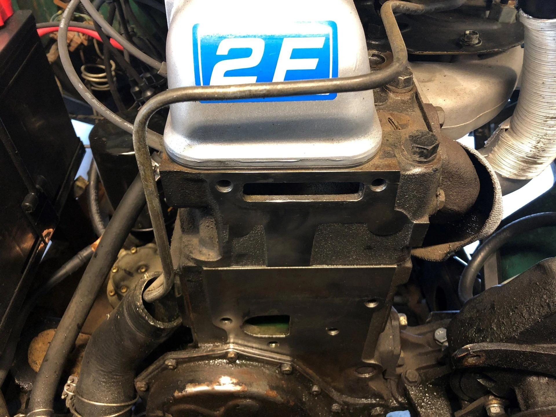

I believe my flapper valve in the exhaust manifold is non operational as there is welding evident in the two large holes where the flapper pivots.
I purchased a Felpro IN/EX gasket a week ago, knowing I'd need to start by removing the manifolds. Let the fun begin! Have you seen my torch and penetrating oil?

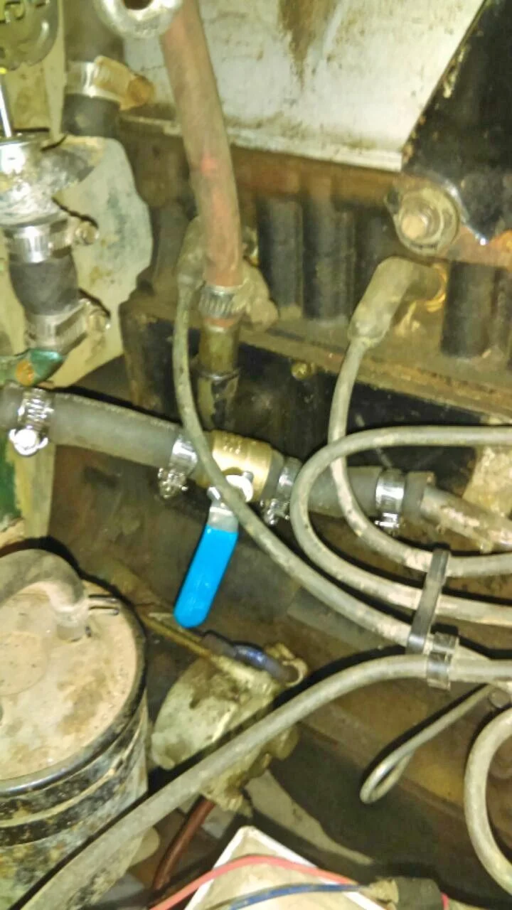

I just did the ball valve modification over the weekend. I put mine near cyl #6 and confirmed it stops the heated coolant from entering the cab. :D

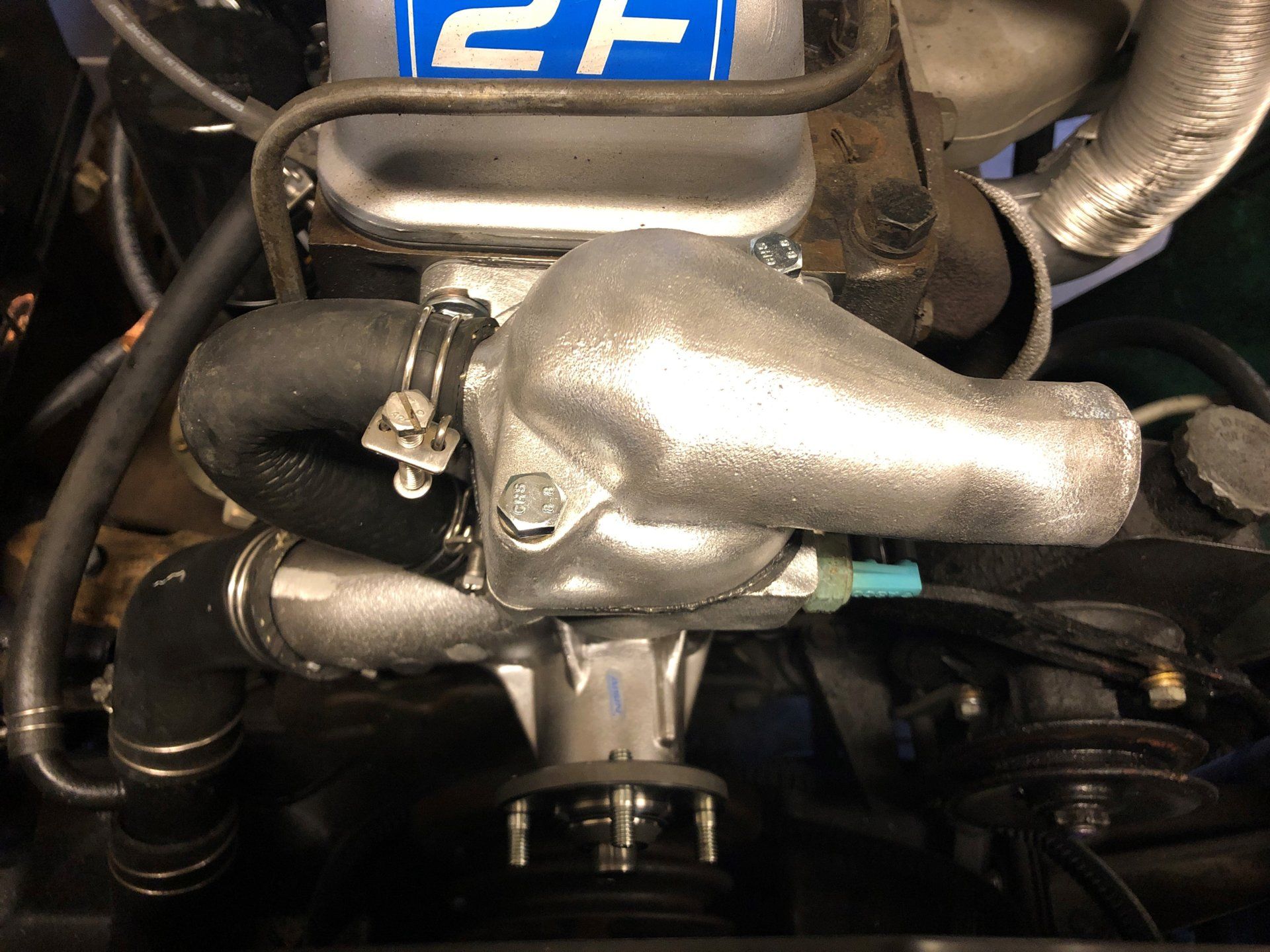

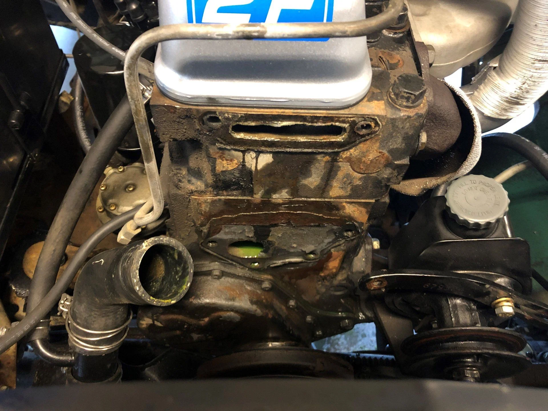

Today I replaced the water pump and thermostat along with the applicable gaskets. I found some interesting things in the process that may have led to my minor overheating issues.

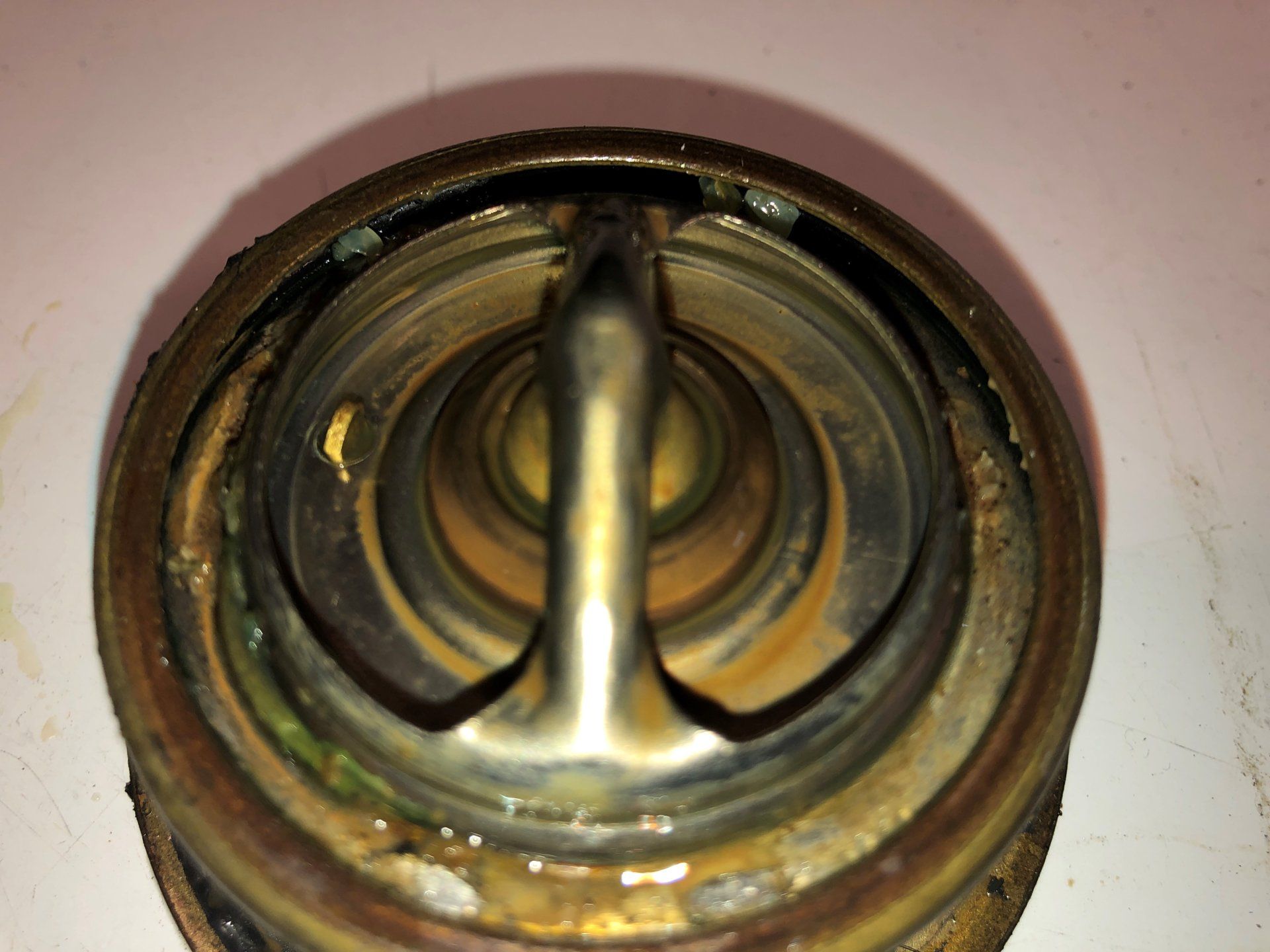

First, I separated the thermostat housing and noticed the t-stat gasket was under the t-stat which is not how it's supposed to be. Then I took a closer look at the t-stat itself and I noticed it's bent/broken and not OEM, also there are little pebble like things in between where it is broken.

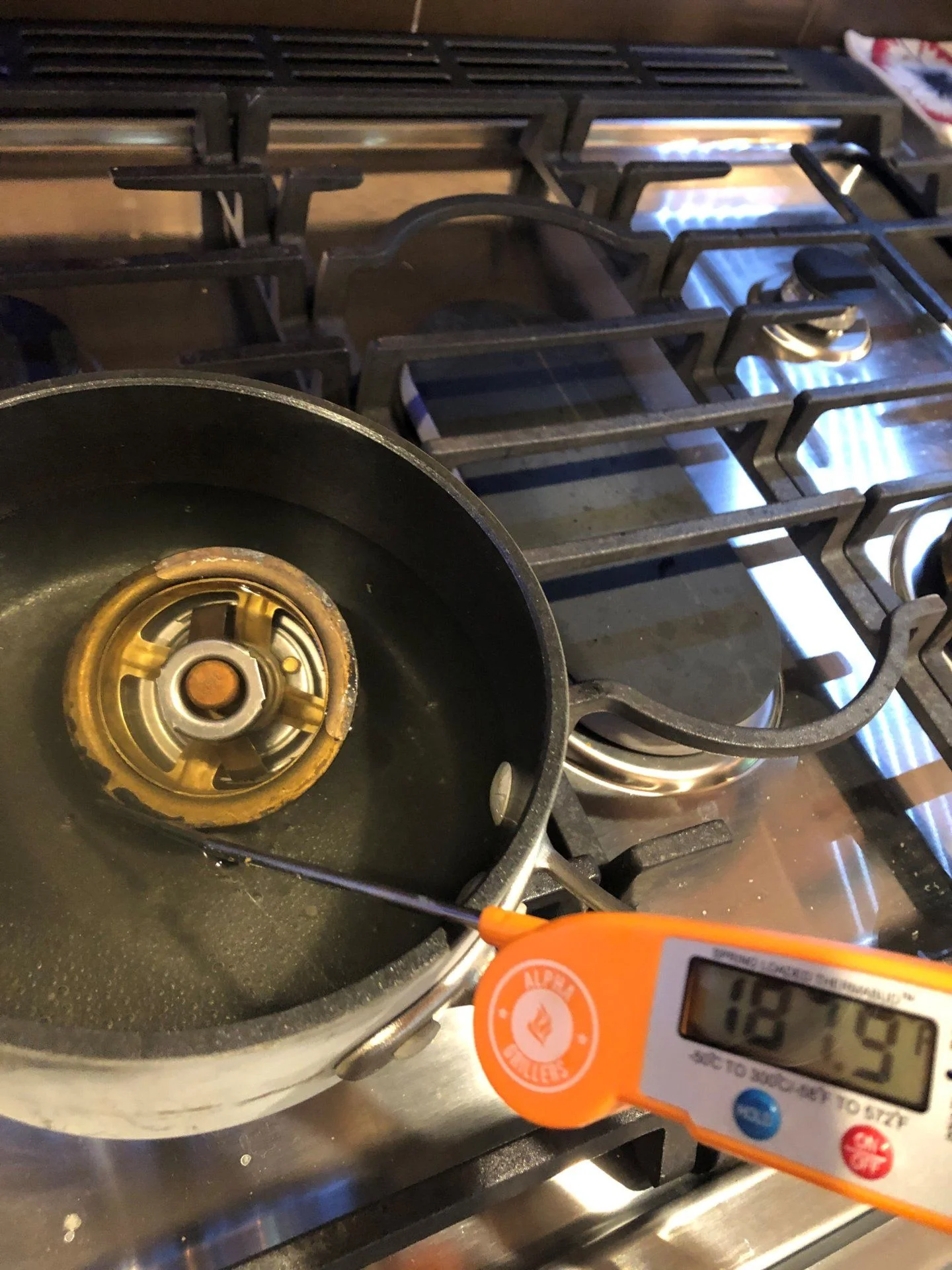

I tested whether this thing opens properly at 180 degrees and surprisingly it does. Just not evenly as the picture below shows. It kind of opens sideways, which could cause a coolant flow blockage. Notice how the copper center is, well... off center.
Then I took a look at the block and noticed that the lower thermostat housing was attached using a gasket with a smaller opening than the hole in the head and smaller than the OEM one I'm replacing it with. I don't have a good picture other than the dirty vs clean pictures below, but I think it's evident. Add to that... the person who put the thermostat in, clearly had a deep love for black RTV silicone because he used about half a tube on between the t-stat, lower housing and water pump.
I matched the OEM lower thermostat gasket up with the hole in the head and it matches up perfectly with no overlap like the old one had. These two things along with the fact that the thermostat and the water pump were not original could have contributed to my heat issue.... I guess only time will tell.

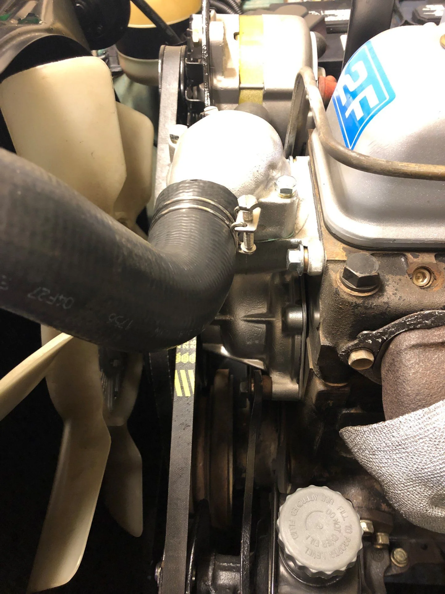

Here's a mostly done picture. I'm waiting for some items to dry before I bolt it all back together.
After I buttoned it up last night, I took it for a spin. It was only a few miles, so I really wasn't able to tell if the mild overheating issue is fixed, however part of me believes it could be. With the lower thermostat housing gasket/RTV silicone mess gone and the thermostat not being broken/bent, it can't help but flow coolant more efficiently.
It also gives me some peace of mind knowing OEM items are going back in. There is a noticeable quality difference when looking at the water pump casting on the inside. The impeller blades are closer to the housing on the OEM and the overall fit and finish of the entire assembly seemed higher quality.
Also, I just want to point out something I did with my water pump replacement which was recommended on this site. I took the backing plate off my new pump and put a very thin layer of black RTV on the housing where the gasket seals and then on the gasket where the backing plate sandwiches the internal gasket. Thanks for the tip Mud Members!!!
If nothing else, it's good knowing the pump and t-stat are new in my search to find the cause of this issue.
