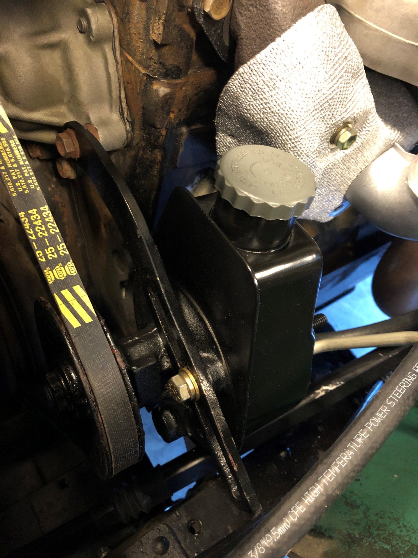

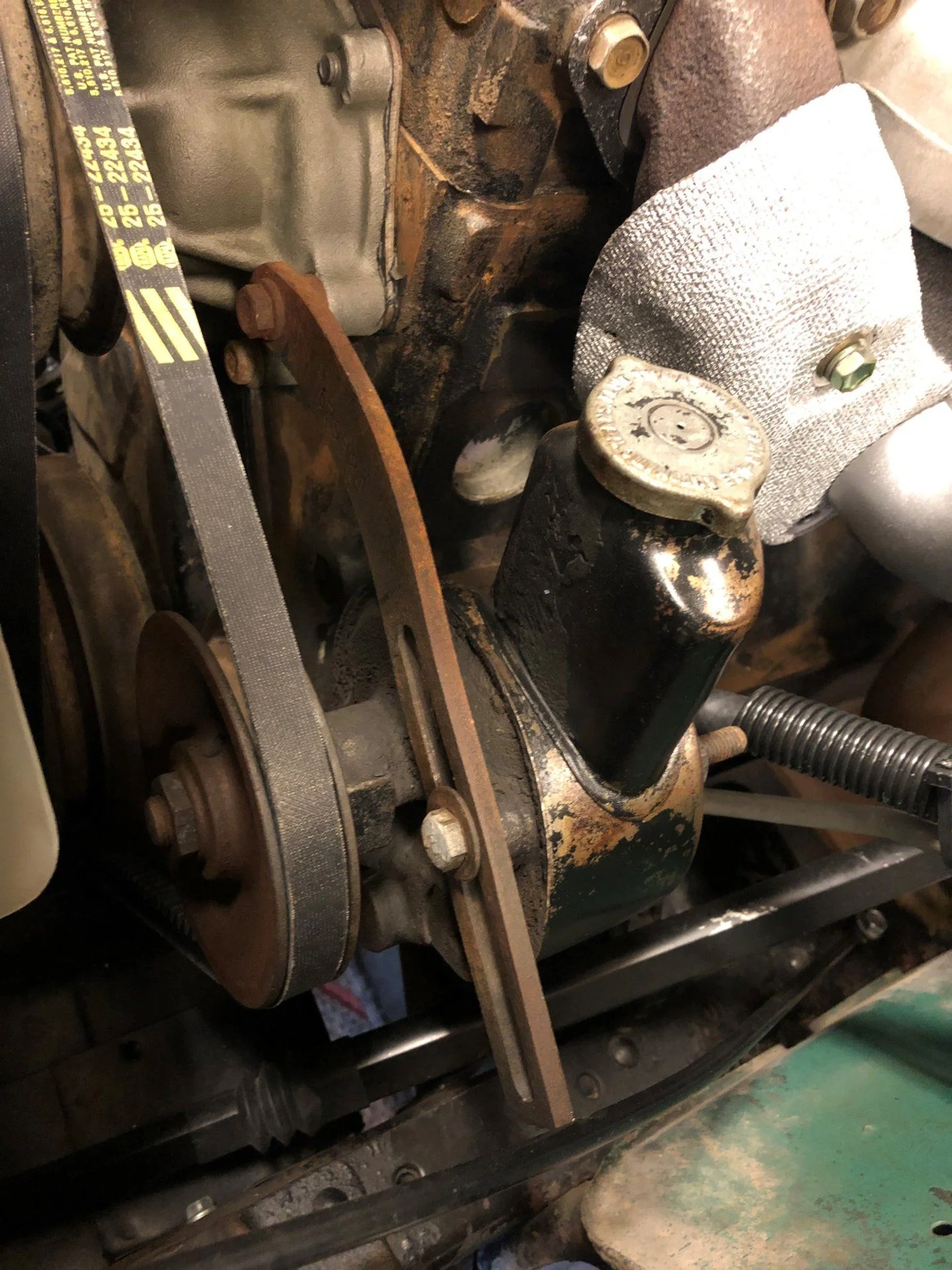

I replaced the crusty, noisy and badly leaking power steering pump below.
The studs at NAPA helped me pick out the right replacement and order it. Installation was a breeze.
I then got to thinking about the oil flow again and something the PO told me popped in to my mind. He had replaced the 10w-30 oil with 20w-50 because he felt it would burn less oil with thicker oil. After replacing the valve stem seals it appears to have done the trick at completely eliminating the oil burning. So I dumped the thick oil and put in 10w-30 and took it for a spin. Man, what a difference! It idles better, seems to have a bit more power and this is going to sound crazy but the shifts are smoother. I think the super thick oil was causing some unnecessary drag on the internals of the engine.

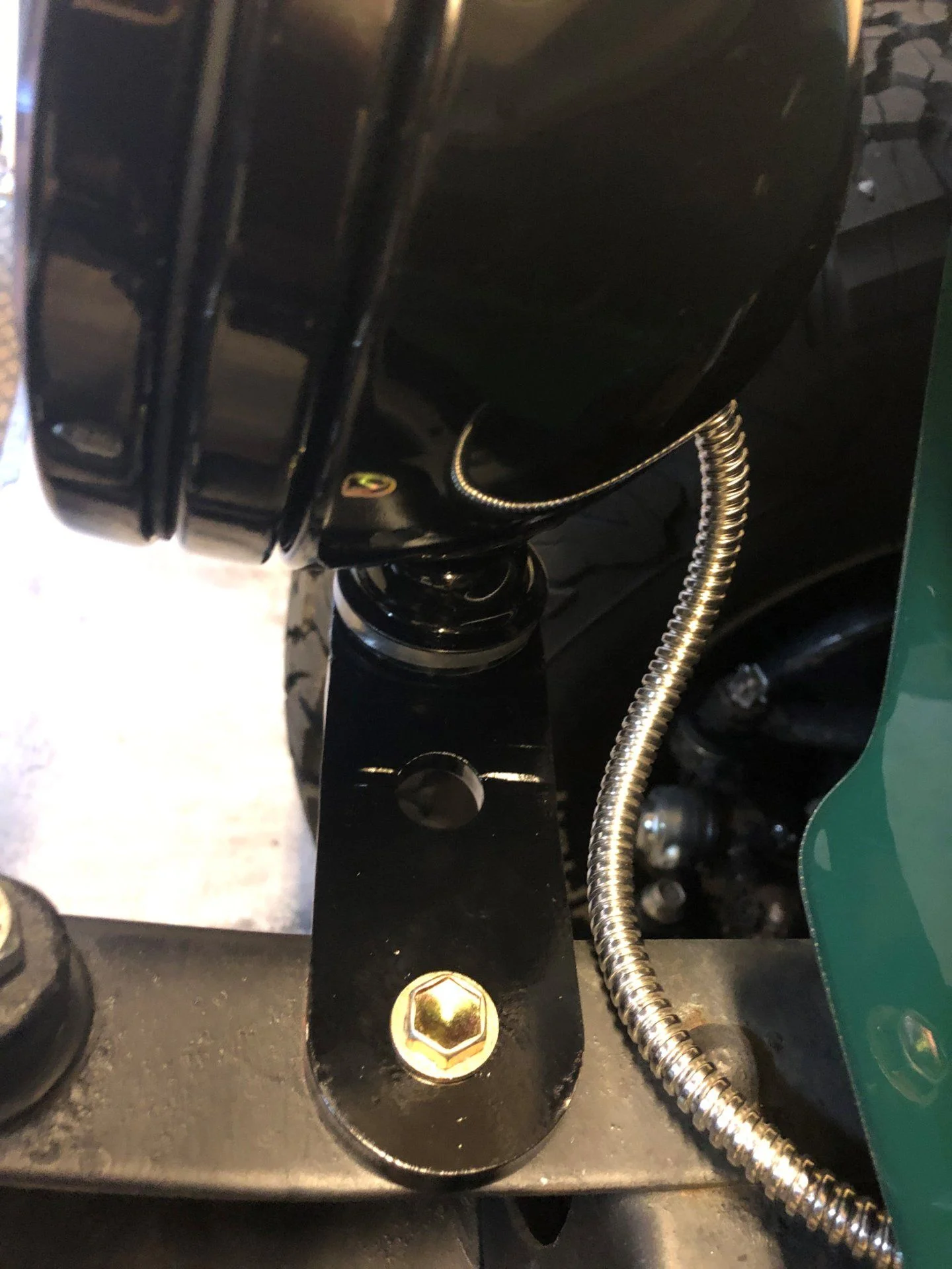

Then I installed these auxiliary lights connected to the high beam so I didn't have to put a separate switch in, just push the turn signal stalk forward and the high beams plus these lights come on. They are KC Daylighter 6" LED driving pattern lights.
I found some shackles on Amazon that I used to mount them up...

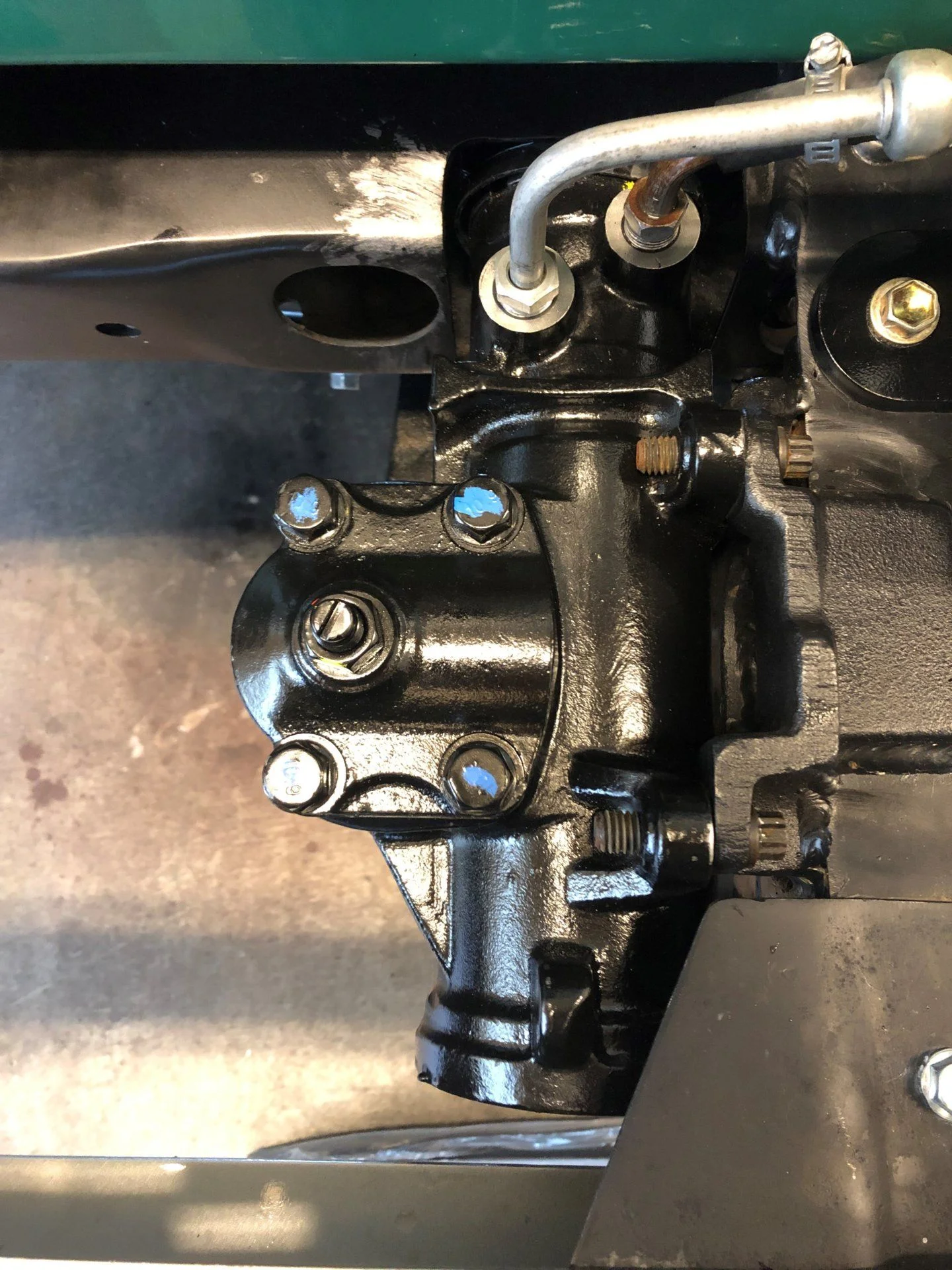

When I replaced my power steering pump, I needed to remove the high pressure line, in order to get a fitting so the old high pressure line would fit on the new pump. I carted that line down to NAPA and then to PIRTEX and then used the fitting to reinstall it. Well, what I didn't realize I did was I over tightened the high pressure line on the steering gear box side.
So when I went to take the cruiser out on a dusk drive to check out the headlights, I pulled it out of the garage and noticed a spot of oil on the floor under the gear box. Upon further examination, I noticed the high pressure line was leaking. I figured, maybe it's loose, so I grabbed a wrench and checked it.... it wasn't loose, the threads had stripped.
Shoot! I needed a new power steering line, damn! So I removed it and was going to bring it somewhere for a replacement and I noticed something... the threads on the hose were perfect.... it was the box that stripped. NOOOOOOOOO!!!! So essentially 2 crisp Benjamins later and I now have a new (reman) steering gear box on my FJ40. Not the end of the world, but I can think of a whole hell of a lot of things I'd rather spend $200 on! The icing on the cake... the gear box I stripped was new from the PO.
The good news, NAPA had the box at a warehouse, it was 12 hours until I'd have it in my hands, and I needed to buy a pitman arm puller anyway because I didn't have one.
The moral of the story here is this.... I need to slow down and be more careful. It's easy to get excited and slam things back together. It's also easy to only share the good things online and not the bad, but I want this thread to be helpful for others, and I for one like to learn from other people's mistakes, so hopefully this helps someone else.
Don't tighten the hydraulic lines on your Saginaw power steering box like your life depends on it. They simply need to be snug.

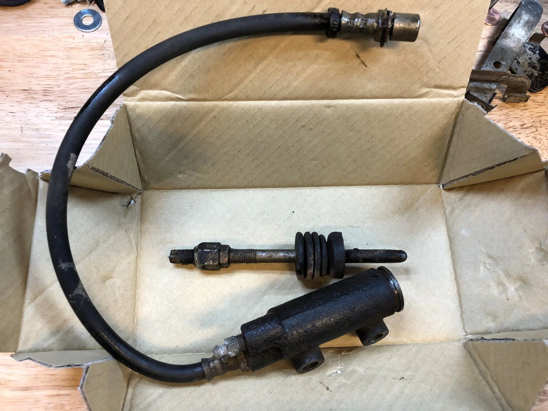

On a slightly more "perfect timing" kind of note... I ordered a new clutch master/slave and stainless braided hose a week ago because of the road trip we have coming up.... and Lee's experience in Pueblo (Saving The Old Rustbucket story).

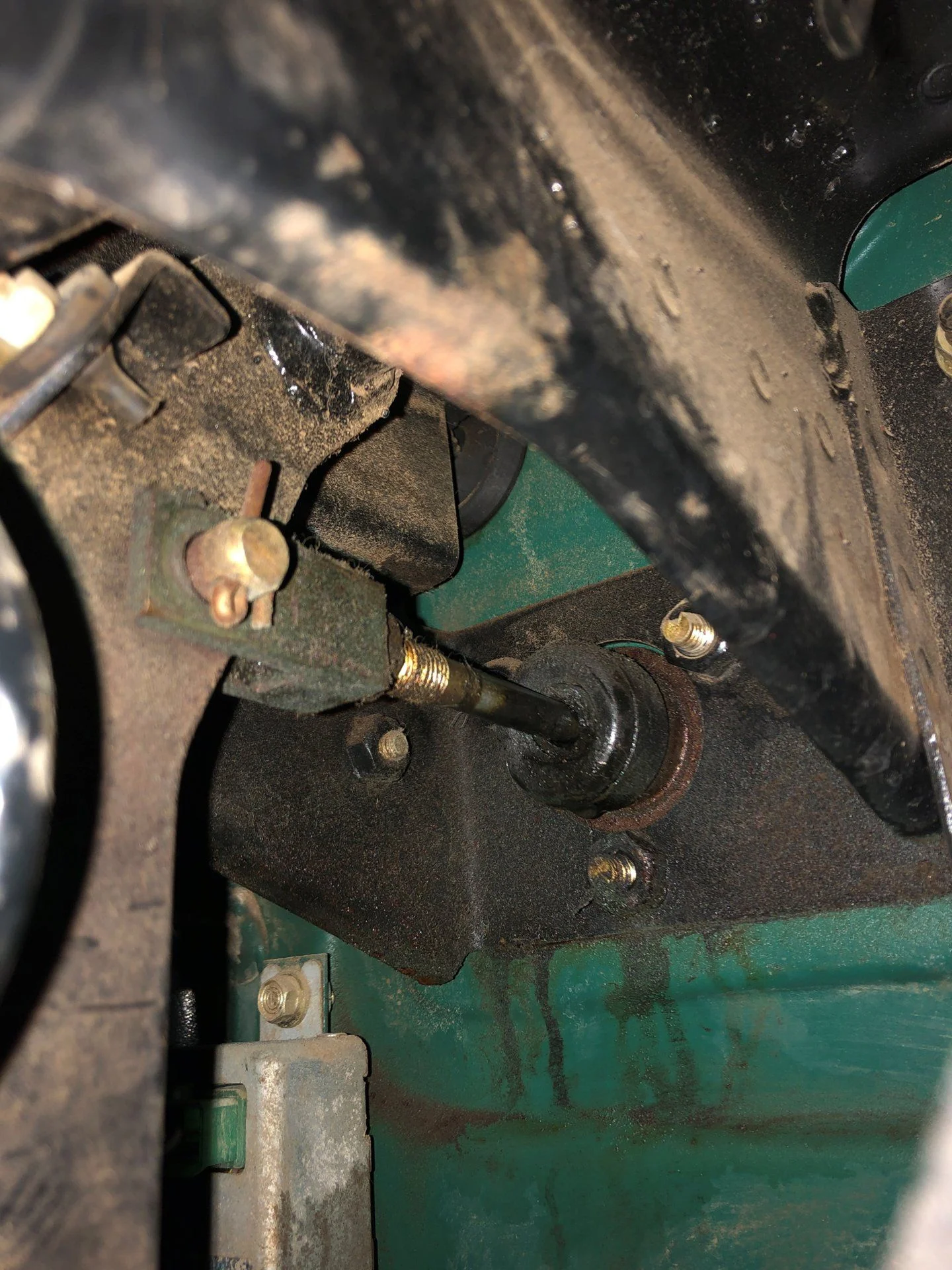

The master and stainless hose came in so I thought I'd take a quick look under the dash at what it takes to replace it. Lo and behold that crusty master cylinder isn't just crusty, it's also just started leaking on my fire wall.... So at least I have what I need already on hand.
The slave is already wasted and leaking some fluid, but I don't have that just yet.... fingers crossed I get it before we leave. Even if I just toss the part in the back of the rig as we head out the door it will give me peace of mind knowing I can change it in parking lot if I need to.

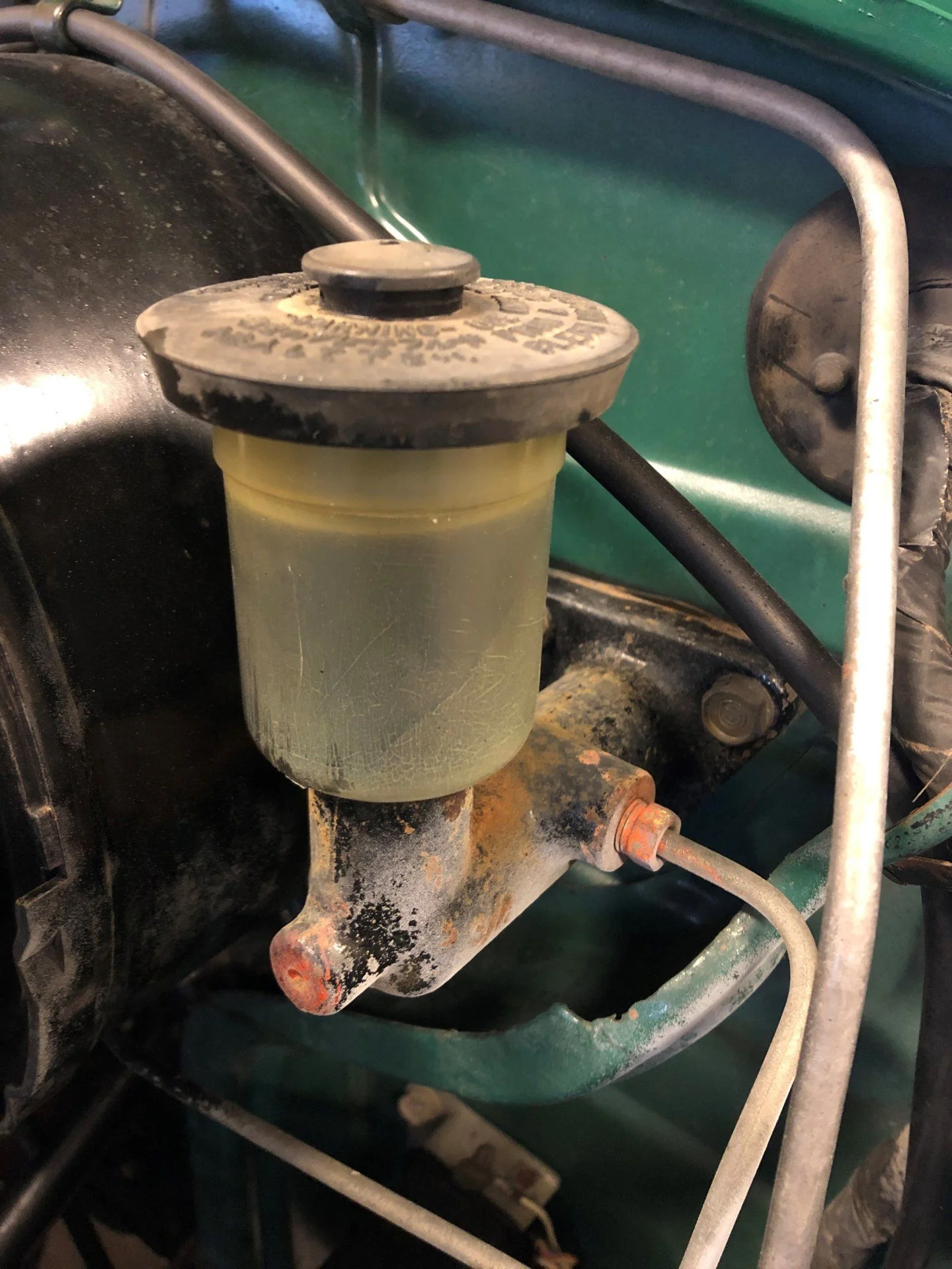

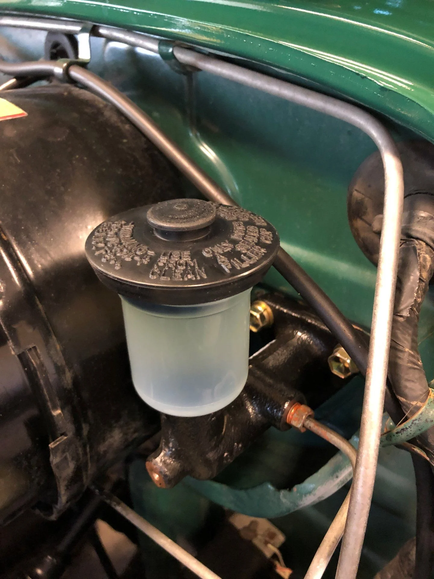

Here's some pics of that master cylinder... it's a peach.
Notice those cracks in the reservoir, the black fluid and 3 different paint colors on it? The firewall leaks look like they've been there for a while too. Yep, this thing just spent 3 months at a Land Cruiser specialist. Not impressed, but it gives me something to do I suppose. :confused:
Every time I opened that hood it was just begging to be ripped out of there and replaced. I'll see if I can get to it on Sunday and who knows, maybe the slave cylinder will be here by then... it's also leaking, crusty and is begging to be replaced.

I spent a little time today replacing the clutch master cylinder. The old one was leaking, crusty and the reservoir was very badly marked with surface cracks. It took about 30 minutes to replace it. I also installed the stainless steel flexible hose between the slave cylinder and hard line attachment. I'm still waiting for the new slave cylinder so I can button everything up and use my cool vacuum tool to bleed the system.
Old master cylinder
New master cylinder (I also installed new bolts while I was at it)
Super easy job to do and just like many of the items I'm replacing, it's 50% piece of mind and 50% because it's starting to fail, could fail or if it did fail it would leave me stranded.

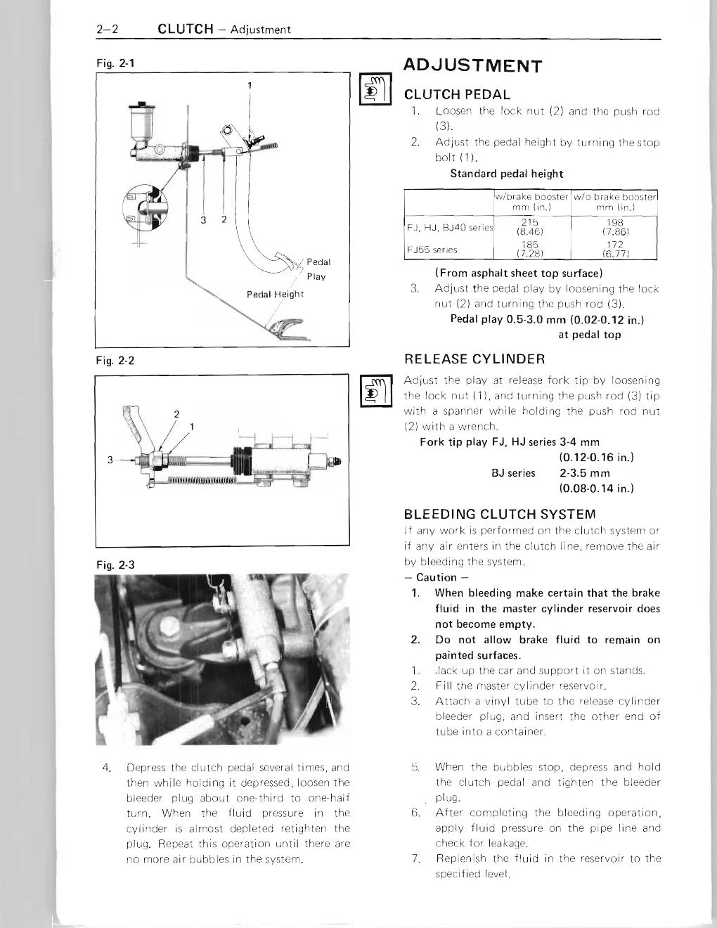

First the good. I installed my new clutch slave, it went on in about 10 minutes, super easy. There are plenty of posts here on how to do it. Mine was a hammered, sloppy, leaking mess. For the slave and the master I used OEM parts because they're relatively inexpensive and I believe in their quality.
I used some instructions that someone was kind enough to post here on Mud, so I'll re-post it for those of you who are like me and still waiting for my FSM.

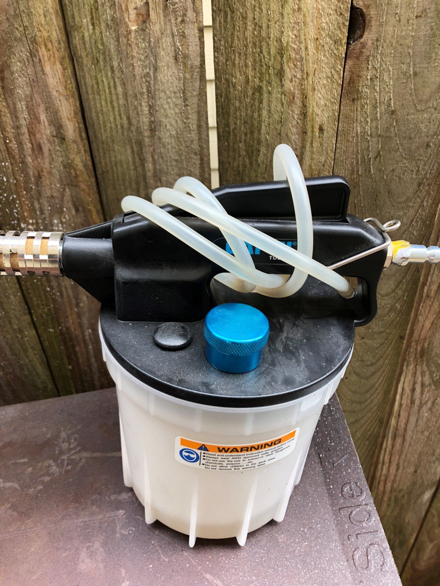

For the bleeding, I used the tool below. It made the bleeding of the clutch system a 1 person job and done in about 3 minutes. It makes it so easy you second guess yourself and end up using it a couple of times just to make sure no bubbles are left in the system. I picked it up on Amazon a few years ago.
I drove it a few times and the clutch works perfectly.

I can't read it, what's the brand name on that bleeder pictured?
I just test drove Scout with it's new brighter eyes and I can confirm that the changes I made in post #45 improved the night time visibility by leaps and bounds. Plus the headlights stay brighter at idle. If you have a vehicle with 7" round headlights, the Hella ECE housings with those LED bulbs and a dedicated harness with separate relays makes a huge difference. Total cost about $120 and total time installing and aiming the headlights might be 1 hour. Add in those KC Daylighters and I doubt you'll need much more light for normal night time rainy driving.
It's a Capri Tools vacuum brake bleeder. It's roughly $85 and I found it on Amazon.
Amazon product ASIN B00OM751EC
It made bleeding the clutch system super easy. No more of that... "Hey babe, can you help me in the garage for a minute.... you sit here and push the pedal while I tell you UP, DOWN and HOLD and fiddle around under the hood." HA!

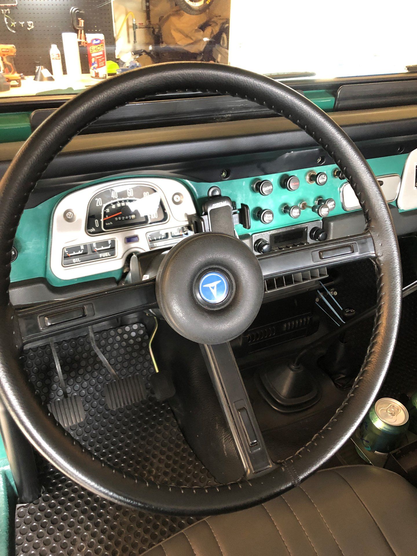

I like the factory steering wheel diameter but it's pretty skinny. I found this on Amazon for $13 and it took about 30 minutes to install. I'm not going to pretend it wasn't a bit of a pain to stretch it around the wheel but damn it looks nice!
Here's a link.... Amazon product ASIN B01L8NUQSS
The size I used was L- I needed to warm it up a bit, so I threw it in the microwave for 15 seconds and then 20 seconds. It was still difficult to stretch around the wheel but I didn't want it to be loose.

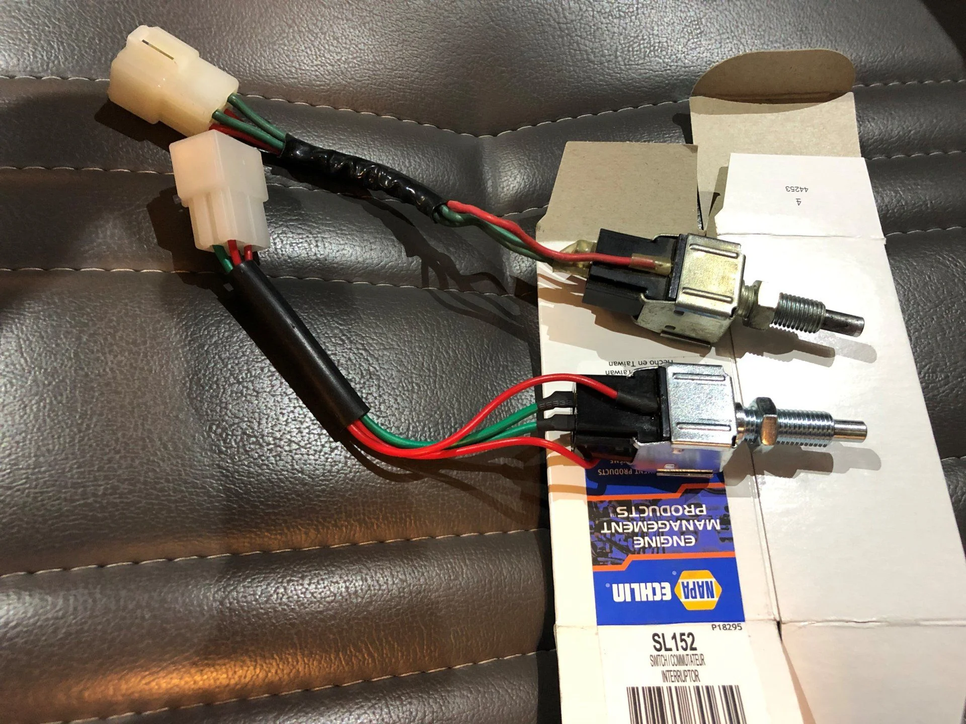

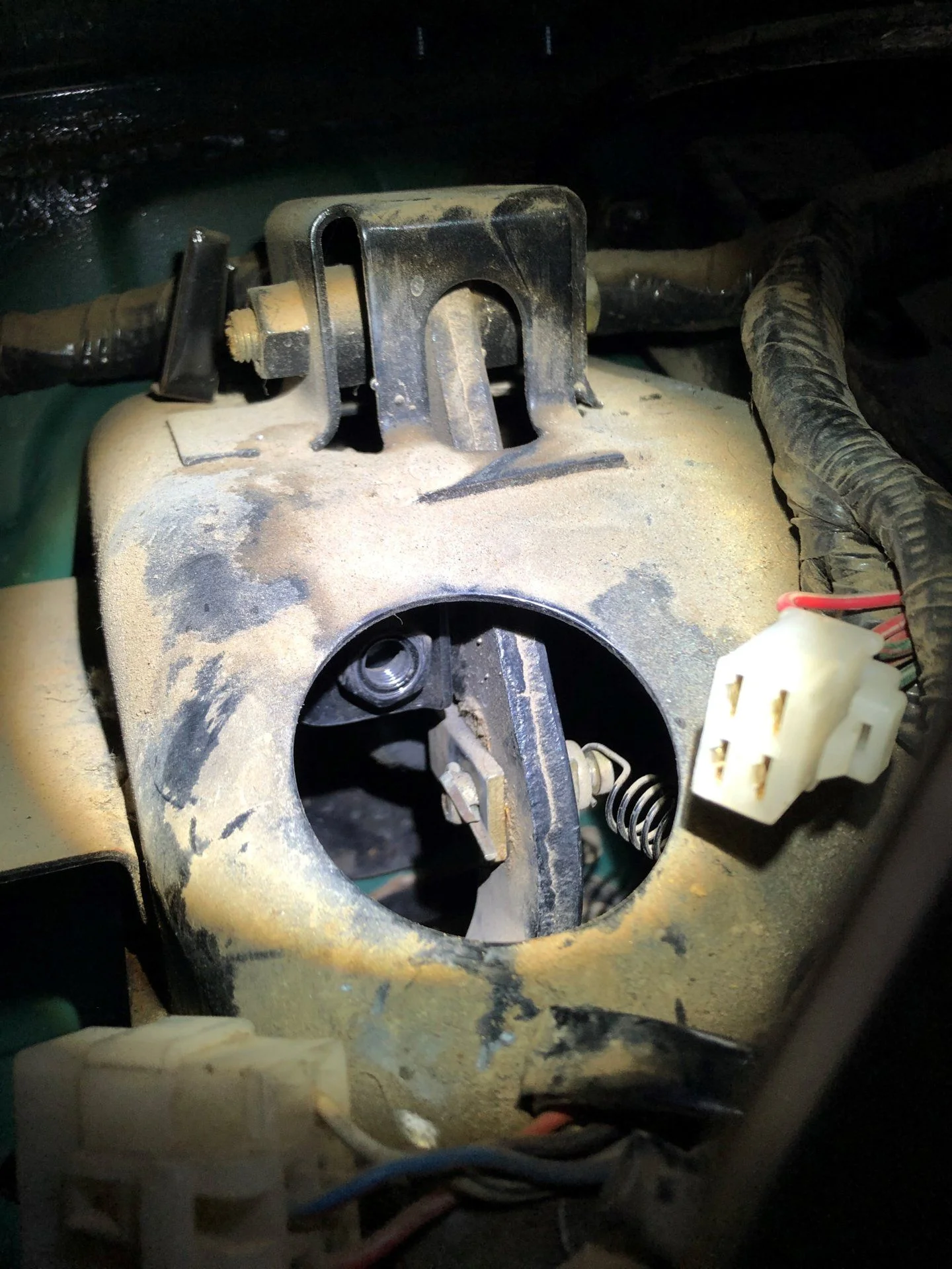

So I completely forgot I ordered a new brake light switch from NAPA a couple of days ago. Mine was intermittently not working and I didn't want to get backdoored by a 18 wheeler while on our trip. It's part number SL 152 from NAPA and about $26. It took me less than 10 minutes to replace it.

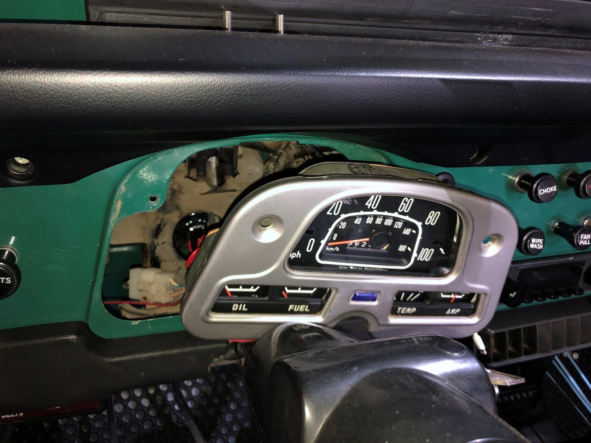

First, remove the two screws for your gauge cluster and pull it out of the way, no need to fully remove it. Also take a 14mm and loosen the jam nut on the pedal plunger portion.
The brake light switch will be right in this empty spot, threaded in to those threads you see in the 11 o'clock position in that big hole. Unplug it and then unscrew to remove it. (it's dusty in there!)
Here's the old one and new one for the poser shot to make it look like I know what the hell I'm doing here. HA!
I used the approximate location of the jam nut to get the position about the same on the new one. Reverse those steps with your new one and you're good to go.
