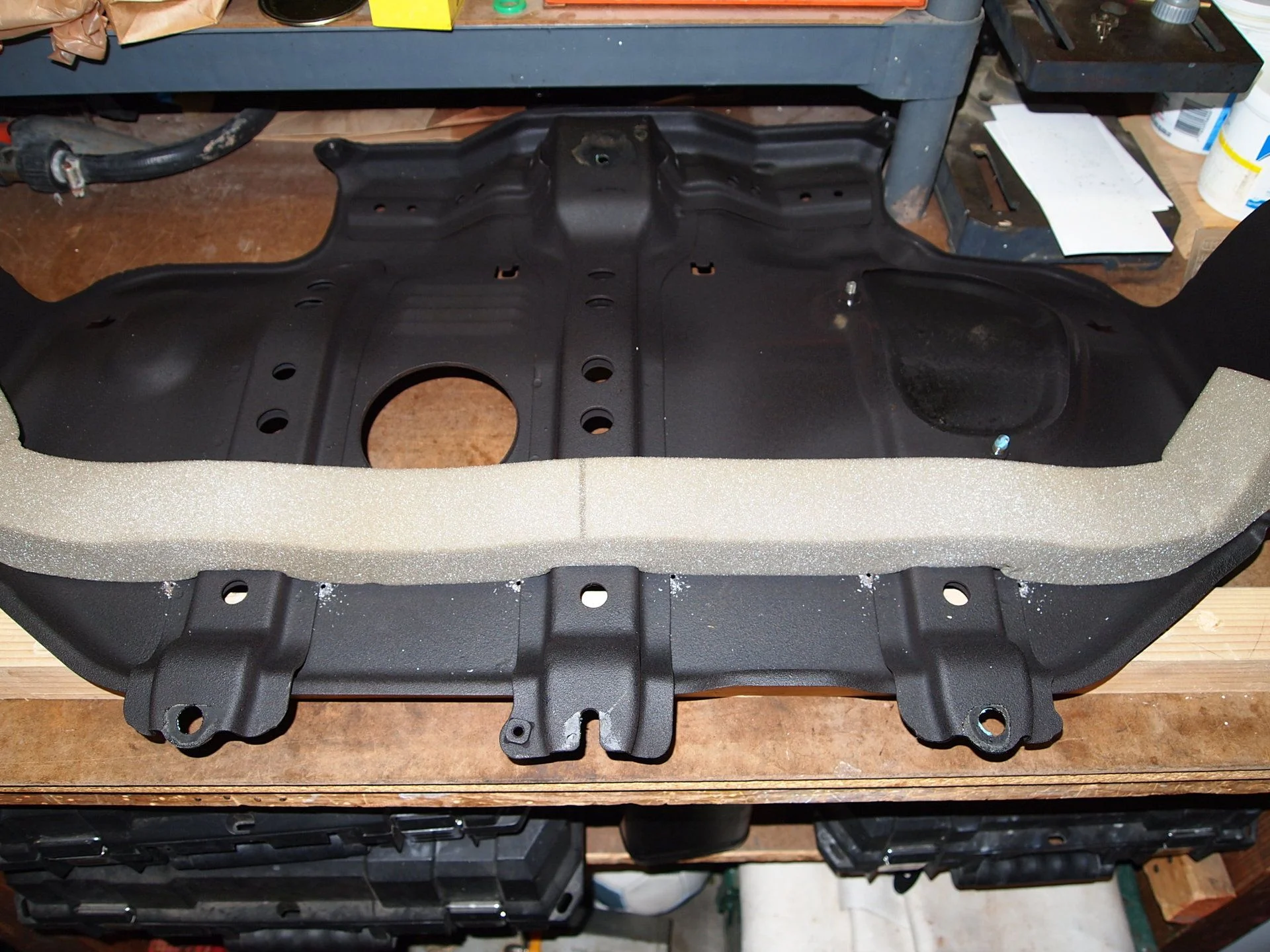

Here is one I replace in 2013 on The King. I also drill some small holes (painting afterwards) as water weeps.

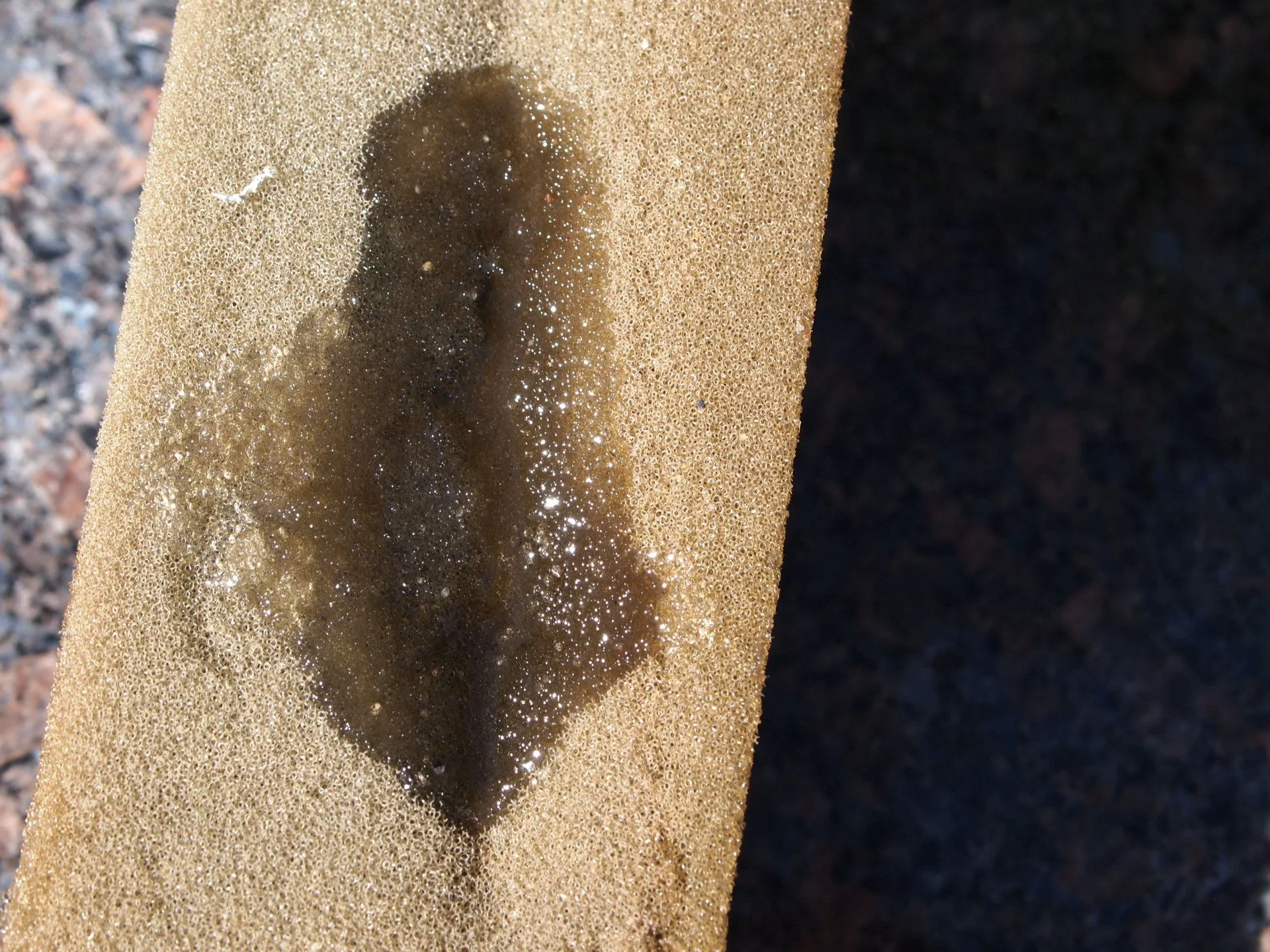

These foam pads, as they break down over time, absorb water holding it like a sponge. I real bad rust promoter.

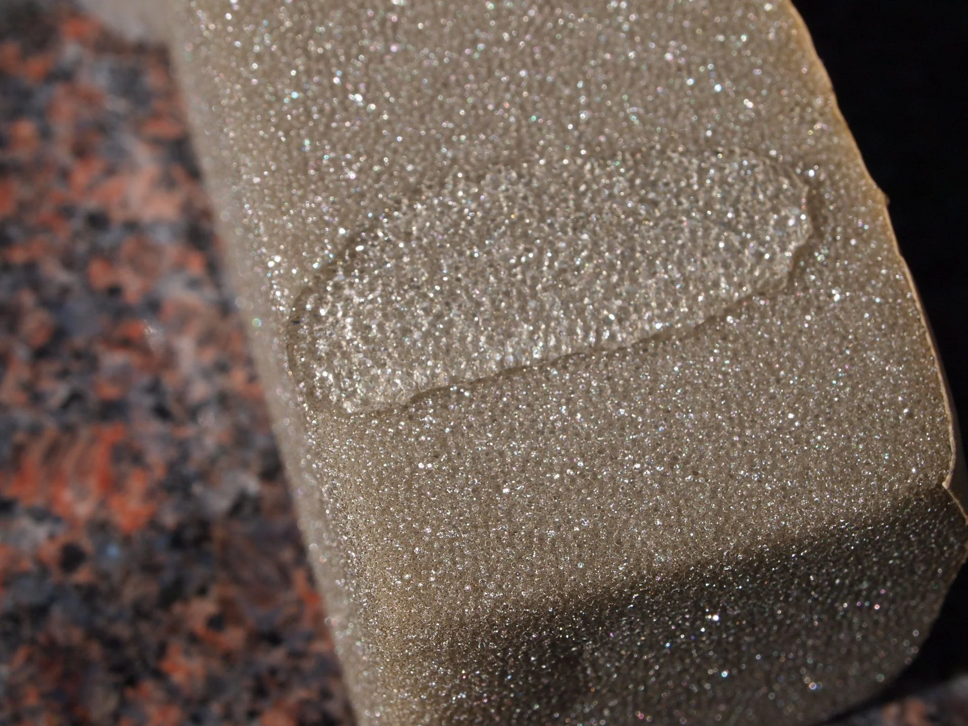

Here you can see how new foam pad repels water.
