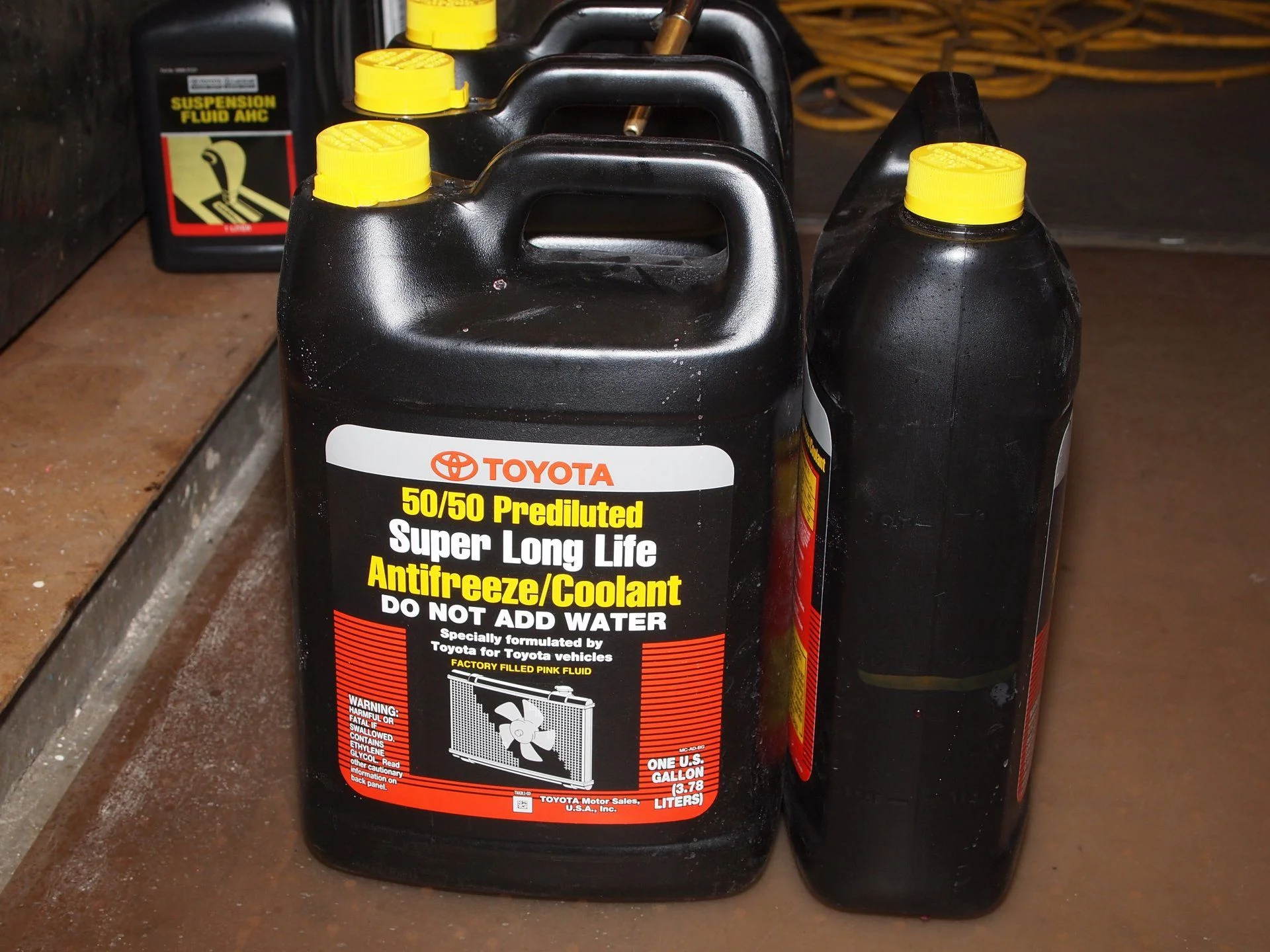

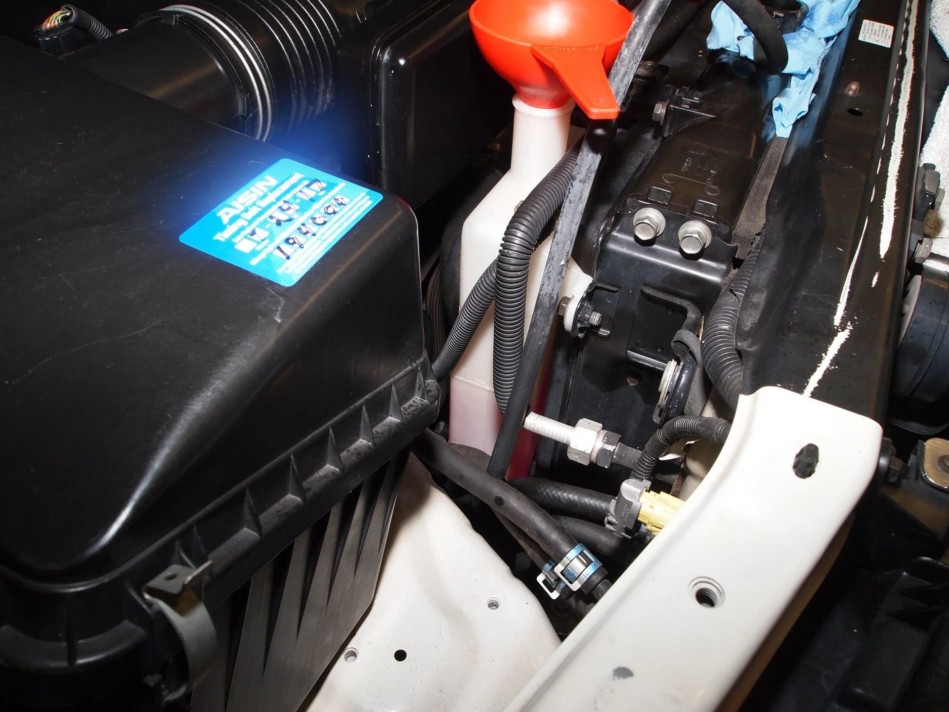

Adding coolant now. It takes a few cycles of cool down over night to get burped.
I bring reservoir to full line only on first fill. Next few mornings I'll top radiator, and bring reservoir up only to low line/cool

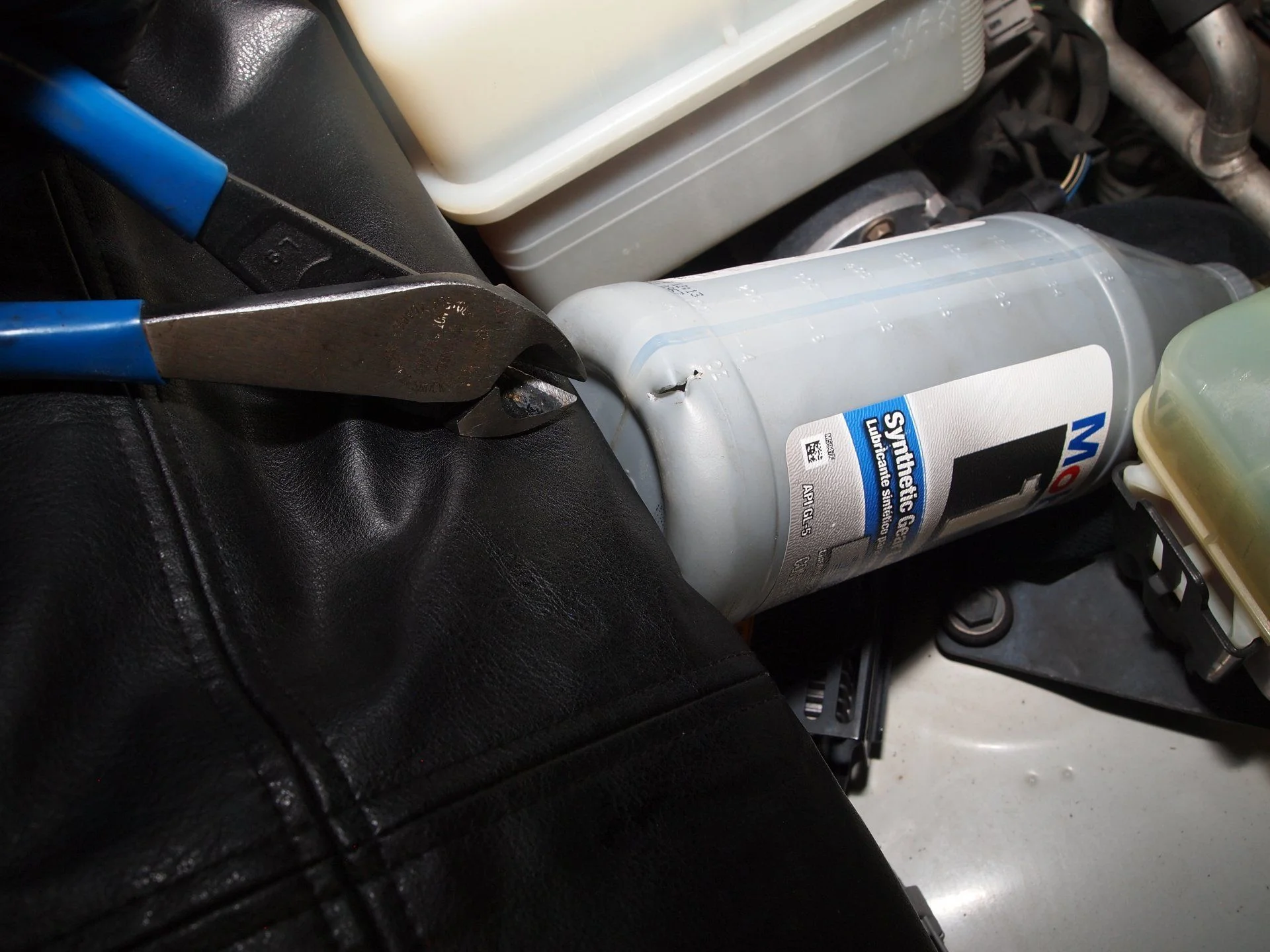

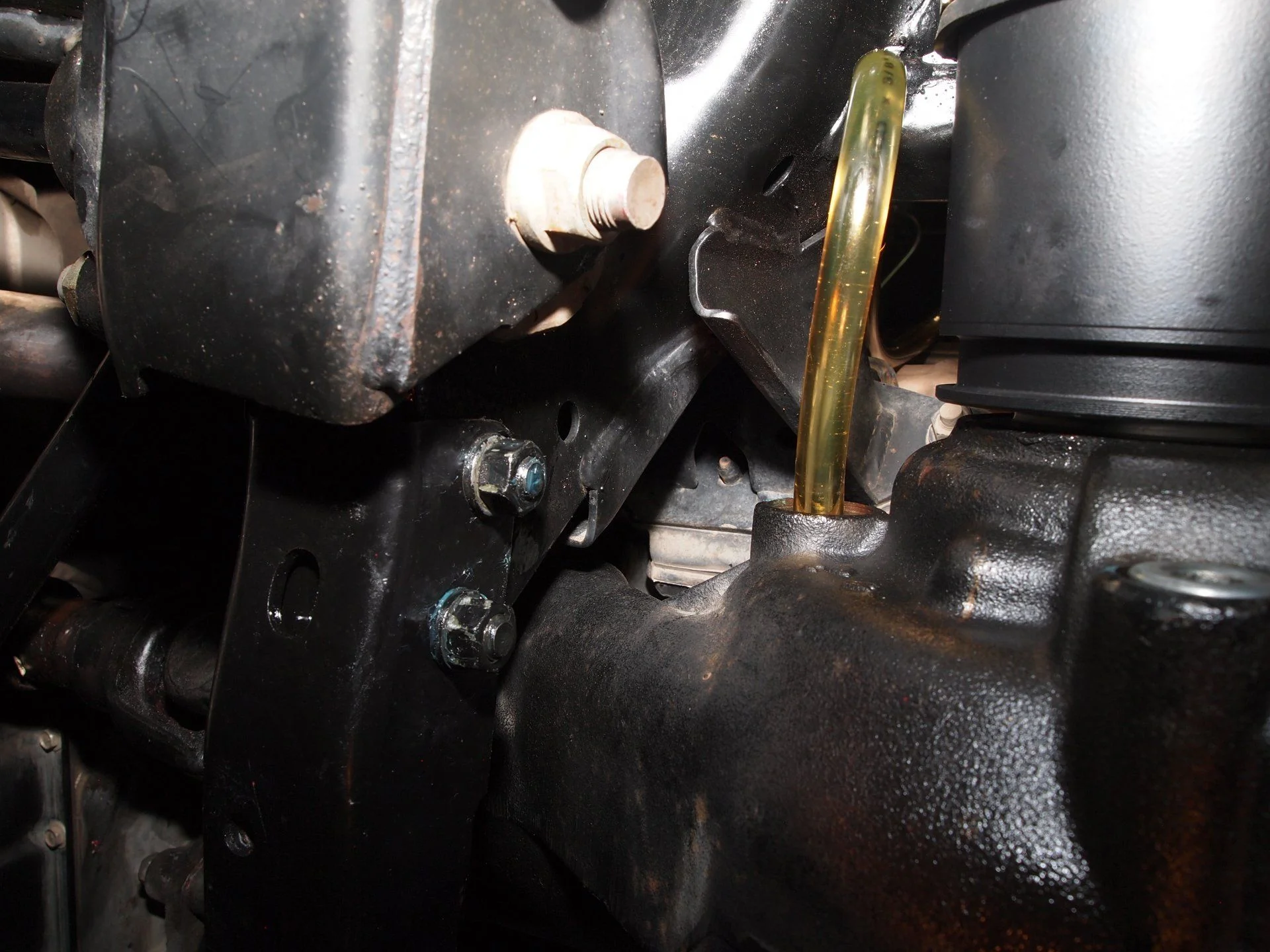

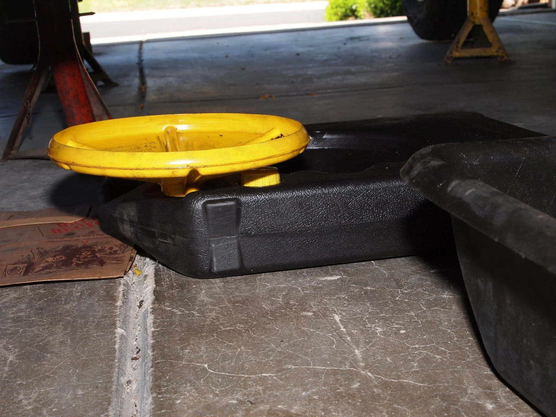

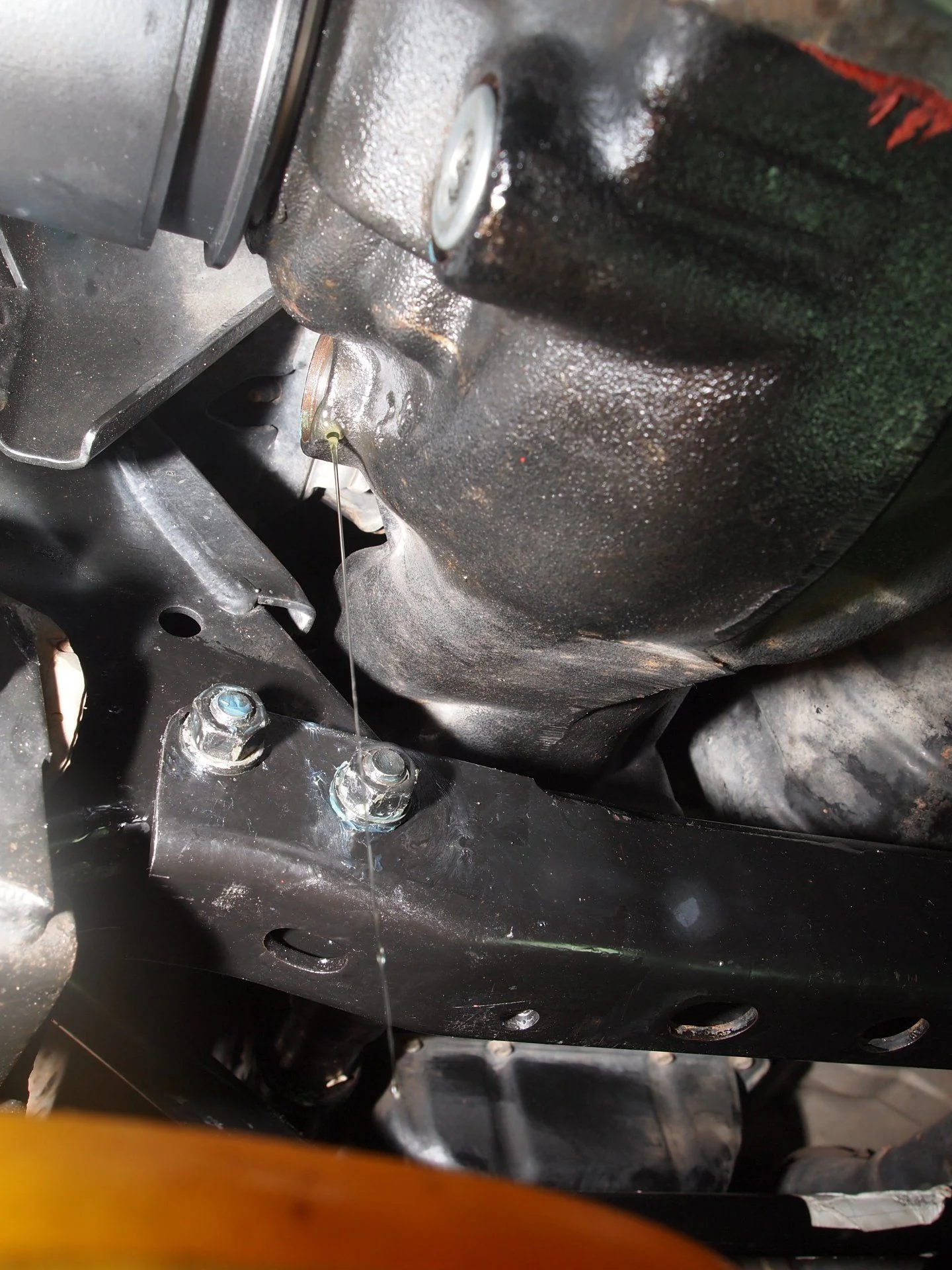

Filling front differential (or in process now) with the 1.8 qts I've on hand. I'm leaving my allenwrench out on top work bench, to signal I'm not done yet and have not torque on new fill gasket (washer) yet. As I want to let settle at minimum 15 minutes, then top again or check level is no more then 5mm below fill plug. I had differential out and drained even the DS tube.
File hole is visible form the top side.
Squeeze bottle or cut air hole to speed up job.
Filled with gear lube while front was lower than rear. Hand tighten fill plug and leveled Snowy. Let sit while worked other stuff for a few hour (15min would have done fine), then unplugged fill plug. Torque in fill plug with new gasket (washer) once gear lube stop running out.

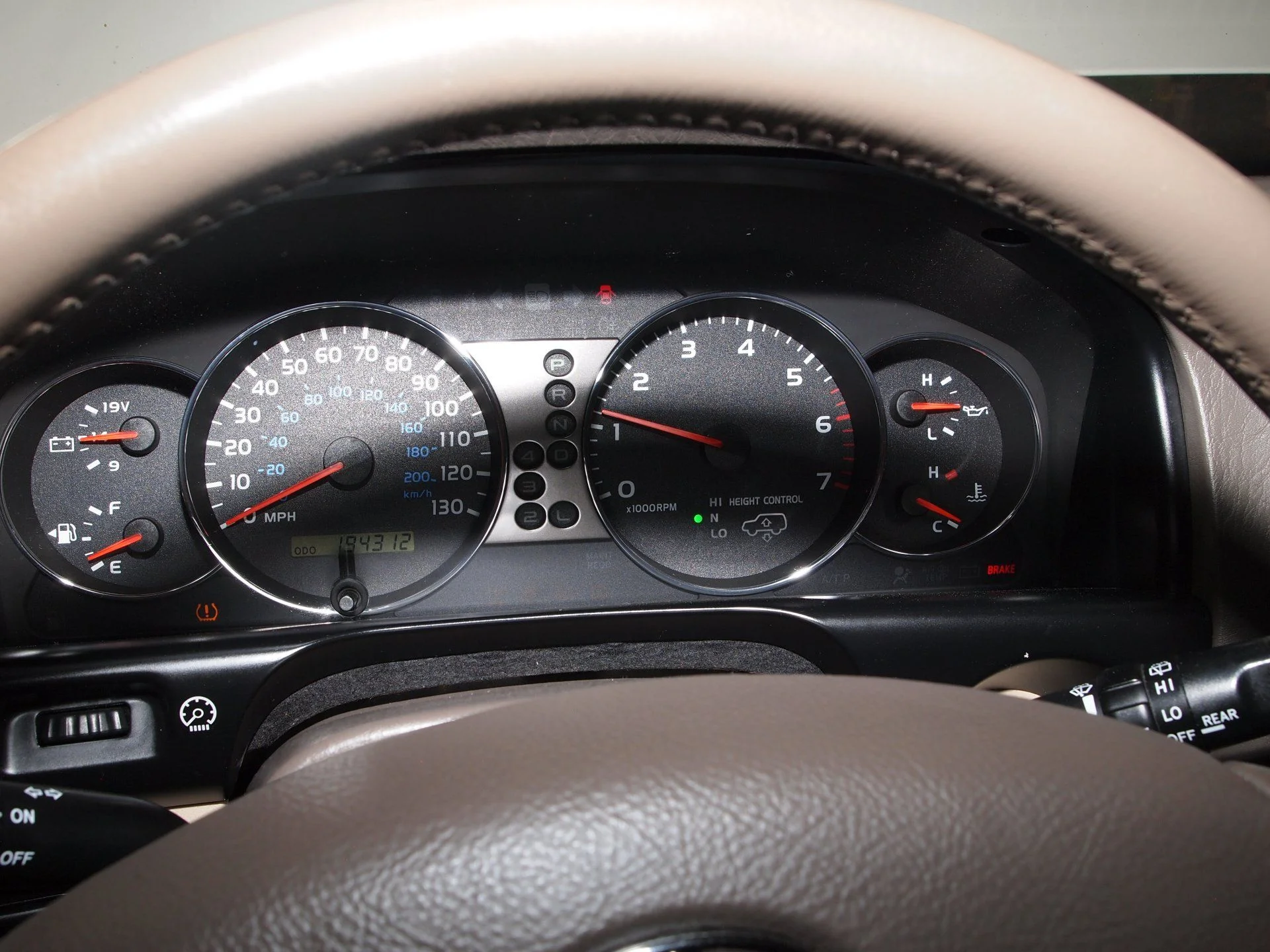

It's been a month or so since it's run; oil, coolant are making there way thought the passages, new bearing and pumps all settling in. It's so sweet to hear it run. I've never worked so many systems before at one time, so was excited to hear. These VVTi always run high RPM on cold start, so don't make much of high RPM, it's normal.
One think I notice is oil pressure gauge is more responsive, oil sending unit was a good idea. Makes me want to change out temp sending unit.
I paced around Snowy for 15 minutes like a dance, as I do before each start up after a timing belt job in the 100 series 2UZ-fe....Sweet to hear it roar.
Second start engine warmed up. Fuel injectors are the tapping sound. They sound strong and balanced.

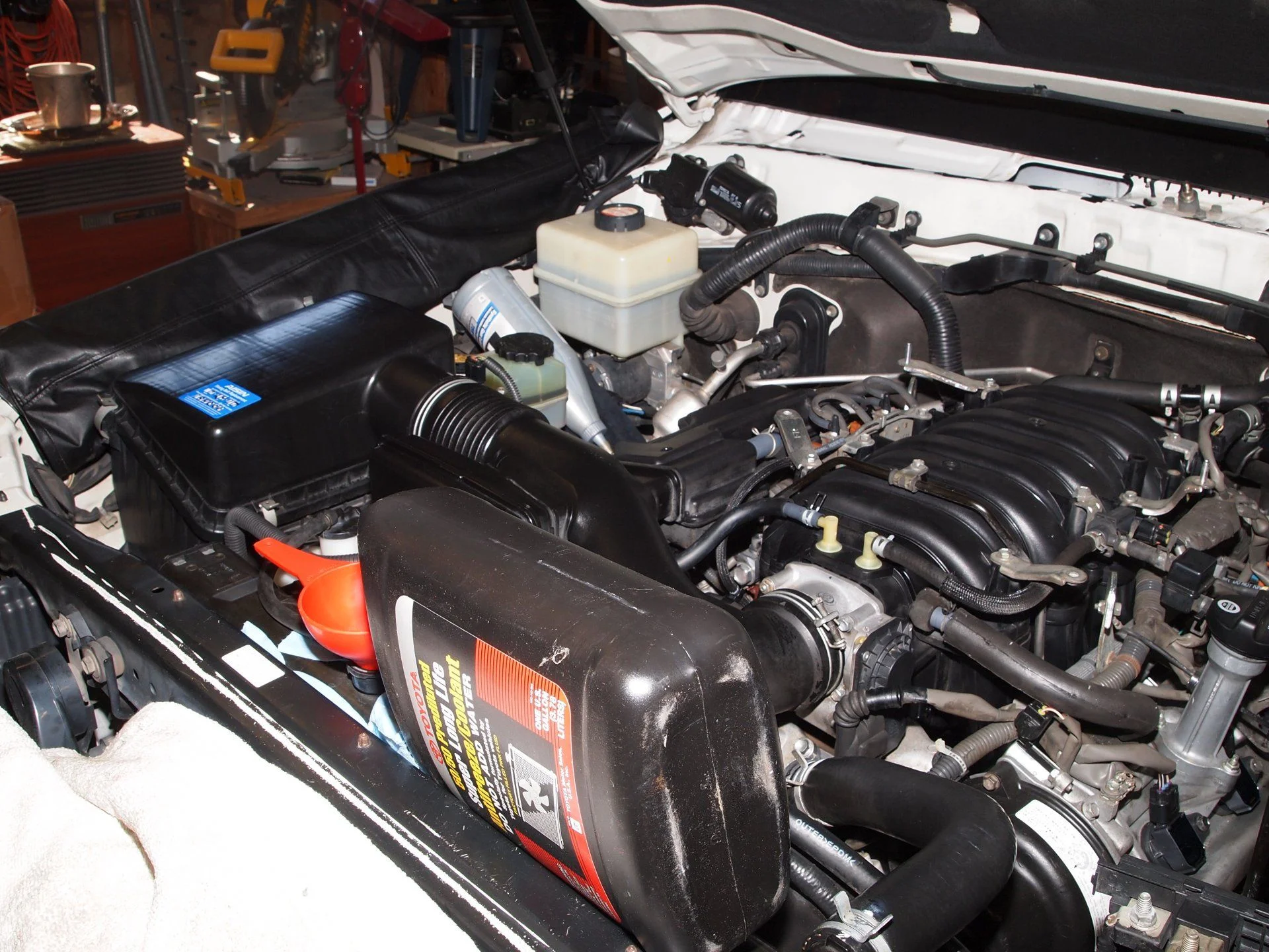

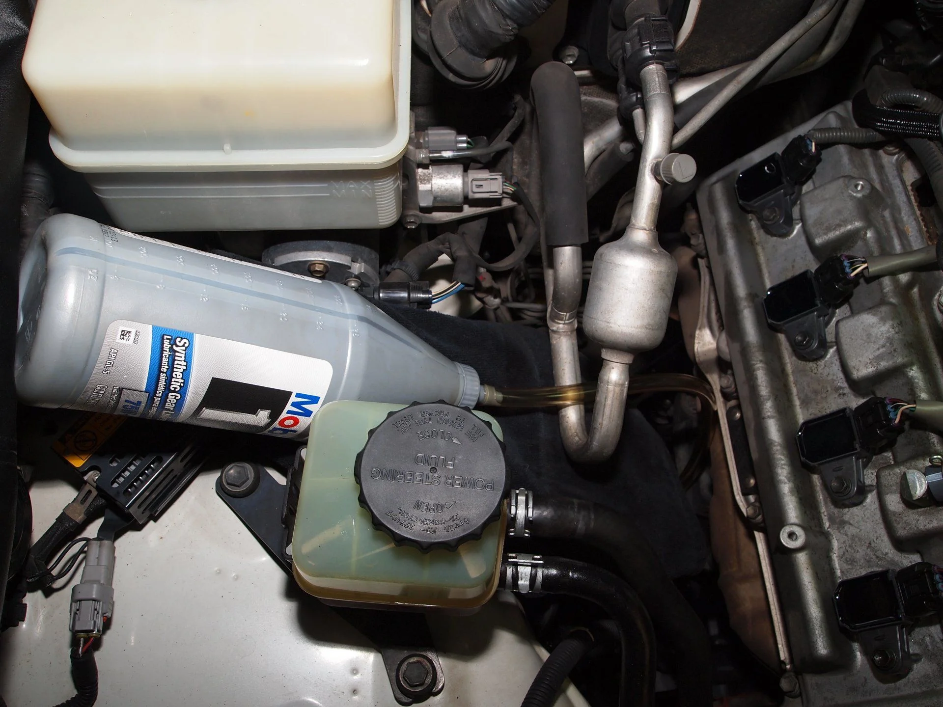

keeping eye on Power Steering HP hose & gaskets at union bolts for leaks.
Also top off power steering with some more M1 ATF and bleed by turning steering wheel stop to stop and holding at stop 3 sec, three time in each direction. Then did same with wheels on ground with engine running. Both procedures done slowly!

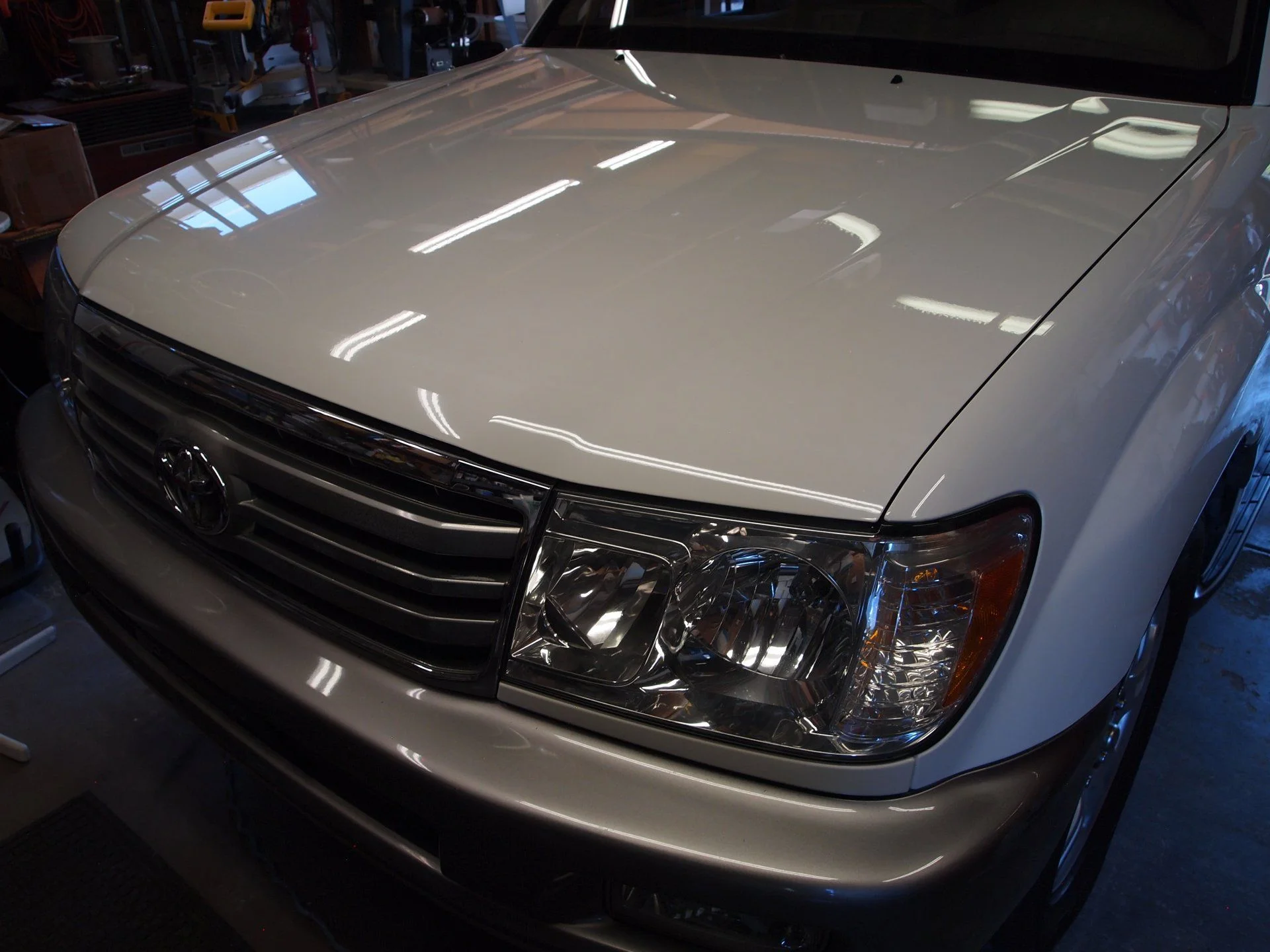

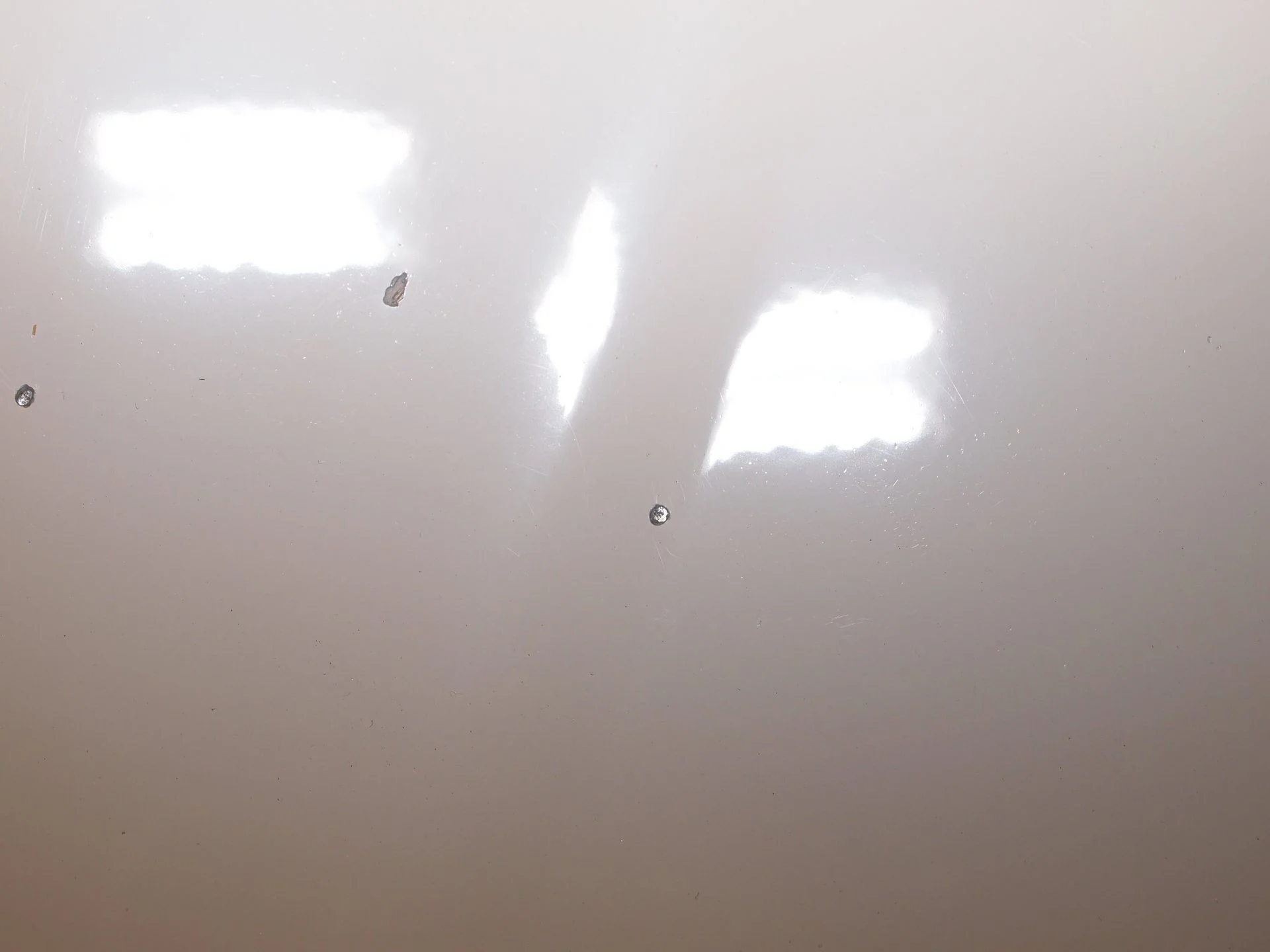

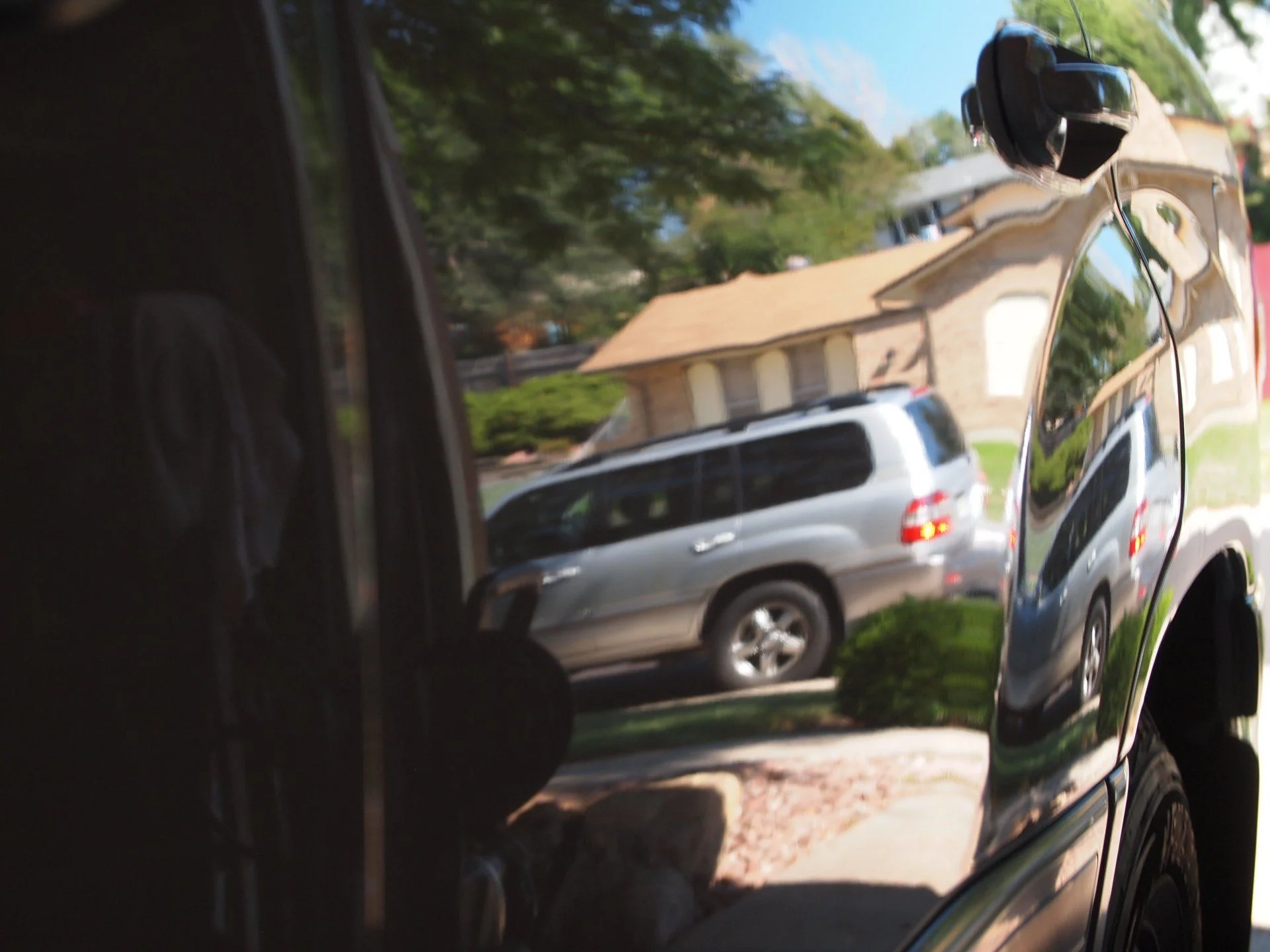

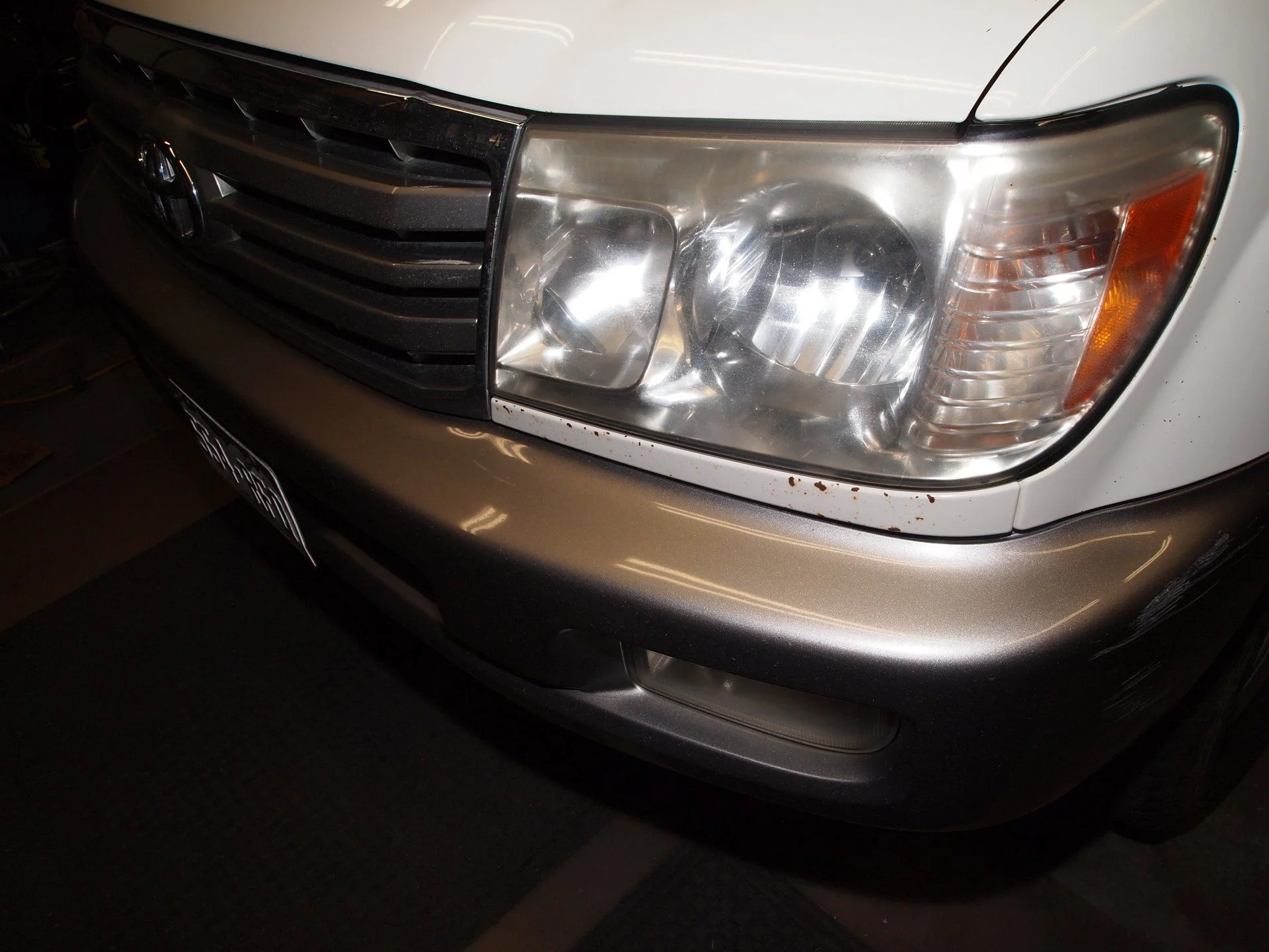

Went over the paint with cutting (Correcting) compound again. Cutting in spots I worked chips with micro grinding out rust, self etching primer & touch up paint, or too remove fine scratches now revealed.
After cut:
Before

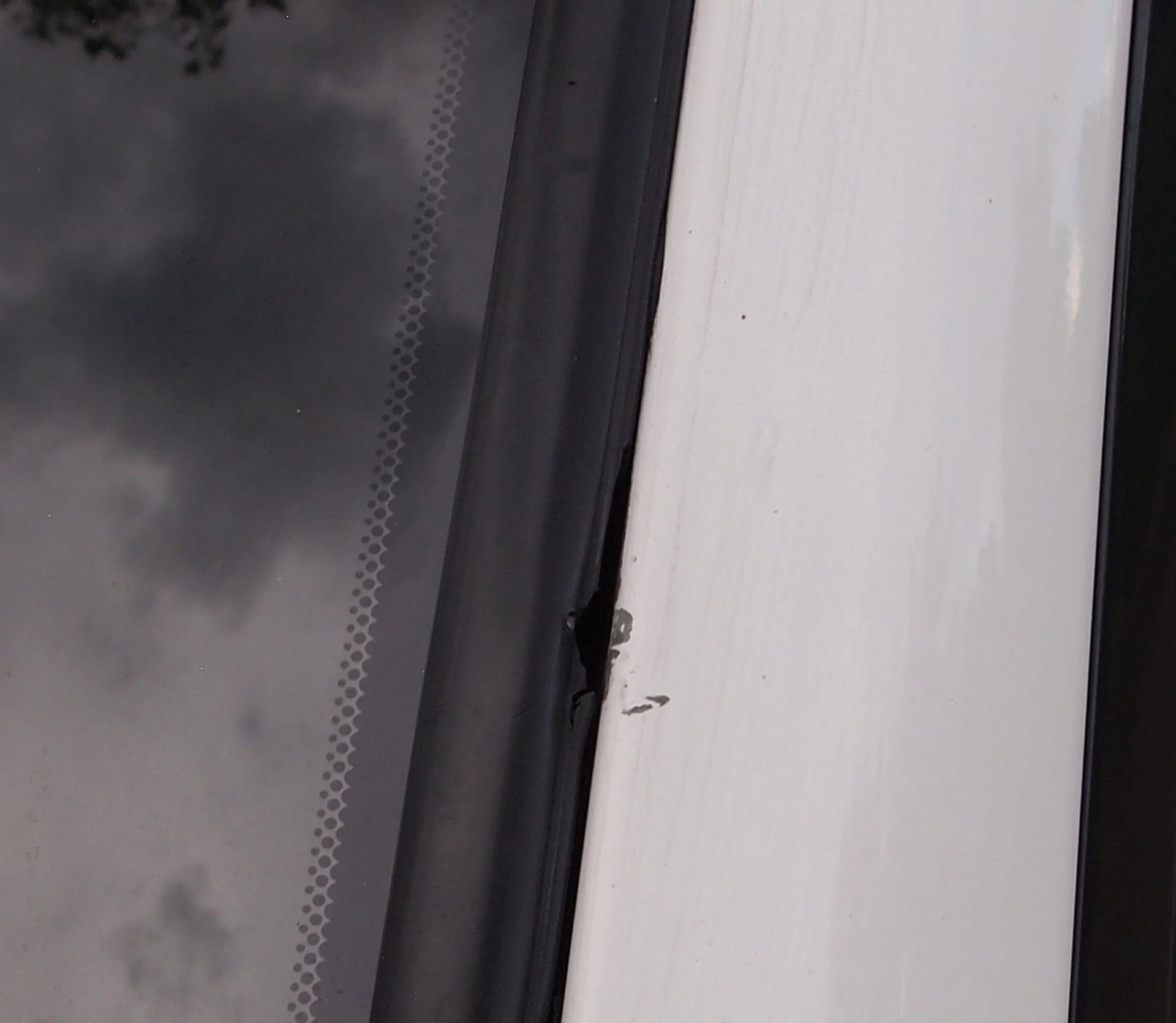

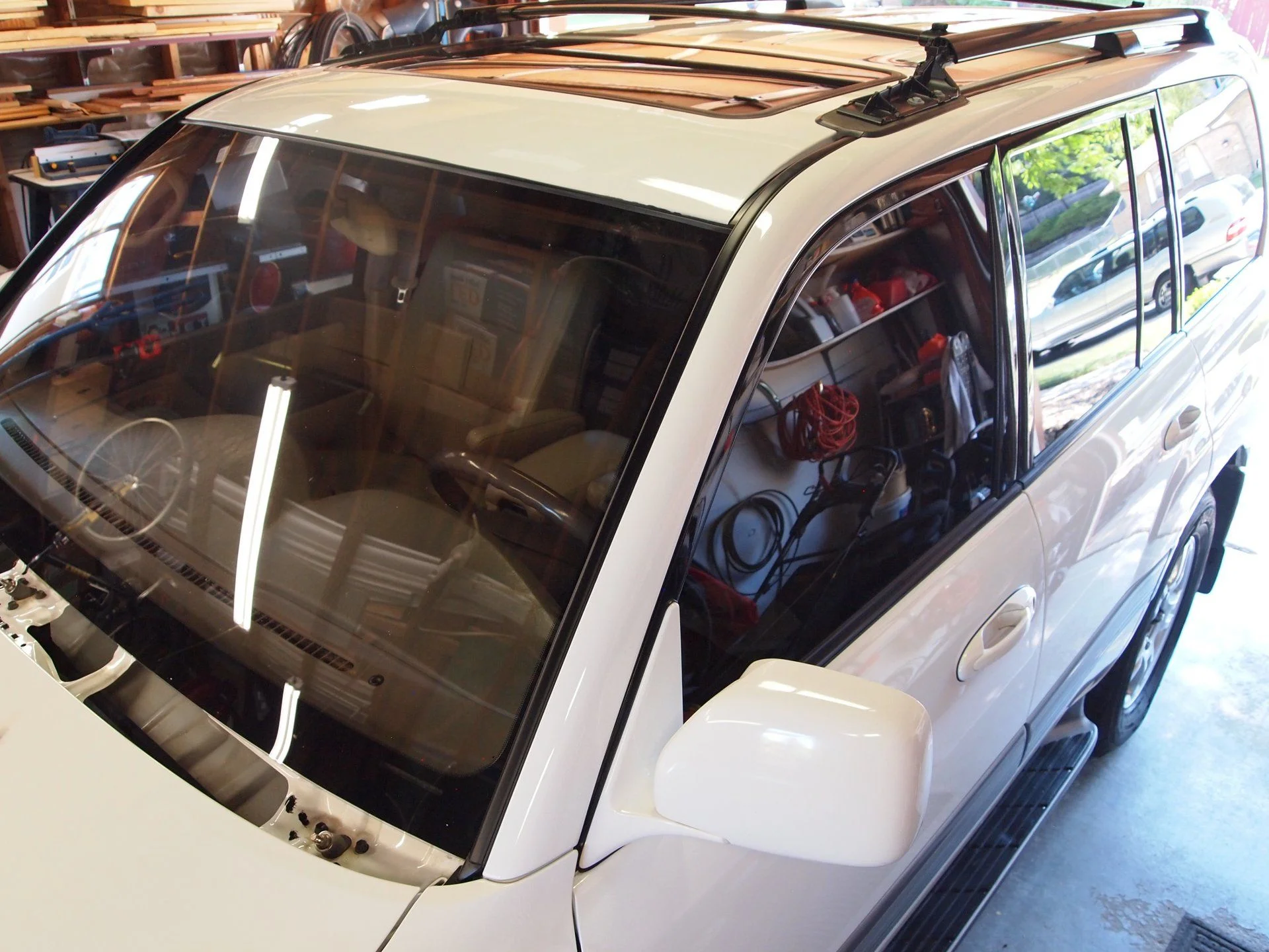

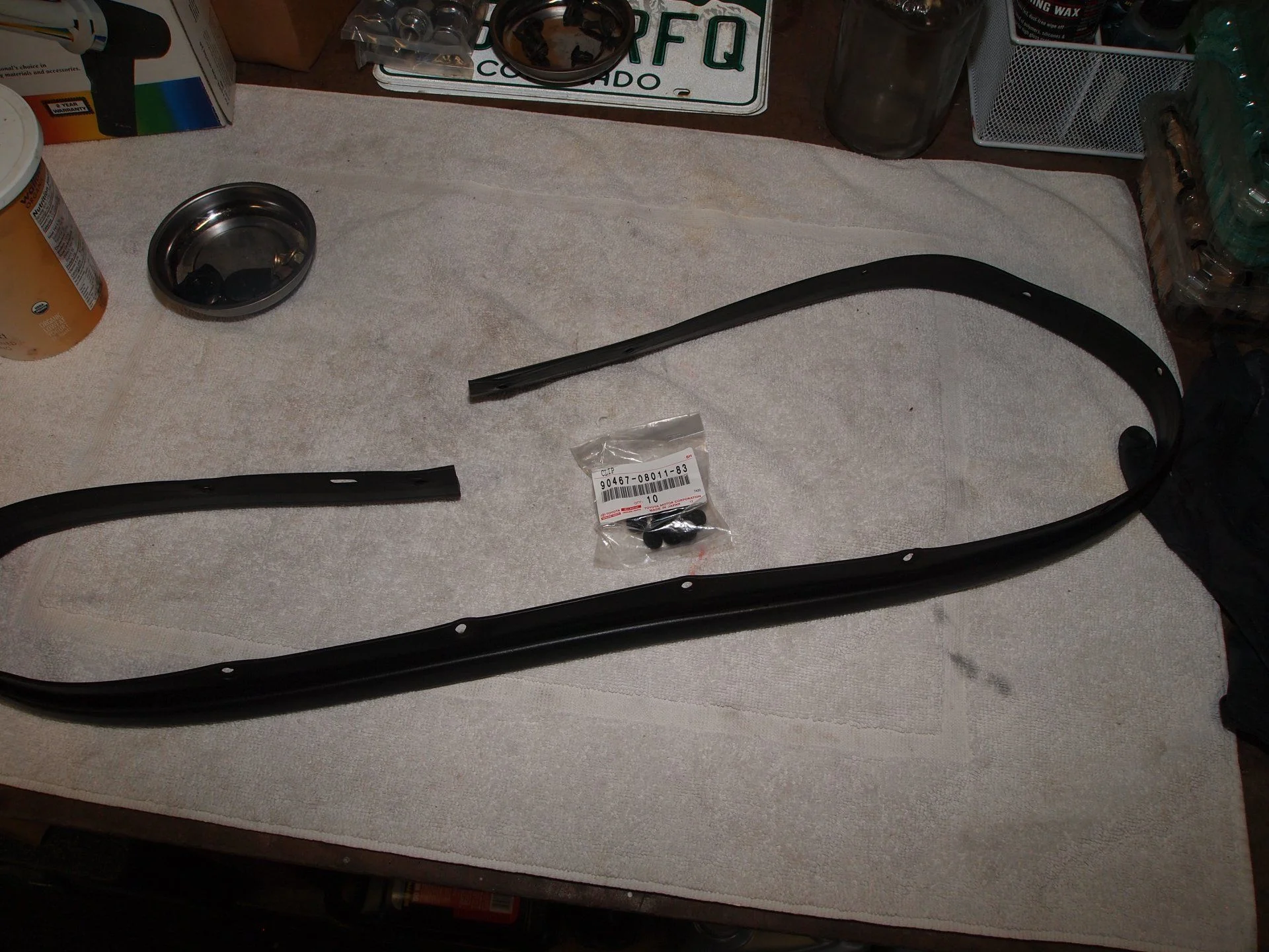

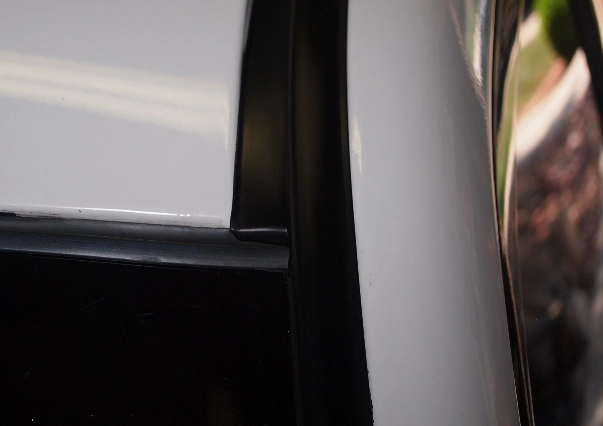

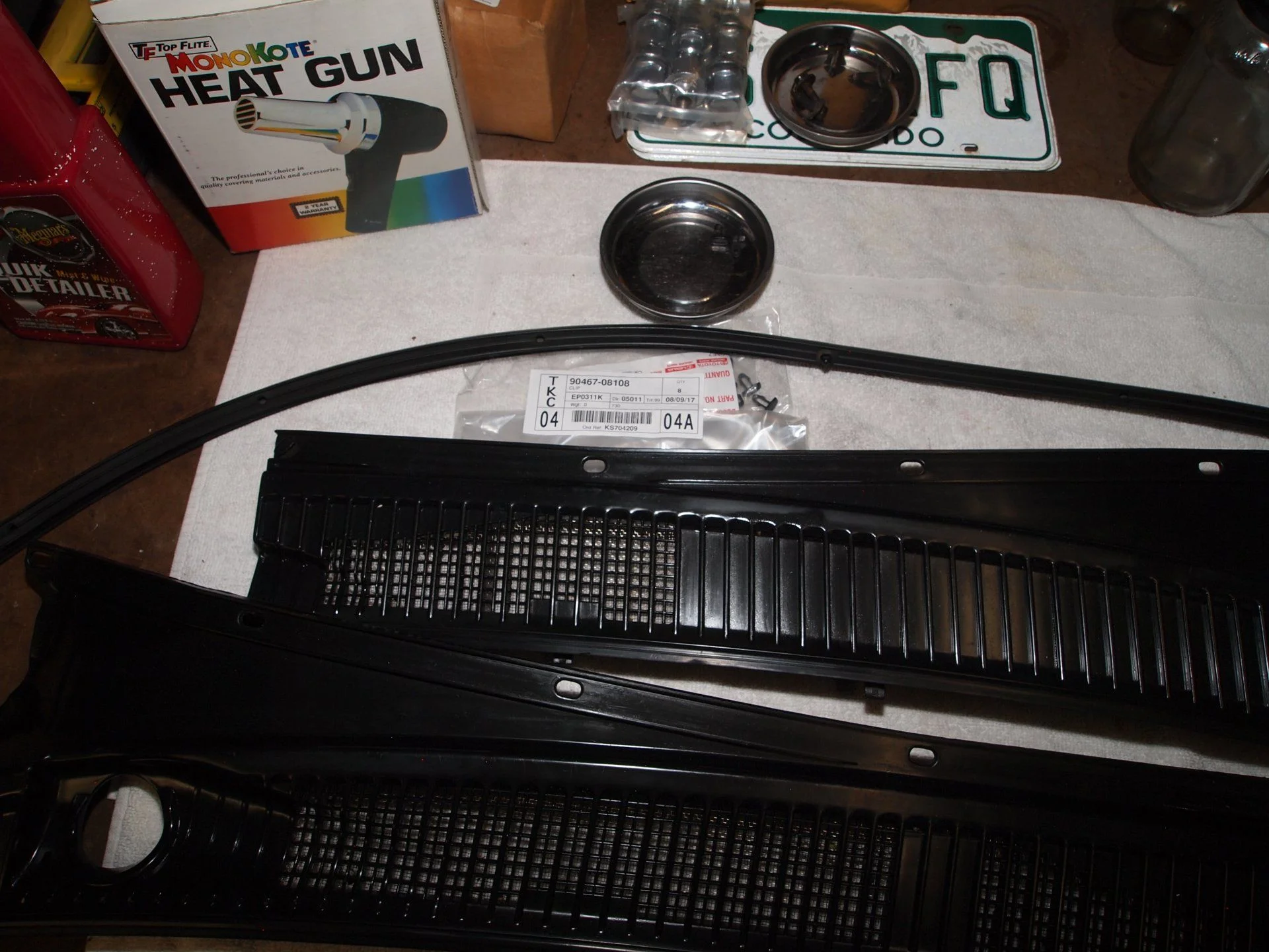

Once final cut was done, then I installed windshield side molding. This sealed up rivet holes so I could wash before waxing without concerns for water entry into "A" pillars. I replaced both side, because last windshield installer really butcher the molding and "A" pillar paint not to mention drilled new holes. If that wasn't bad enough not even plugging old holes.
Before

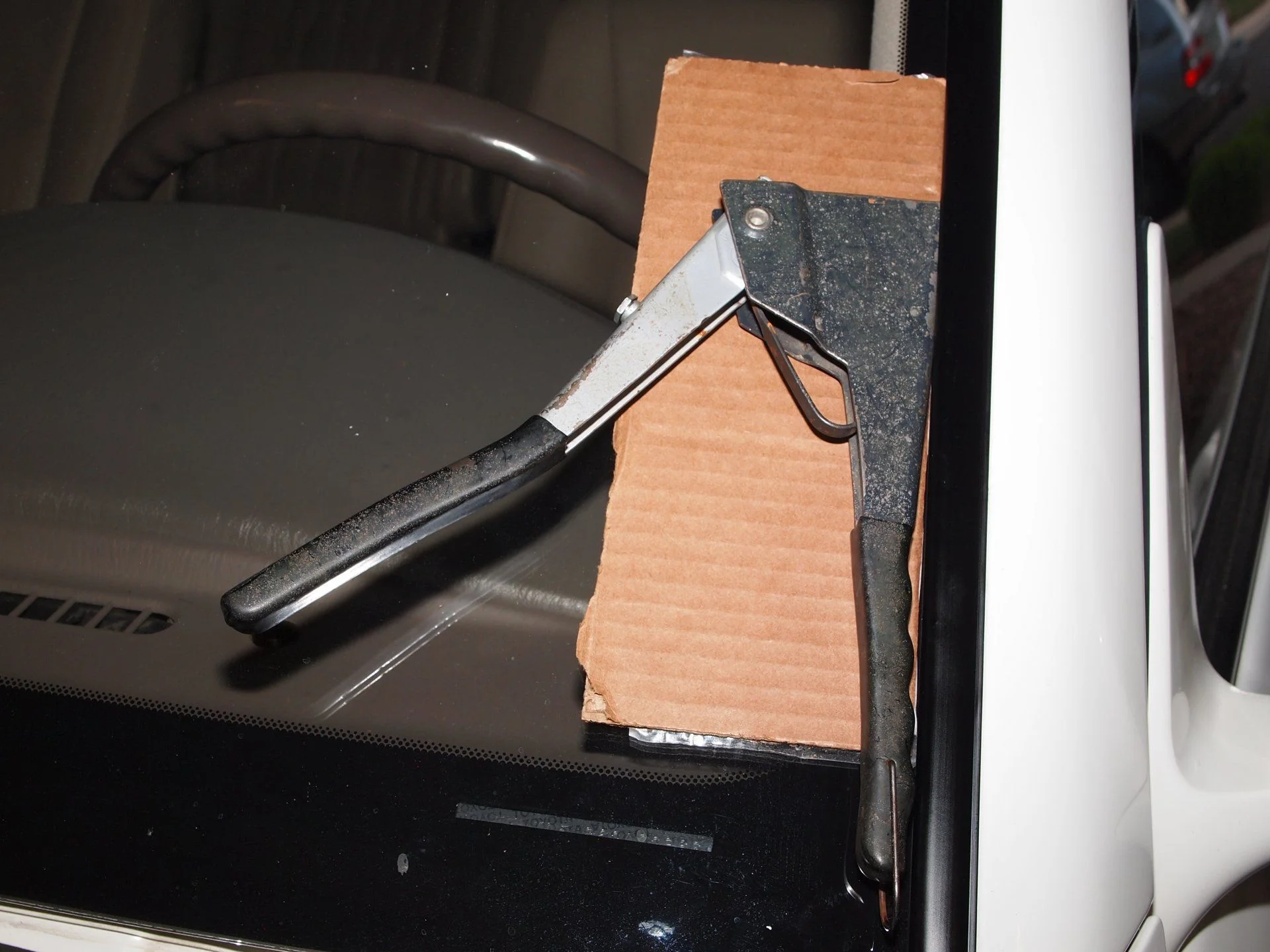

Found and old very narrow rivet gun in my tool box, which fit into molding nicely. Using a piece of corrugated cardboard to keep shock of rivet setting snap/pop from cracking windshield.
After waxing I installed final exterior molding pieces.

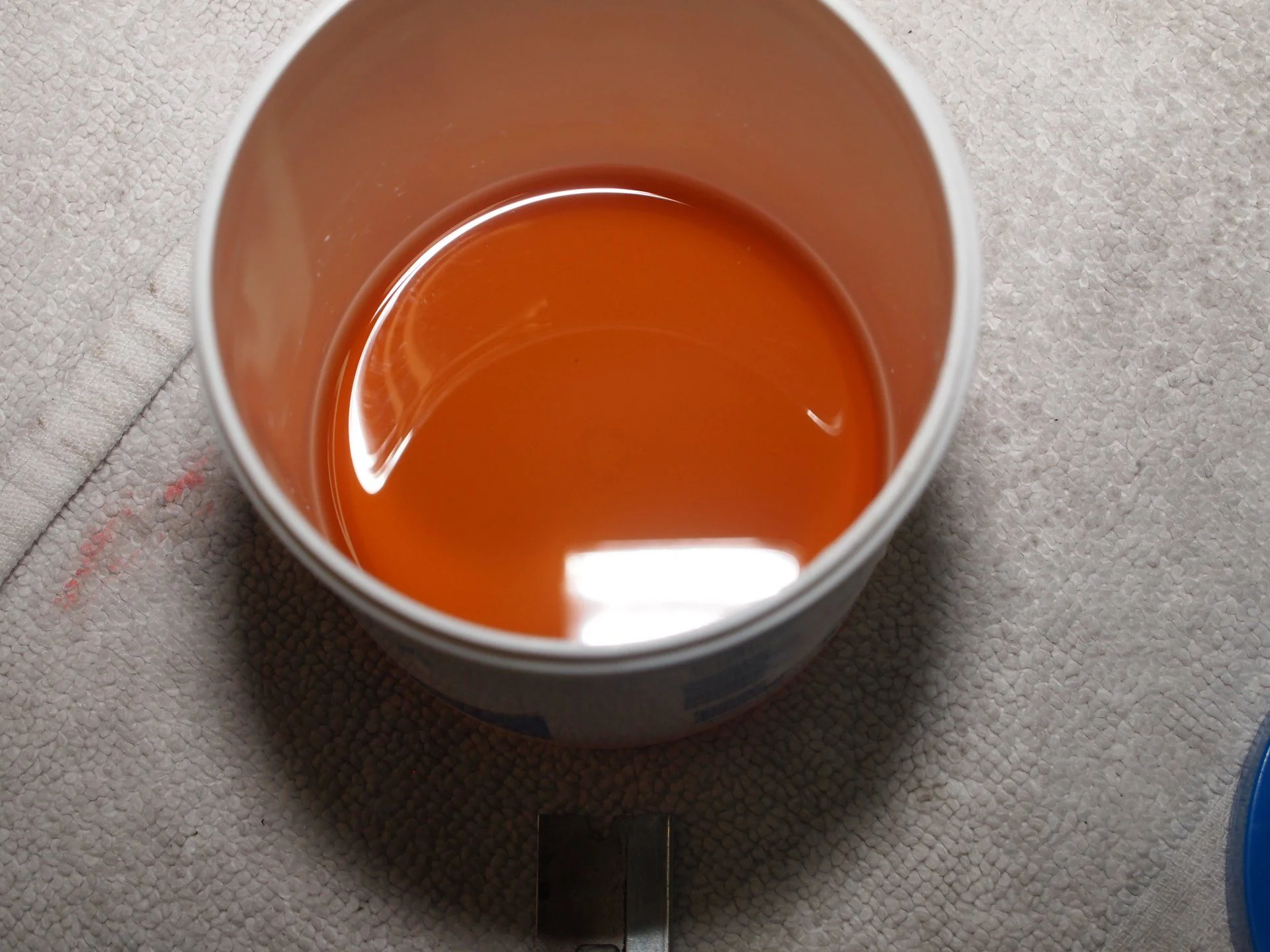

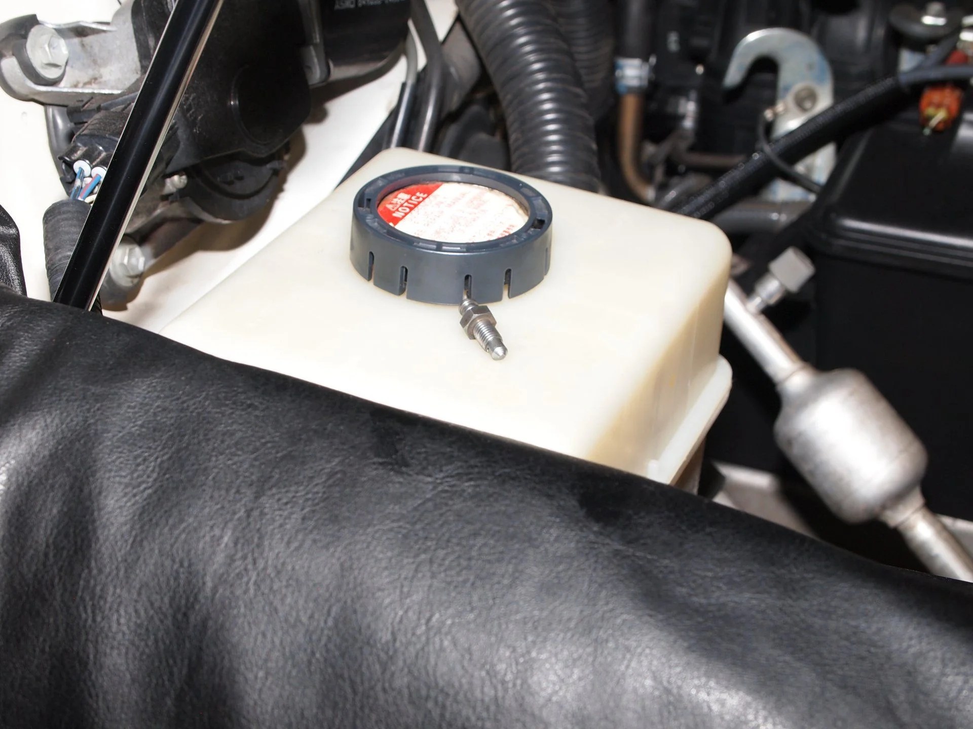

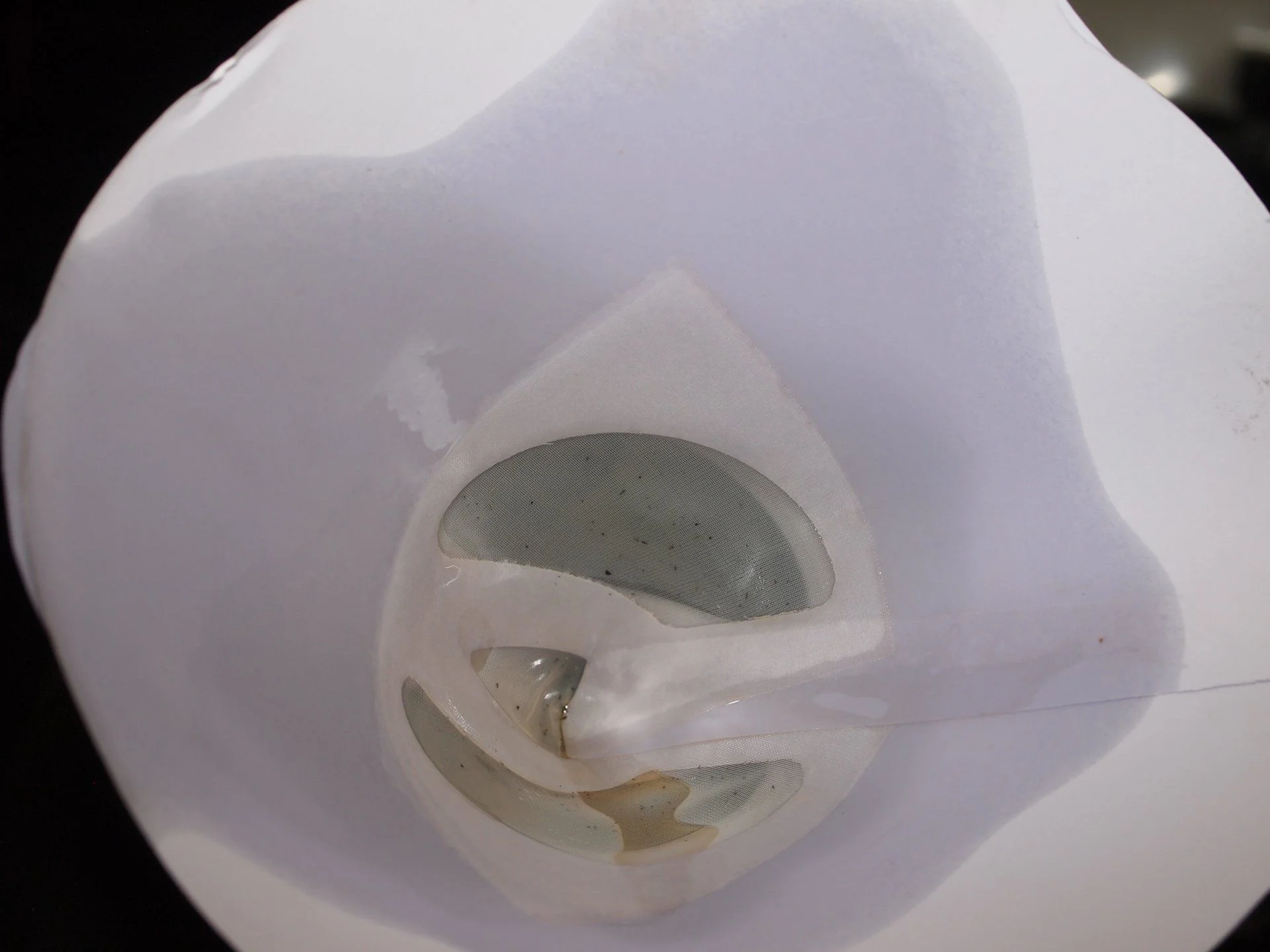

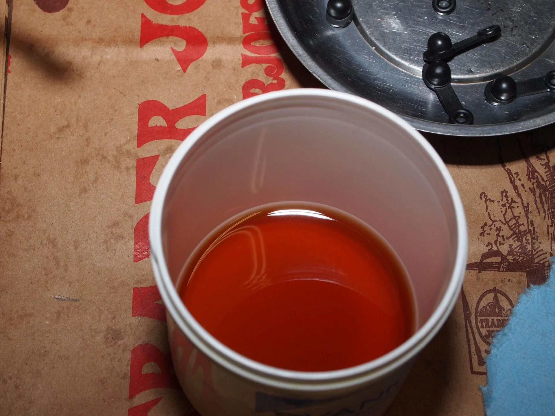

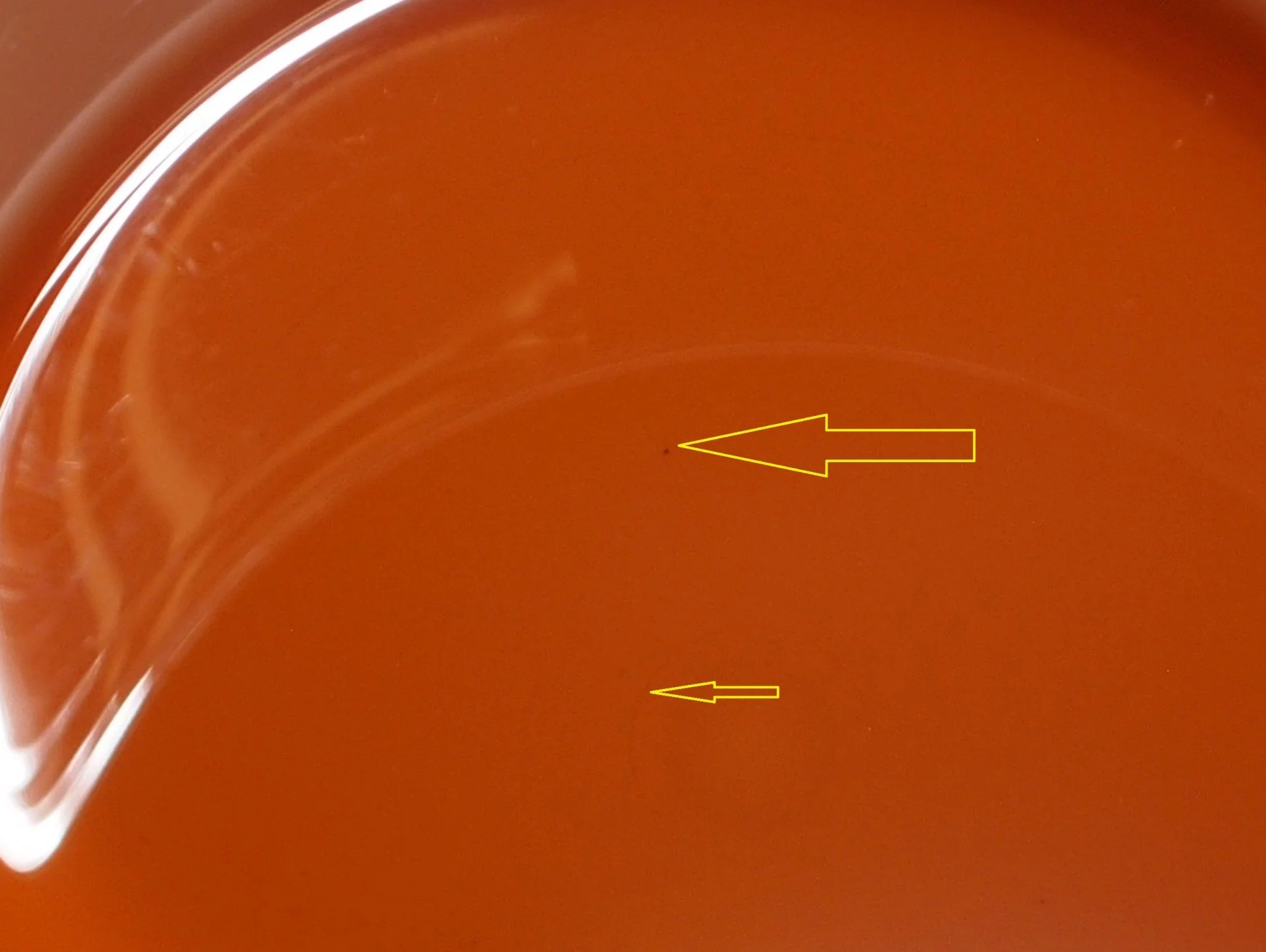

Doing a final flush of AHC it's third, to get fluid to run clear. I found some contaminates in fluid from second flush. So with a homemade hydraulic fluid filter & pump, I filter fluid. So I actually flushed and bleed this AHC 4 times, with 7.5 liters total.
Second flush filtered at 125 microns.
Third flush
Final (fourth) flush after running through hydraulic filter, it's clear without contaminates.

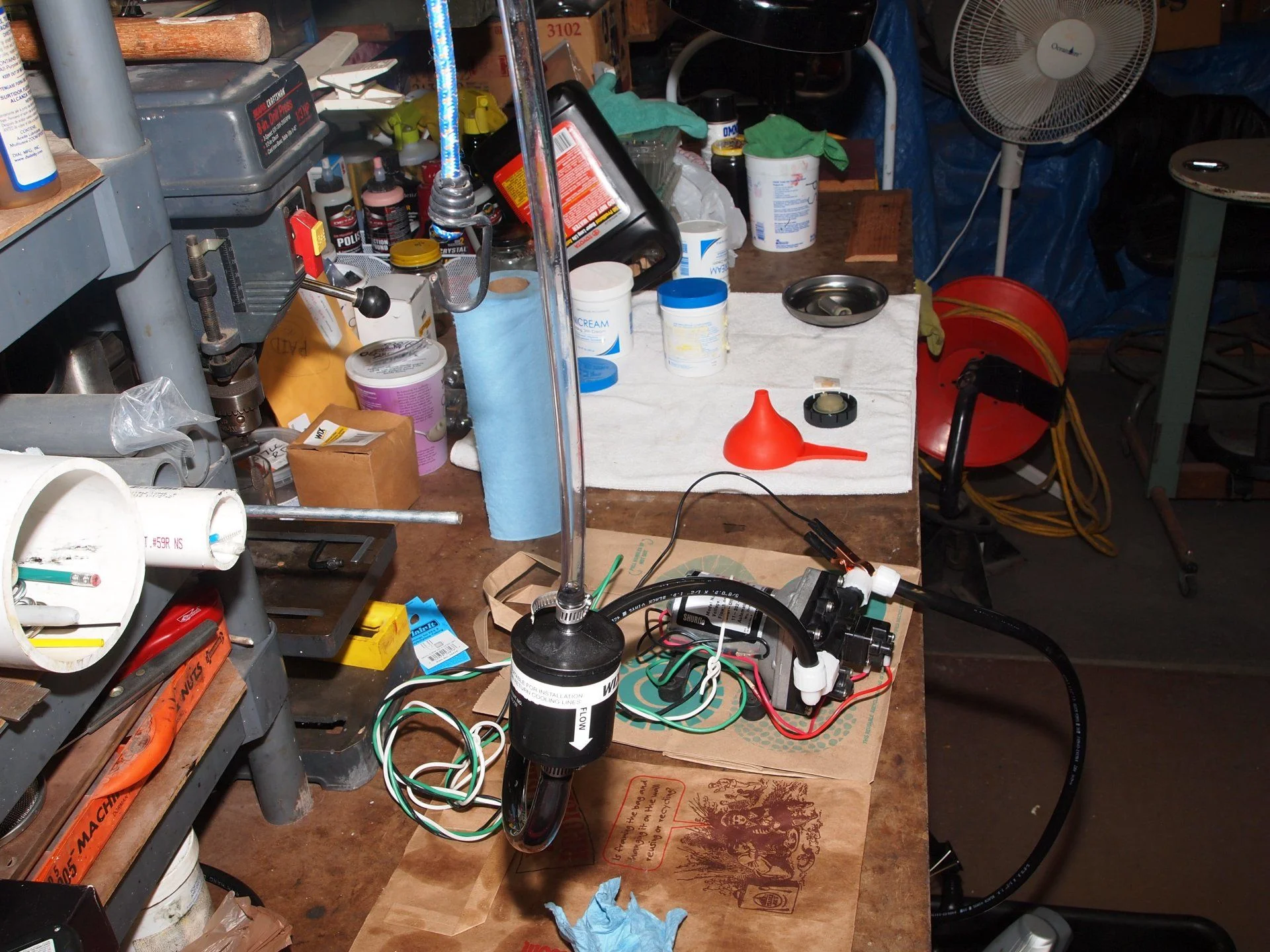

My homemade filter. I used a WIX inline transmission filter. I'll not use WIX again as I did need to double filter fluid and company (WIX) can't give any info on filter's micron ability as they don't have the data, but it worked.

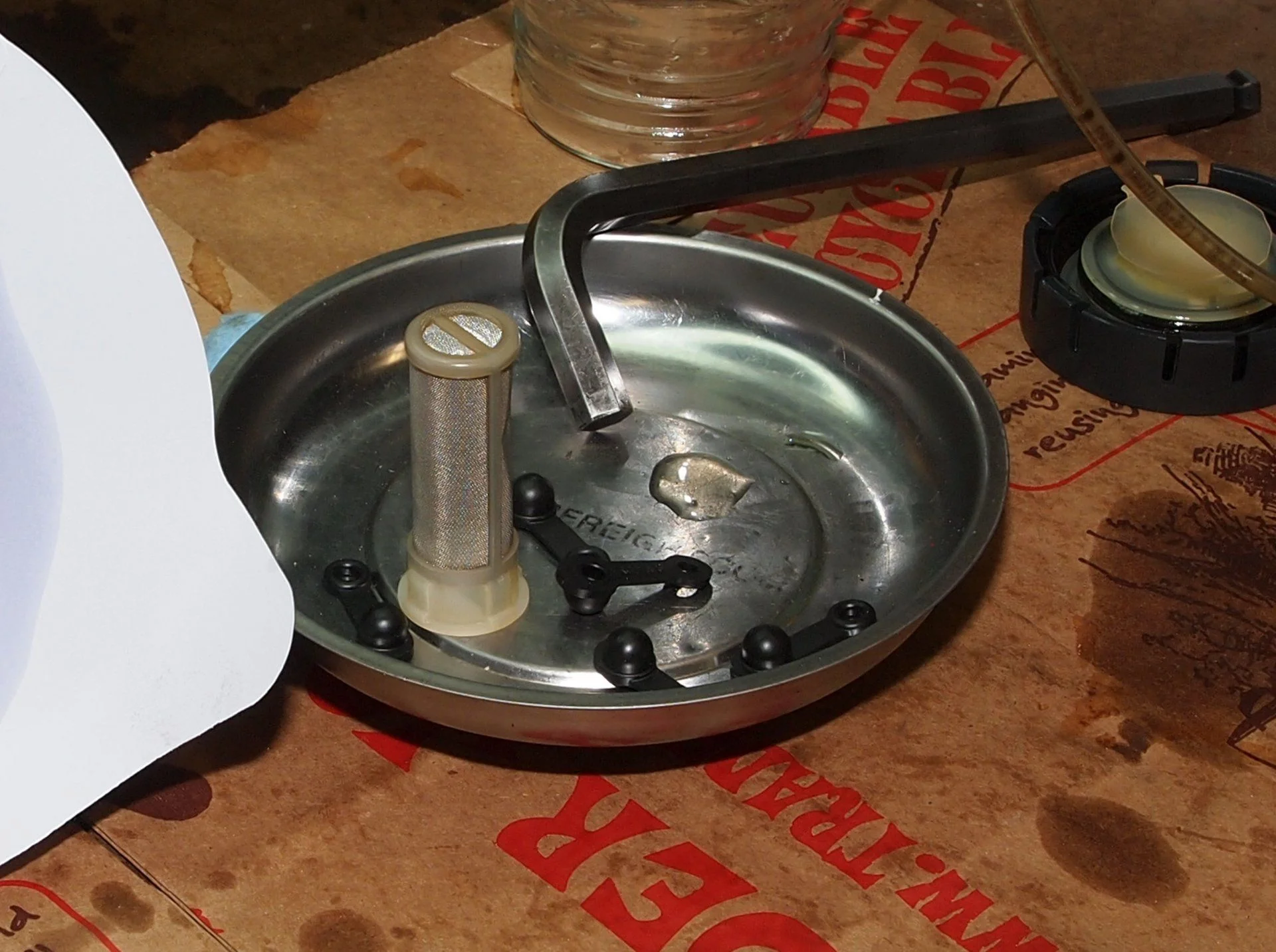

I wire brushed each AHC bleeder and lightly coated with marine grease then wiped off and blew clean with compressed air.

I've also installed all new bleeder caps, this is key to health of bleeders and the socket they fit into (Globes & Accumulator)
I also cleaned screen.
After bleeding I blew out each bleeder to get out the few drops of fluid that remains, then installed the new bleeder cap. I then washed area around each bleeder to remove fluid residue.

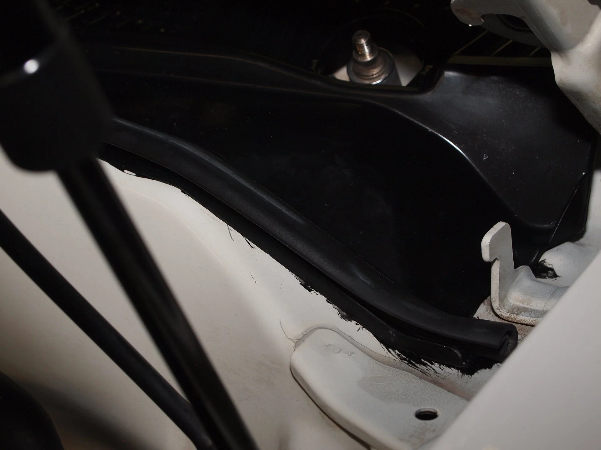

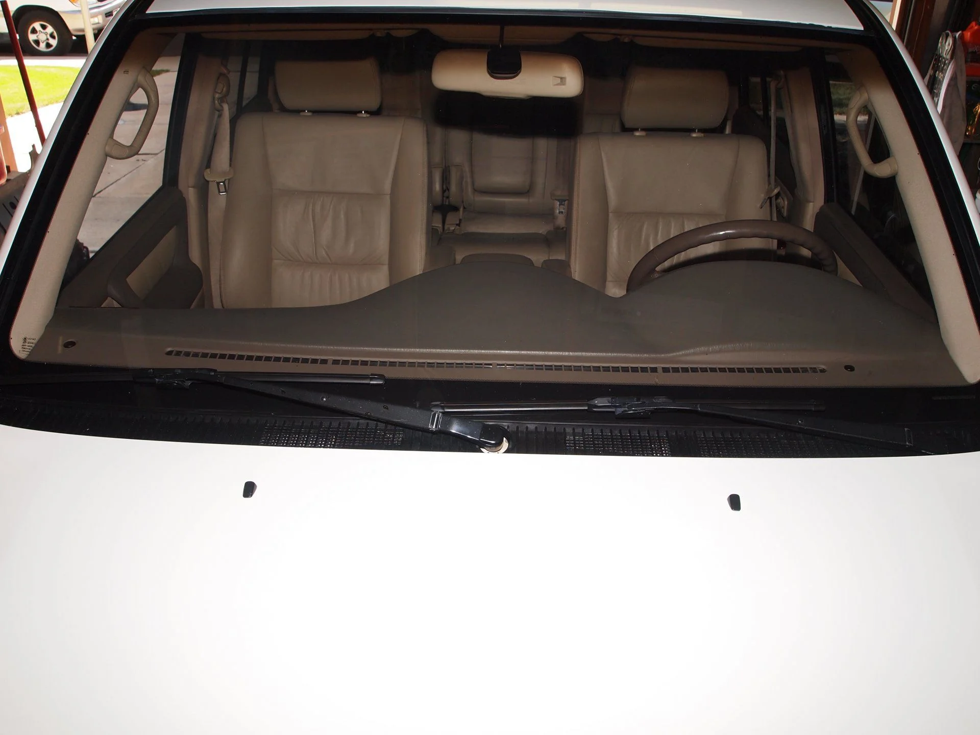

what black sealant do you use on the rubber channel run under the wiper hard plastic bits?
thanks
thanks
I had some stuff windshield installer uses (i showed early on in thread) but switched to POR-15.
