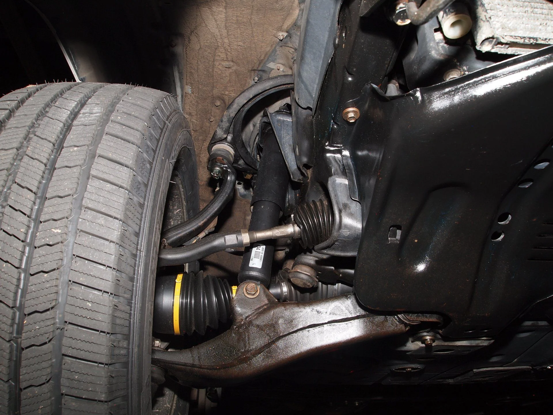

New Michelin on. Unfortunately my supplier sent me the wrong lug nuts, darn. So I'll have to reduce part by 16:cry: Not 20, because I did have 4 new from my last box supplier sent, that I replaced the locking lugs with.

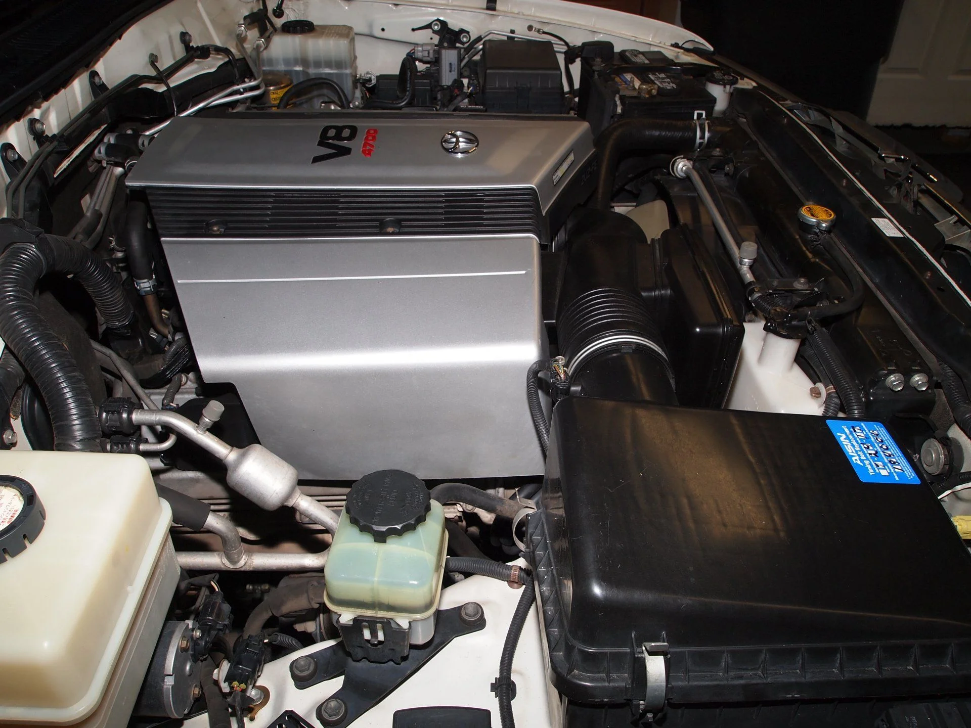

AHC tweaked.

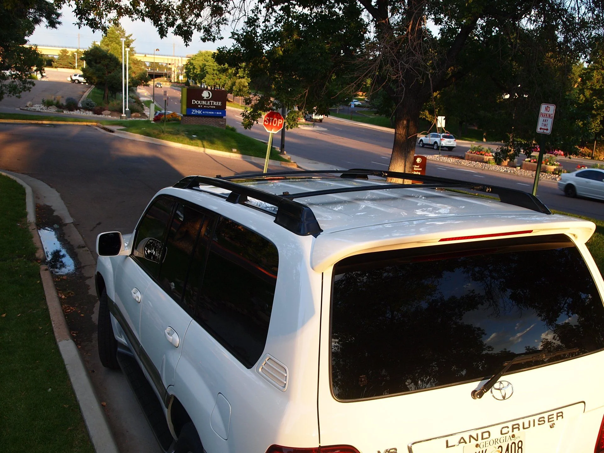

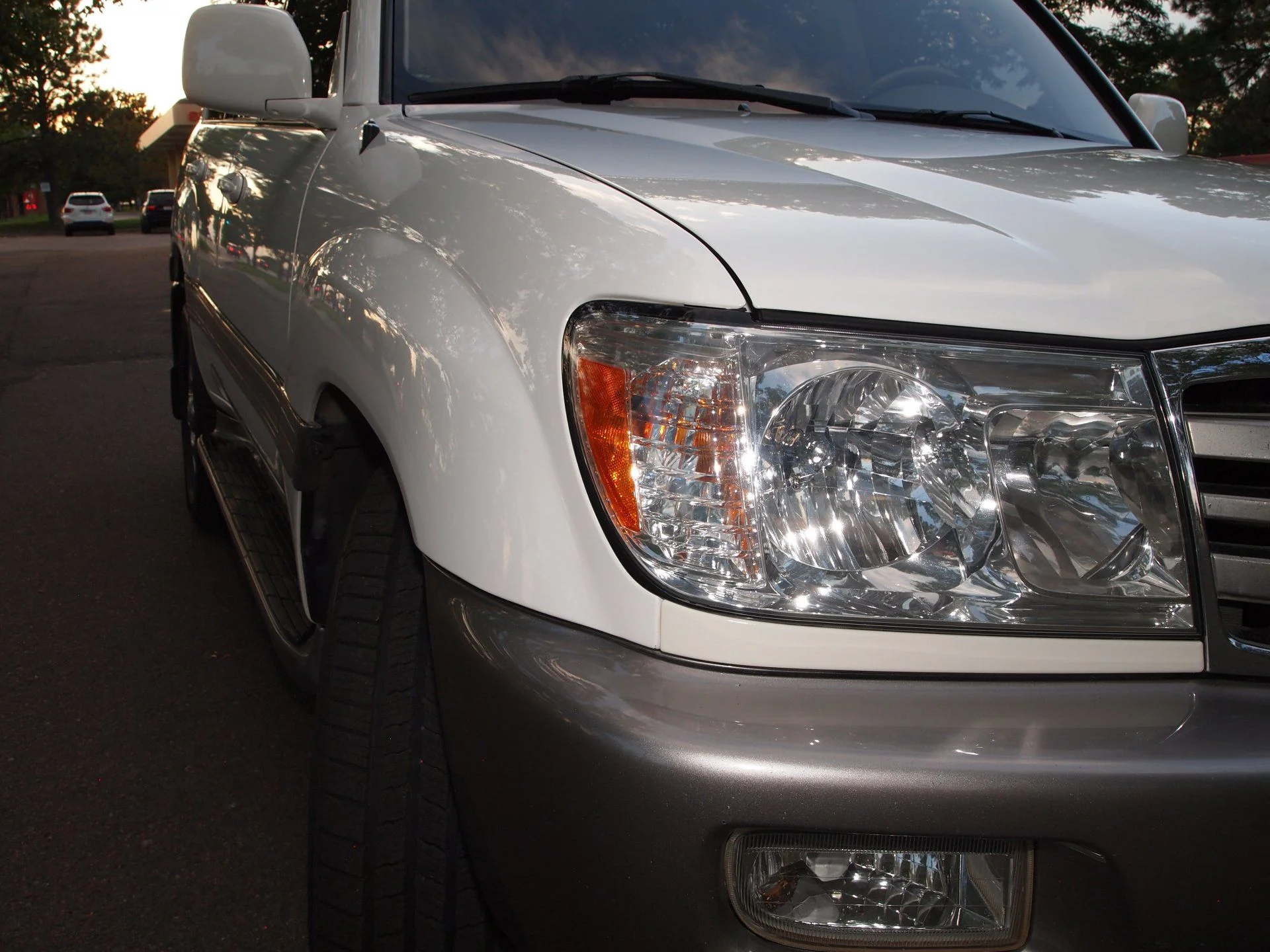

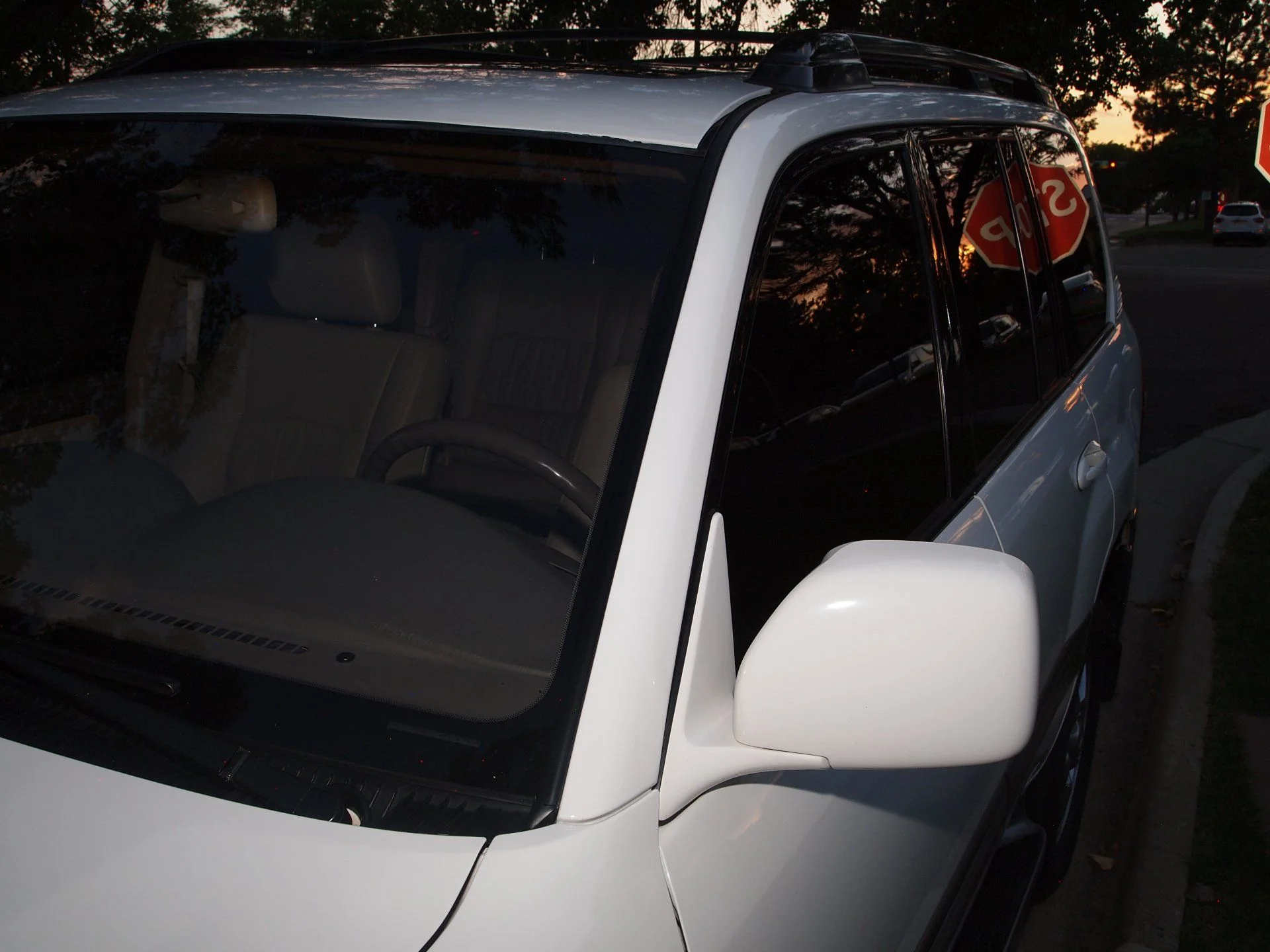

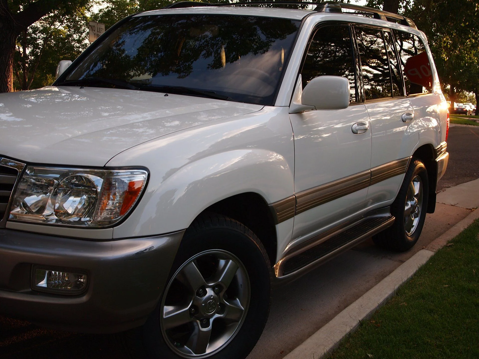

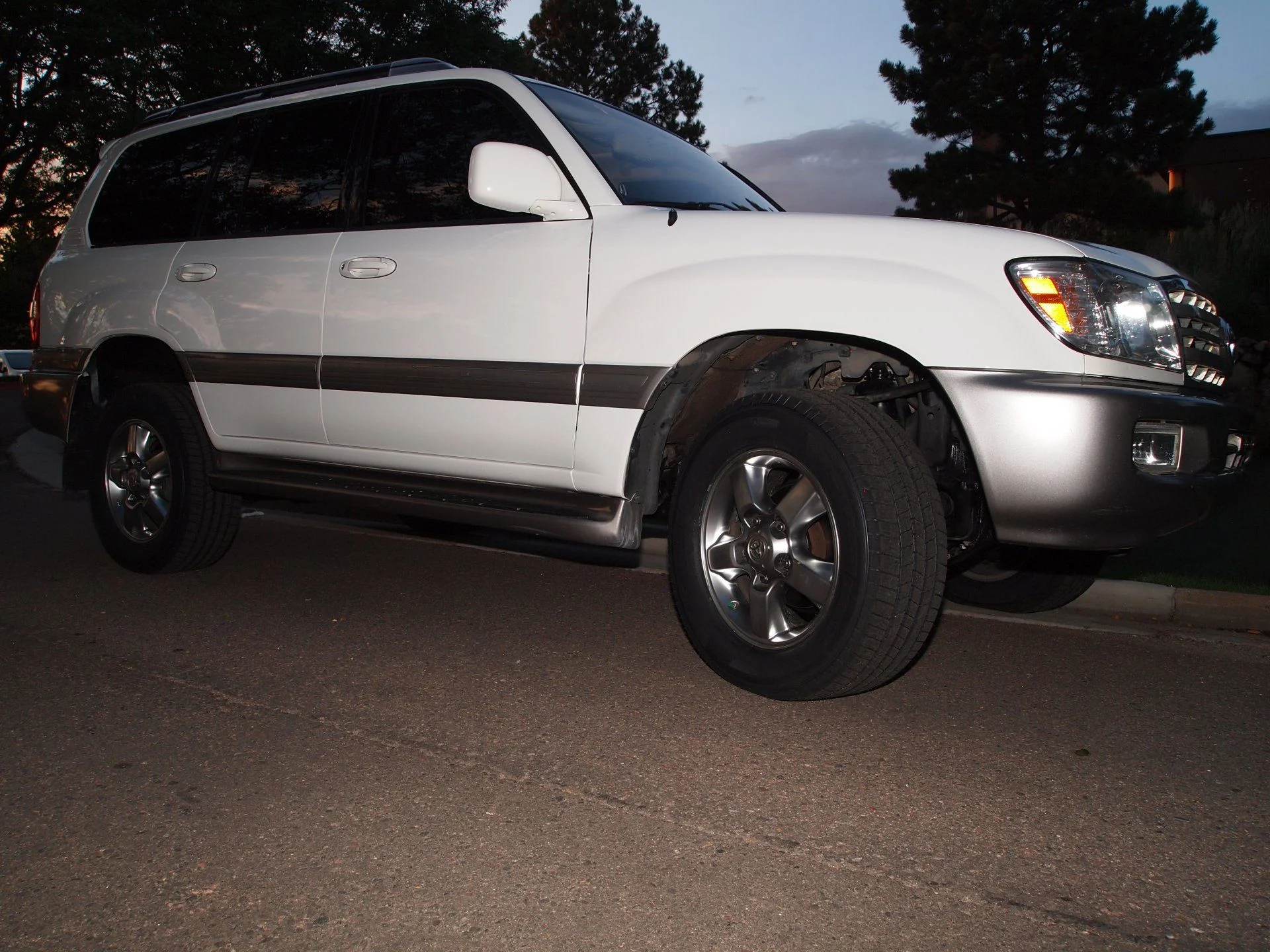

A final pictures.
In time I'll organize this thread with links and list of what was done in OP.

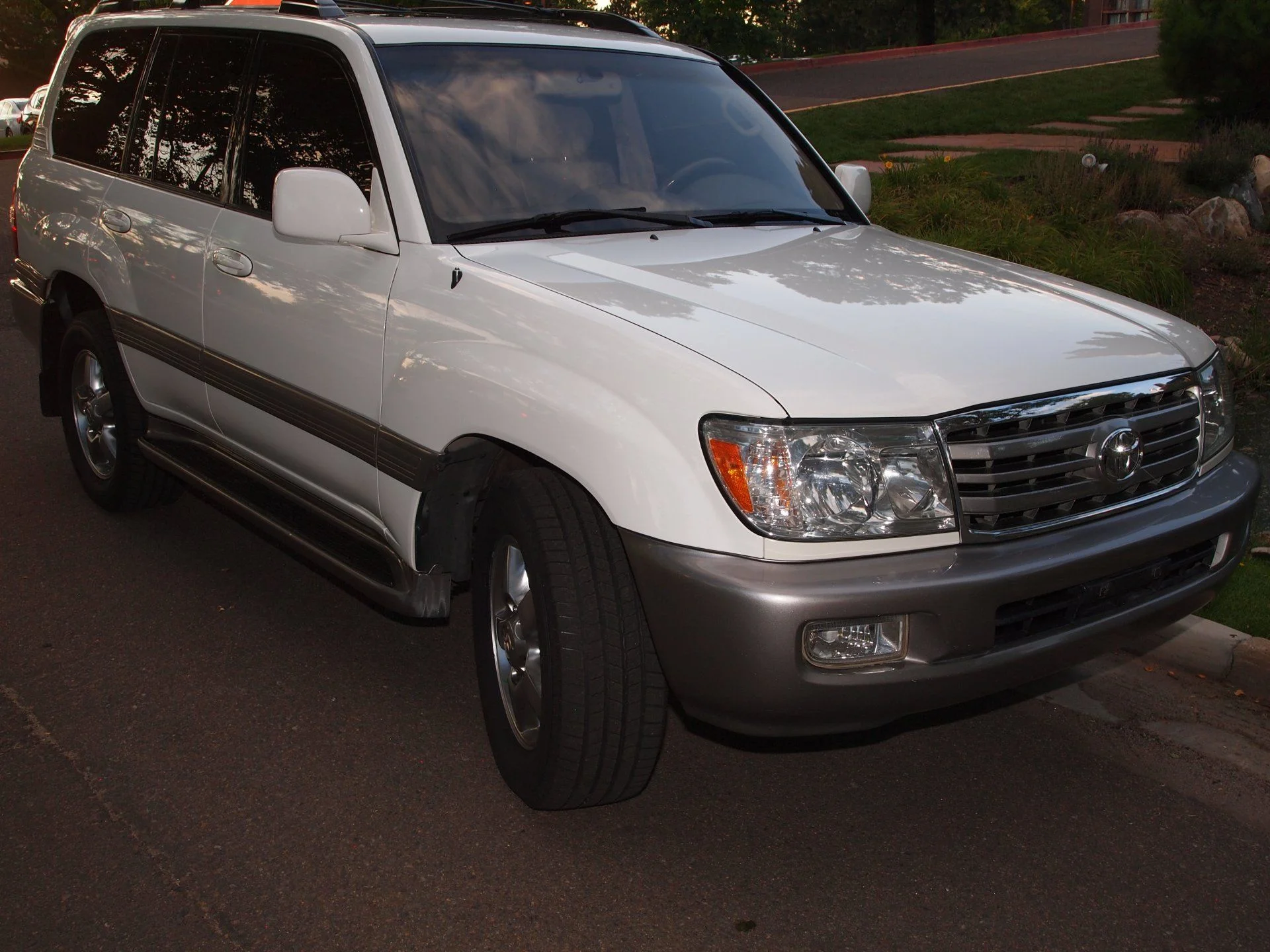

Wowzers, she looks brand new! great job with the detailing. I love that OEM rear spoiler, been looking for a decently priced one to throw on my rig as well. It completes the look of the rear.
Thanks @FxFormat & @HeavyEarly. I'm learning a little more with each project, and I do think Snowy was my finest work to-date. The King is really getting jealous, he wants some of these ~300 parts as well.;)
Snowy headed out yesterday to it's new home after 90 days with me. Perhaps the new owner will make some posting here on first impress, value, how the drive home went and keep us updated over the years.
It's likely Snowy will need other parts over the years, but so much of what we'd except to fail in next 100K/10yr has be dealt with on Snowy. Issues like intake gasket of the VVti to zero clunk with new front drive shafts, hub flanges & front differential bushings..WOW it was sweet.
The engine sounded felt amazing with very little exhaust smell as I did final idling (adjusting AHC and other inspection) in my garage. As many of you know we often get that raw gas smell on warm up and some even after. With all the work done on intake & spark it was like new, I could close garagae door while idling .. so cool.

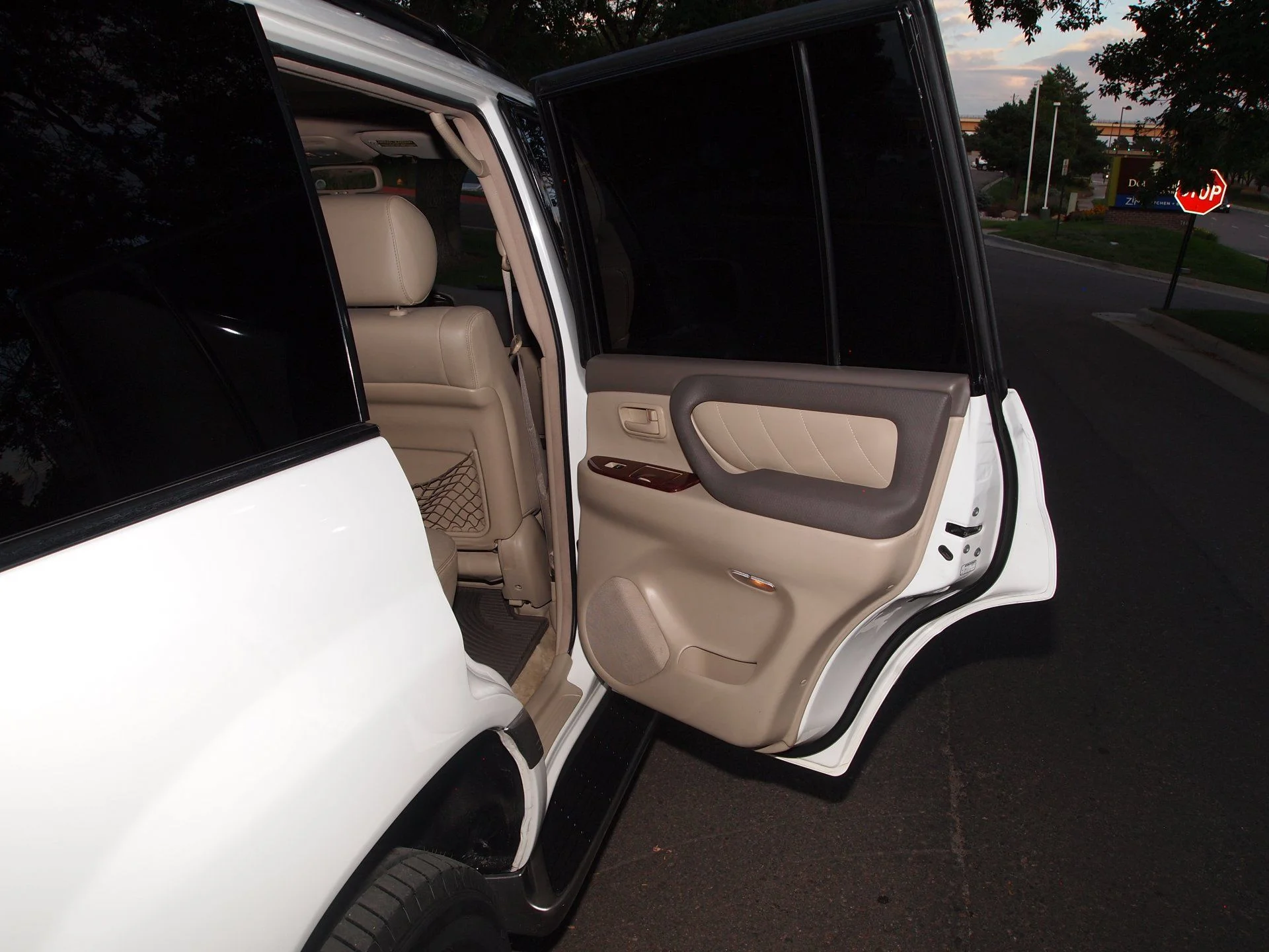

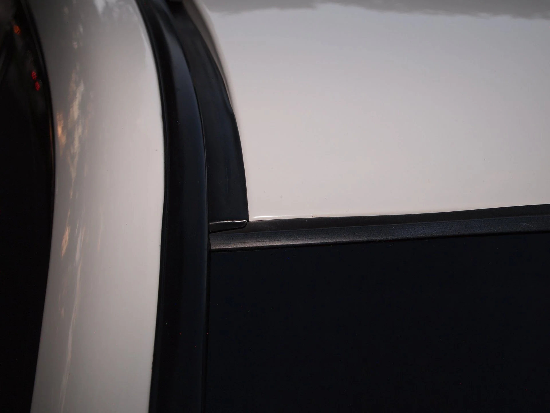

On finial cleaning & inspect I did find a few areas I was not happy with, with no time to correct.
  1. It seem after all my work on the carpet some of the brown color came back around edges along threshold. Should be easy to clean, just pull off threshold plastic molding to get it all. Then once acceptable, a sealer like Scotch Guard would be nice touch.
  2. I never did find a DS front interior door panel, so 3" cut is still there. Here's few (of the many) places to watch for panel:100 Series - Body-Exterior - CruiserYard Used 2001 Lexus Lx470 Parts | Search Used Car + Truck Parts TLS Auto Recycling - OEM Used Auto Parts Parts . Here's source for new that with great $$ but watch the shipping on heavy stuff: RADIATOR GRILLE | LAND CRUISER 100 FZJ10#,HDJ100,HZJ105,UZJ100 UZJ100L-GNAEKC | Toyota | Genuine Parts Catalogs | PartSouq Auto Parts Around the World
  3. Glass of rear deck hatch was badly scratched. Mostly likely from PO trying to clean off grim while on the road, with snow. This can be buffed out with Cerium https://www.amazon.com/gp/product/B005HVU2FU/?tag=ihco-20 https://www.amazon.com/gp/product/B00CL8VIFA/?tag=ihco-20 https://www.amazon.com/gp/product/B00CL9HDAS/?tag=ihco-20 https://www.amazon.com/Glass-Scratch-Repair-GP-WIZ-System/dp/B007CJI6HQ/?tag=ihco-20 I did have not tried these produces. I have used just my paint cutting compound with 3" disk, which worked me to death. Cutting compound does not cut deep enough either. So this looked interest for the job, just could not get my hands on the night before Snowy was leaving for good.

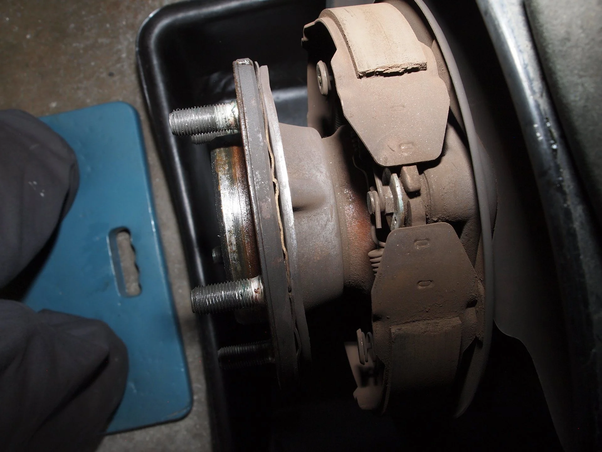

  5. "Scraping sound from rear." I did not hear at first as I was in passage seat on test drive with window down. The air was buffing, as is common when rear vent window closed. So I'm not sure if pressing on brake at that time made a change in sound. Later I did hear and braking did seem to make a difference, but that wasn't clear. So probably a rear brake pad rubbing occasionally. But it could have also been the oil deflector gasket also. This gasket sits between the rear axle shaft hub flange and oil deflector. When a lug nut is over tighten (generally with impact wrench at tire shop), it bends the oil deflector. Then the gasket start coming apart and can rub on E-brake area as it comes out. Snowy had no sounds like this on test drives my GF and I did before new tire installation at Costco. We both agreed there was nothing remarkable on our drive. This sound started after Costco used impact wrench on lugs, and over-torqued "I checked!"
Here a piece of the oil defector gasket I found on earlier rig I was working on (IIRC it was GrayBear). This was first time I became aware of this issue.
It seem to be a redundant seal to protect outer oil seal of outer bearing. Name implies it's to deflect oil, possible in event seal failure of axle that holding back gear lube from differential. It a poor design IMHO, the metal is to thin and bends/presses in to thick gasket to easy. I'll bet most every rig on the road, that's been in a shop that used a impact wrench on the rear lugs, has a bent oil deflector. IMHO this seal is not worth replacing until the day rear bearing need replacing. It's a job that requires a press, and all axle bearing and seal must be replaced just to get at this one gasket. This is just one of the many reasons I use shops' that allow me in bay while they work, at Costco they don't. I press on them not to use impact "they said they will be using", but are only set to 50lb torque. That is BS, where it may only have 50PSI to it, the speed they spin on can certainly cause lugs to be over torqued as these were.

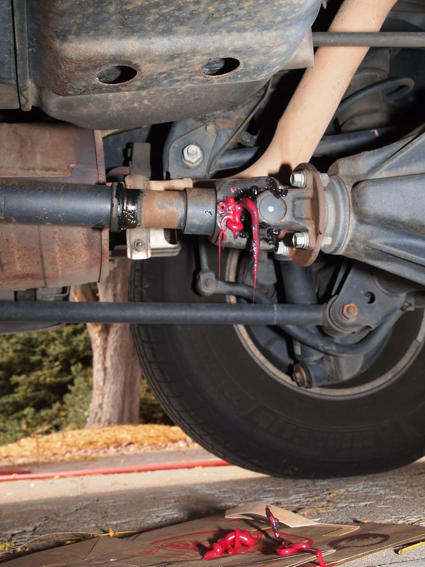

Turn down your volume, my compressor is running and it's so loud. You'll see at very end of video some grease flowed passed the seal. This one was a very dry propeller shaft and tight seal. I use the pulse/pump technique here as you can see.
Here you see the grease zerk removed and how much grease came back out as I lowered AHC to "L' in this LX470. Without AHC one can jump on rear bumper. I jump/press on upper radiator support at front, as don't like stepping on the front bumper.

With time and miles these seals become worn and actually work better at allowing grease to pass. The picture below is Snowy where you can see the grease passed the seals during lubing. Grease passed relatively easy, which is nice. But this also means it MAY (not will) need grease a little more often the 5k miles intervals. The red grease is M1 )Mobil 1 #2) the purple is Amsoil #1 w/moly
In Snowy I would recommend just using the more common #2 NGLI grease for now. This it’s what most all shop have in there grease guns. I like the Mobil One synthetic #2 NGLI grease, a little more costly but it’s top shelve. Since I used a lighter grease (#1) first time, it may have a shortten time between intervals, before clunk/thunk observed. It will probably go more miles between lubing by using the thicker #2 NGLI from now foward.
Once the slide yokes are working well and regular lubed, it only takes 5 to 10 pump with the grease gun and you'll see some grease pass the seals. Then lower to rig to "L". If more grease passes seal as it lowers, you will not need to remove the grease zerk.
