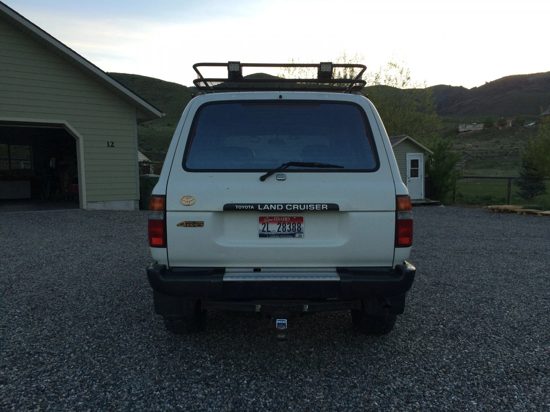

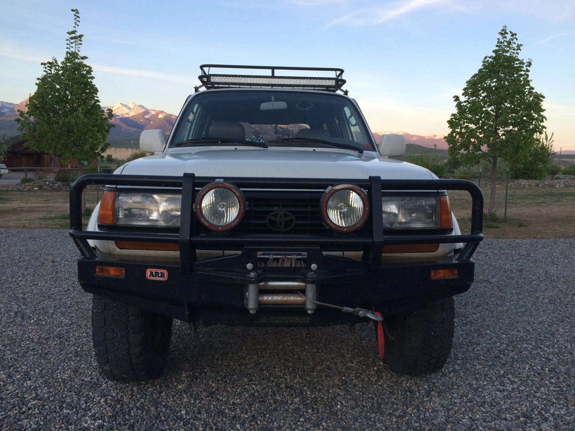

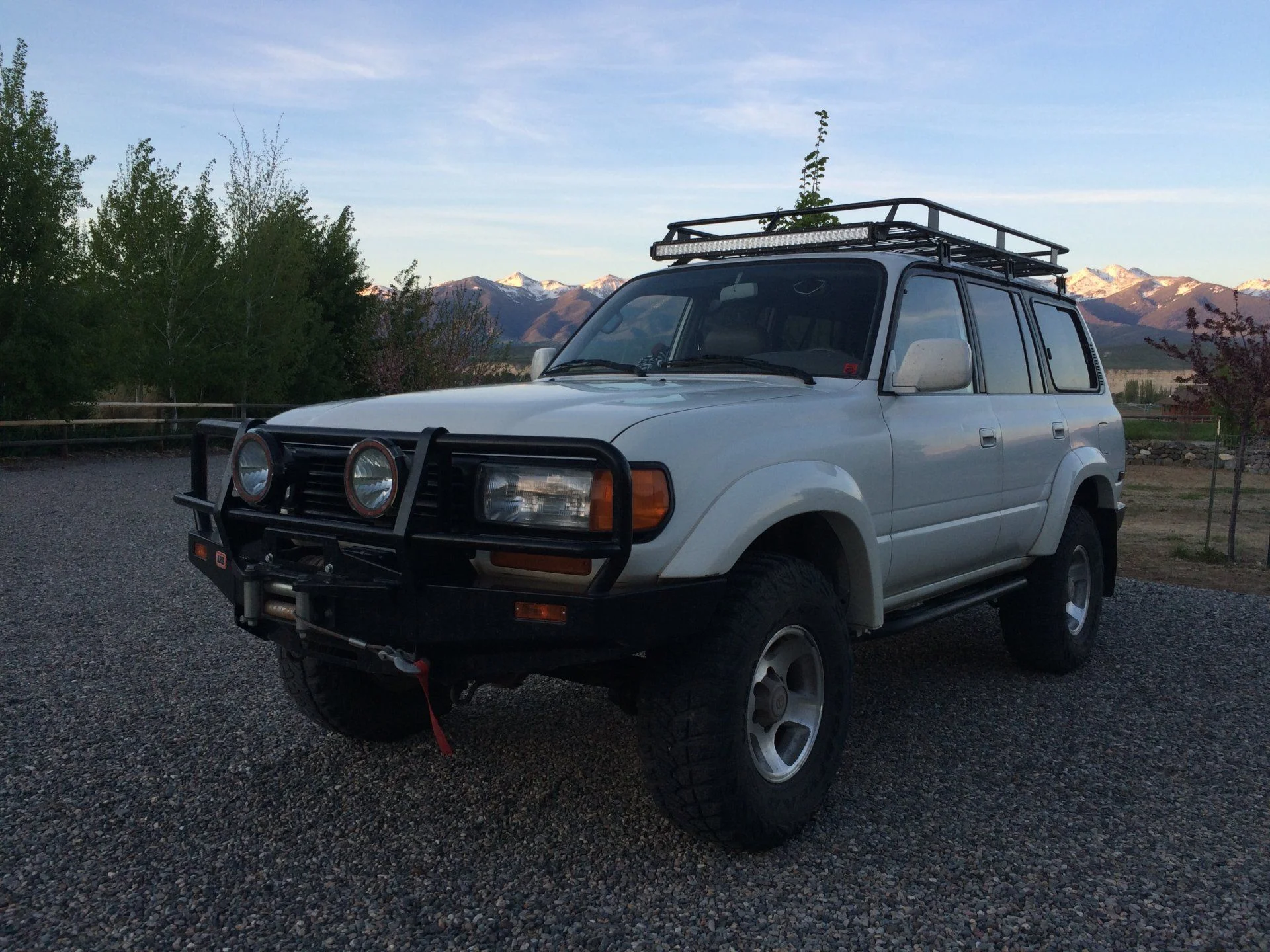

Anyway, back to my original point. A clean rig deserves a photo. And in taking the photo I noticed how much progress I've actually made over the last year. In my OP I said this build would progress like a fine wine -slowly. While I'm far from complete, the results definitely please me...
How it looked in Nov 2014 compared to now
versus:
