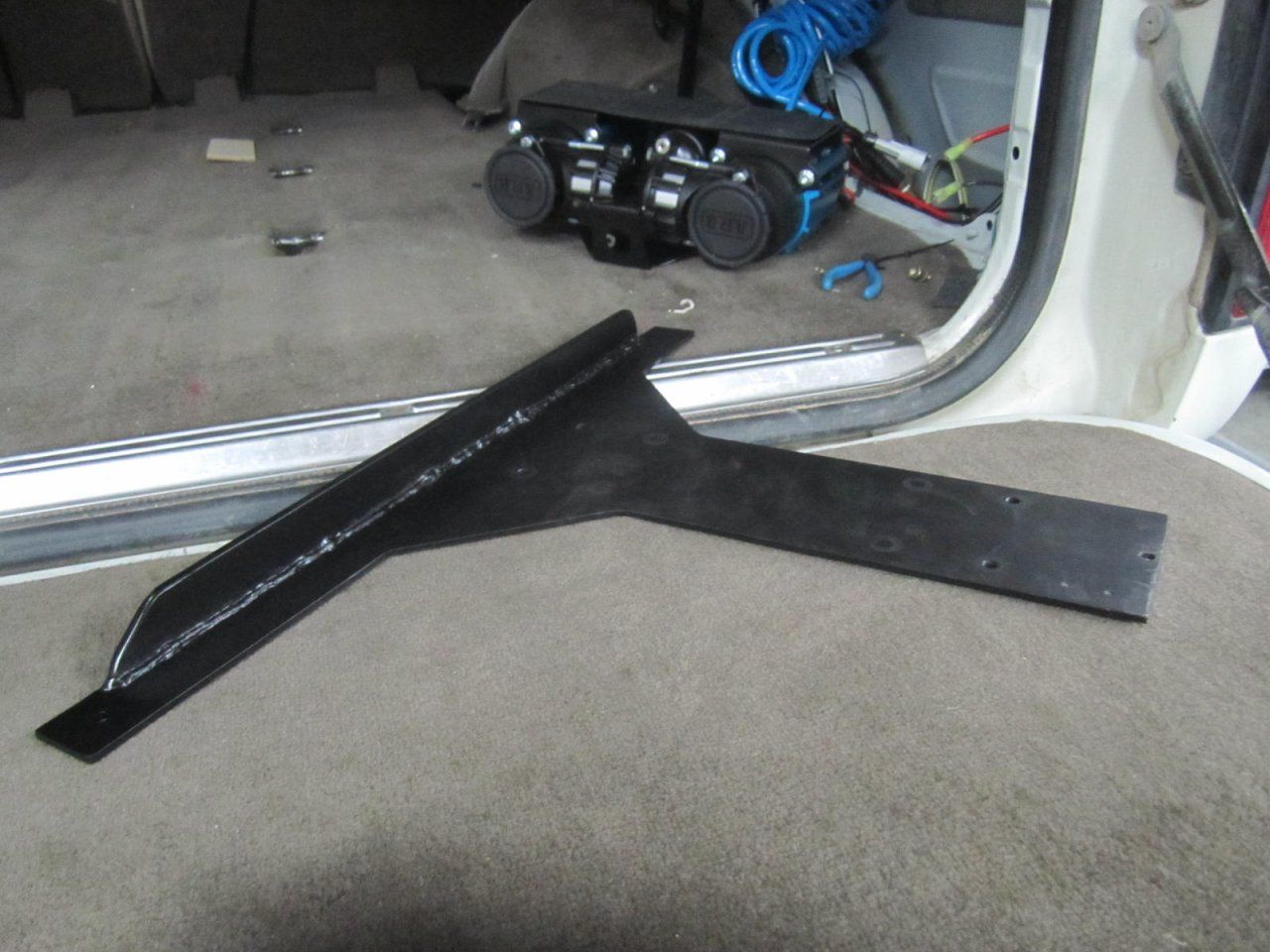

tinker-time on Sunday avo...Per the suggestion of @ppc back on page three, welded a little angle iron on the ARB compressor mounting bracket. Will see whether this reduces the vibration and noise...

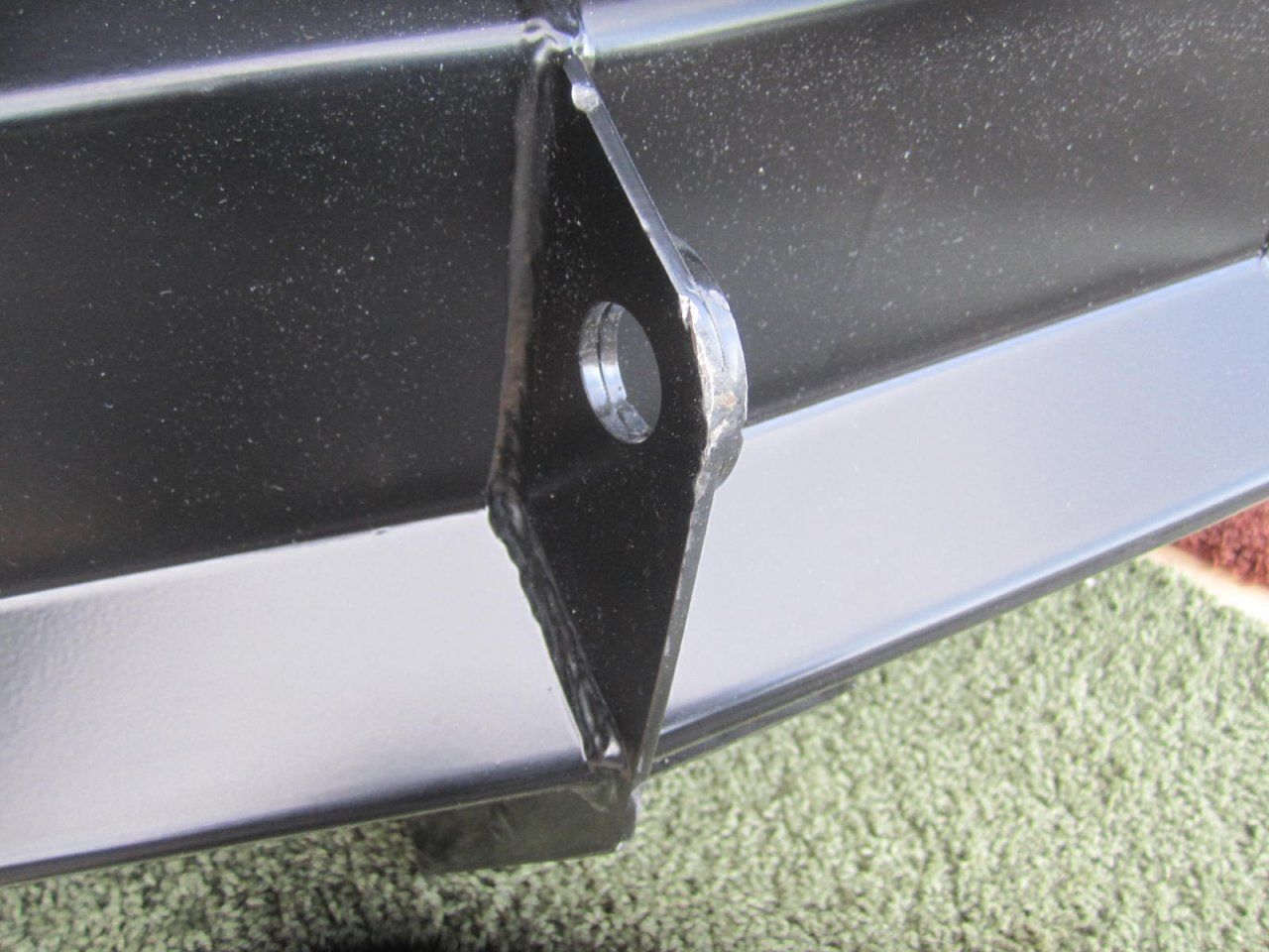

The ARB winch bar was a PITA! For an item that is supposed to bolt right on...over four hours later I put the first bolt in. First obstacle came when removing the factory recovery hooks. One of the bolts snapped in half...
Fortunately, I was able to drill a 1/8" hole through the retained portion, which released the pressure just enough that I could twist it out with a pair of small channel-locks. Then, challenge two: I discovered that either the frame on my truck is tweaked, or the new bar itself is defective. Space between frame was 25-1/2". Corresponding measurements on bar was 25-13/16". Somehow I had to find a way to spread the frame 5/16" apart. Ratchet strap around the bumper mounting tubes, trying to pull them together, yielded maybe 1/128" -if that. In the end had to cut two pieces of hard 2x4 with a progressive angle and pound them down between the frame:
Once everything fit, the winch wouldn't fit the bar. NOTE to BADLAND winch users: you will need to fab two spacers of at least 1/4" material to get this winch to fit.
Anyway, like i said...over 4 hours later the bumper was bolted on. Had to twist the AC Dryer up and over so it would remain safely behind the protection of the bumper. When reinstalling the factory recovery hooks/loops it took another hour of tweaking and hammering, and finally carving both DS holes in the new bumper with a die-grinder so they would accept the bolts...Perhaps this winch bar was a 'second' after all. Here's hoping I don't have to take it off again ;)
