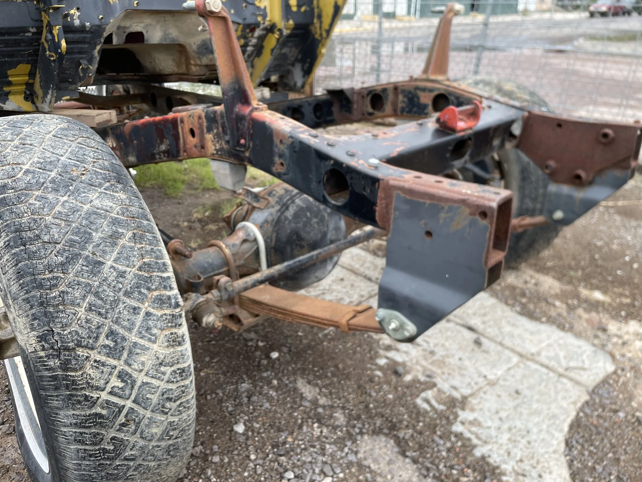

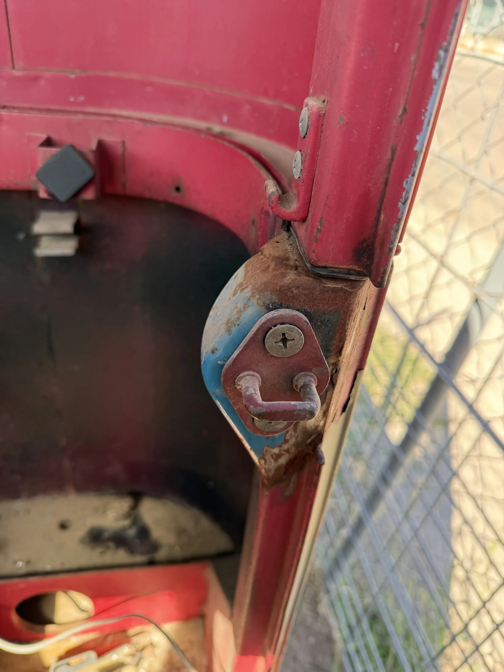

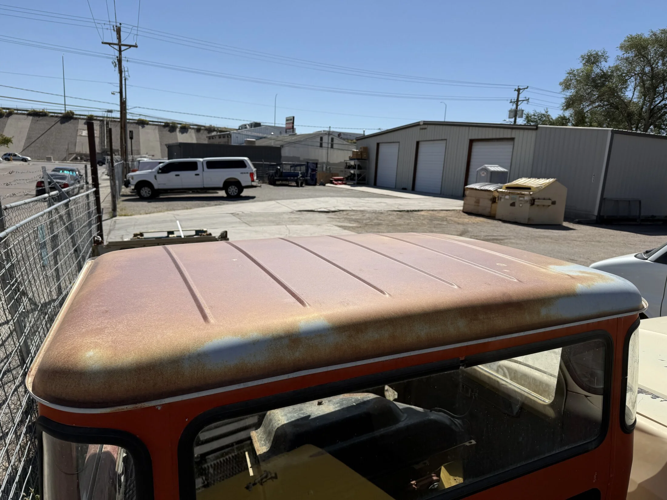

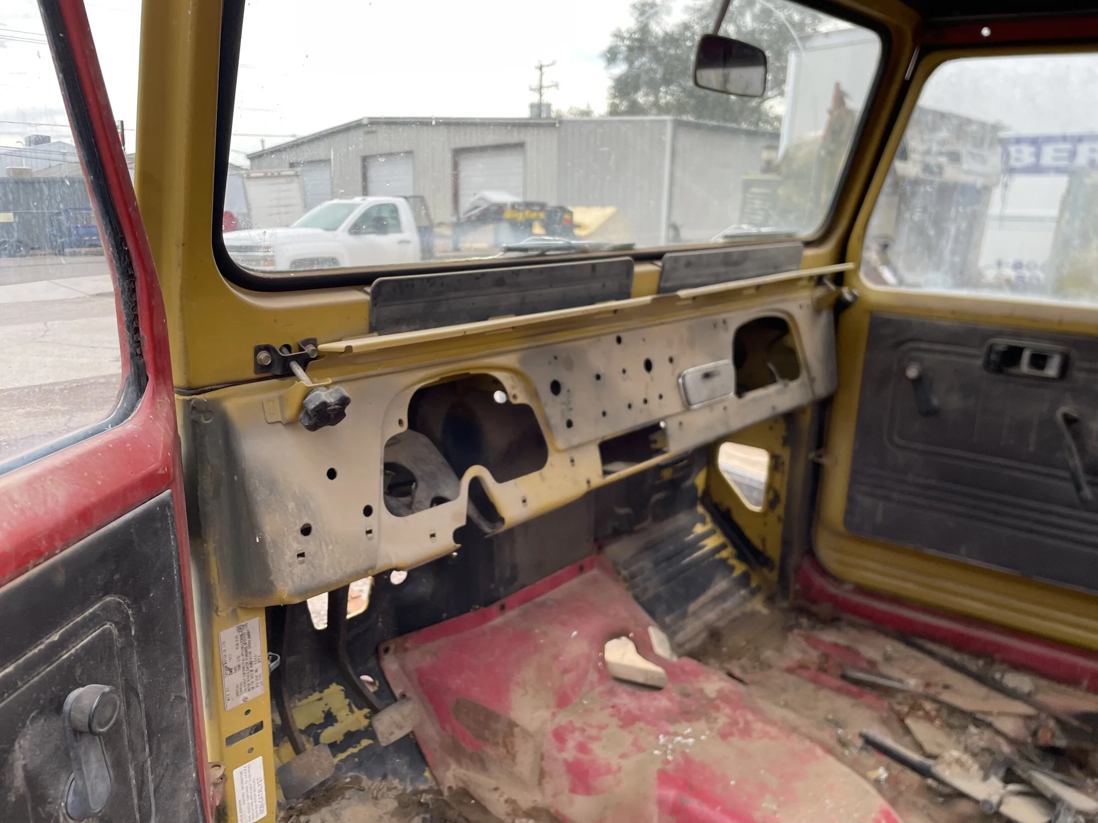

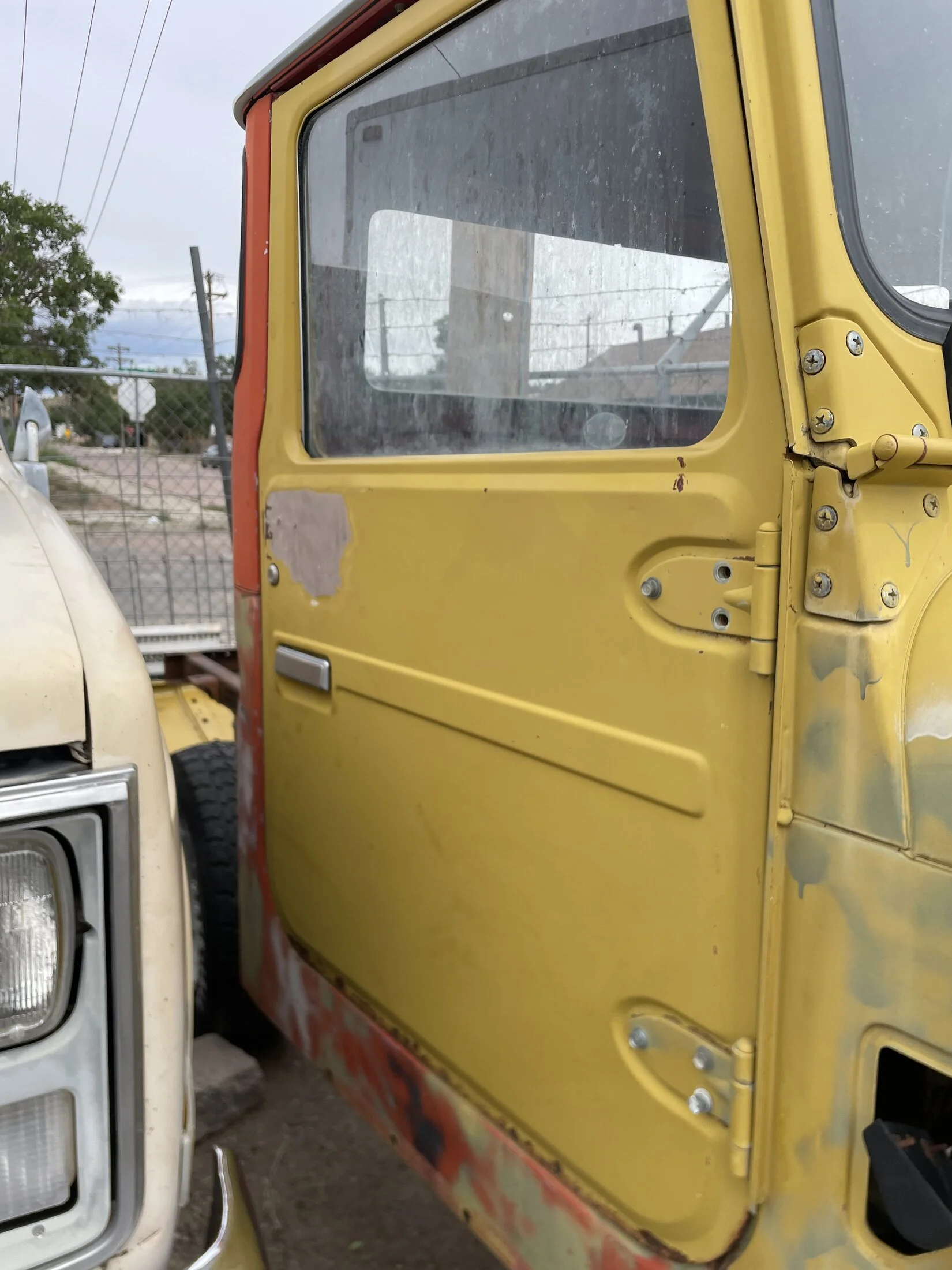

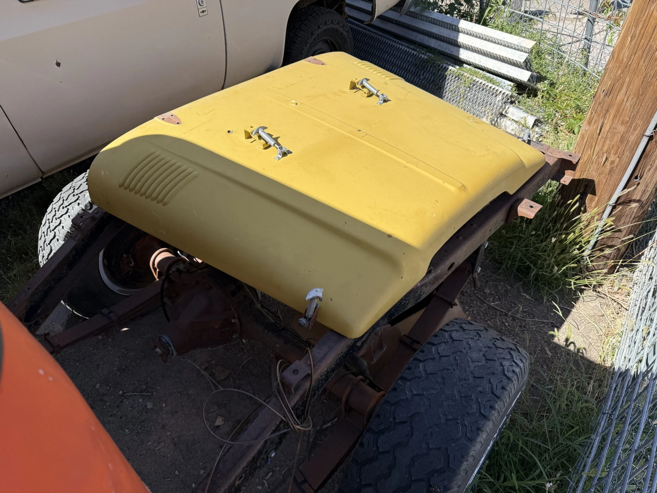

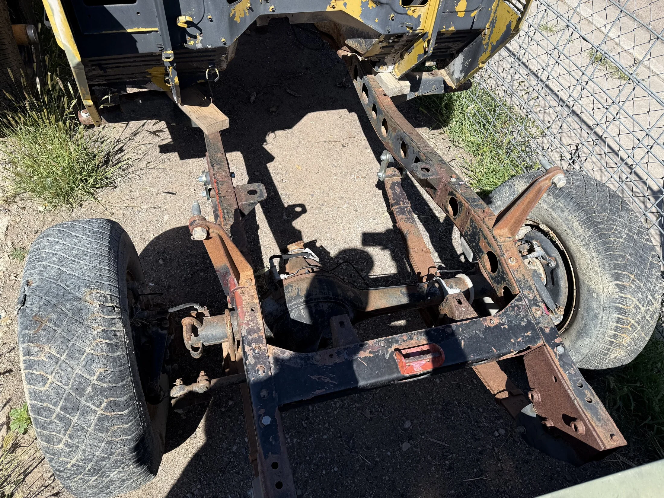

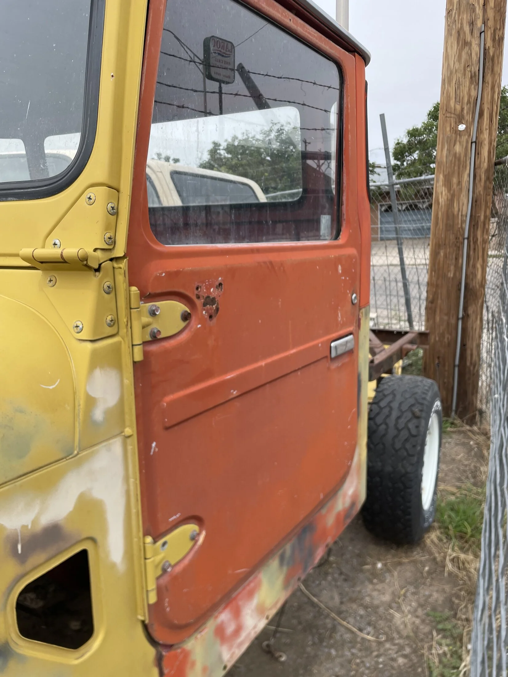

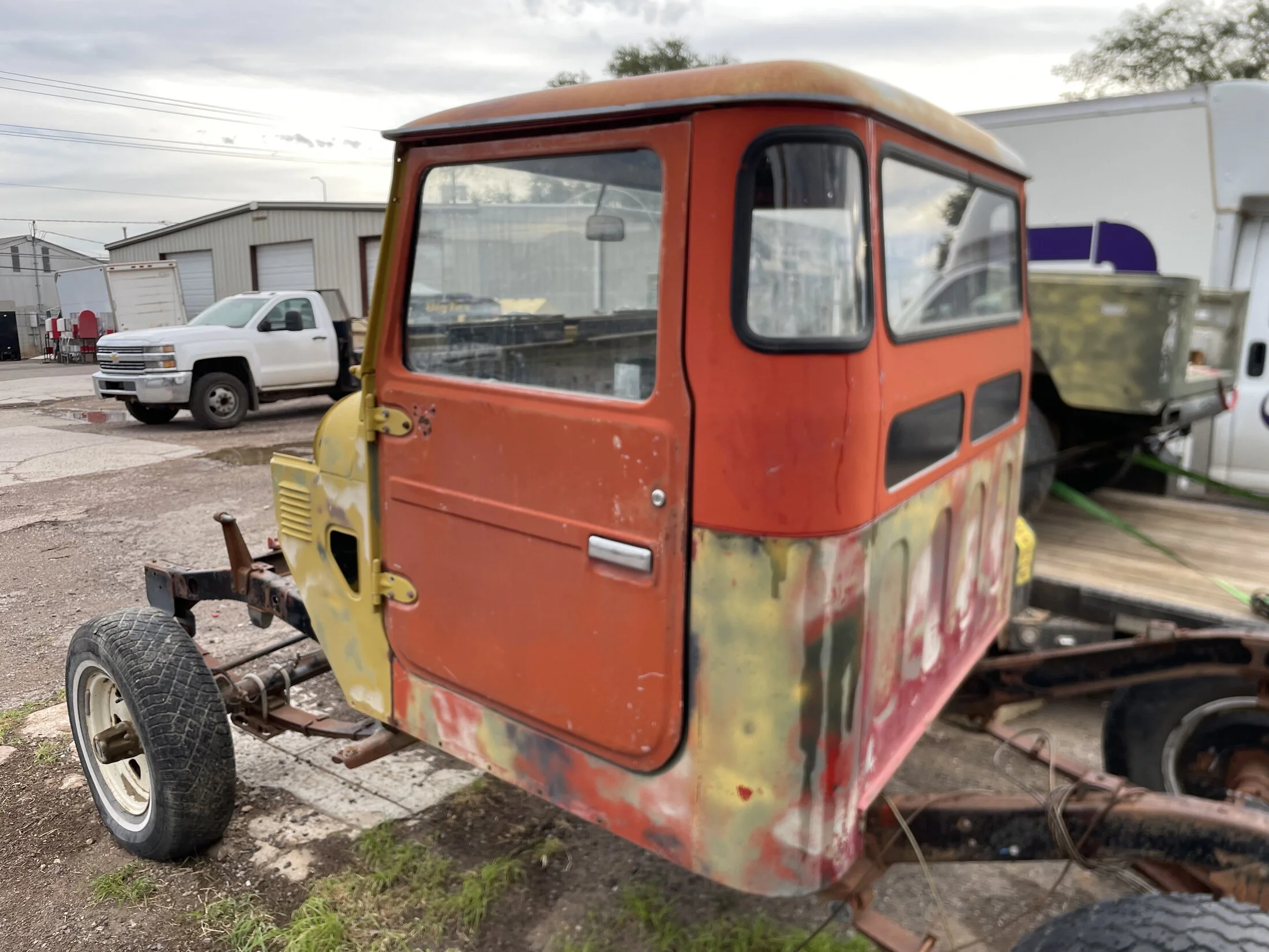

So I’m not sure what year the 45 is. It’s got a removable top. The front clip from the bulkhead forward is from a ‘75. They also converted the doors to the newer style by grafting in the bumps on the B pillars. Here’s some pictures of what we are dealing with.

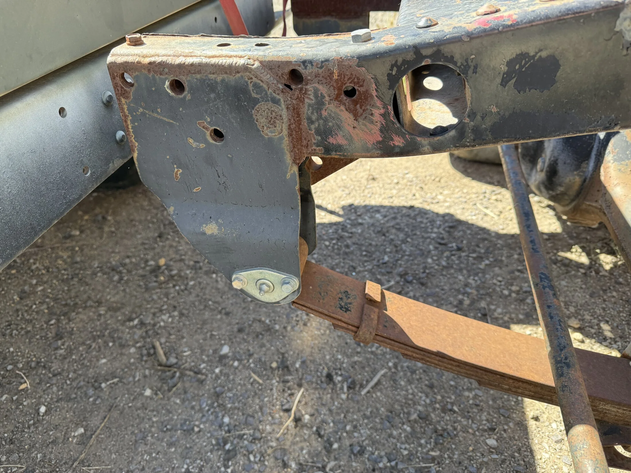

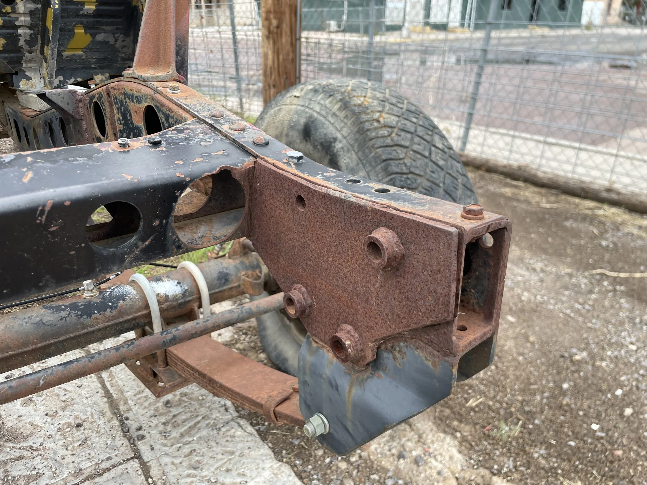

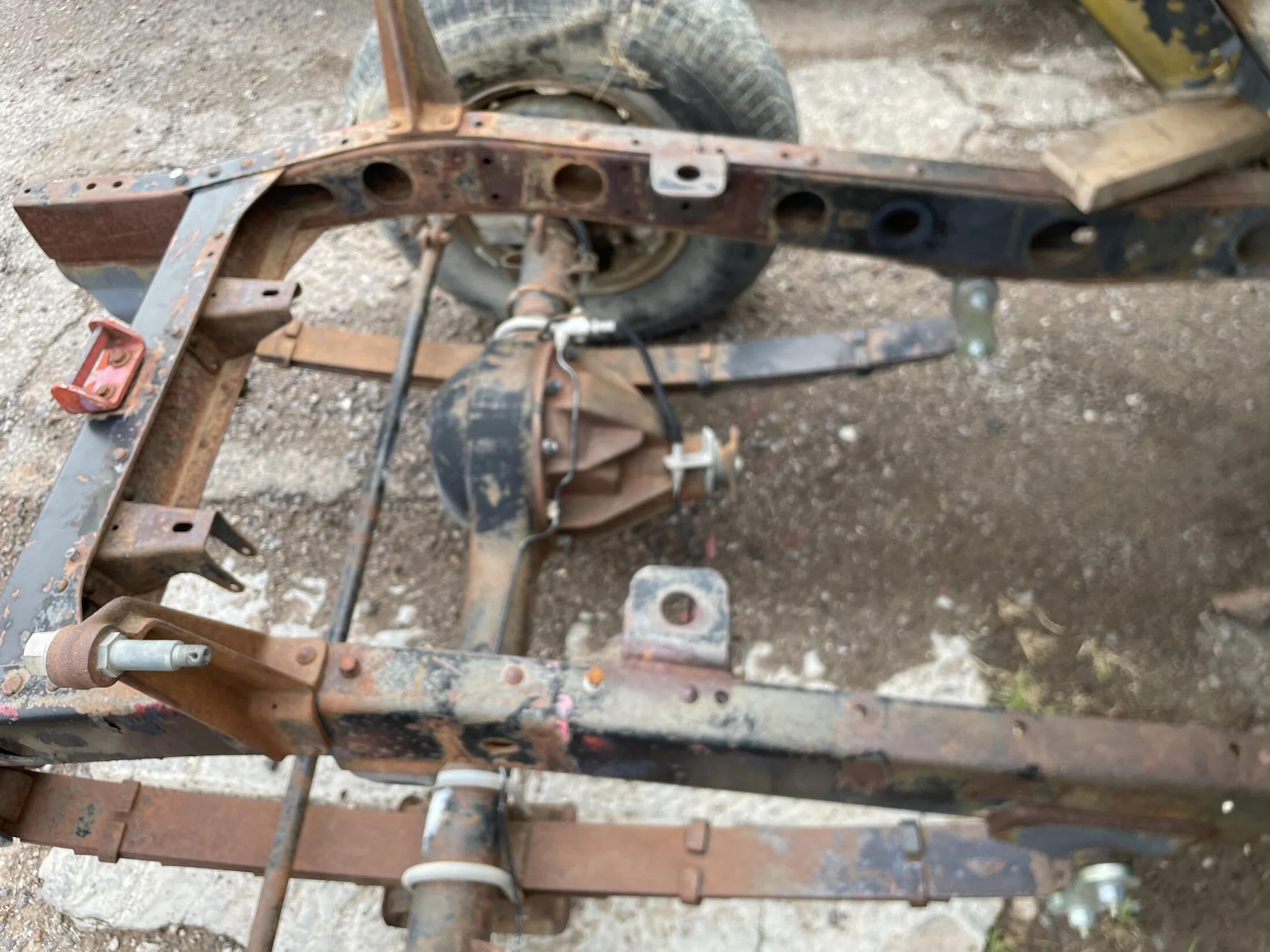

The truck had a shackle reversal kit and a Saginaw power steering setup almost completed. Also has v8 motor mounts and some kind of transmission adapter mounts too. No drivetrain. Unknown axle condition. Nice dash. All good glass. VIN has been covered up so we’ll have to see about titling the thing.

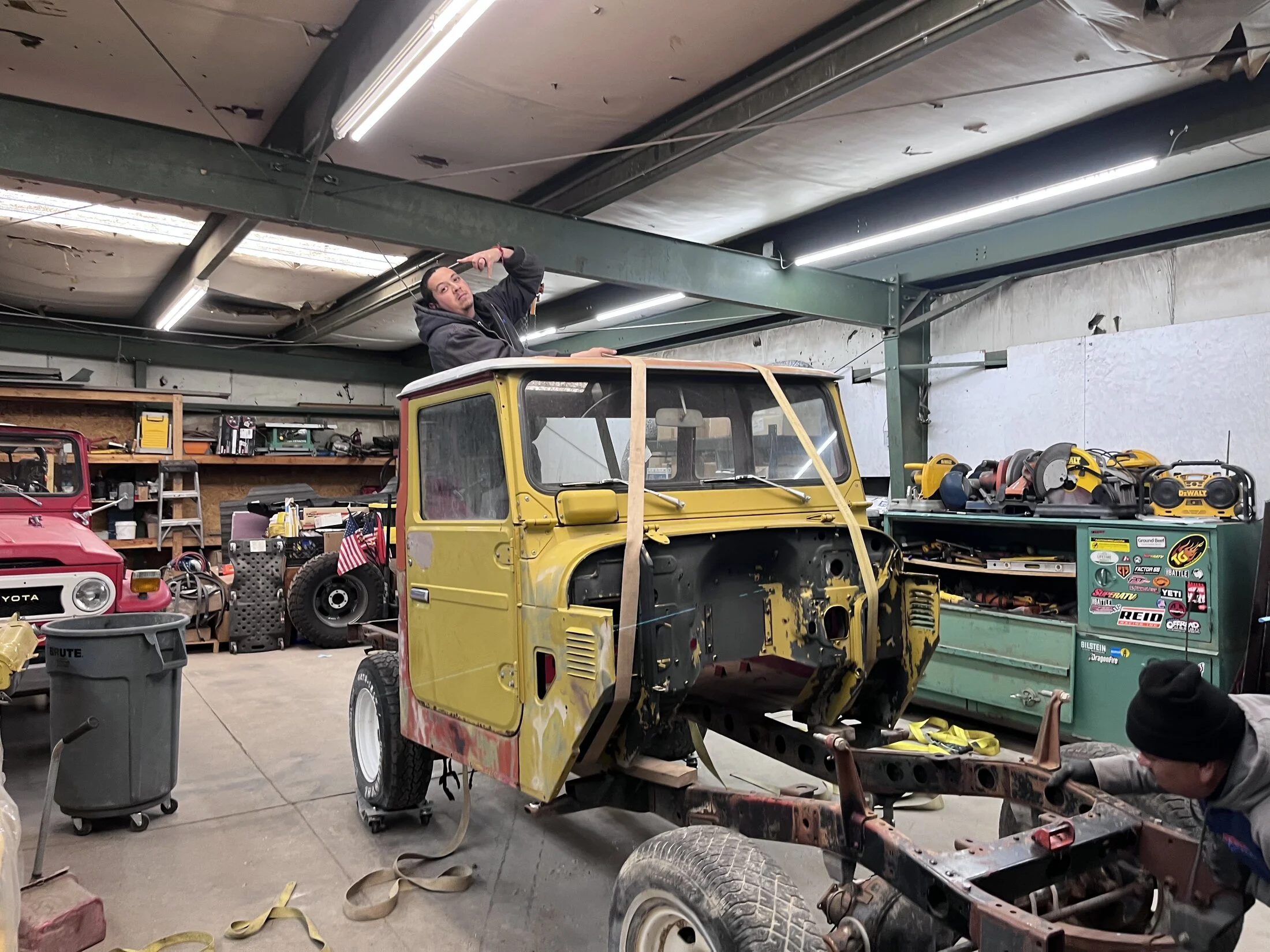

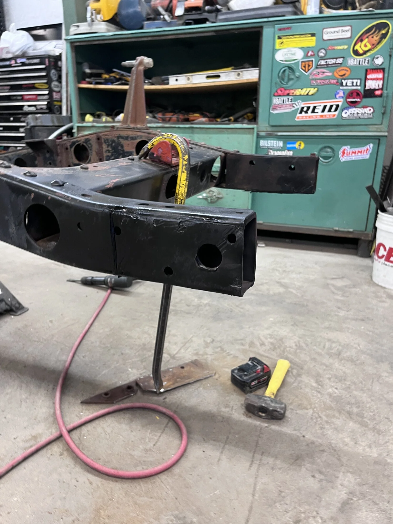

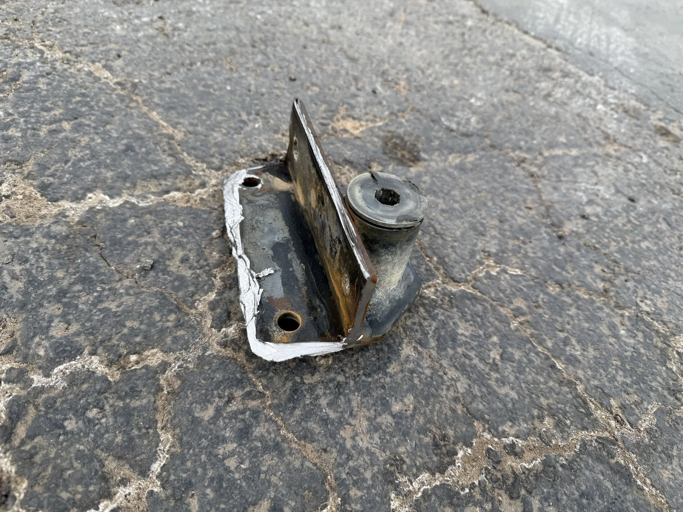

Today was the first day of work on the truck. First thing is to get the cab off. Next reverse the reversal. New perches and motor mount brackets on the way. This will be more of a patina build.

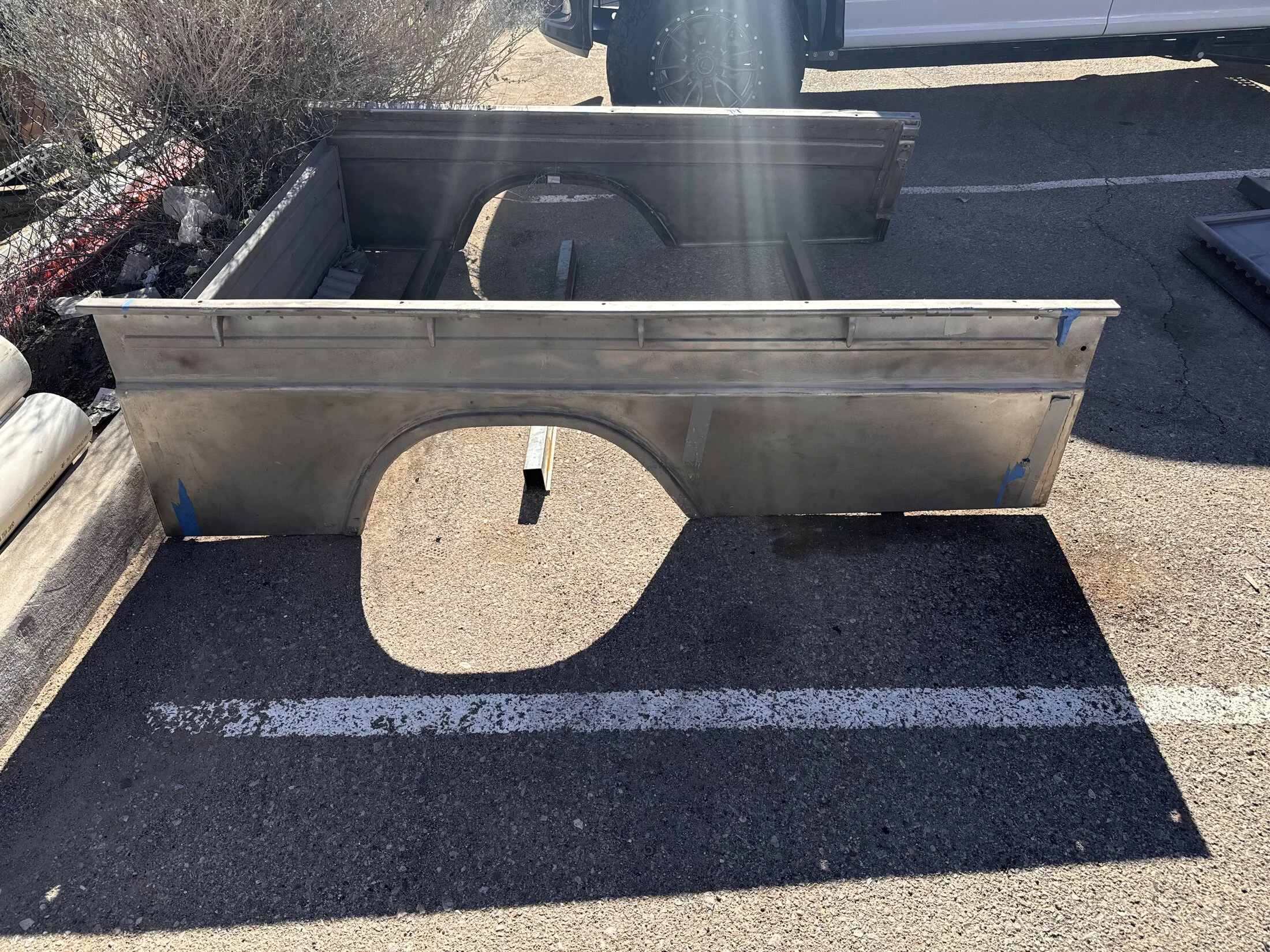

nice project

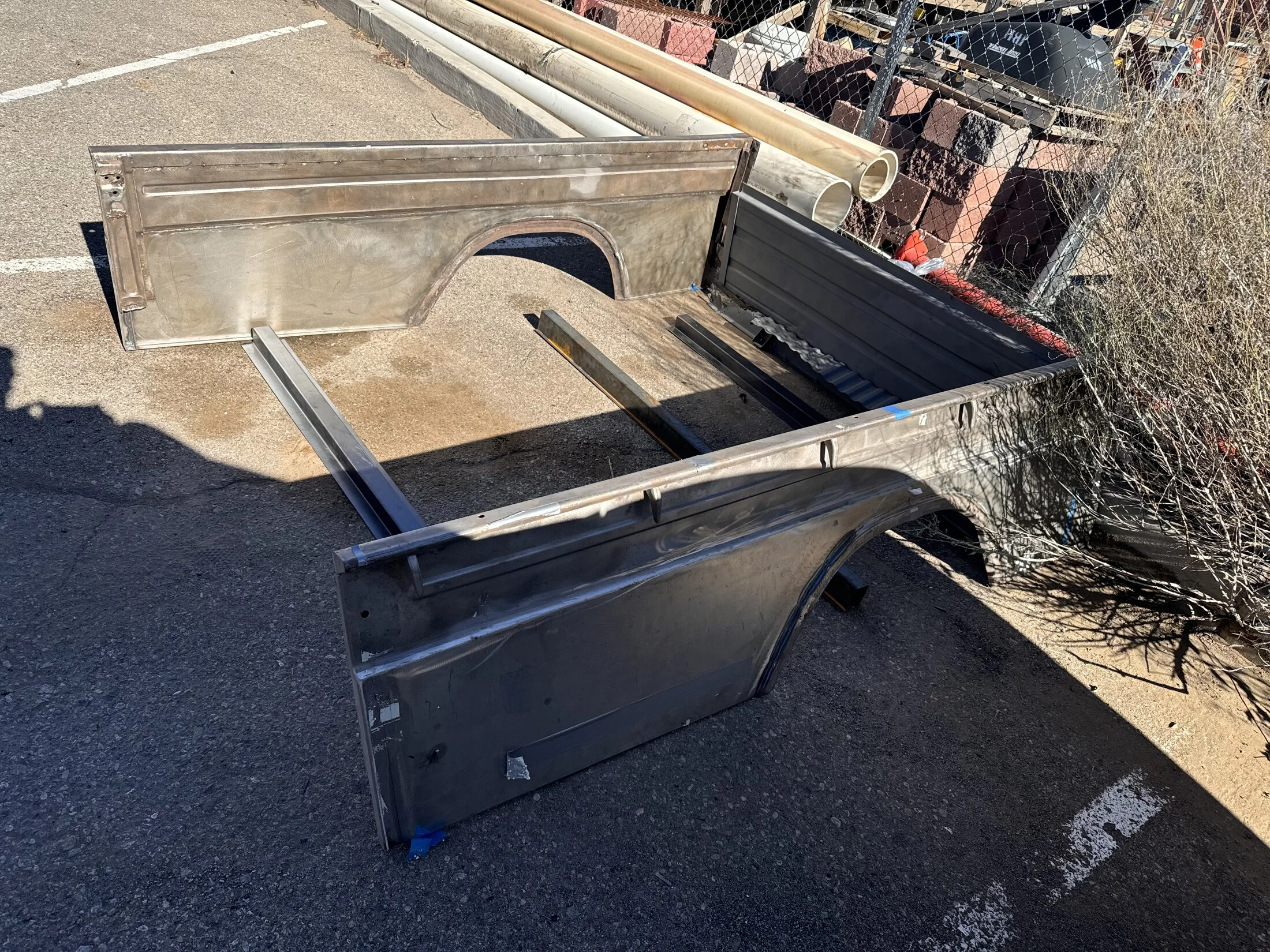

the frame looks like a swb frame looking at where the front mounts of the rear springs are located
the lwb bed will take mods to fit it to the frame or lengthen the frame to fit the bed
take some measurements to verify

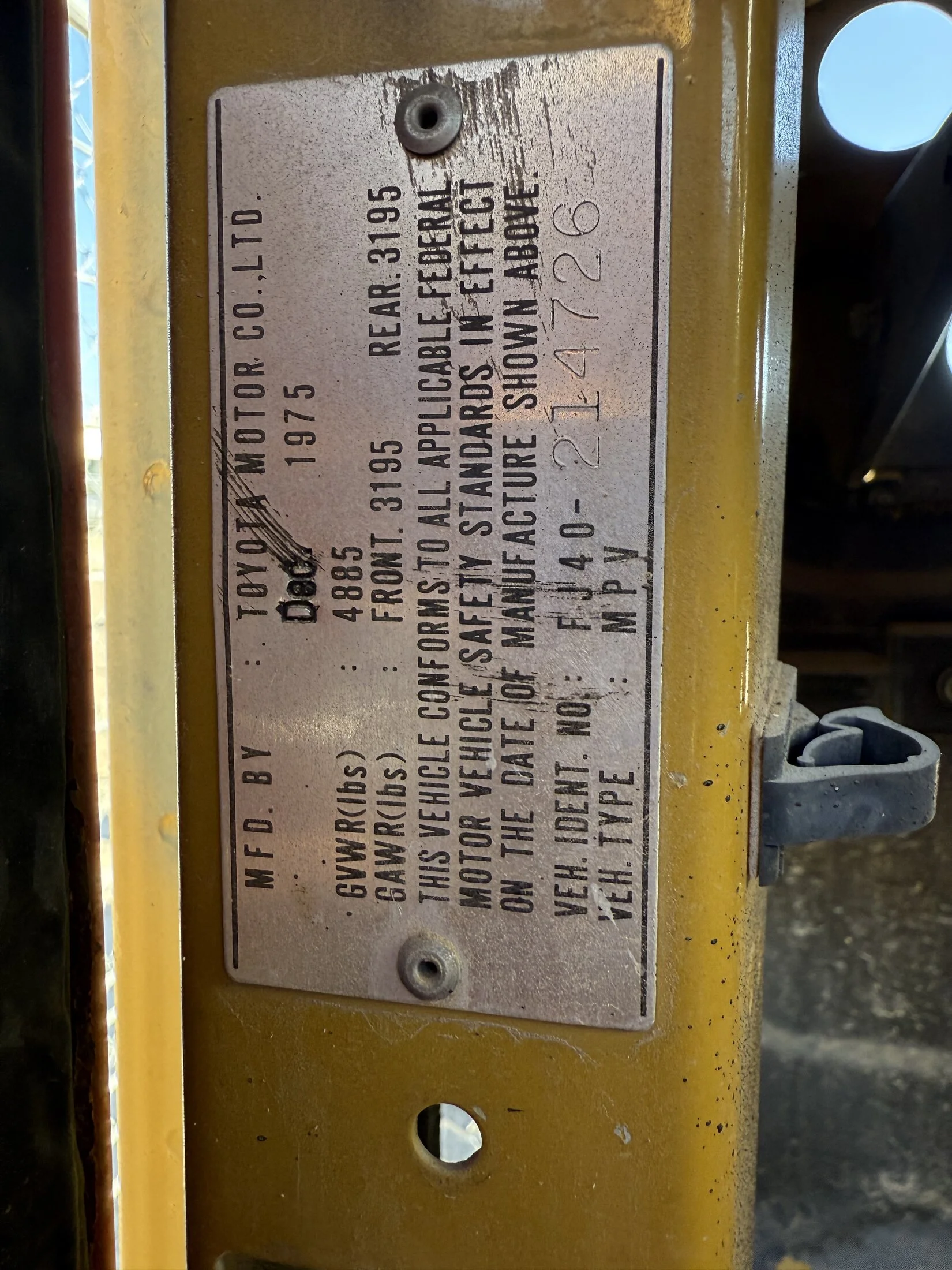

did you find the vin on the frame horn?

The VIN is pretty screwed up. I need to do a little more research. It is a SWB. Any idea what year ranges have removable tops with a SWB?
SWB rigs were only produced from 1962 or 1963 thru 1967 and were either fixed top or removable
more and better info here in the 45 section:
looking again at the pics, is a later firewall looks grafted to the tub?

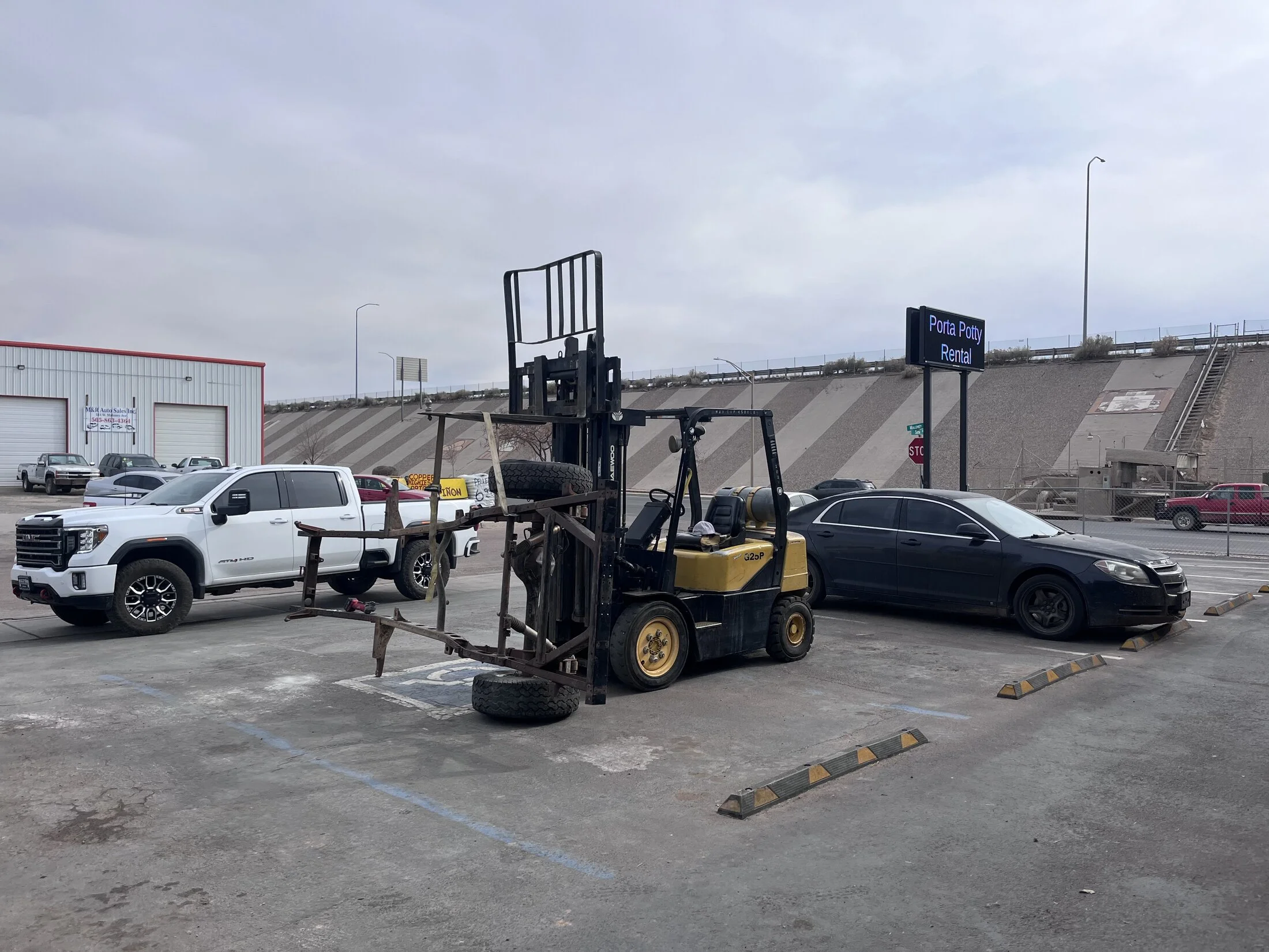

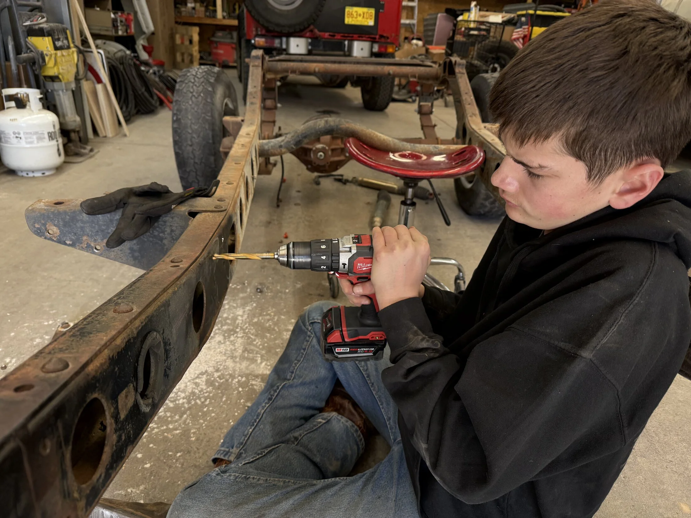

The boy made more progress on Sancho today. Removed the remaining suspension mounts and started on the motor mounts and transmission mounts. There’s a bunch of broken bolts we’ll have to figure out. He loves the forklift almost as much as the truck…almost.

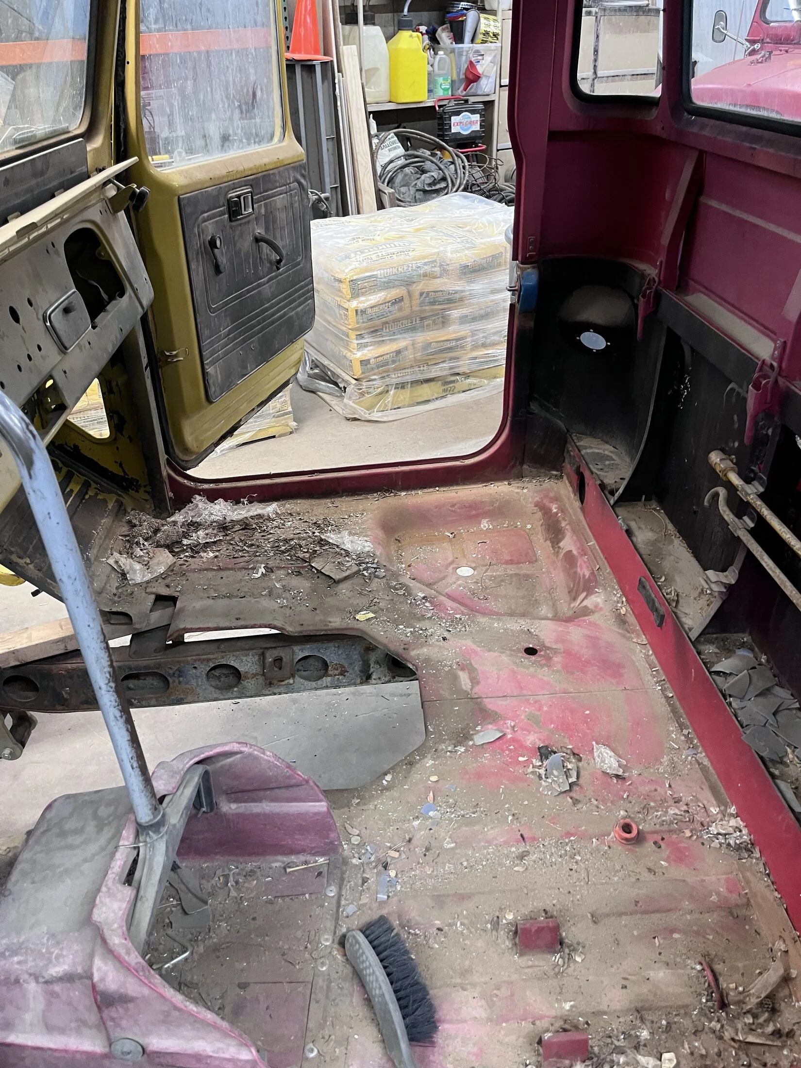

Cleaned out the tub a little more too. Not too clean as it still lives outside for the time being.

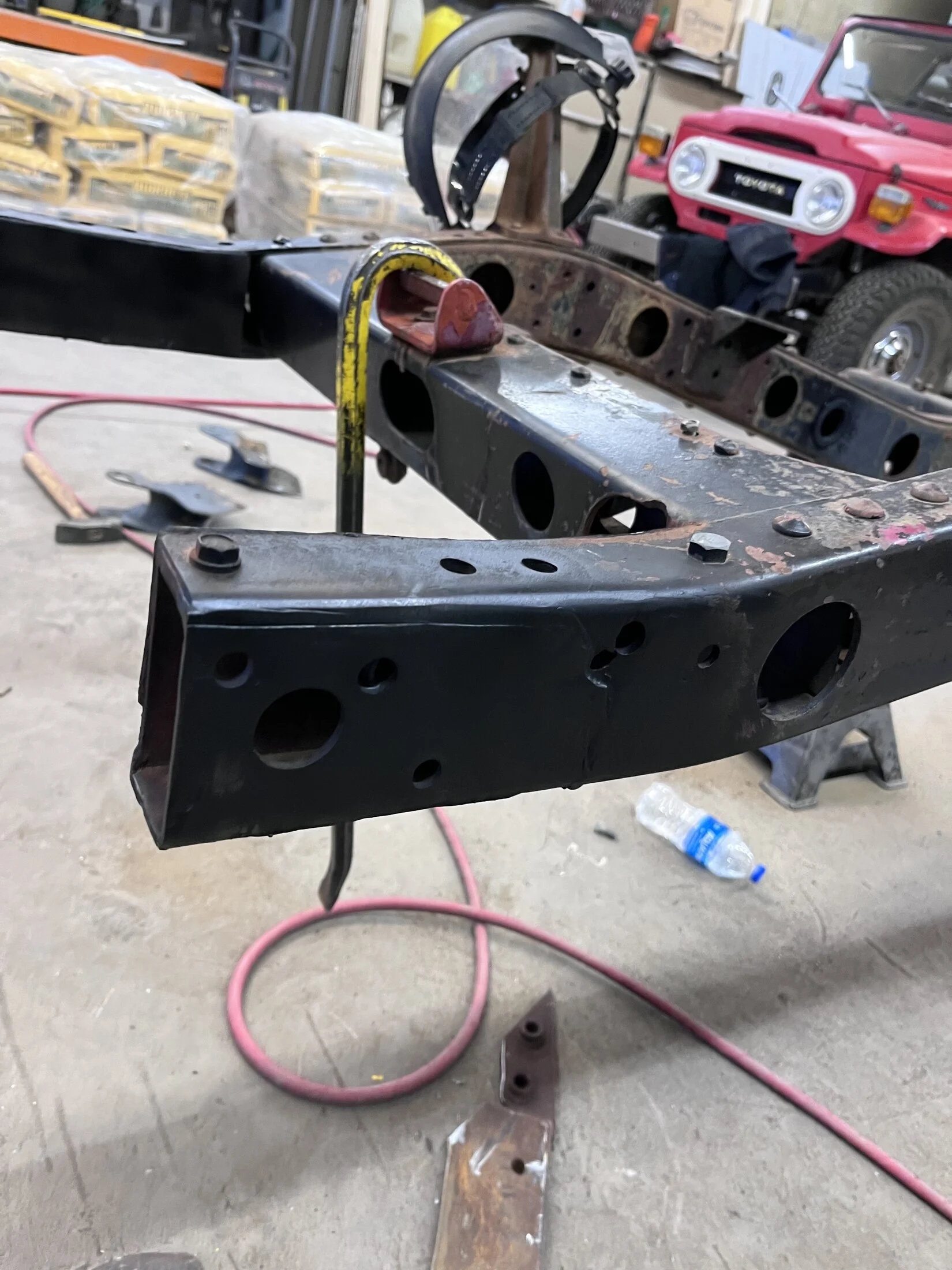

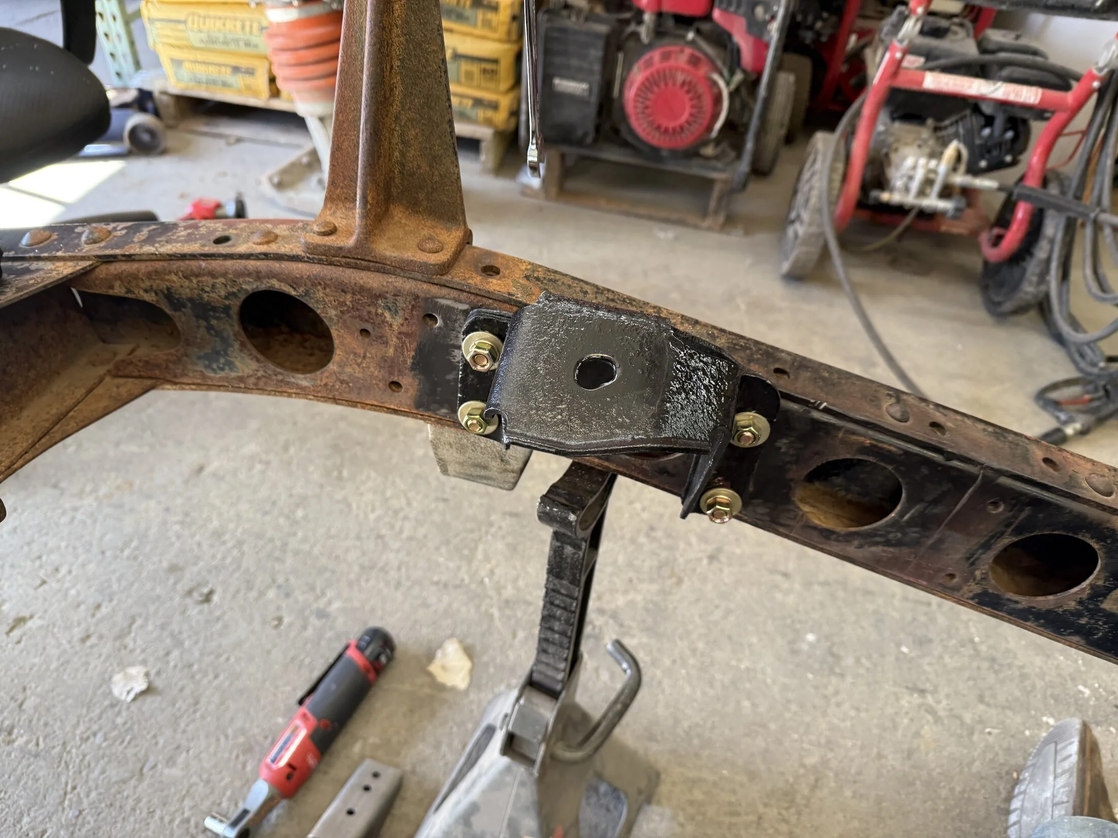

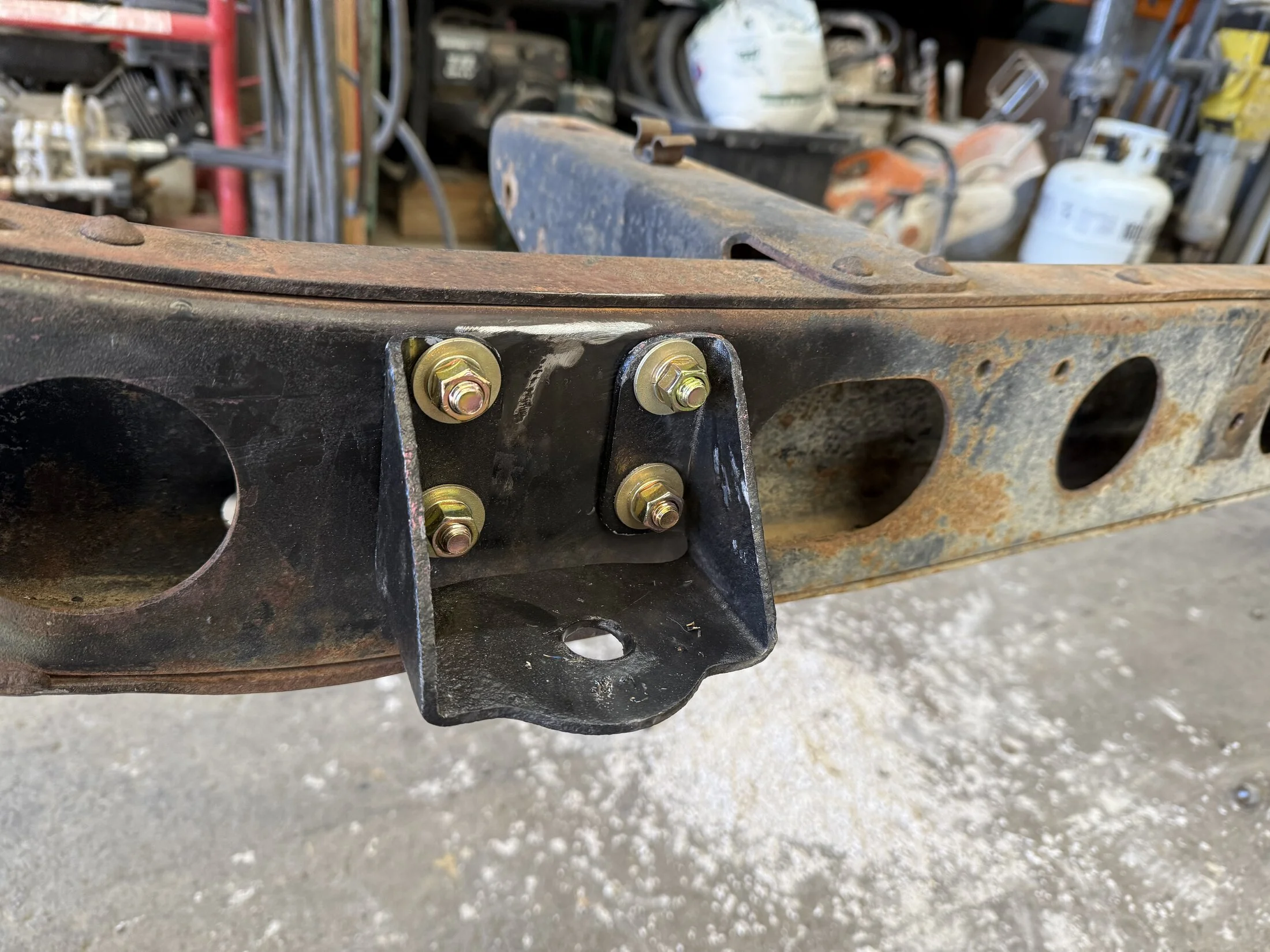

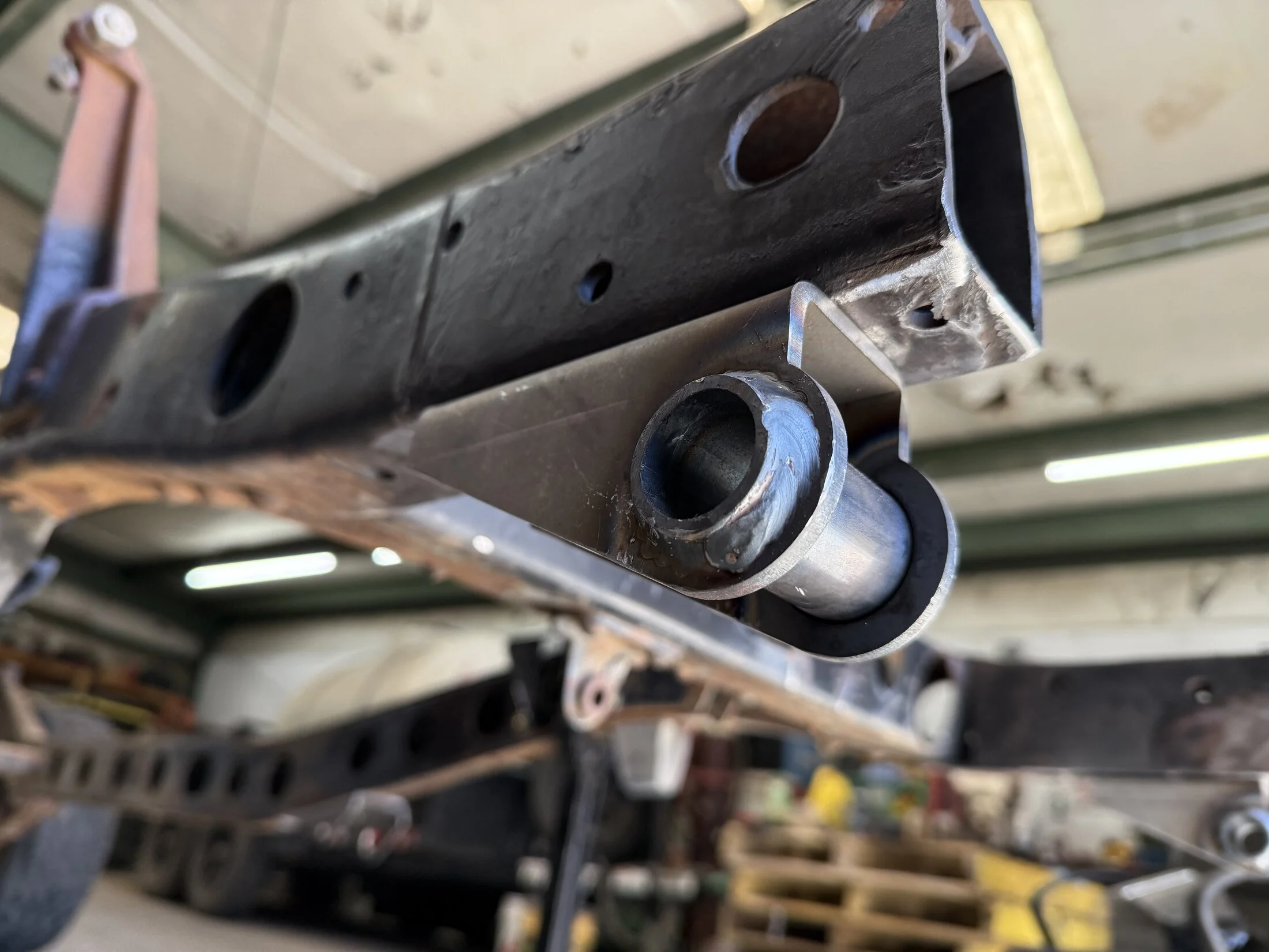

Got all the stuff stripped off the frame and then bolted on the new stuff. Got new suspension mounts and used motor mounts from BTB. I’m on the hunt for frame extensions and bumper brackets for this thing. Does anyone have a set they would sell me please?

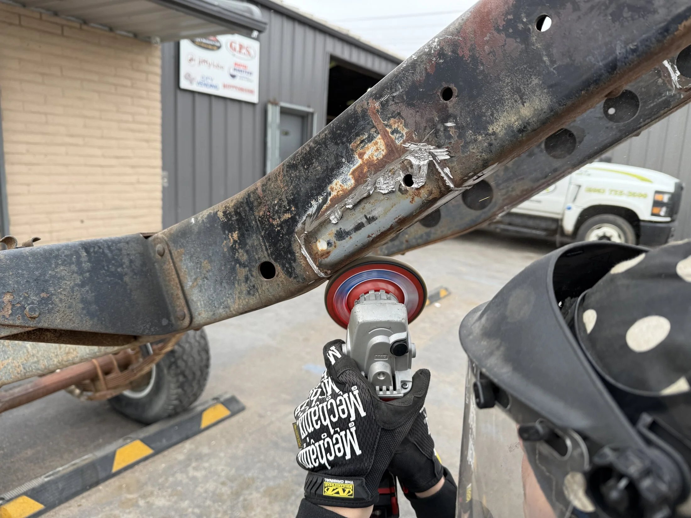

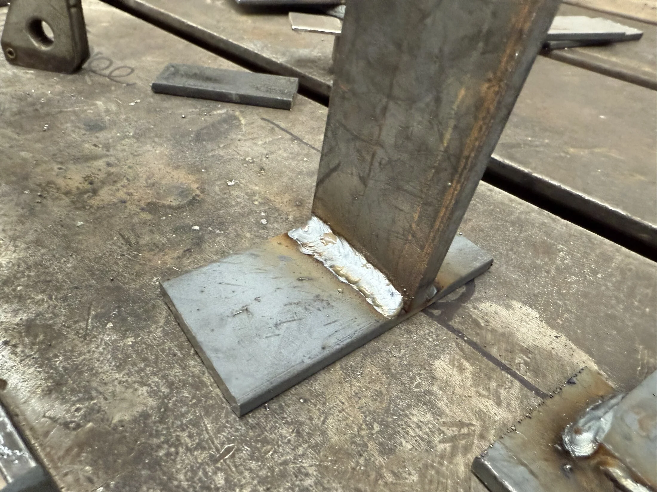

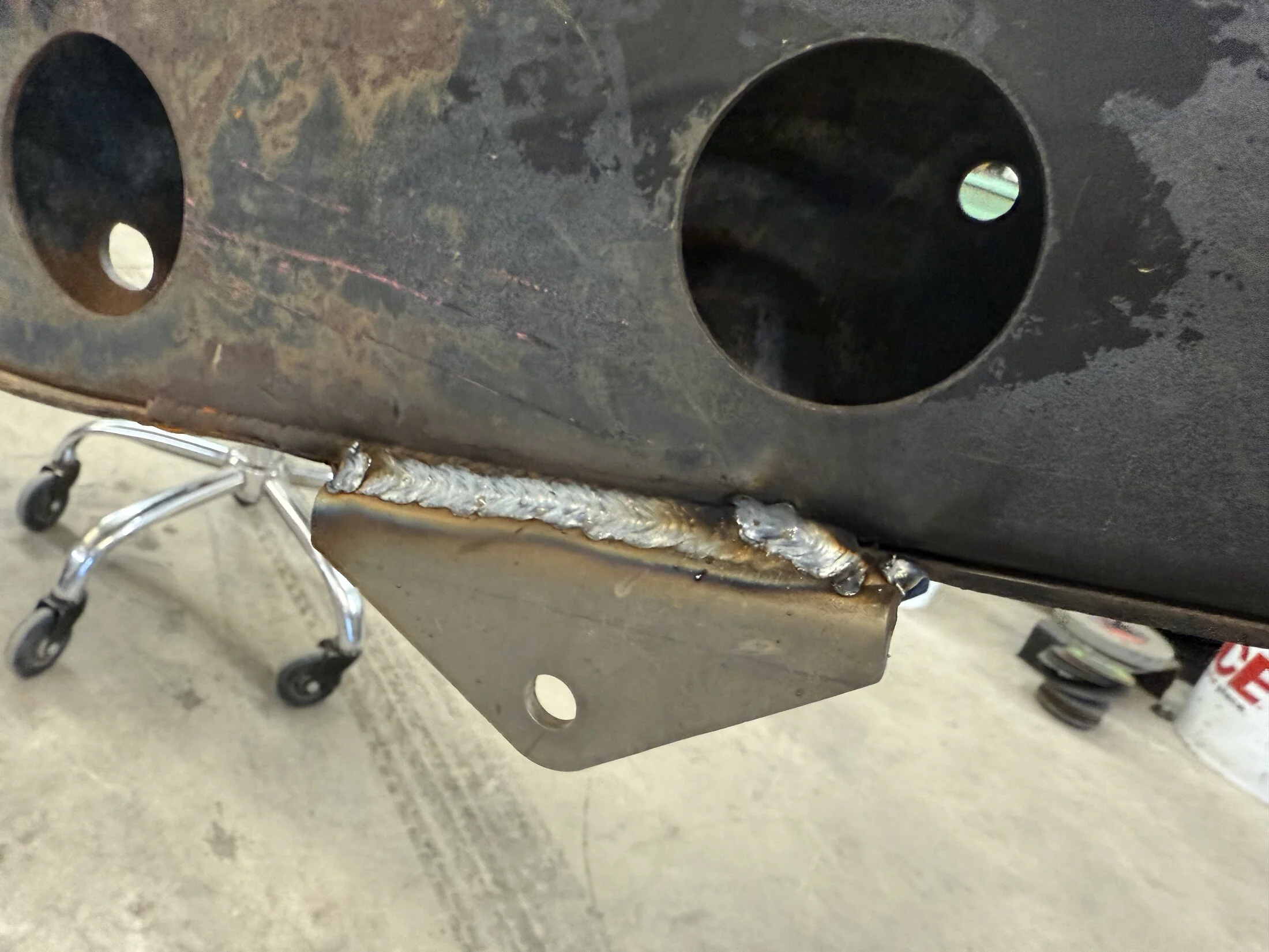

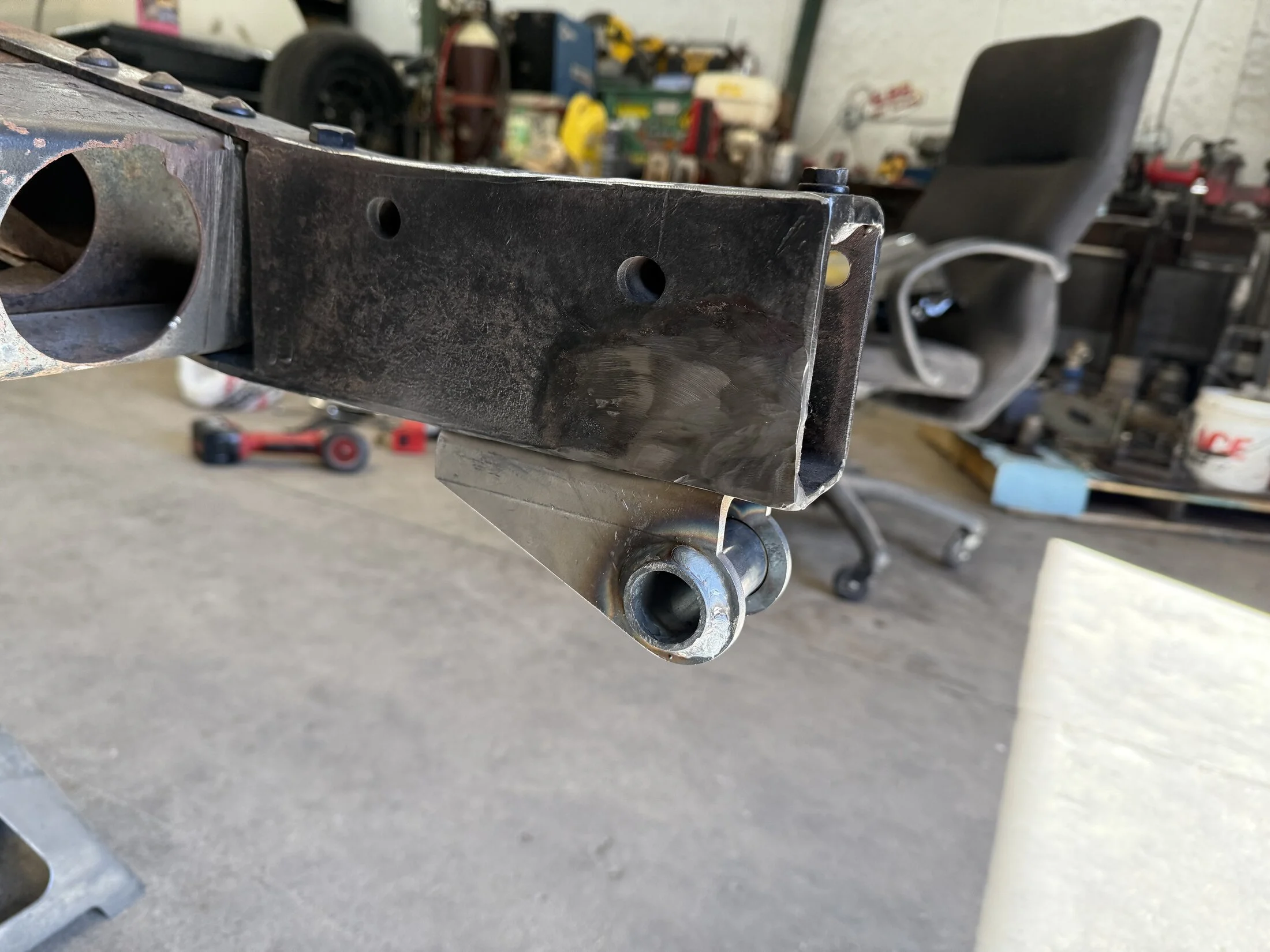

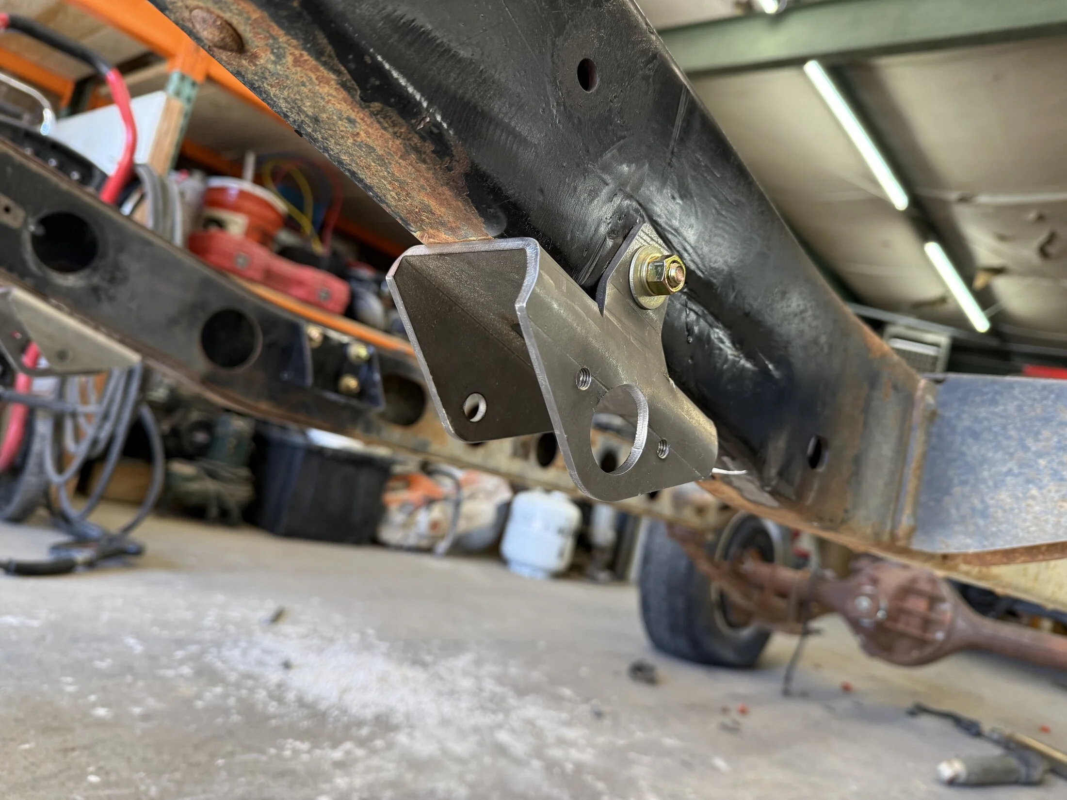

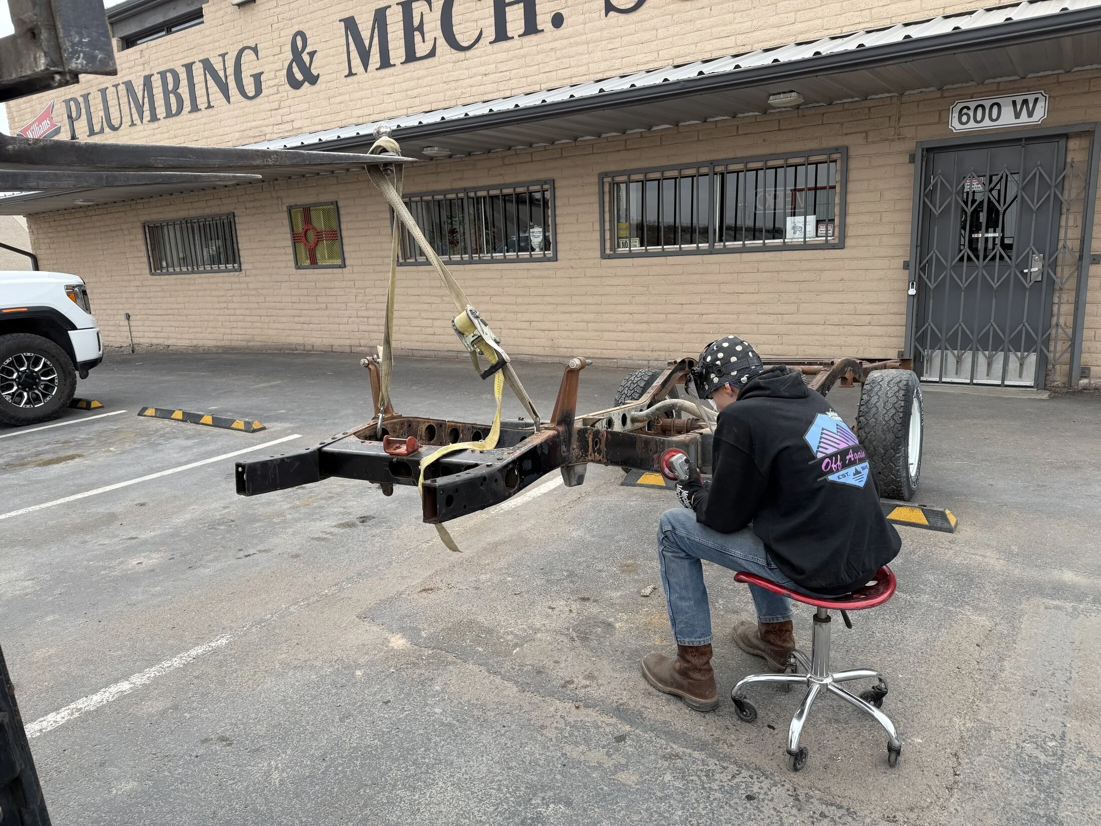

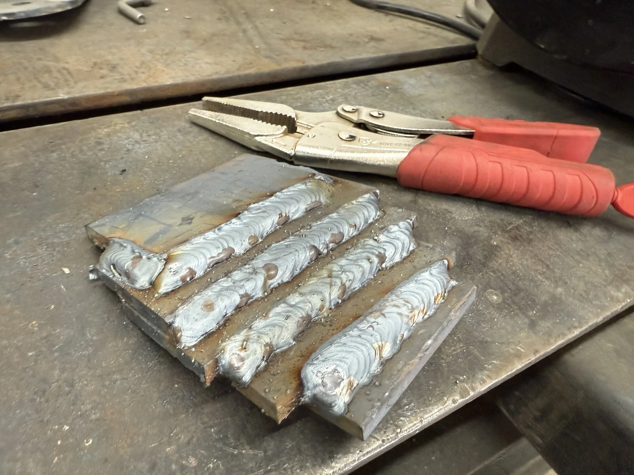

So my man has been practicing for a couple days. This is the results of his practice and then some real beads on the frame. He’ll burn in the motor and transmission mounts later this week. Then off to sandblasting and chassis paint.
Also on a side note we cleaned up the frame rail and discovered the VIN. I think this means it was built in March of 1965?
