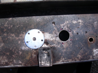

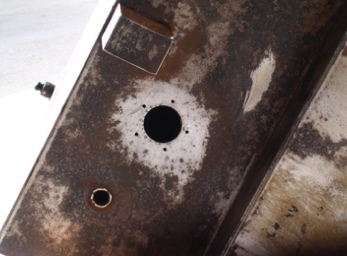

SUCCESS & I SURVIVED!!
so, I just wanted to follow up and report that I was able to drill the sending unit hole today in the tank and live to tell the tale.
I ended up doing the following:
  • pulled tank and washed out 3-4 times
  • let sit (and air out) 24 hours and washed out again 3 times
  • filled with SOAPY WATER until full
  • drilled sending unit hole and 5 attachment holes while tankwas full of soapy water
and I didn't even get shocked using an electric corded drill to do it all.
I will post up photos of the process either in this thread or the man-a-fre tank thread I started. https://forum.ih8mud.com/showthread.php?t=84831&page=3&highlight=drill+tank
I have some good photos of the drilled hole.
