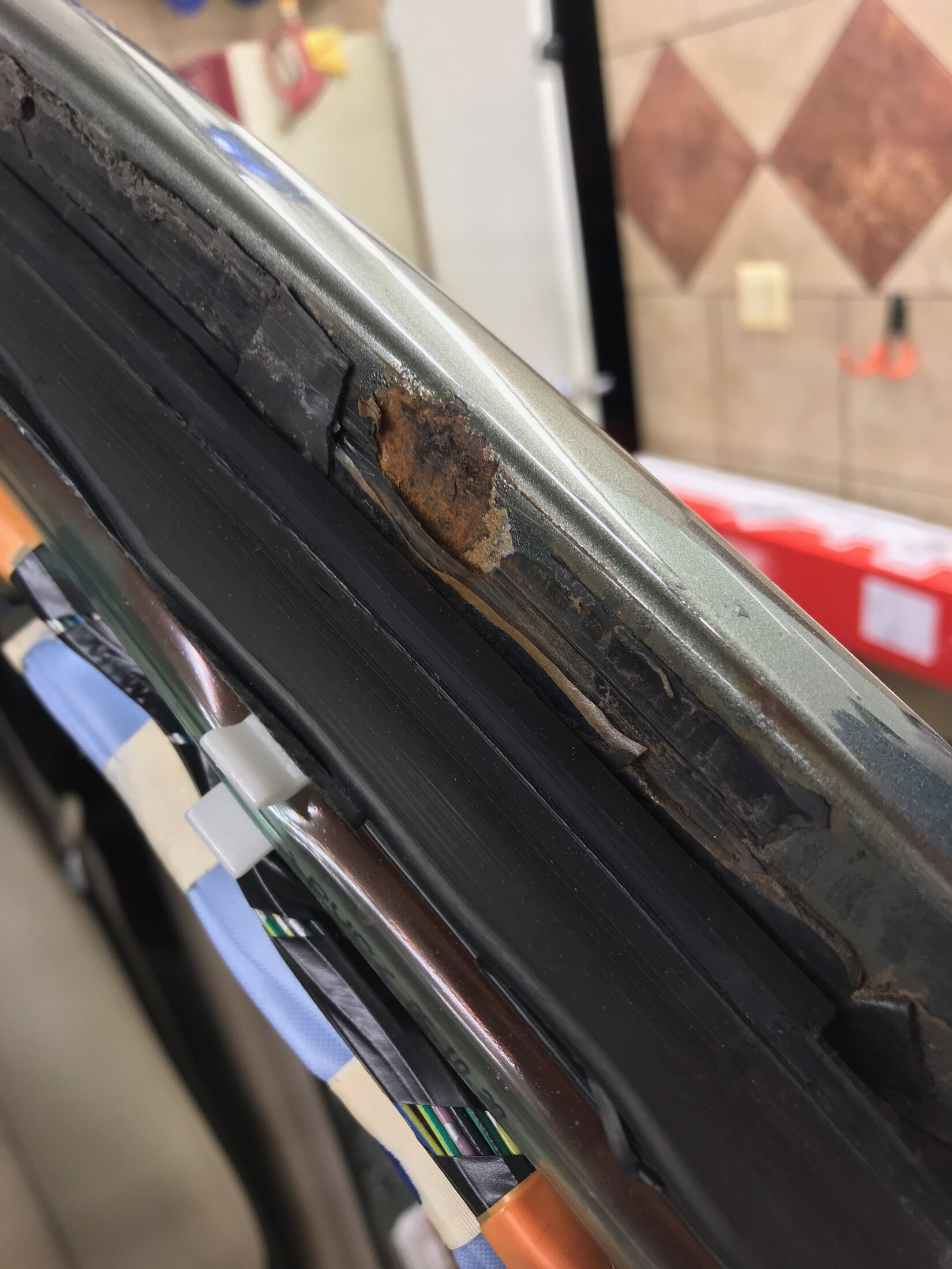

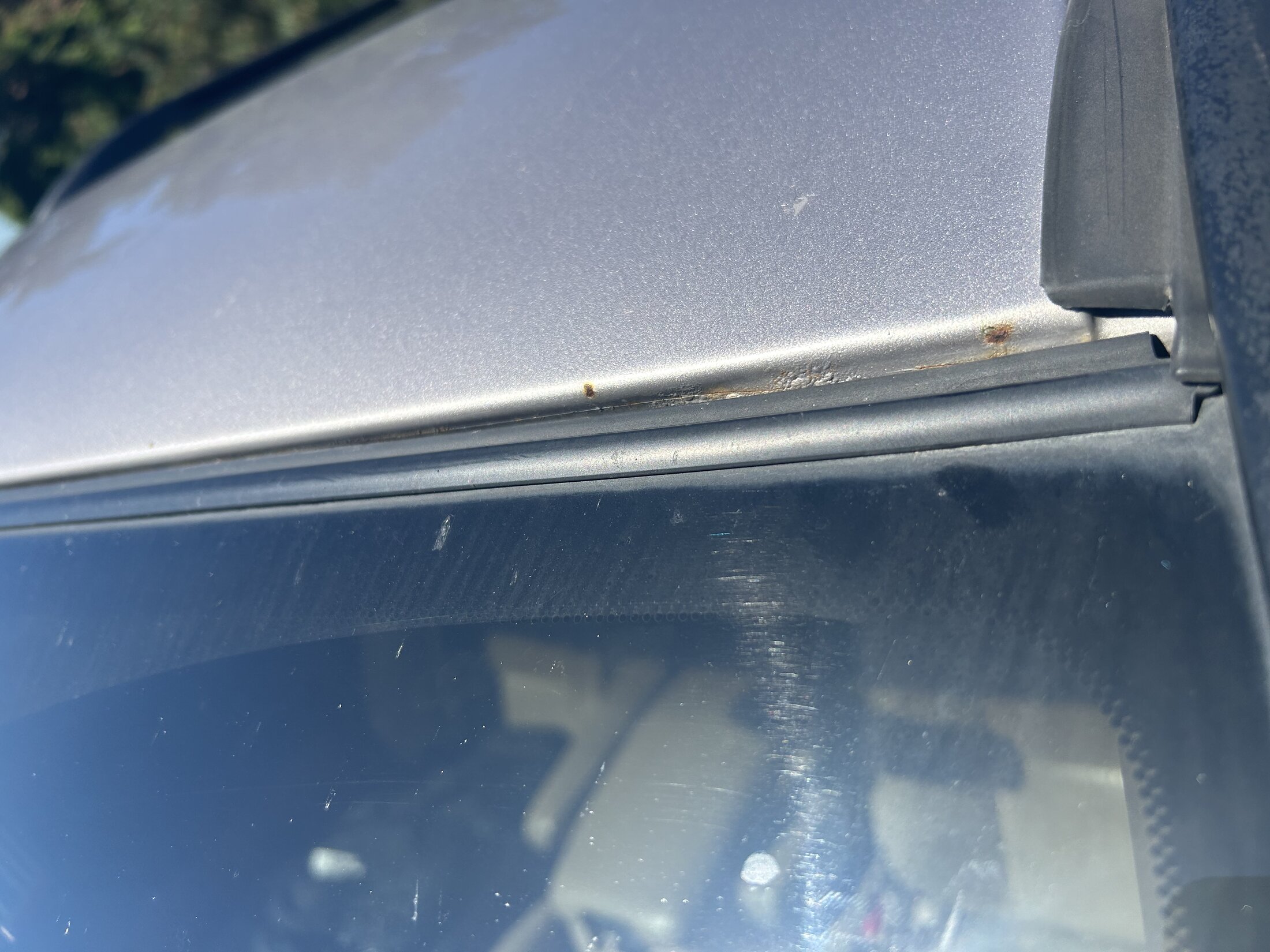

Hey all,
Need a new windshield for the 1999 TLC and Safelite told me this morning they will not do it because of the “severe rust” that is around the windshield. Hoping to get some advice on next steps before just taking it to someone else, for example should it be going into a body shop first?
Personally, I would not let Safelite change my wiper blades... Too many "rookies" being given jobs that they have no idea how to repair/replace glass without causing damage or issues... Amazing that they can diagnose your issue with the glass in place. Looks like someone has attempted a repair in that area in the past (paint tape line visible).
In any case... have a well known and established shop pull the windshield, then inspect further, to see the extent of the rust. Repair the windshield frame accordingly and have that same shop install the new glass.

@summy Interesting how the windshield gap at the top center is different than the driver's side.... like as if the windshield was installed crooked or body work done to the roof area. What does the passenger side look like?
In general I would say for the 100: If you can see rust along the upper edge with the windshield in place, chances are good it's going to look *awful* once you pull the glass out. I think Safelite was wise here.

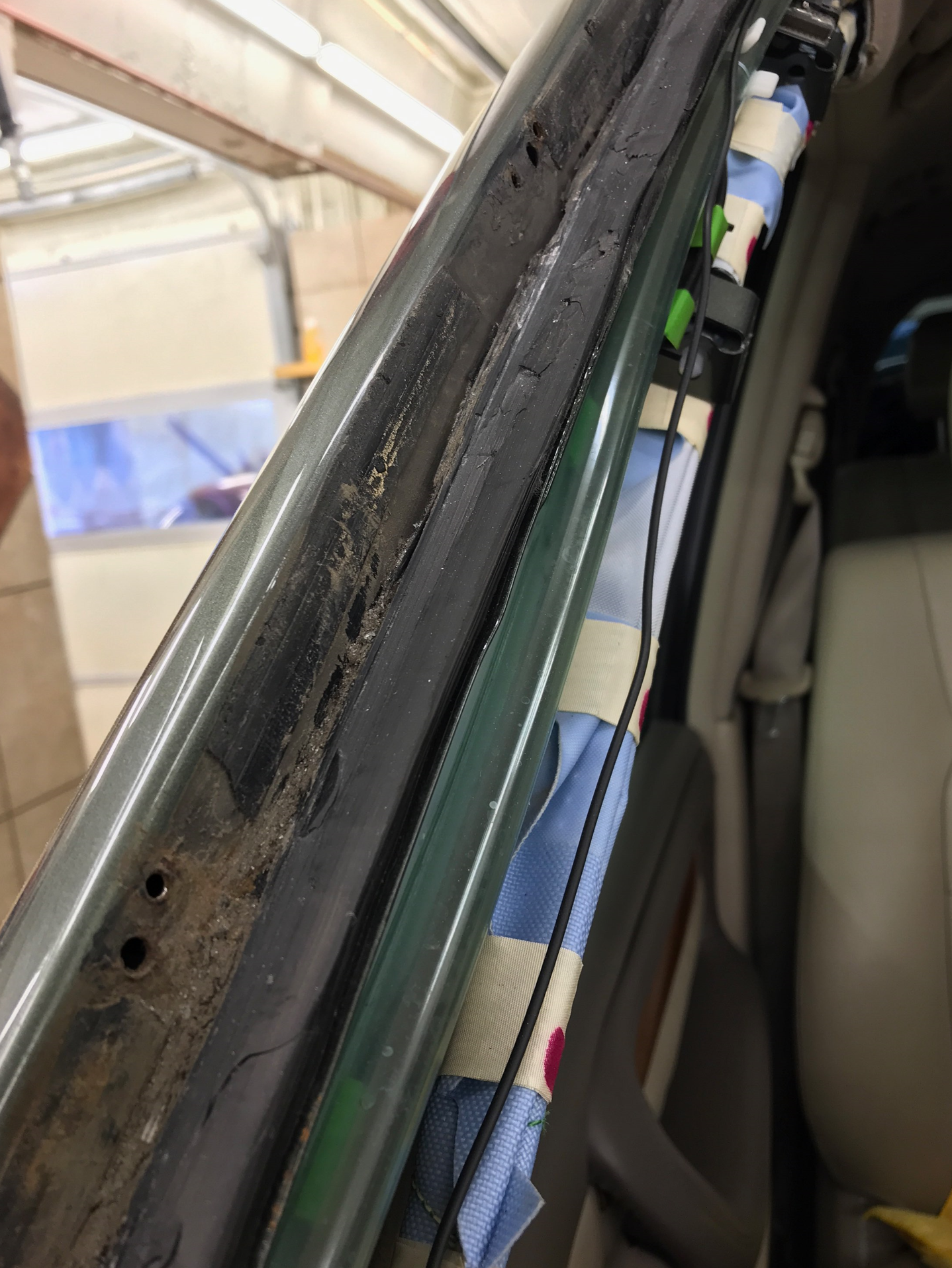

My windshield job involved a lot of body work to prepare for the new glass and it looked better than yours in these pics.
Here was the worst spot, but there was more minor damage in other areas. With the glass and trim in place this was just a tiny area that was obviously rough.
Previously drilled trim mounting locations from past installers:
Really good eye. Checked this out when I saw your message, and the glass was totally out of alignment. Just had it replaced today and asked the tech what he thought happened and he said probably a poor installation the last time. Nothing wrong with the body. Looked at the new glass and he did an awesome job, everything lines up and sealed well. Just grinned down the surface rust, reseal and have a good day.

Odds were in my favor! Lots of flavor on the surface but grinded it all down and there was good metal right underneath. New shield looks great.

Nothing more than some flavor on the surface that could just be grinded down.
