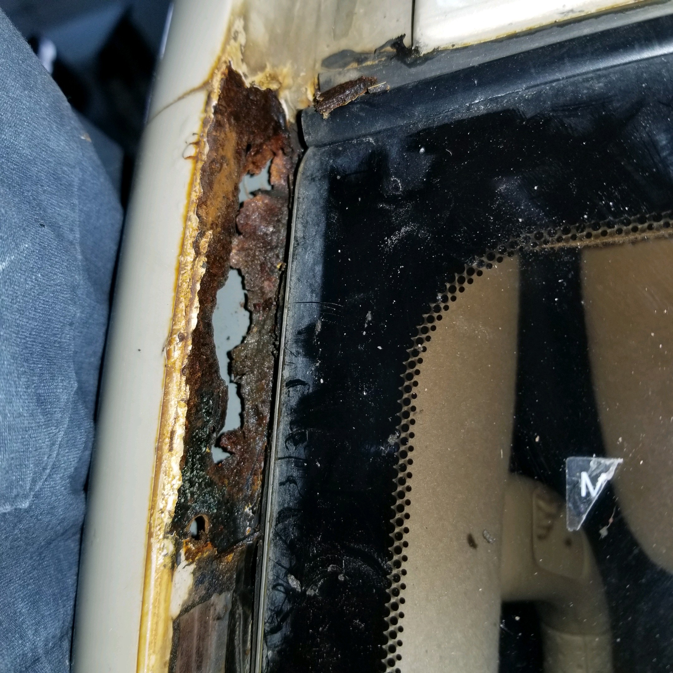

I once suggested to during a PPI of 03LX, to not buy due to windshield rust. He bought, with rust. After purchase, I notice a small new dent in fender. The kind PDR could likely pop out. He hadn't noticed. He said; "Must of been in store parking lot".
I suggested he put in a claim. That at same time, he put in claim for cracked windshield. Tell the ins adjusters. Safelite requires body work be done, before they'd install. What was shocking, is just purchased and they paid for rust. Rust that must have taken years to eat away metal.
Insurance gave him a check for $3,500 (dent, rust and windshield). He found a guy to fix for $2,500. Bough set of wheel, with extra $1k. I can't say how good a job, at cutting out rust was done. But I can say it looked like new and paint match perfectly. It's been 5 plus years, still looks good and no water entry.
He had big holes under molding.

To close the chapter on my windshield frame rust I can report the Rust Doctor in Grand Junction CO saved my 100 series. Cut, weld, paint. Amazing group and result. I am so happy to have this behind me.
I also learned though the experience a lot about windshield installation. The dams are not required in the day of modern urethane formulations. We also have primer-less to glass urethane these days. The top spacers, geometry and dimensions of the urethane bead are all that really still apply from the FSM. My opinion is that Dow makes the best automotive urethane currently.
