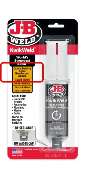

IMHO, that would be entirely acceptable, espescially if you used something like a steel reinforced epoxy, which I think performs better than epoxy alone for these types of applications. Something like
This stuff, and epoxies like it, get a bad reputation because it's misused a lot. Lots of end user products are epoxied together; like the honeycombed floor of a Lexus sedan, for example. Toyota chose epoxy instead of welding because it provides a premanent flexible bond, whereas welding would not. It also serves as a sound dampener.
Remember, you can also solder or braze metal. Welding is not the only way to repair metal, it's just widely used because there's a lot of utility in it, and a lot of money for manufacturers and sellers. For repairs like this, if I wasn't going to epoxy it, I'd silver solder it, after prepping it as you described, of course.
