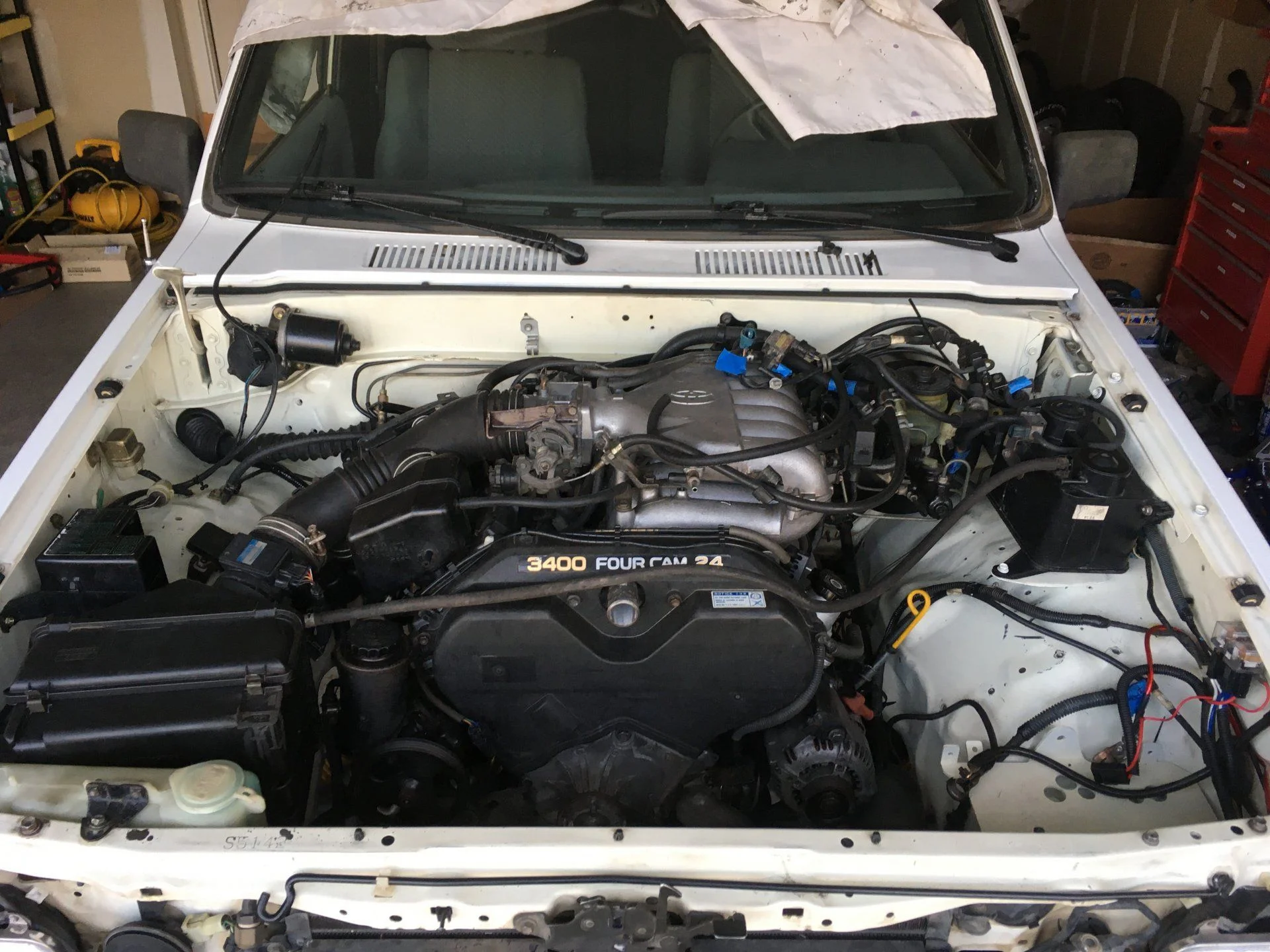

5VZE is in and most of the supporting mods / wiring is done. I finished the airbox mods, EVAP box mods, throttle bracket mods and a few other things yesterday. If things go well, I may be able to start it up today. My exhaust is only connected to the downpipe and cat ATM. When people say the 5VZE swap is "plug and play", I'd say they have either never done the swap before, or they are comparing it to a full 100% custom engine swap. There's A LOT changes that have to be made. I'm pickier than most though as I want my swap to look as close to factory as possible.

Just a thought, but if you move the evap box over near the wiper motor and fuse box, it eliminates have two vapor lines running completely across and back in the engine bay since the tank vapor line and donor motor intake are both on that side already. I did it on my last swap. Not quite as easy to mount but worth it. Just my two cents.

Anyways, I'm super happy, as all the troubleshooting I've done over the last 6 weeks has been failure after failure. I learned a ton about wiring and how everything works at least. Here's the finished engine bay. Still a little work to do.... The truck runs so strongly and smoothly compared to the 3VZE. So far I'd say it was well worth the effort.

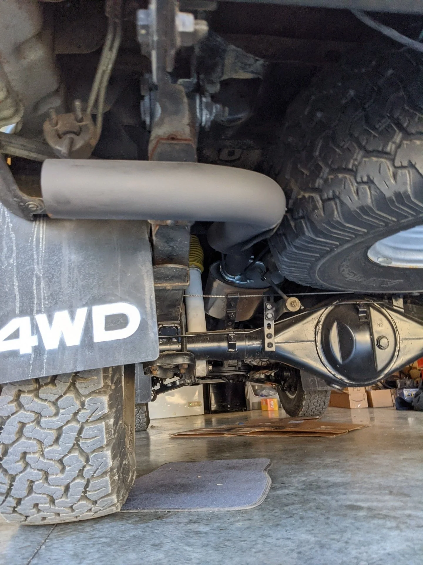

It's been awhile since my last update. Fabricated a new cat-back exhaust for the 4Runner using a set of 2.5" bends and a Borla 40665 Pro XS muffler. Lots of respect for the exhaust guys; it was not easy. Sounds great to me. No drone at all and pretty quiet.

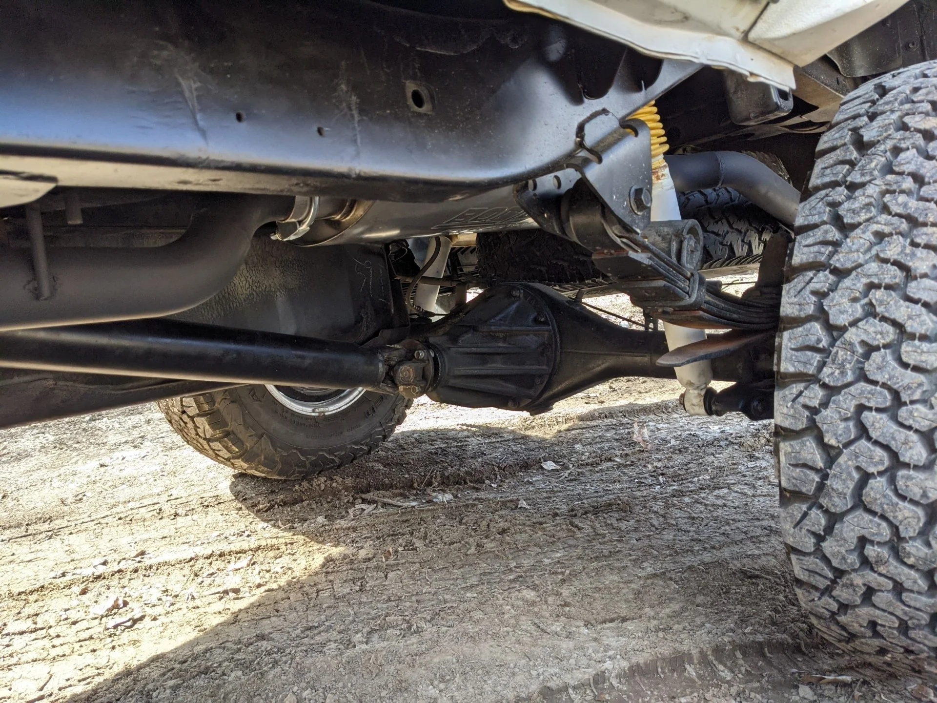

Also picked up this beauty from the pick and pull from a 99 Tacoma Pre-Runner. Future install. As it's sitting now with the new (used) Aisin manual hubs!
