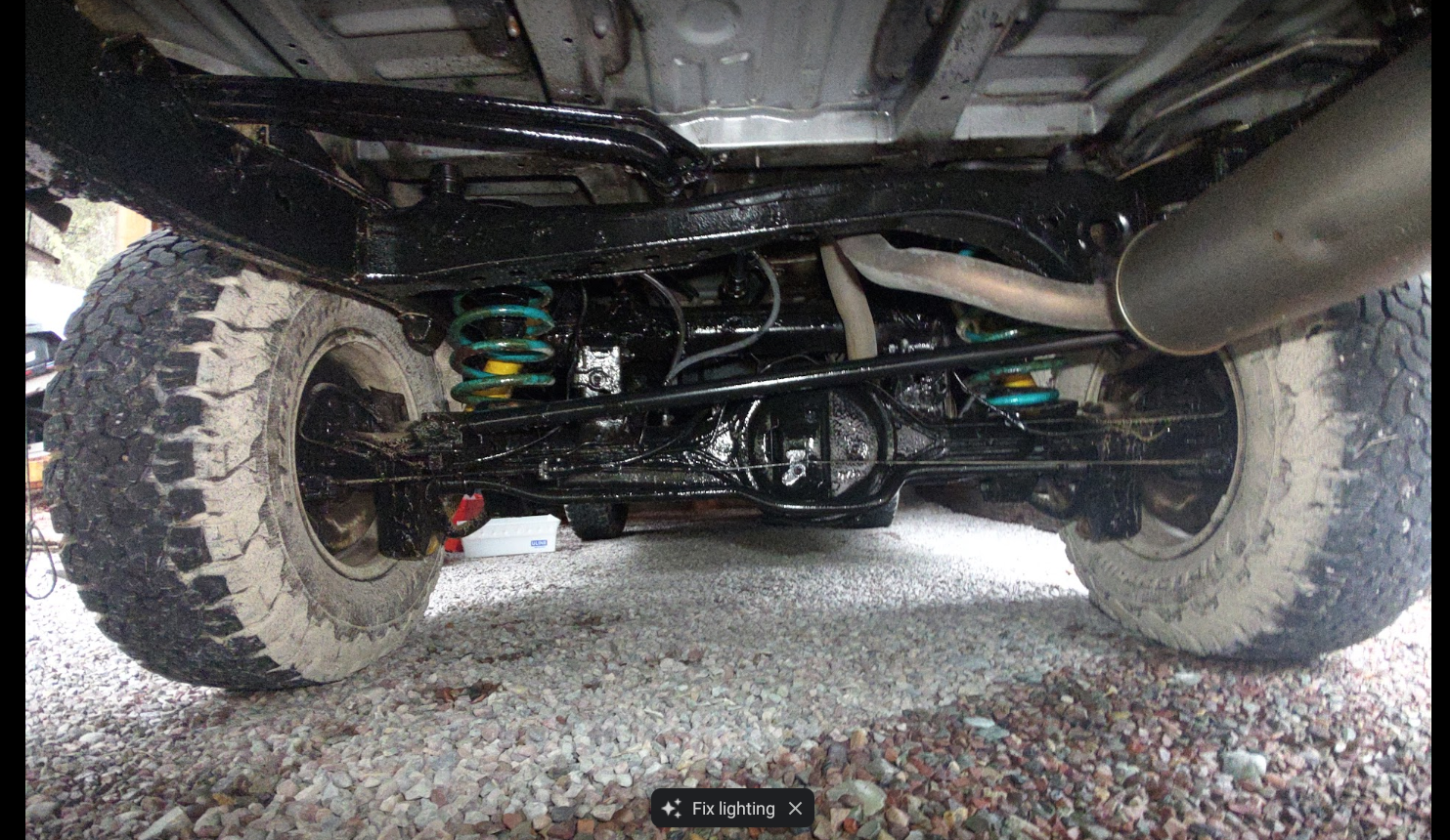

Hello,
I recently got a 2000 LC. It has been a Cali truck all its life except its spent the past couple years in Maine. There was almost no rust on the frame, just on the welds and the axel had some decent rust in some spots. I spent time getting away most of the rust then painting it with POR-15. I'm not going to lie its not the best paint job. There small spots that didn't coat right (most likely due to not being clean enough). I did all this during s***ty weather. I'm planning on getting a FF coating every year. I want to keep this truck as long as possible. If I'm being honest I never want another vehicle. Anyone have any suggestions on how to keep the truck in good shape while living in Maine other than my precautions and future plans with yearly undercoats? Any advice is greatly appreciated.

Let's see some pics. It sounds like you've got a solid base to start with so don't stress it so much. POR15 is a good product but needs to be applied right or else it tends to crack / peel / trap moisture.

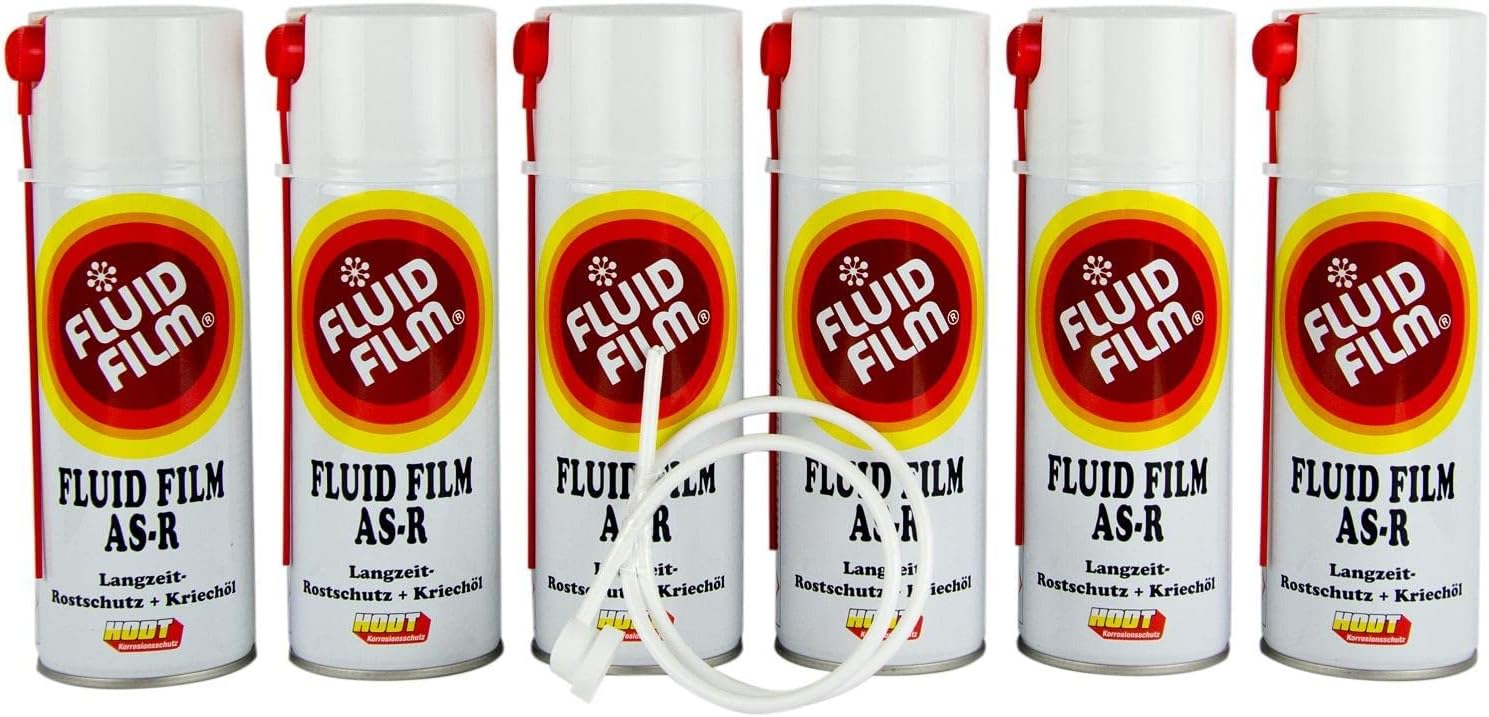

To the OP - regarding the inside of the frame - most of these products are sold in aerosol sets that include inner coating nozzles. If you intend to use a compressor instead, look for inner coating nozzle for compressor separately.
I bought a pair of these sets, total of 12 cans, observe the inner coating nozzle included:

I bought a dozen and used about 9-10 of them for the underbody. I will use up the rest for the body cavities like behind the rear lights, etc.
I saw no signs that the previous owners have done any rust prevention, but the car is 24 years old, so at this point I don't know. The frame is in a good condition, with some surface rust that I removed with wire brush on my Makita before spraying.

I'll take some pics soon
