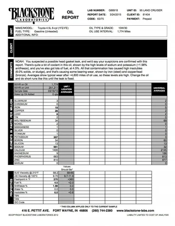

**UPDATE WITH BLACKSTONE RESULTS**
I have attached the Blackstone Report. I'm hoping for someone to help me interpret it.
  • I know a head gasket is for sure.
  • The rep made me very concerned about the amount of fuel in oil and threw out two possible ideas; worn cylinders or leaking fuel injectors. Is there a way to have the cylinders checked before I would decide to do/not to do the HG job? How concerned are Mud members about the possibility of worn cylinders? I haven't seen it really come up as a topic on the forum.
  • Any other thoughts or things I should be concerned about (as if that wasn't enough)? :censor:

Wow! Sorry to hear that. For this area a locked truck with a bad engine will be more like $2k. Let me know if you need help. I look at the results and there is a lot of copper and lead. That would concern me for bearings. Did you pull a sample from the oil that was in it when you bought it? If so, the fuel could be directly related to what the seller did to get it ready to sell. May be an injector hanging open. I'd keep it and do it but I don't know your situation.
The oil sample was taken from what the seller had in it, and I took it while still having the overheating issues in the truck so it only ran for about 5 minutes before I drew the oil. Does anyone thing that not having the oil up to temp could have resulted in the higher fuel %?

I don't think there is a way to differentiate. However, the head gasket is a really well known failure for these trucks and it seems reasonable to think that it is the problem. You could evaluate the spark plugs by looking at them or do a leak down test to see which cylinder is leaking and what systems are leaking. If the truck is still running smoothly, it must not be too bad. Mine was missing on at least one cylinder due to low compression. At this point you know that it has a sealing issue, replacing the block and/or head with used during a rebuild doesn't add that much to the cost all things considered. Personally I wouldn't spend time or money on additional analysis, but decide if you want to rebuild/replace the motor or sell the truck as-is. An overhaul is not a cheap thing to do, (I am doing it myself on the truck I just purchased) but once you are done, you will know what you've got. If you want an 80 series, you could sell it and buy another and be in the same situation in weeks or months, or live happily ever after, it's a gamble. When I bought my truck, I was OK with buying one that already had a blown head-gasket so that I could get it cheaper, overhaul it and then have a known quantity to work with. If you decided to try to have the head gasket fixed in place, you do run the risk that you'll get into it and find the whole engine has to come out. That was my theory so i went ahead and pulled the whole motor so I could go through it all and replace all the coolant hoses and be sure that the cooling system in in top condition.
I'd say a cracked or warped head is much more likely than a cracked block. Anything is possible, though.
If you read in this forum, the number of cracked blocks is very minimal (unless you count the ones that threw a rod through the side of the block). I don't think I've read about even one. If it was a bored out SBC, then I would consider the cracked block, but not these.
