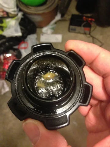

Just to be sure, check oil and if you can post a picture of your oil cover overturn to see the inside of you oil cap!
I just ran the engine for a few minutes and snapped this pic. Oil level on the stick was showing a little above the full line. photo.webp
