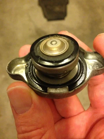

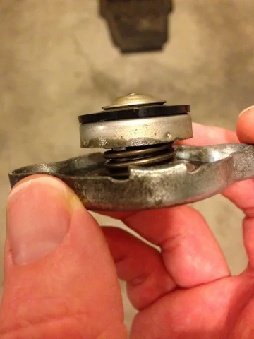

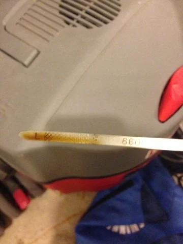

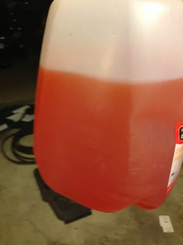

I want to see the bottom of your cap!
Sorry for the delay friends, I had to work late last night. I have four photos to share: The first two are the underside of my rad cap, the third is of my dipstick, and the fourth is of the coolant that came out when I changed the TStat.
To me the oil looks fine. I would recommend changing the radiator,... while you are at it throw on a new water pump. I would not be surprised if that solves your problem
Thanks for checking. I took the oil sample today for Blackstone Labs. I drove it for about 5-7 minutes around the neighborhood to warm the oil and it was up to just North of 200F again. While I was at it I ran it some more in the driveway to see if there was any movement in the radiator and there is none; just the distilled water from when I last topped it off after changing the thermostat. I dont want to buy anything until the anaylsis comes back, but to me it seems plausible that the rad and water pump may be the problem, as you indicated in your previous post.

After seeing your pics of coolant, oil, and radiator cap, your system looks clean and no obvious evidence of HG.
