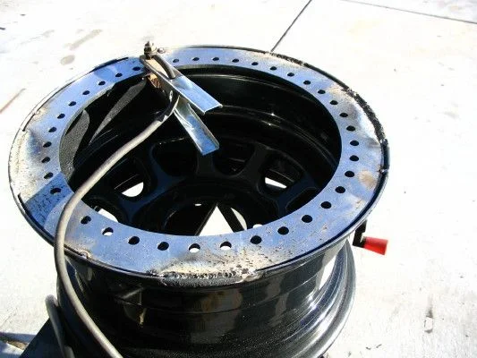

starts with the rings
spaced them and started welding. firswt tached them in a + x configue ie did a tach on top and bottom , left and right, then diagnol. o make sure they didnt move, than started 3 inch welds, moving to opposite sides t keep the heat down.

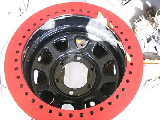

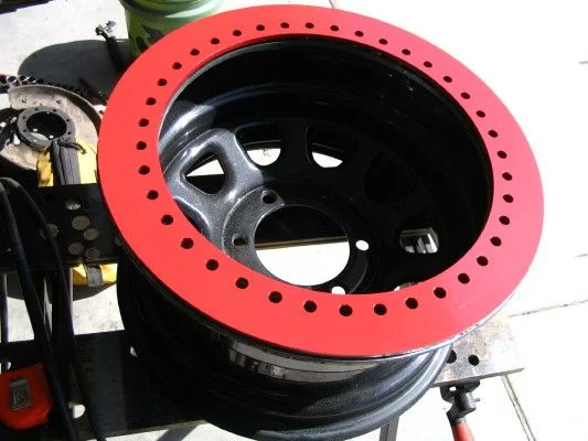

welded it all and painted the rings and this is somewhat of a final look.
bought all my hardware ( cleaned out the store where i bought them from)
i am using 2 inch 3/8 bolts and some nylon lock nuts.

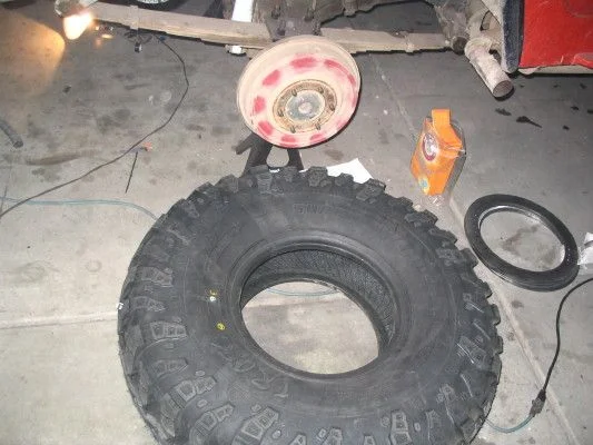

heres a look at the tires ill be squezin on these bad boys
they wheel and tire do not weigh as much as i thought they would.
tires are 36x13.50x15

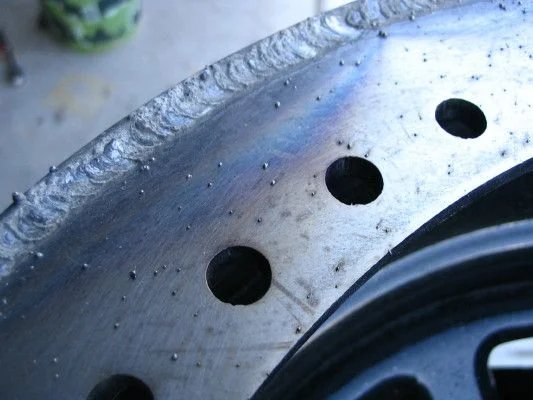

It doesn't look like the wheels were cleaned from paint before you started welding. That's why there's so much spatter = contaminated weld :hillbilly:
i took a sanding disc on a grinder to it, it was clean, i do not have gas and those splatters are fomr the flux core sh*% wire i have. trust me it was cleaned

nah its all good, i dont claim to be the best welderor even a good welder at that. i like the feedback and the do and donts and try this maybies.. i take it all in and learn as much as i can to become better.
