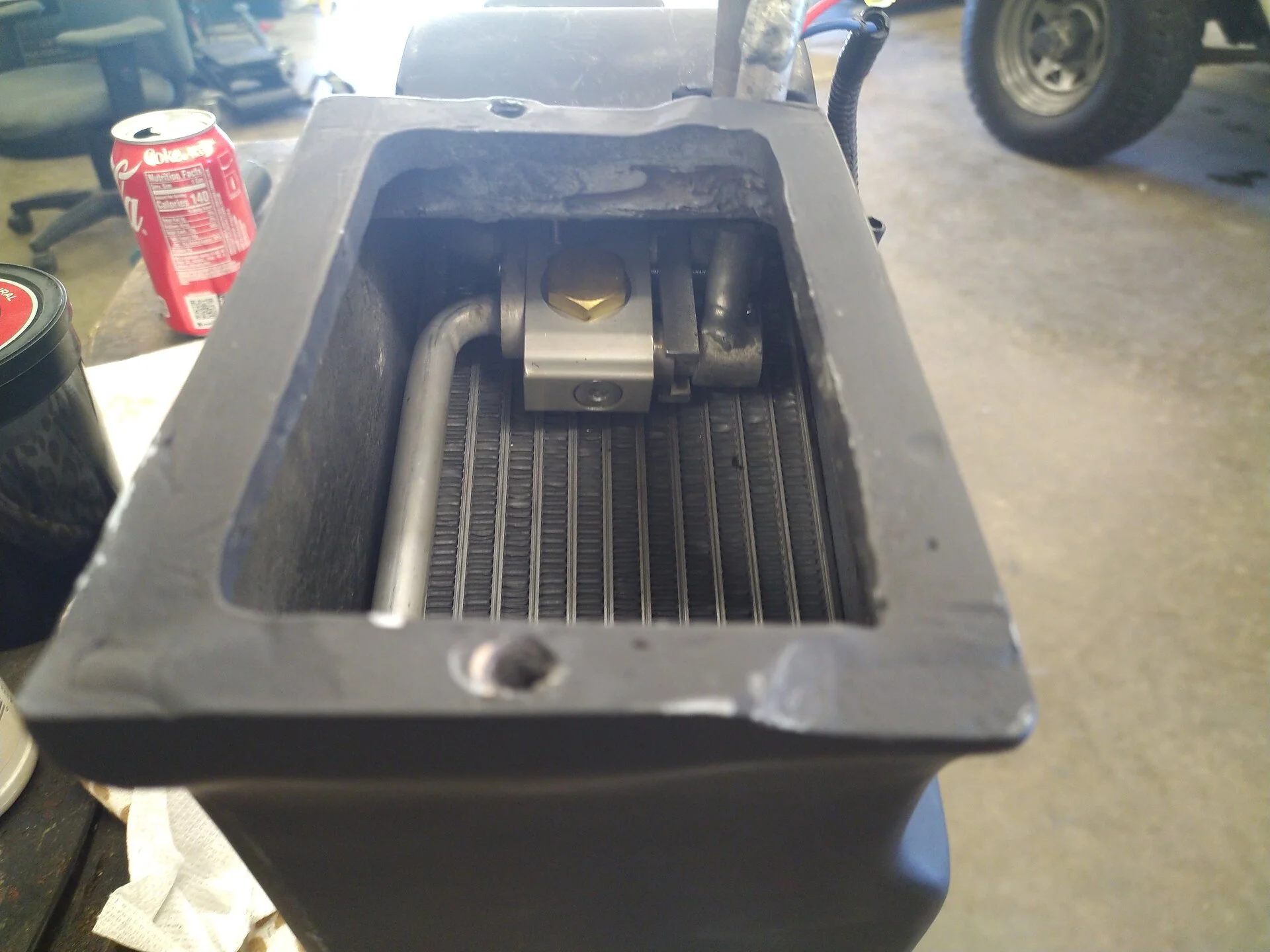

Built to hold a evaporator/expansion valve from the rear of a Lexus 450. Pick only because of its dimensions.

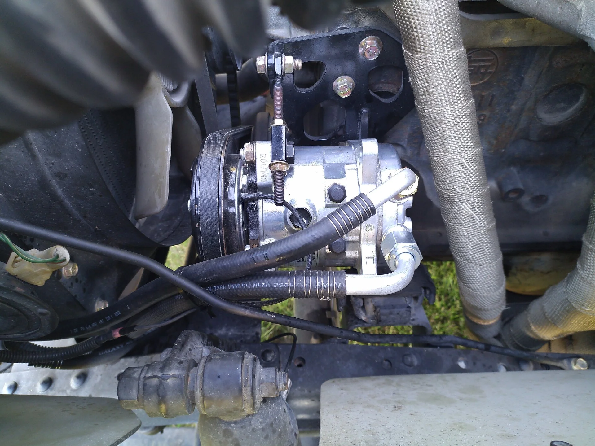

Used hose barb ac fittings and then wire hose clamps. Really impressed with these but never used them on ac lines. Pressure checked system to 250psi and have no leaks looks like I'm good.

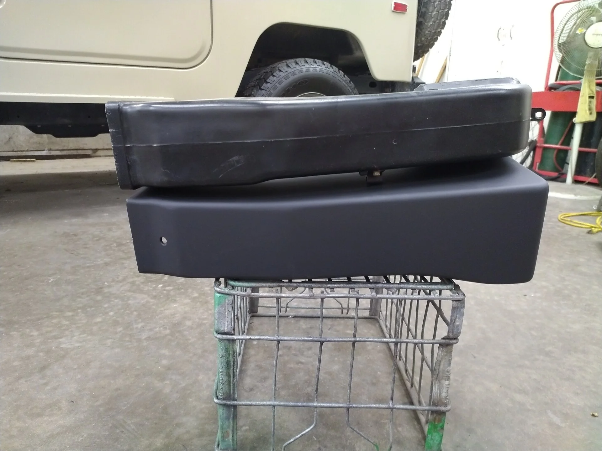

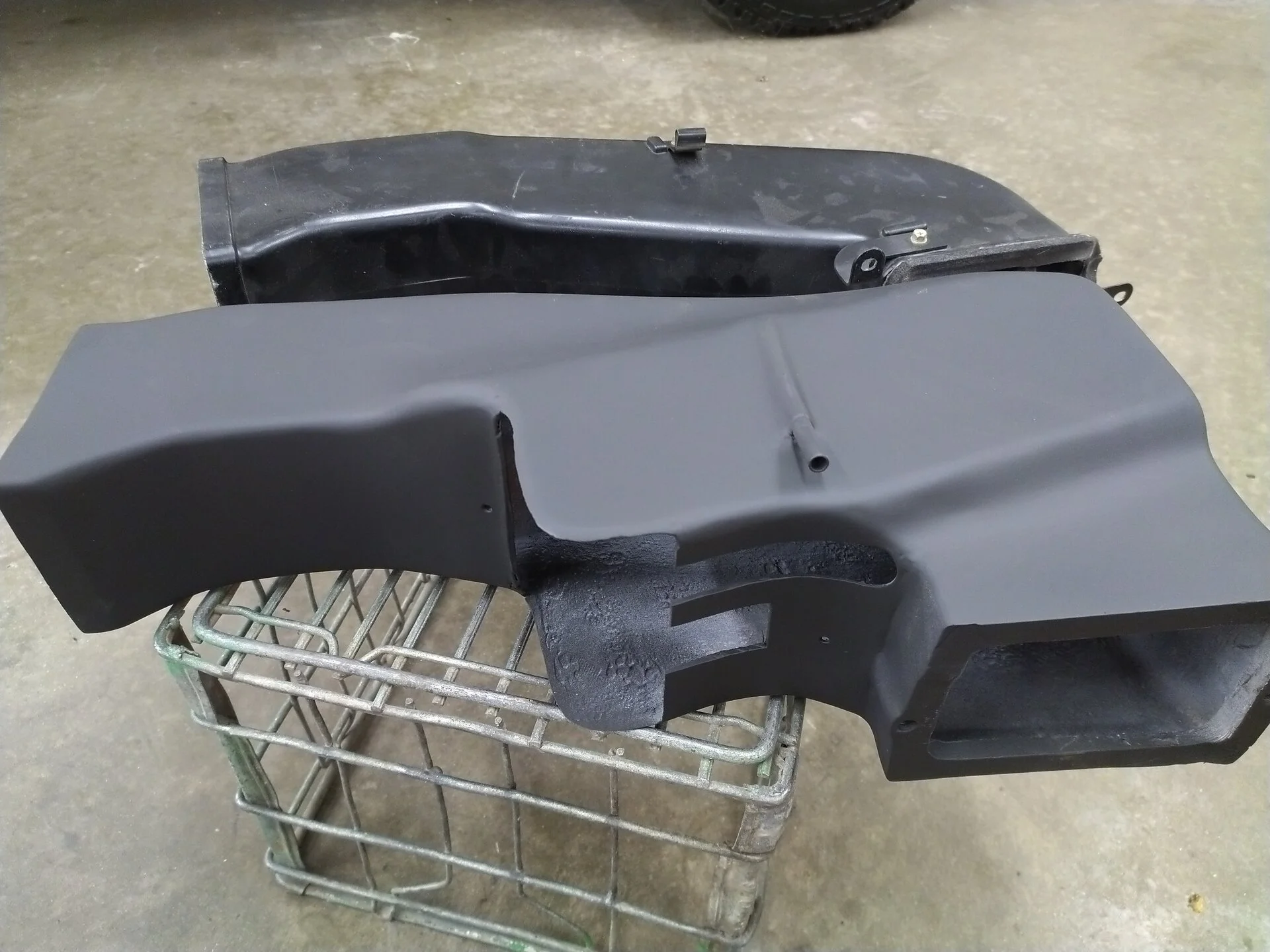

The duct work I made from a hot wire cut foam male plug then covered with fiberglass. Old school?
Cut access door after the fact to allow insertion of evaporator, expansion valve and AC lines that go through to front of firewall.

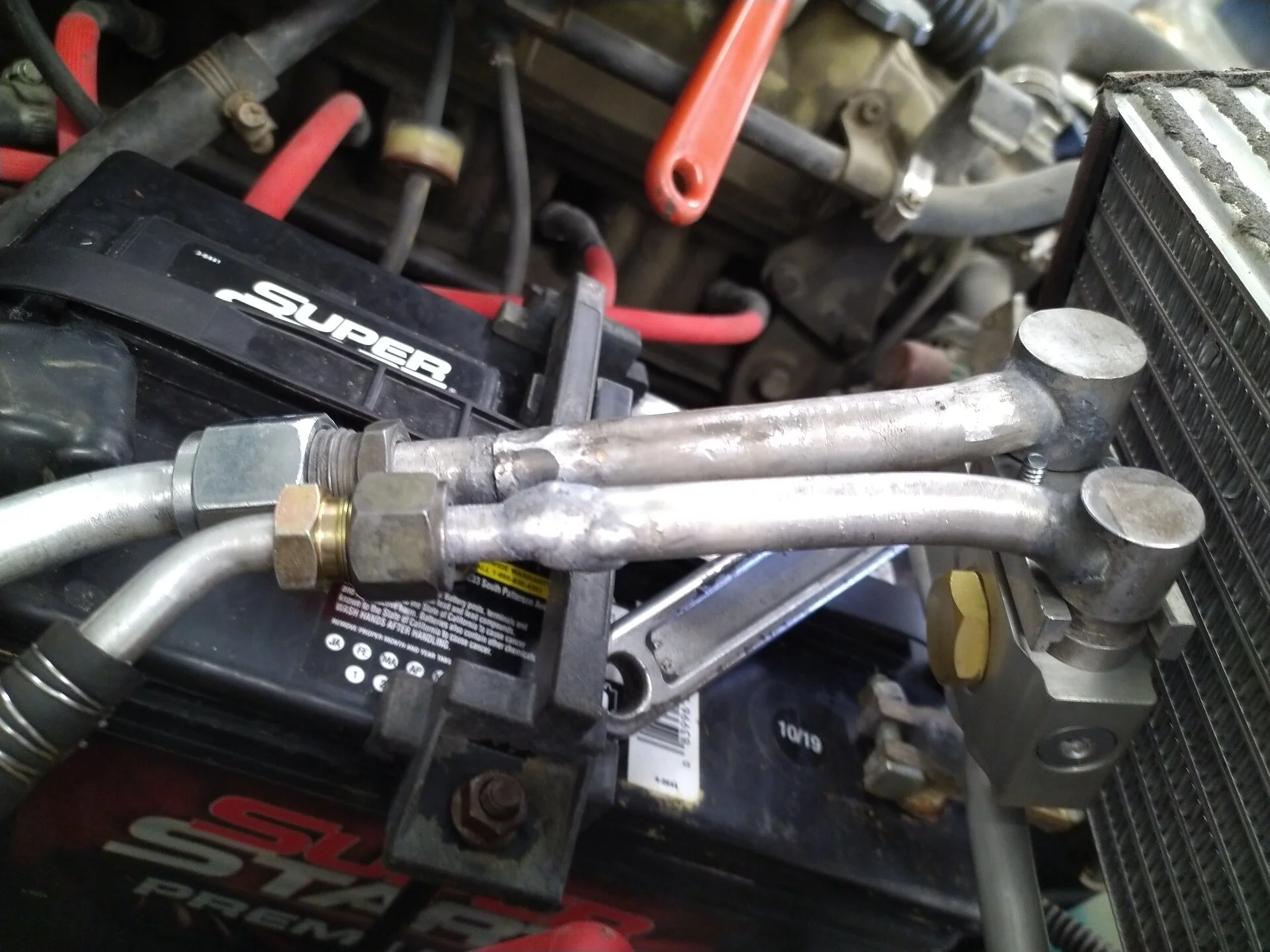

Made the hard lines that run through firewall.
Used aluminum brazing/sweating rod for the joints as I lack confidence Tig welding aluminum. Worked great for three of the joints but on the input of the high pressure side had contaminates that I chased around.
This brazed contaminated joint held 80psi. But not 250psi. Switched to Tig and ended with this embarrassing glob. But it doesn't leak.

So the only thing that has changed is the duct material but feel more important is the way I mounted the duct to the firewall.
Note stainless Philips countersunk screws.
Felt this was a great way to support duct holding evaporator.

For the joints other option is to use the AC repair joints. I had to use two sets on my 100 series lines and these have worked really well. No leaks for couple of years. Also used something similar on my mini split install and have not had any issues on the connections. My tig and brazing would be much worse than yours...
Thanks for the heads up on the repair joints.

is that Sanden brand Compressor ?
