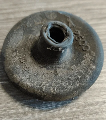

Have someone found these sold separately? Door wiring loom is NLA. Mounting hole 30mm and total width of this grommet is 40mm.
There's an alternative, BUT, it requires removing each wire lead from the connectors and loom, and re-wrapping the loom and reinstalling the leads into the connectors by hand. Electric-Life 4301-70-011 does the front doors. As long as the grommets can be saved, I would clean them as best I could, wrap the wire passing through them with a bit of spiral loom and wrap good quality electrical tape over that to seal them. If the grommets are shot, the Electric-Life looms are your only option.
I just want to run speaker wires with OEM look. So that Electric Life is not really a option. It would look nice though. 5/8" equals 15,8mm. If that is the mounting hole diameter it is way off. Hole in door and A-pillar is 30mm.

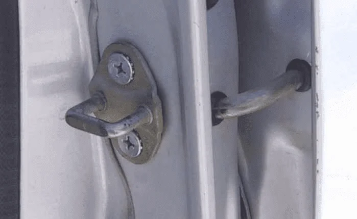

Some things are better non OEM IMHO. OEM left taped wires exposed between two grommets like pictured above. Not optimum IMHO
