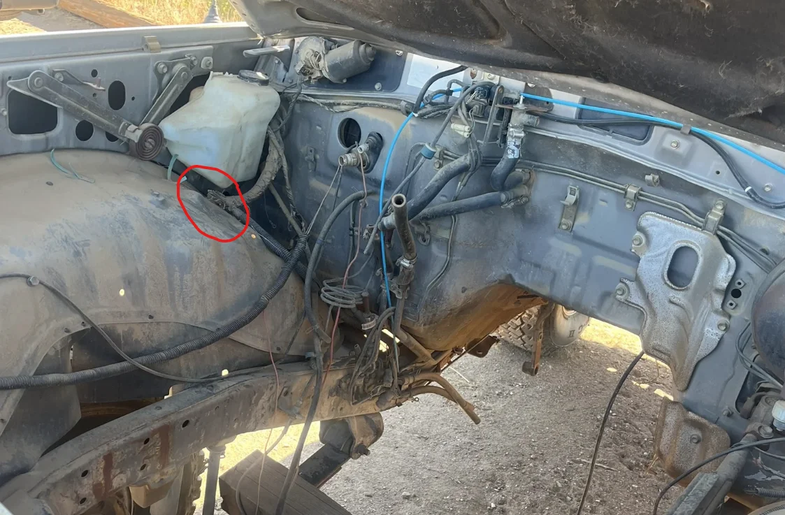

can you post some pictures of where the wiring was cut? I don't see anything in your pics that would inidicate the facotry wiring was cut.

I will take better pictures soon but that's where it was cut

I see it now! Ugh, that's such a stupid place to cut it and no reason to do that for any sort of swap, that is the main harness to the battery. So dumb!
