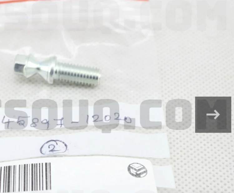

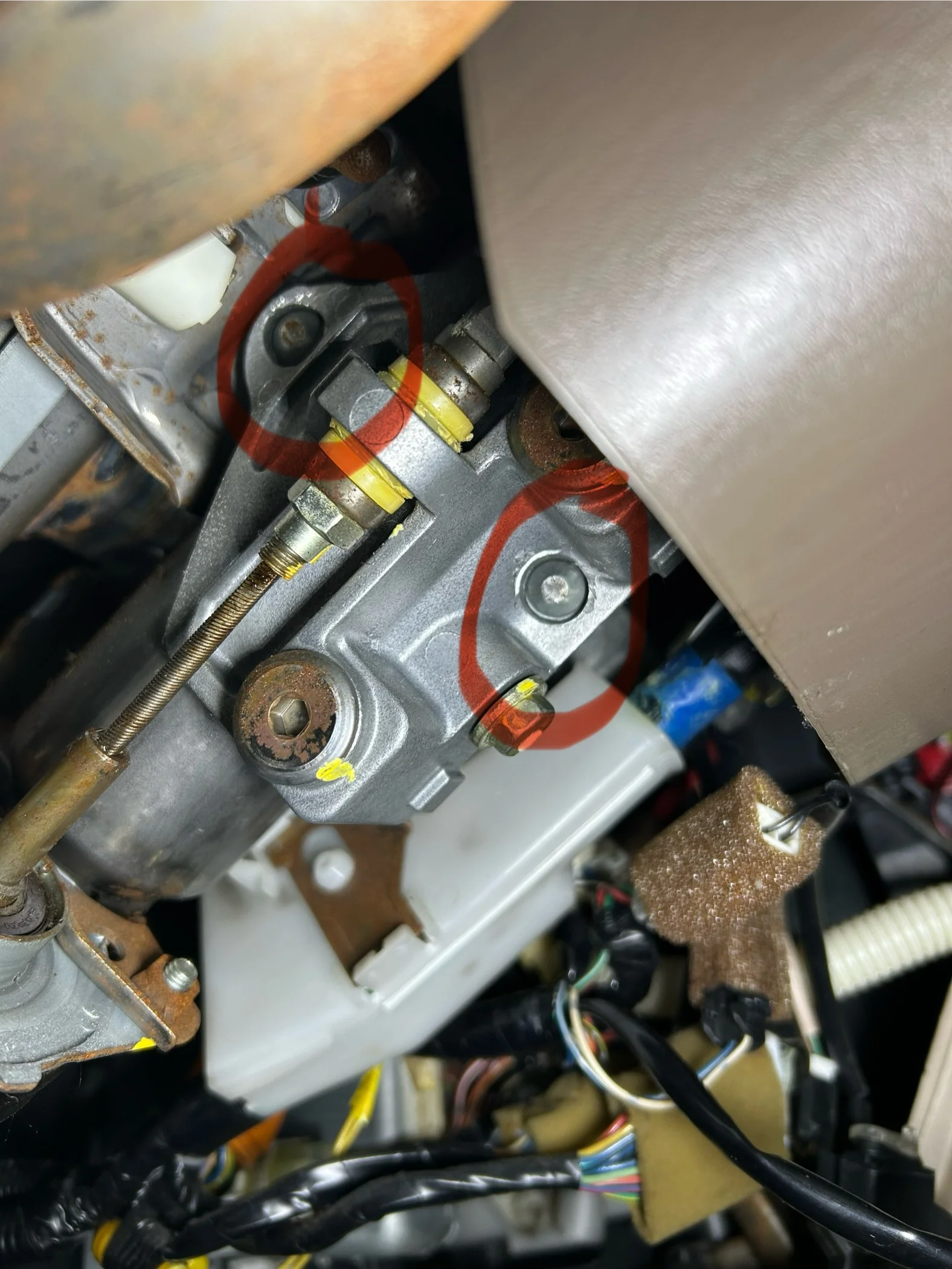

if you can please post a picture of the two bolts that are on the driver side of the steering column. These two bolts secure the ignition cylinder holder to the steering column. I believe mine has been messed with and the heads of the bolts have been sheared off. This is what mine looks like.
You don't need to. There's several threads and even a couple Youtubes on replacing just the internal rod.

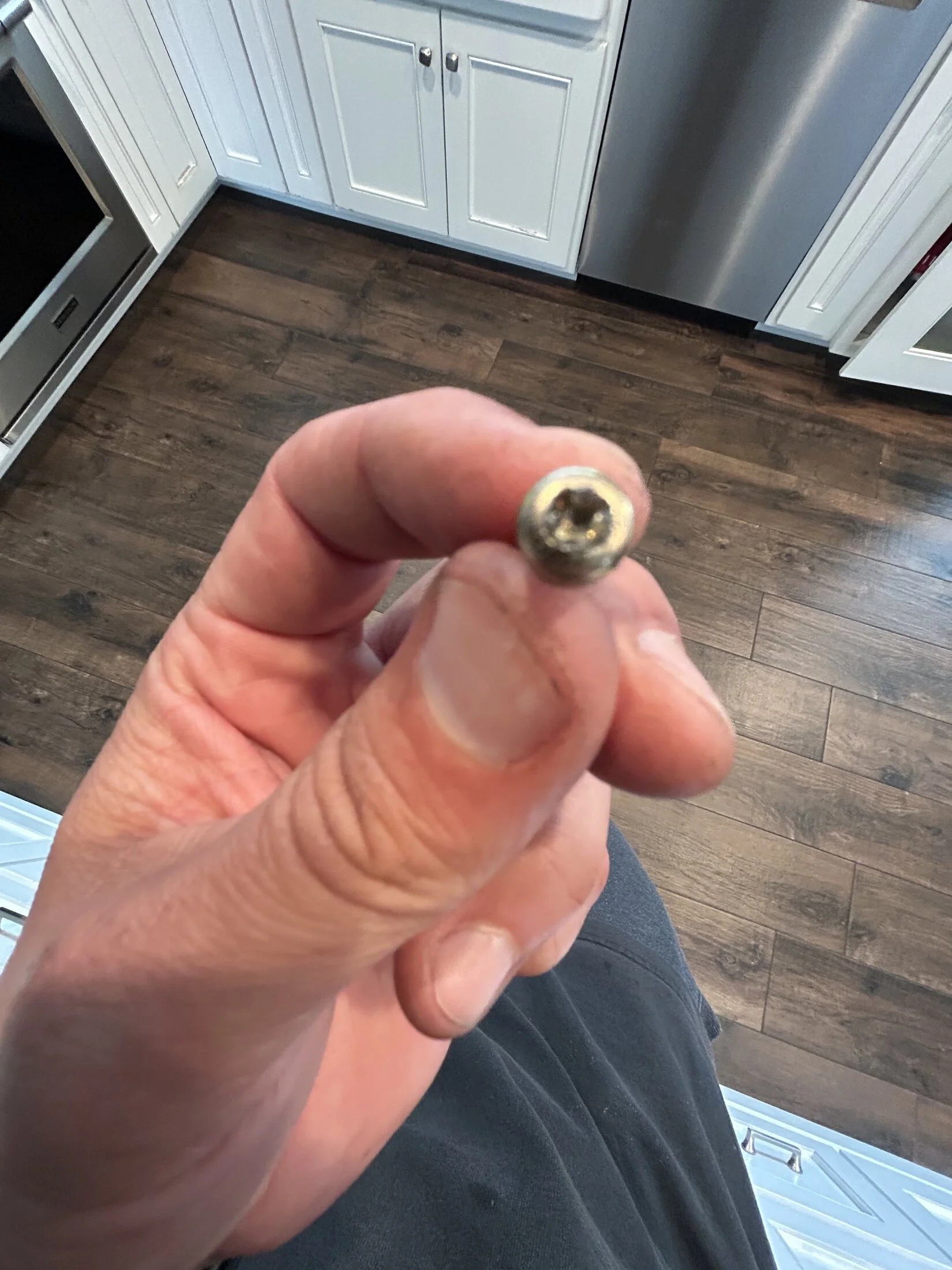

My cylinder cam broke in two places….. so I the end piece will not come out of the very bottom. When I tried to back out the off white connector at the back of the cylinder lock holder I found the brass screws were stripped not allowing me to back out the connector slightly. It’s all a perfect storm for me.
So now I want to the whole thing off so I can replace the screws, inspect the back connector, and put everything back together on my bench with proper light and space.

Yeah. That is why I ended up having to remove the security bolts on the ignition cylinder holder, drop the steering column while it was hanging for the two bolts near the fire wall, then remove the entire ignition cylinder holder. It was a PIA man.

Finally, yes. Had to completely remove the rear 2 screws, then easy. Waiting for replacement part 👍
Nice. Mine were stripped out pretty bad which was why I had to remove the whole assembly. I replaced with hex heads and new lock washers
